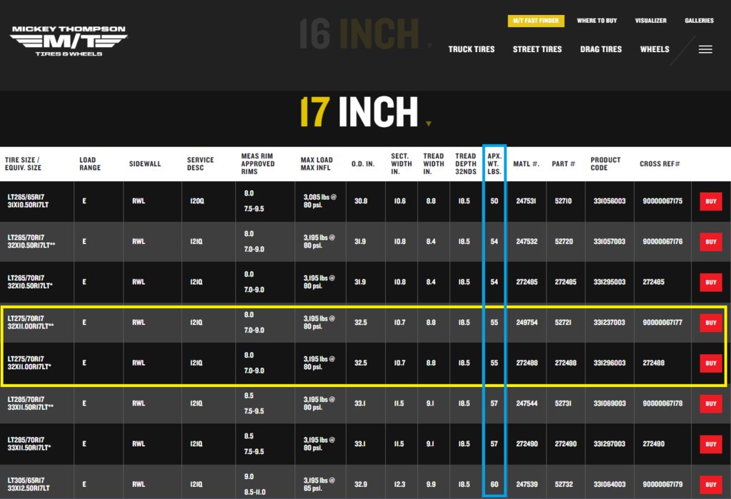

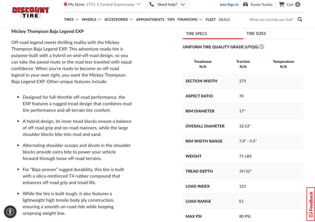

    Sorry, but where are you getting that info?! This is direct from Mickey for the Baja Legend EXP, see for yourself. ~55lb.

    Wow, that’s a bad typo on discount tires part, I guess those are back in the running!

    Dang thats like how heavy the 35x10.5r17 Kendra RTs are.
    Depending on where you look they're listed between 68-71 lbs.
    Not sure how it's so hard to accurately measure weight.

    Yeah I definitely trust Mickey Thompson’s website over discount tire. I’m sure they’re closer to 55 than 71. Seems like a simple copy and paste situation but somebody screwed that one up…

    Bruh it depends how much air you put in them, like doy

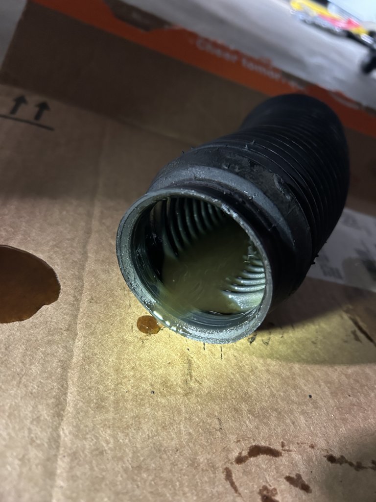

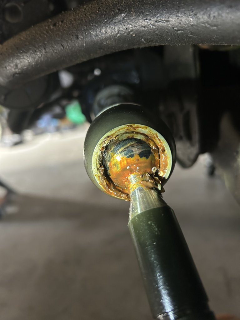

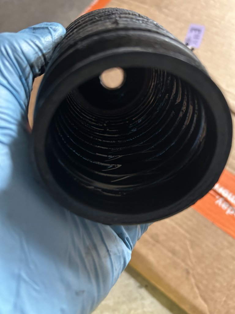

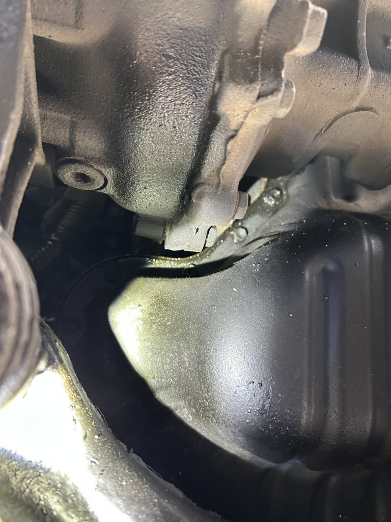

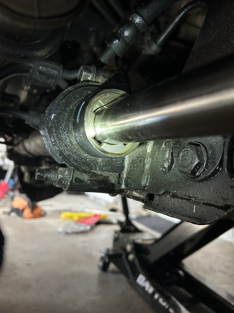

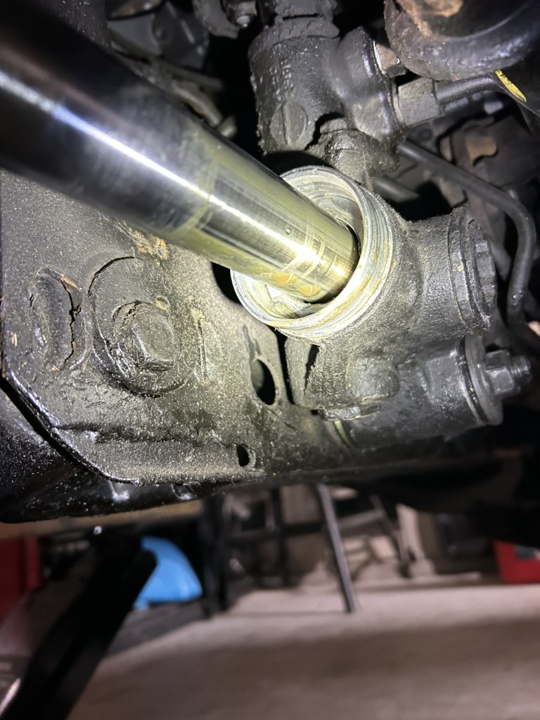

    Got the Moog inners taken care of friday. Impromptu front end refresh continues! After taking the time to do the outers before, and being much more familiar with the components, was able to get them both done in about 2 hours
    Unfortunately while in there, the bellows were full of dirty ATF. I think my seals in the rack are failing. No leaks in the lines above and outside the bellows were dry. Heard about AT-205 to try out to rejuvenate them. Question is, how much do I use? Does the fluid I add replace ATF level? (Ie take fluid out then add equal amount of AT-205 in) or in addition to?
    Also, the valve cover leak is more substantial than I thought to be concerning. Tightened the bolts last week (second time in about a year), but am diving in to possibly needing the gaskets changed, and the figure 8 gasket at the oil filter since there is a leak around that area too. Wonder if the cold temps are making it worse. Checked fluid level and its perfect. Will keep an eye on it. Will also try AT-205 here as well, so same question, would the bottle replace oil at my next change, or do I add it to the 6.5 qts?
    Will get pics soon.
    Voss and KNABORES like this.

    AT-205 is an additive package similar to what high-mile engine oil contains. It can be added at any time to fluids (except brakes and coolants). It’s OK to add into fresh oil, and run it. It’s a seal rejuvenator, not a seal swelling agent like some stop-leak products are.
    They recommend using 1oz of product per quart of fluid. They also recommend 1 whole bottle (8oz) to treat up to 6 quarts of oil. I’ve seen people claim it’s safe to use as much as 1.5oz - 2oz of product per quart. When I used it with quite good success, I poured a whole bottle (8oz = 1/4 quart of volume) of it into my crankcase. My 2UZ (V8) holds 6.5 quarts, and I checked my oil prior to see I was just below mid-level, so I had more than half a quart of wiggle room for it to be there.
    I want to say purposes steering system holds 3.5qts? The specifications section in the back of the owners manual in your glovebox should say/. I noticed a small leak on my bellows about 600-800 miles ago, so I took a turkey baster and siphoned out a couple pulls to empty out the rez, then added 4-5oz of product, and topped off with Valvoline Dex ATF to midway between low/high. I cleaned my bellows off of stray oil a few weeks back, checked this weekend, no new leaking after that 600-800 miles.
    As with any product there’s no guarantee it’ll work. It didn’t fully fix my valve cover leaks, because my particular leak was an FIPG failure. It did shore up 90% of the leaks I was having, though. Whoever was in the heads last failed to properly seal the lower right-angle corners at the cam towers, and that’s not something at-205 can fix, I guess. Maybe FIPG isn’t the proper type of rubber.
    As always, be skeptical, but know the product has worked for others. It’s expensive if you factor per-ounce cost. With how infrequently some fluids (PS, ATF specifically) get changed in most vehicles, those seals aren’t getting new additive packages, and I think that’s probably where the product shines most, rejuvenating those deprived seals via fresh additive addition. That said, if you look at the cost of a rear main seal (“RMS”) repair versus the cost of this product, or the repair/time cost of other hard to reach seals like the oil cooler figure 8 gasket, sometimes it makes logical sense to drop $20 on a bottle. Go hit the Ih8mud forums and search around for feedback on this product on RMS leaks. You’ll find a number of promising reports, though many coming from the GM world where RMS leaks are far more common than in our Toyotas.
    Remember, it takes time of this washing over seals to hit full effect. I think they tell you 300 miles?

    Thanks Shifty. I figure $20 a bottle is a lot cheaper and easier to test out versus diving into seal and gasket replacement. If it doesnt help, i'll continue down that road.
    I just did my oil maybe 3 weeks ago, so I'll add it in soon and get it cycling through. Same for the rack via the reservoir. :fingerscrossed:

    Are you sure? ATF should still be slightly red. That is brown. I had some of the same gunk and thought mine were failing but I think some of the grease they pack in there liquified over time. I replaced my bellows when I did my tie rods and I haven't had anything leak since then.
    shifty` likes this.

    Honestly, you may be right! I figured the ATF had browned over time. I only recently changed the PS fluid so I figured it was residual old stuff... I may just leave it be, monitor the res and make sure it doesn't drop levels. And the grease that was left around the old ball was brown on both sides:

    That's how mine looked. I feel fairly confident that what you found was 20 years of old grease, maybe even some water that got into the bellows and mixed with it.
    notlikejohnny[QUOTED] likes this.

    Here's the video I posted of mine. Looks the same color as yours.
    https://www.tundras.com/threads/wha...-gen-tundra-today.2558/page-1889#post-3499006

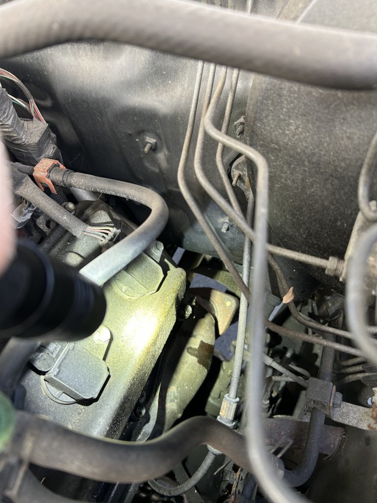

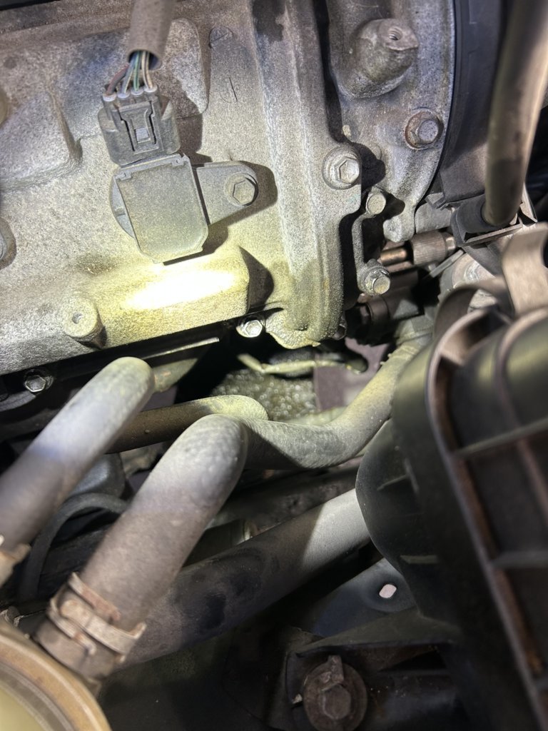

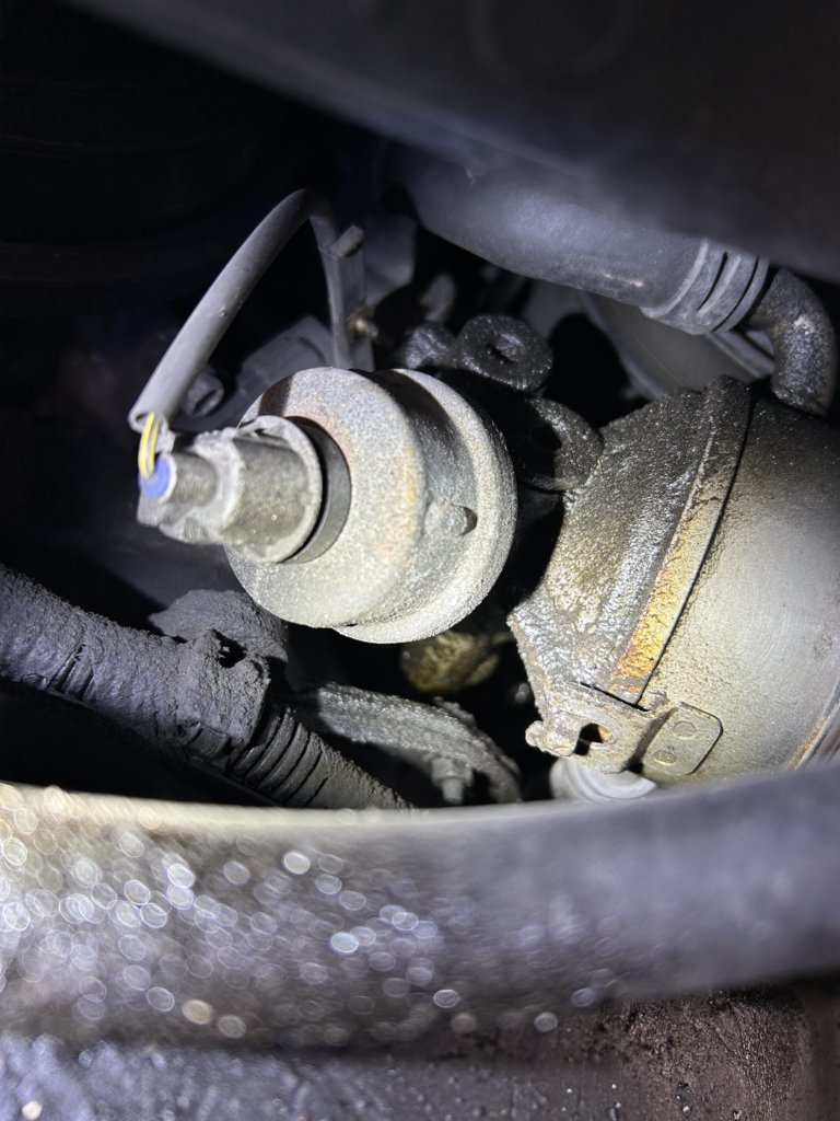

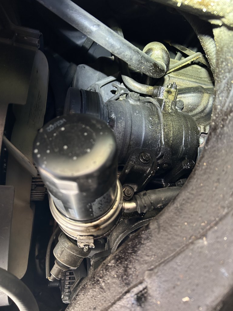

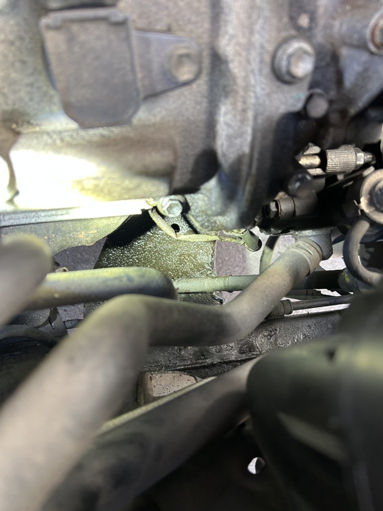

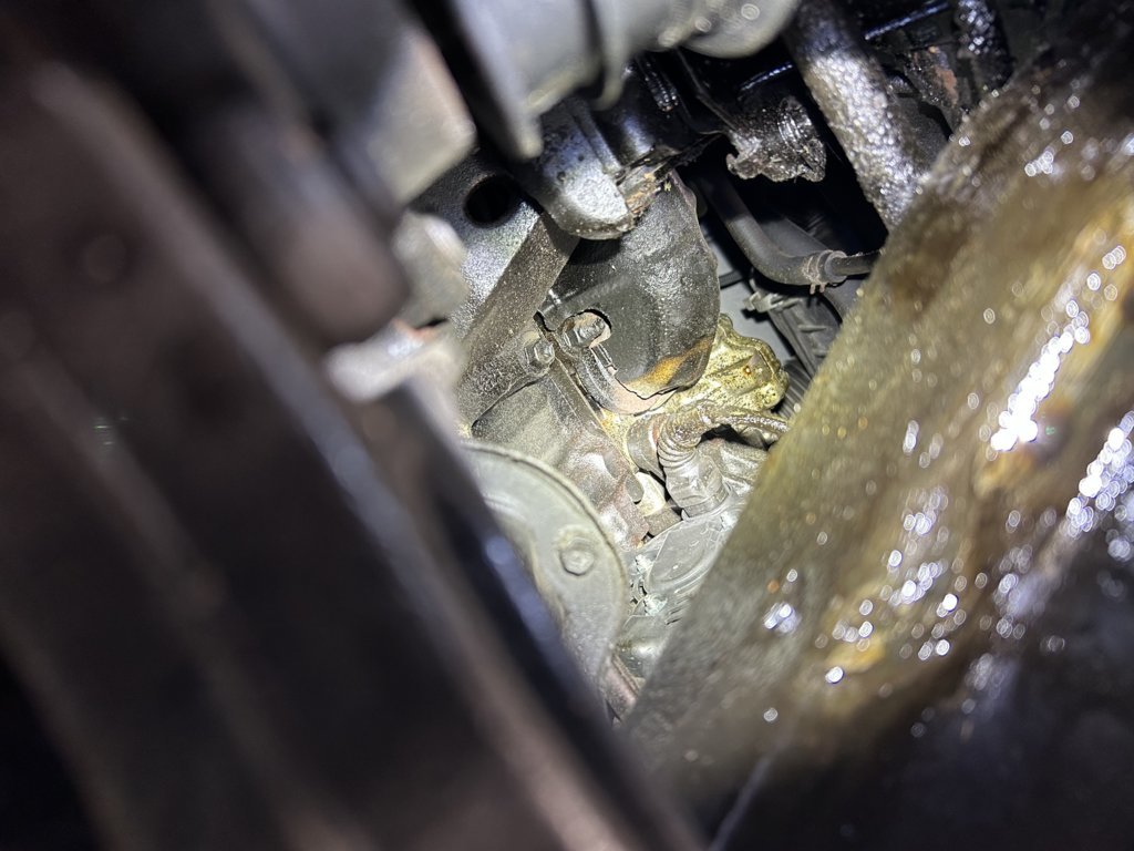

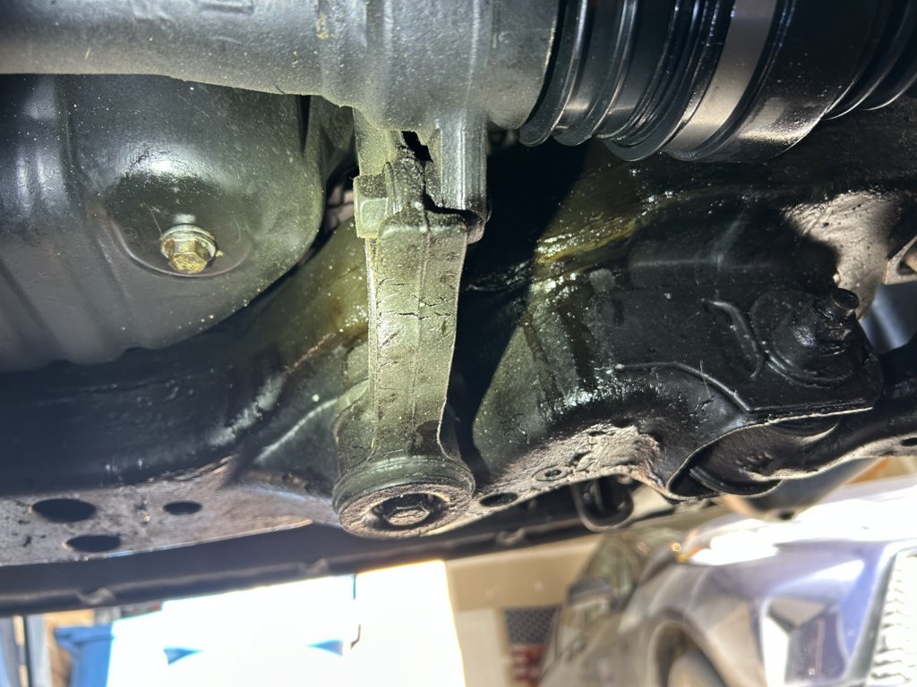

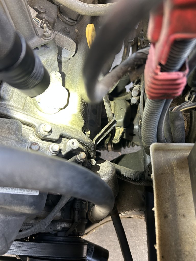

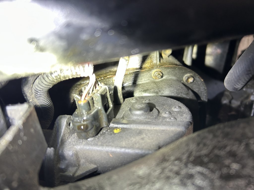

    Ok, got out there for some (heavy) pics.
    My rookie diagnosis: valve cover gasket and/or FIPG failure in the front corners. Oil runs down the oil filler neck or to the "run-off" (?) lip, down to the oil cooler, crossmember and oil pan, runs along oil pan seam and blows backwards while driving wherever it wants. RMS is dry thankfully.
    *keep in mind some of the glisten you might see isnt oil, its the lanolin undercoat I had applied last winter.
    At the oil cooler/filler neck:
    Oil pan, with drips on 4x4 actuator :facepalm::
    looking up at pax side VC:
    Front corner of pax VC, and pooling on crossmember:
    Back of Driver side VC:

  24. Dec 30, 2024 at 1:22 PM
    shifty`
    shifty` Just like witches at black masses
    Jun 20, 2020
    #48239
    28,377
    ATL
    '06 AC Limited V8/4WD
    Yup. Same-same. I was in that same boat, and so is @Dakillacore right now.
    It would seem leaky VC gaskets are pretty notorious on our trucks. On the bright side, if you're not seeing it on the front of the engine, or coming out of the timing covers, it's not the cam seals, and that's something to be happy bout if true.
    Dakillacore likes this.
