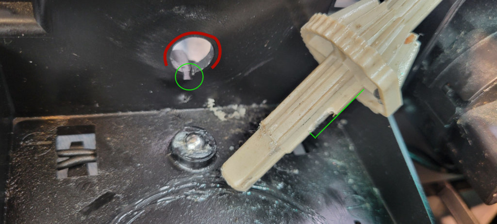

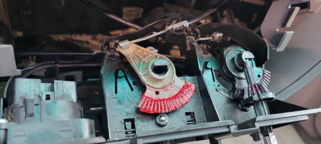

    Shout out to @whodatschrome for these parts for my HVAC controls.:fistbump:
    I had a broken gear lever assembly on the middle temp control mechanism.
    I had not planned to do this job until spring, but it was 48deg up here in the forsaken land of snow today, so I got off my arse and did it.
    A couple tips for dismantling/assembling.
    Remove the cables where they are anchored to the assembly first, then move the entire cable to get the end hooks out of their mounting points.
    Reverse with reassembly, Put the hooks in first, then mount the cables in their anchor points.
    The plastic is somewhat brittle, and I imagine more so for you in southern states, so be gentle.
    Here is a cable mount and how to remove easily.
    Getting the shaft pulled out was a little tricky because you cannot see the keyway on the bottom of the mounting hole that you need to line up with in order to slide the shaft back.
    The tall rib you see (broken on mine) is the only thing that keeps the shaft in, and firmly engaged with the gears by riding on the outside of the hole (RED)
    New gear/lever installed. Reconnected and getting some lube, it's not the space shuttle, so red and tacky will do.
    While all the cables were off I tested them for function by hand. I think my issue was the calibration (position the cable was connected) under the hood on the coolant valve.
    I also had a moment where I felt like maybe the cables weren't hooked up right or something was weird before o_O :anonymous:
    Anyway, all the cables worked quite freely by hand :thumbsup: so that was the green light to move forward.
    Now I have full control of all functions:bananadance:, and maybe a placebo affect, but It feels like I'm getting better heat and better air flow!
    One casualty to report of a tab on the face plate. Next to it is my old JBweld fix that failed. (2nd gen floor mats, free from my neighbor:thumbsup:)
    I still have all 3 pristine cables that @whodatschrome sent me. If any of you are in need of one let me know.

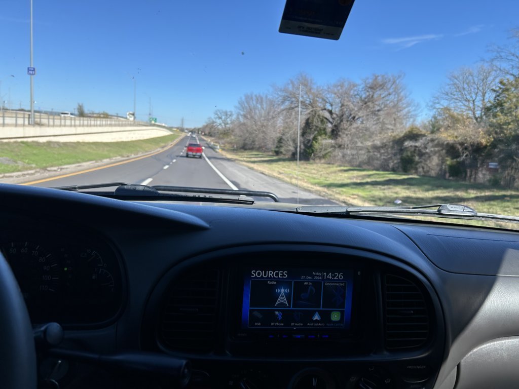

    While I was in that deep I decided to finally install the mic for my head unit. I didn't think I would ever really use it... but while playing Pandora from my phone one day I got a call, the unit answered it, annnnnnd they couldn't hear me... :rofl:
    I had misplaced it and had looked for it on several occasions, but today I found it! Pretty slick :rolleyes: Wife and I tested it out while I was buttoning up.

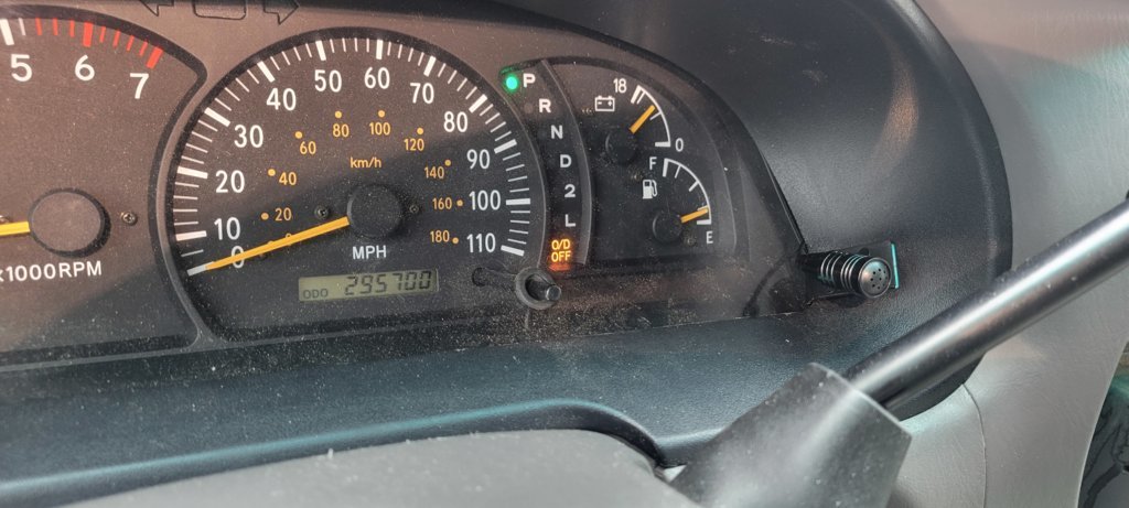

    Creeping up very slowly to 300k;)

    Excellent work. I got a hold of his vent selector gears and lubed up the mechanism by the gas pedal and now I have some operation on that dial, but need a cable to get fully back to normal. The cable is cheap enough I don't mind going new on it.

    What’s the lube of choice for the HVAC console, @BroHon ?
    I had my assembly replaced once under warranty by a Toyota tech and it came out worse than the original but I noticed he used a thick lube paste that was translucent in color.
    I never bothered to asked what was supplied but I know the replacement had less of it than the original assembly. I think it was just for the plastic dial gears in back though.

    I think they would tell you some kind of silicon grease, but the closest I had was Dielectric and it was pretty runny. I need a tube of that rainbow Superlube :D.... or Astroglide!
    I remember seeing astroglide back in 93 or 95 before it was out in the public I think?, at the hospital for one of my girls births :rofl::rolleyes:

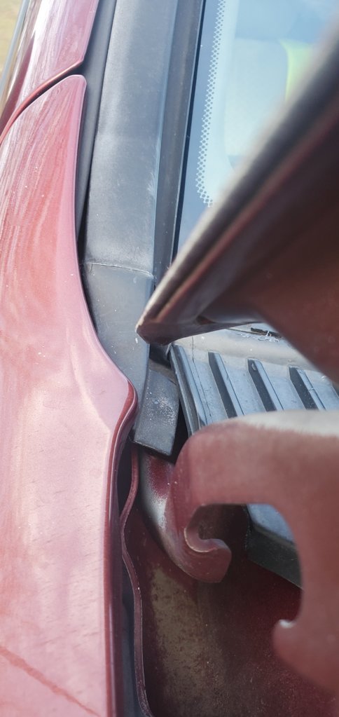

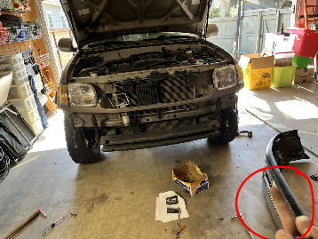

    Thanks for pointing that out. Those rubber pieces that Bubba pointed out are missing on both sides (see photos). So, if you don't have these, I suggest you check down their for debris and apply put some protectant. Hell, if you have them, I'd check because dirt and water has a way of getting into places that you think it can't. I could have grown a garden with that crap in there. The passenger side had more debris than the driver side. I'll have to hit the junk yard to see if I can find these. The Sequoia don't have any provision to stop debris form getting down there.
