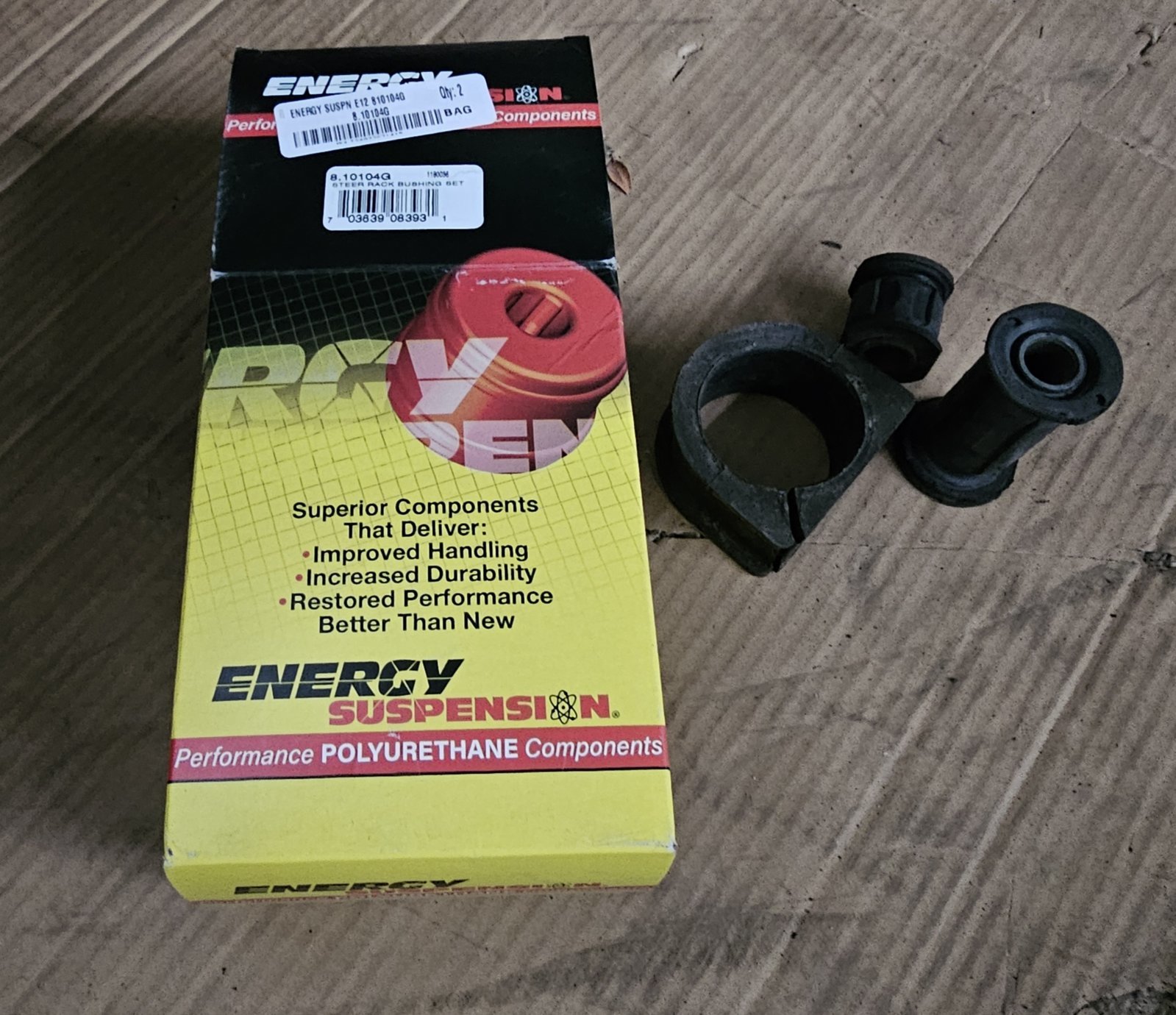

    Installed some steering rack bushings.

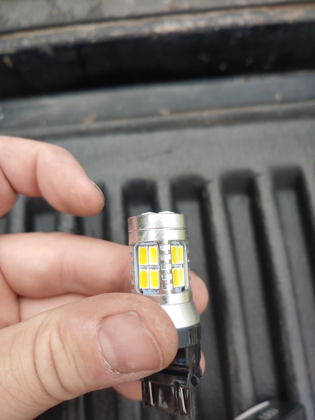

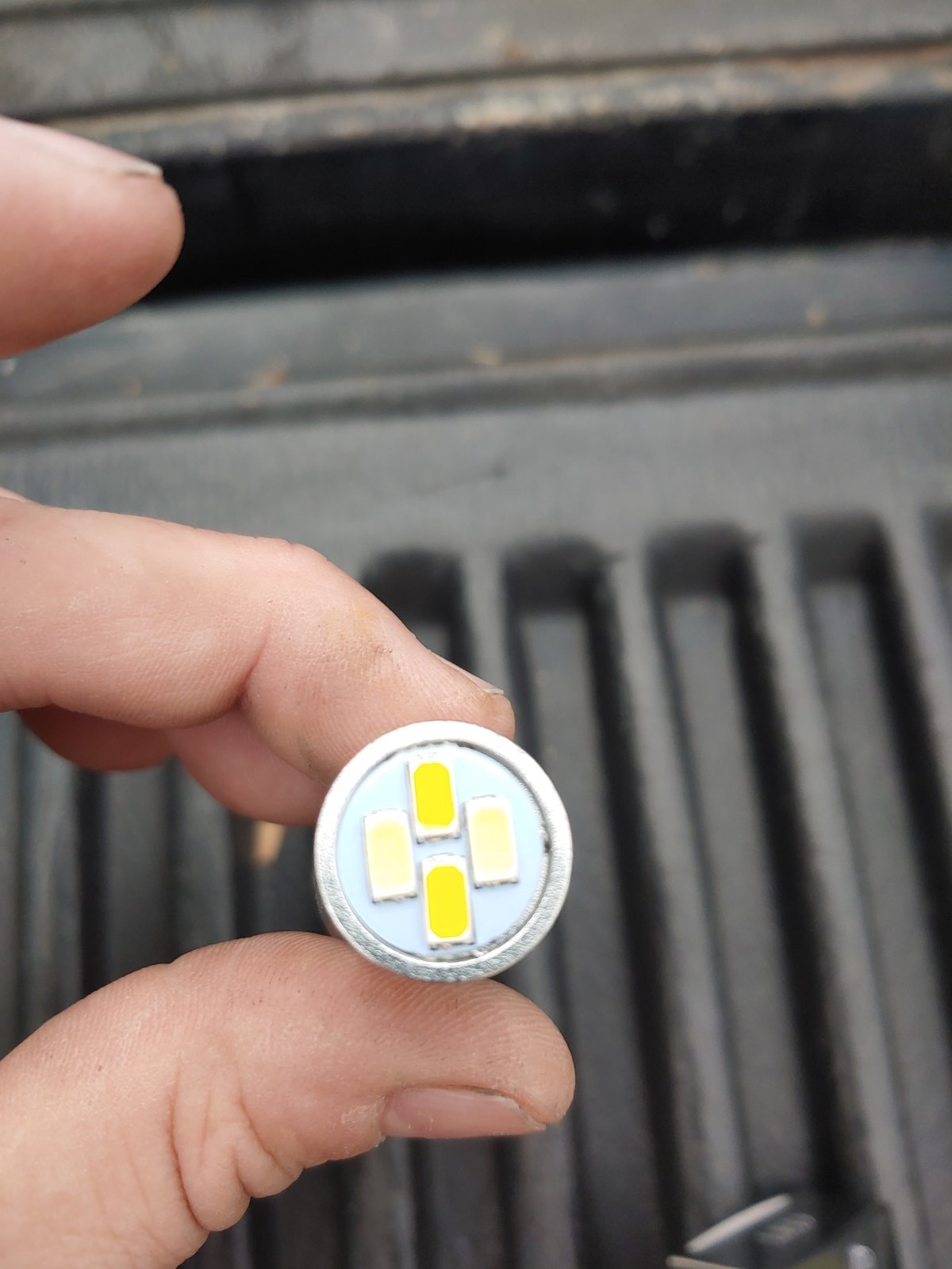

    No problem, I put VLED switch backs in the silver truck. Running light was the same color temp as the headlights, and the turns were amber.
    It was sweet before the deer
