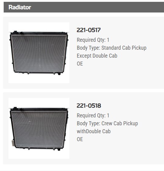

  5. Jul 2, 2025 at 2:45 PM
    shifty`
    shifty` You can call 1 (800) PP5-1-DooDoo
    Jun 20, 2020
    #48239
    31,008
    ATL
    '06 AC Limited V8/4WD
    Dude. The radiator is browning already. Replace it. Get new Denso unit. They're like $125.

  6. Jul 2, 2025 at 2:47 PM
    shifty`
    Jun 20, 2020
    #48239
    31,008
    ATL
    Part numbers, and be careful who you order from to avoid shipping damage. AC/RC is the top one. DC is the bottom one. Avoid scAmazon.

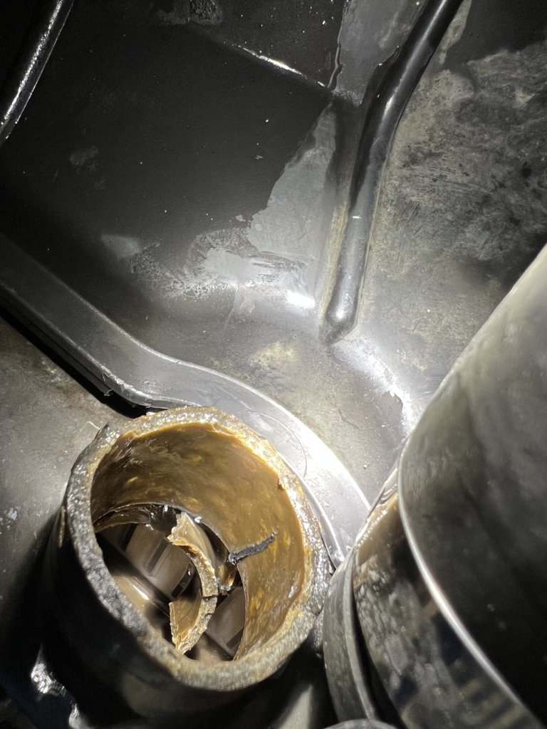

  7. Jul 2, 2025 at 5:42 PM
    455h0le_dachshund

    You mean the diff was leaking juice though, right? Not the CV leaking grease?

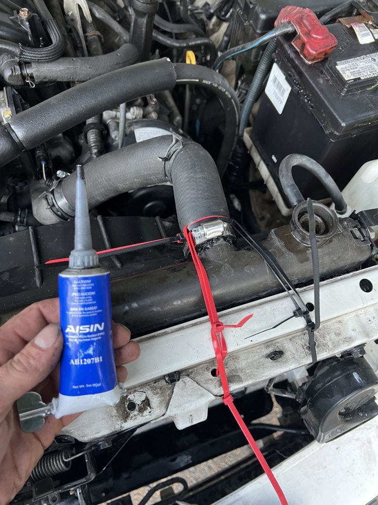

  8. Jul 2, 2025 at 8:02 PM
    Bed Tundy
    Bed Tundy Like changing a tire, the 1st time you're careful
    Mar 6, 2024
    #113153
    206
    Neature Gary
    Moscow, ID
    (W) 2005 AC 4.7 4x4 with VSC, (G)2005 AC 4.7 TRD Sport RWD
    See Signature or my Photo Album
    Thanks, got it ordered from Rock Auto ($165)along with the Asin coolant ($13/gal) for around $240 with shipping. I couldn’t bring myself to spend another $30 a gallon on 3 more Toyota Longlife pink. Think I should replace the upper radiator hose too? RA didn’t have oem so I skipped it
