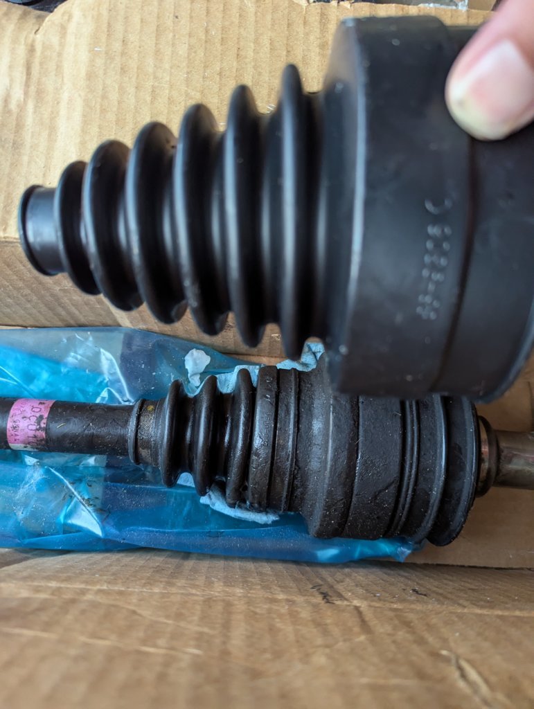

    Just a heads up to anyone looking at an axle debacle in the future... I got OEM remans and the new OEM boots tore within weeks. I was so pissed. So I ended up rebooting the OEM remans (surprisingly easy and not too messy if prepared in advance) with the Porsche non-neoprene boots recommended by Kartek, and they've been awesome. Here's my post on the matter with pics and some basic tips I learned along the way: https://www.tundras.com/threads/200...pic-heavy-little-ot.75017/page-7#post-3057086

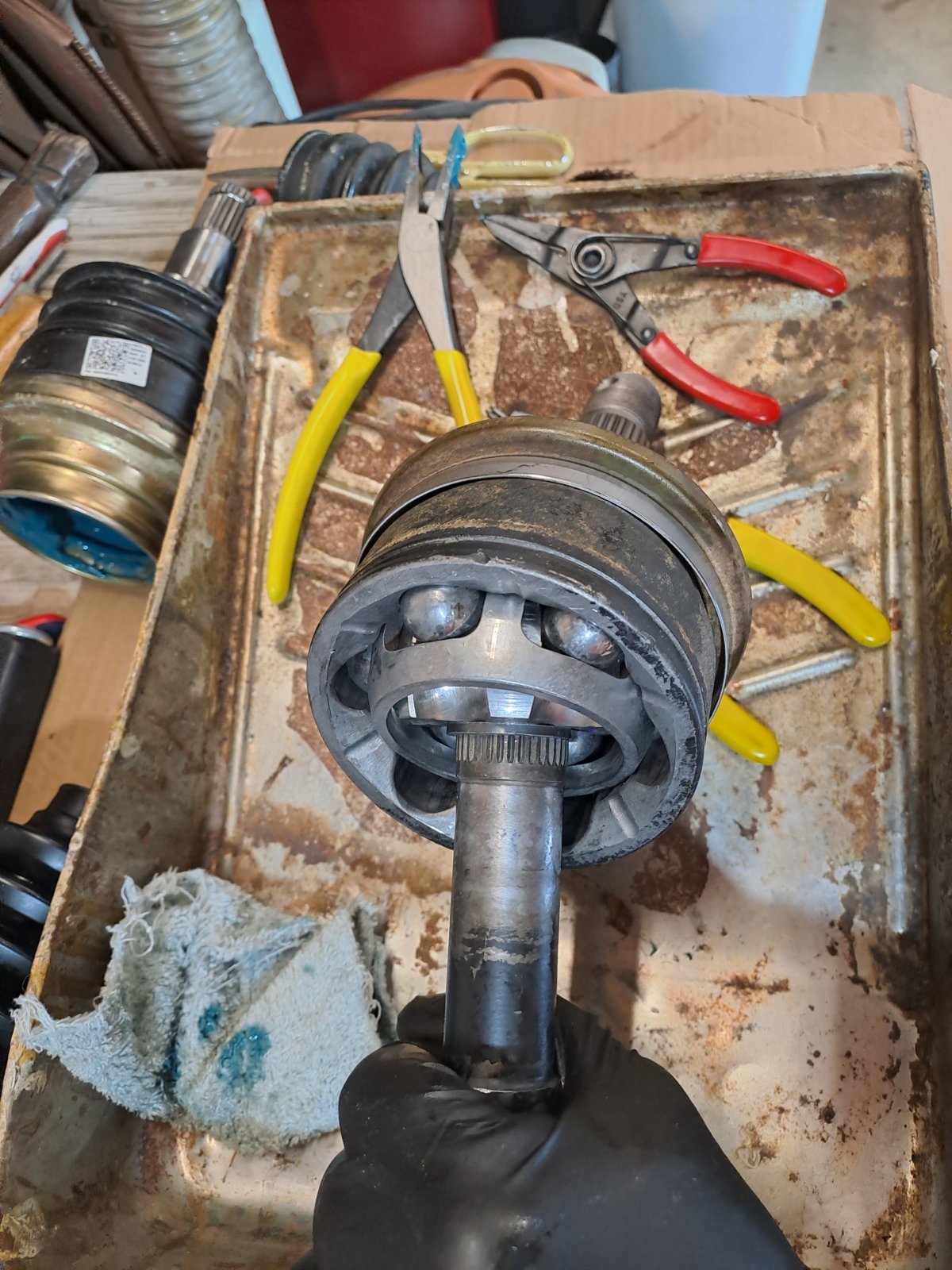

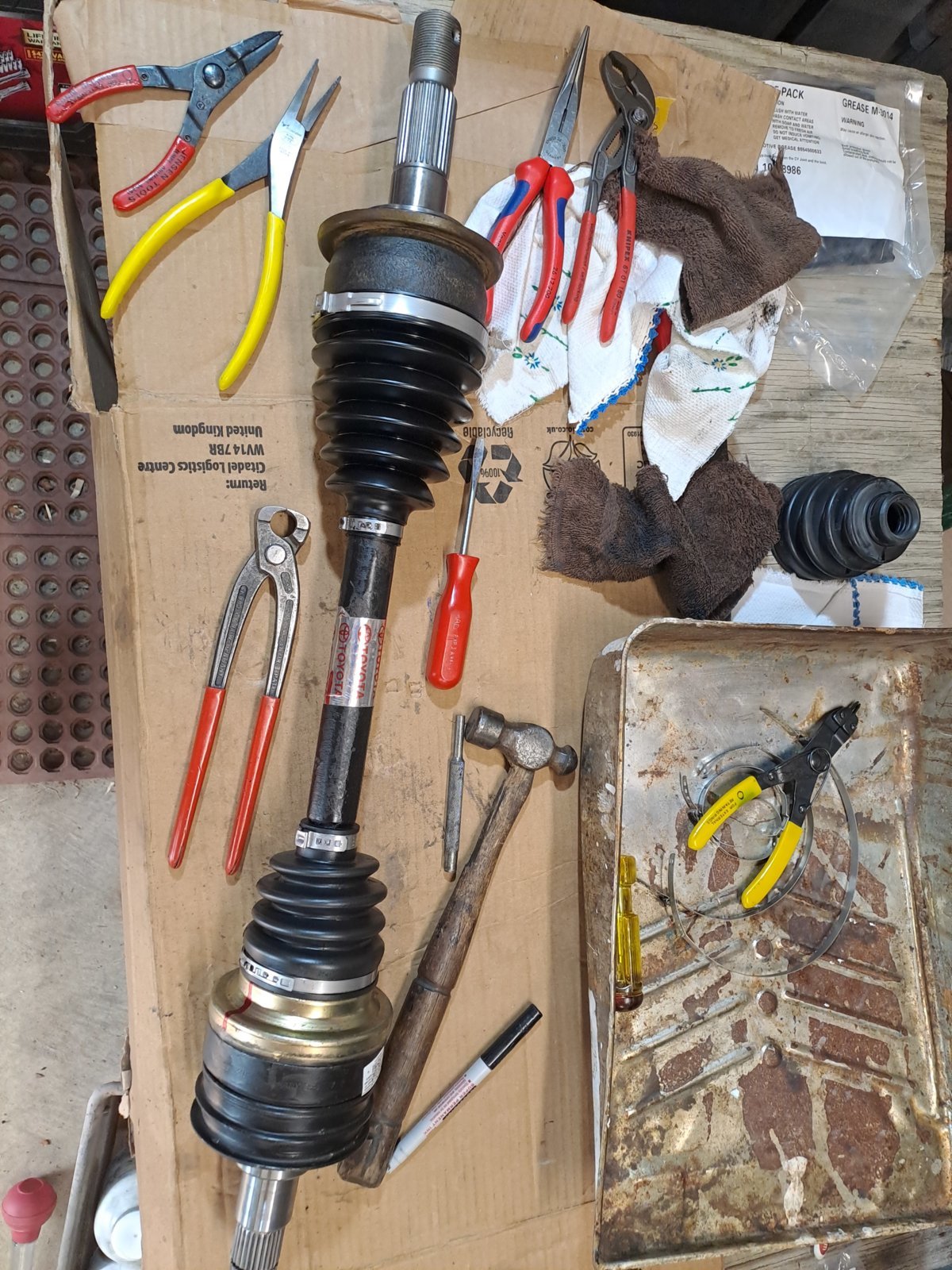

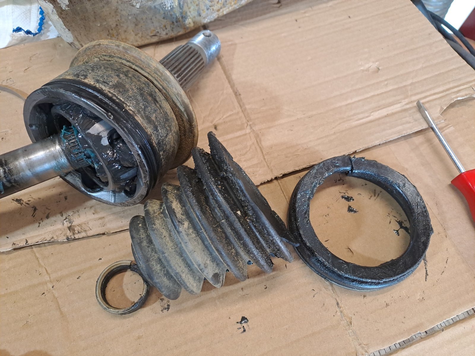

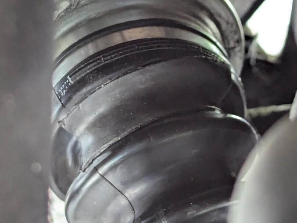

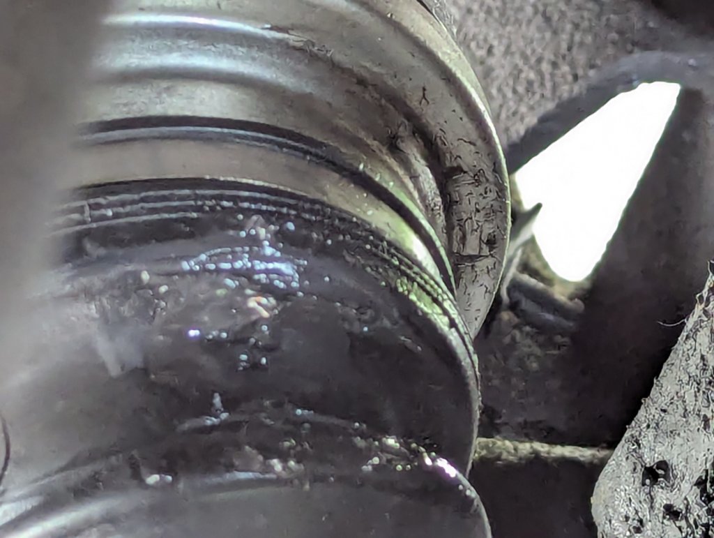

    Like user 912, I had a boot crack on a recent Toyota remanufactured shaft, on my 2005 RC. The shaft was replaced May 2023, and during an oil change recently I noticed the driver side outer boot was cracked all the way around. The grease was still fairly clean inside, and I live on a dirt road, so I guess I got lucky and caught it early before major damage was done.
    My local dealer told me they could not get a new shaft or a reman - they are discontinued. So I purchased a Toyota boot kit (04438-0C020). My local dealer wanted MSRP plus 30%, plus a week for delivery, I ordered it online for MSRP minus 20% and it showed up four days later.
    This was actually the easiest CV axle I've ever replaced - just unbolt the LBJ and the axle comes right out. But that's when the ugly part of the job started. Notice the 3-piece boot. I wonder if Toyota got a bad batch of boots.
    Cleaning all the old grease out of the outer joint wasn't too bad; I used a paintbrush and mineral spirits in a paint tray to get 95% of it out, lots of flushes (turkey baster!) and working the joint around, then a few sprays of carb cleaner and some compressed air and it was nice and clean.
    The messy part was removing the inner boot and pulling off the inner joint. It took a few tries to get that circlip spread; when you can't see what you're doing because of all the grease it adds a little frustration. But eventually I got it apart and slapped a new outer boot on. I decided to reuse the old inner boot as it was still fine and the joint was well-greased. The rebuild kit included a mix of clamps inclucing one low-profile Oetiker clamp. I don't have the special pliers for those but managed to improvise. It didn't seem very tight - I'll keep an eye on it and replace it if needed. Also, the kit included small clamps of 33.7 and 38.1 mm. It turned out I needed two of the smaller size, so I ended up reusing one of the old clamps. I had removed it carefully, so I think it'll work, but I'll need to keep an eye on it for sure.
