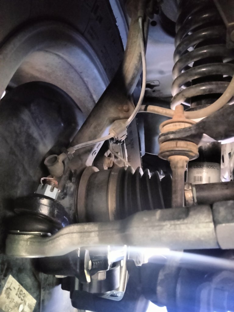

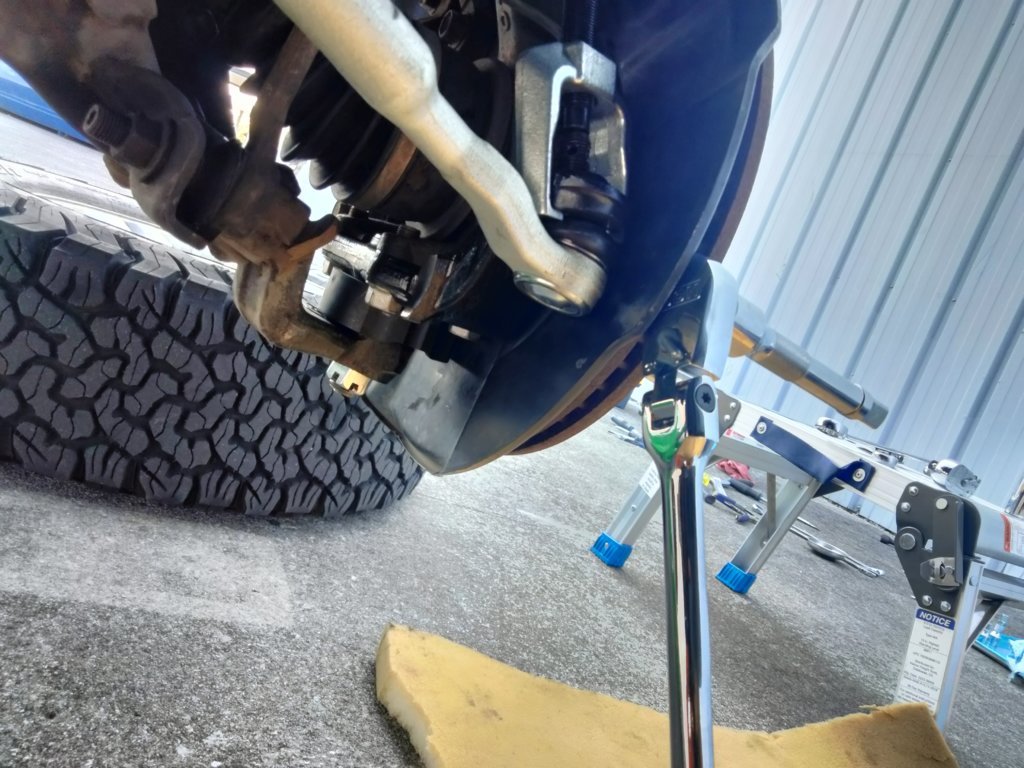

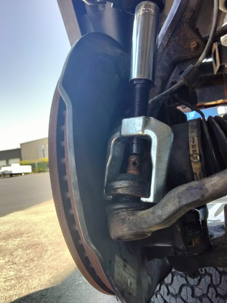

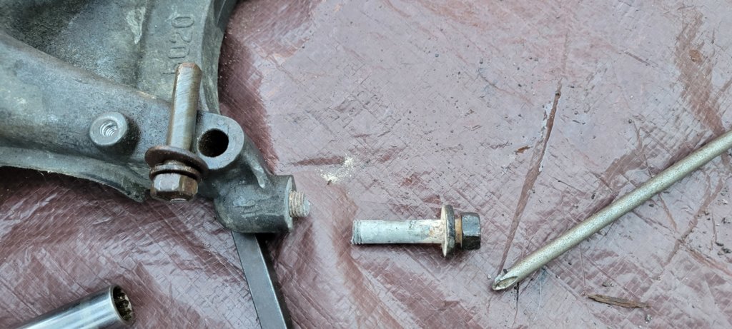

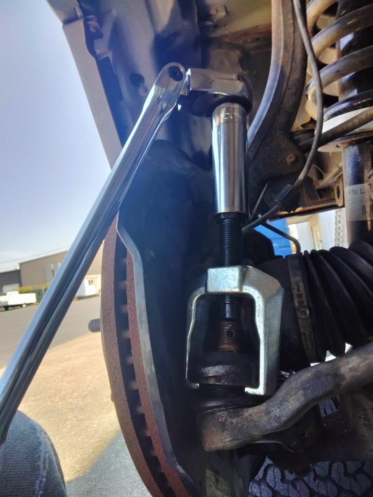

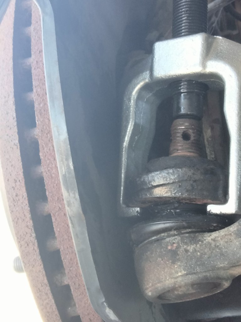

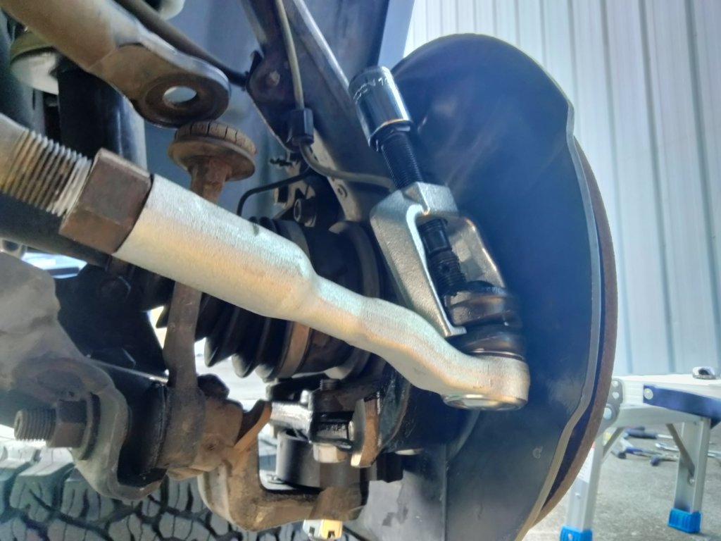

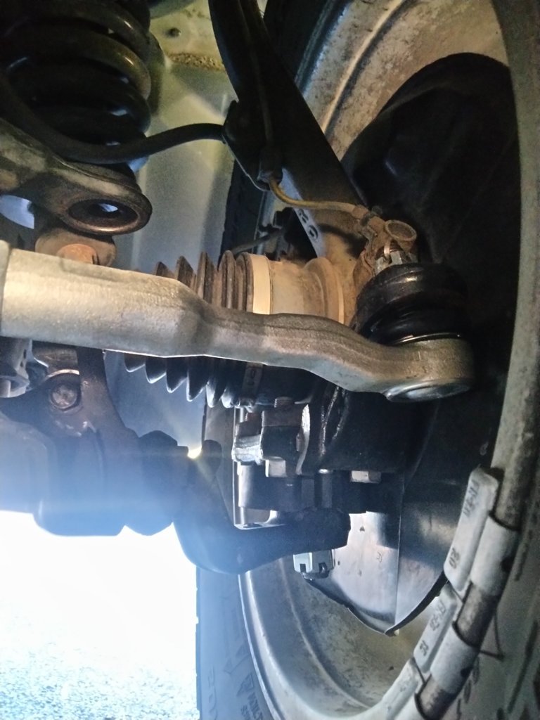

    I'm running behind on my contributions to the board. Maybe some day I will start a new thread from the perspective of a DIY cheechako wrenching on a frugal budget. Till then, here are a few tidbits from my suspension work in late Aug that included OEM LBJs and OTRs along with Sankei 555 ITRs referenced here: https://www.tundras.com/threads/wha...-gen-tundra-today.2558/page-2165#post-3731663.
    I used the PowerBuilt front end service kit from Advance Auto as a loaner tool for OTR and LBJ removal.
    I really wanted to use all the tools in the kit and report back. Many posts had recommended the small Pittman arm tool (#5 in the tool case) for the OTR removal and I think it was either @Jack McCarthy or @jerryallday that really favors the tie rod end lifter (#2), along with the Toyota Maintenance guy for the OTRs. TM guy also likes the 2-jaw puller for LBJs.
    Due to time constraints, I was only able to use 2 of the kit tools - the small Pittman Arm puller (#5) for OTRs and the larger Pittman puller (#6) for the LBJs.
    Here are some pics of the set-up used for OTR removal.
    I installed the OEM LBJs and OTRs one day, reattached the tie rod ends using thread counts and positions marked with paint pen, and threw the tires on. The pre-project photos were a big help as a reference point for returning the tie rod ends to their original position. Then drove home in a silky smooth ride while running out of daylight. The next day I detached the new OEM OTRs. Removed the old ITRs using the AutoZone loaner Inner Tie Rod Removal tool, moly- greased the steering shaft while extended, and installed the new Sankei 555 ITRs.
    Finished project...no damage done.
    I know...the sway bar is part of the next project...discovered during this one.

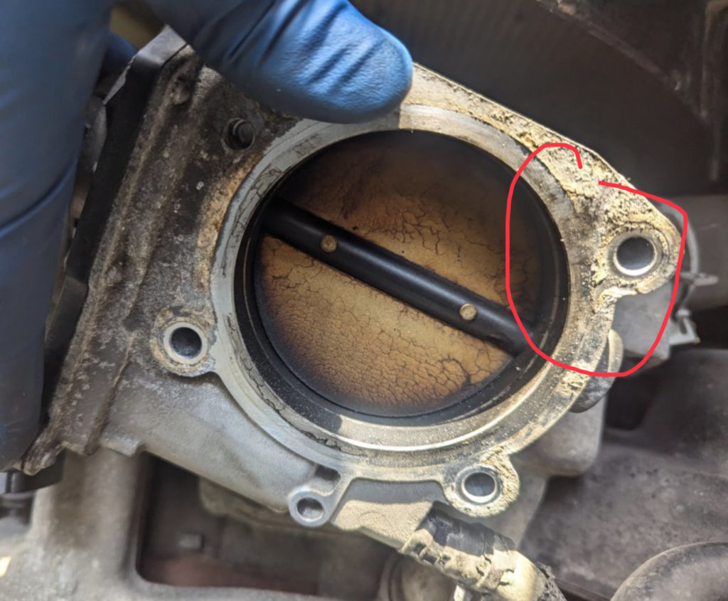

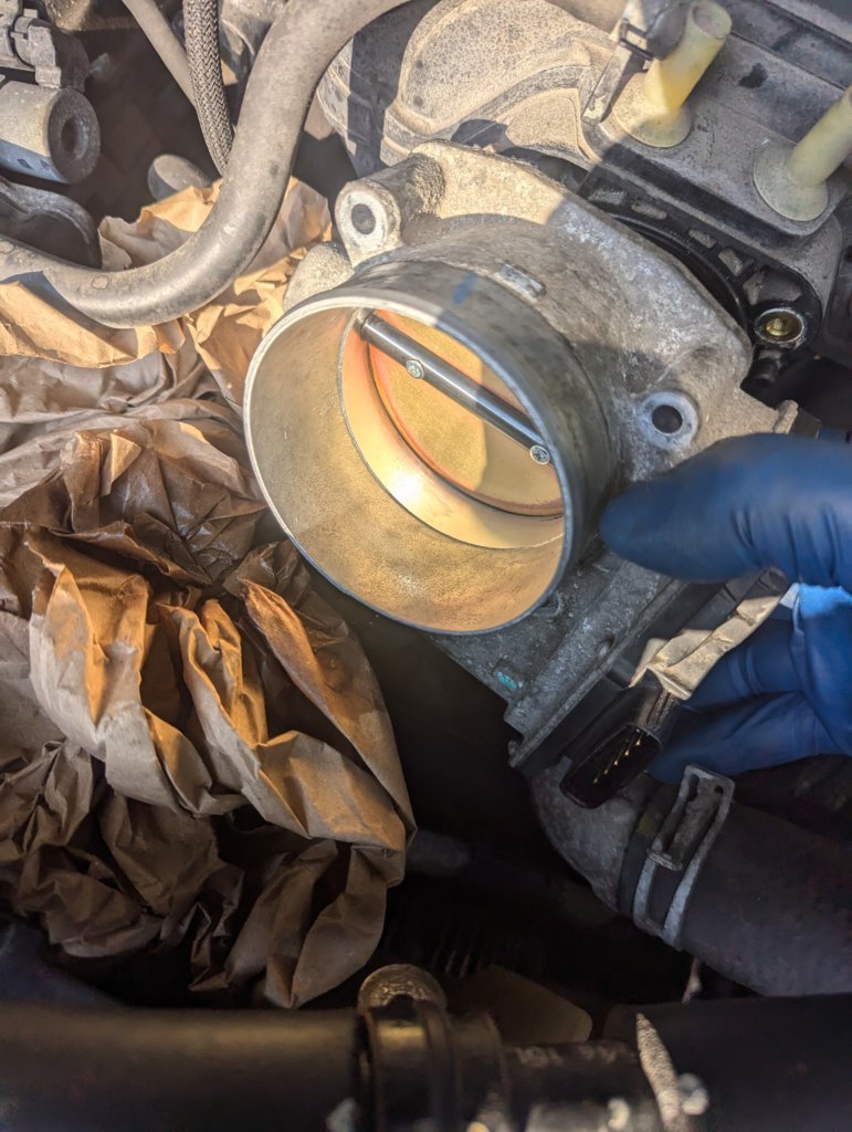

    Nice work. I wonder if you had a leak at that not tight nut? Might have helped with the idle too.

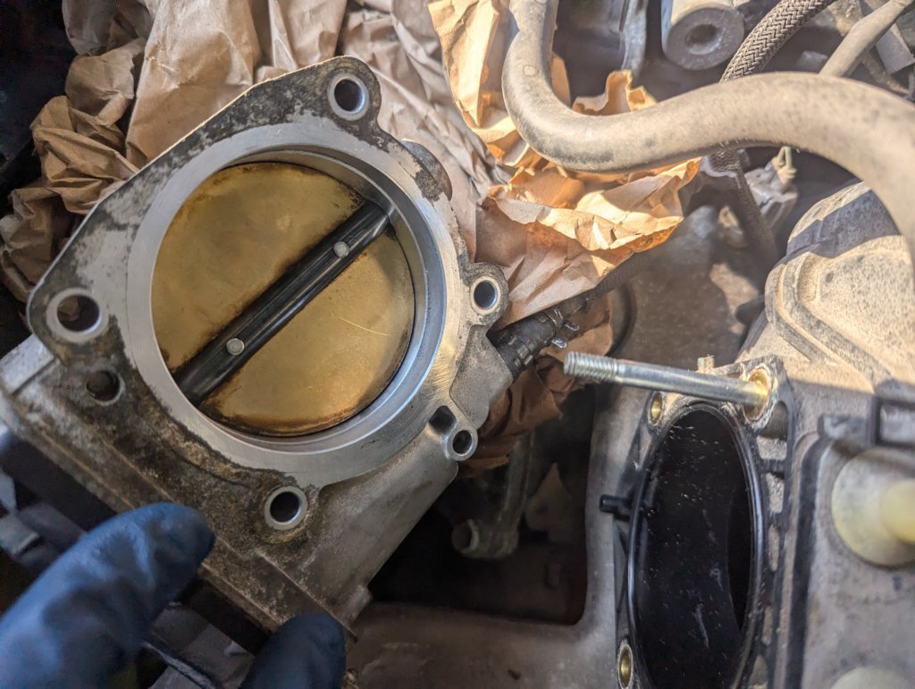

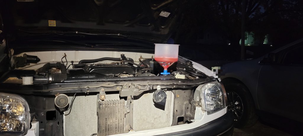

    Replaced the wobbling fan bracket. No AC/condenser really has made going in deep like this (pulling rad) quite a bit easier. Considering my amature status, and "Pure Michigan" rusty truck, 4hrs wasn't too bad in my mind. Two bolts were sacrificed to the salt gods. A good hour was spent on those two with heat, pounding, and working them back and forth to no avail. One of them I'm just not fishing out, period. If 7 bolts won't hold that little bracket, 8 never would have :cool:. Got dark on me but I wrapped her upand got ALL the coolant back in (about a pint left that went into the reservoir). Only thing I want to do is burp it on a hill so I get my heater core purged of any air... max heat performance. Went in raw dog and didn't study or watch any vids like I usually do. Knowing this truck pretty good pays some dividends. Only unexpected curve ball was having to remove the small lower support bracket on the AC pump for acces to one of the two side/horizontal bolts. All in all I'll take the win with this repair.
    TB looked fine, but will get done in 25. Forgot to route the crank and oil sensor wires hahaha, only about a 5 minute setback to fish them down through, NP.

    Good eye. I didn't sand that surface to remove corrosion for a better seal but I probably should have. Maybe I'll do it when I'm doing the timing belt

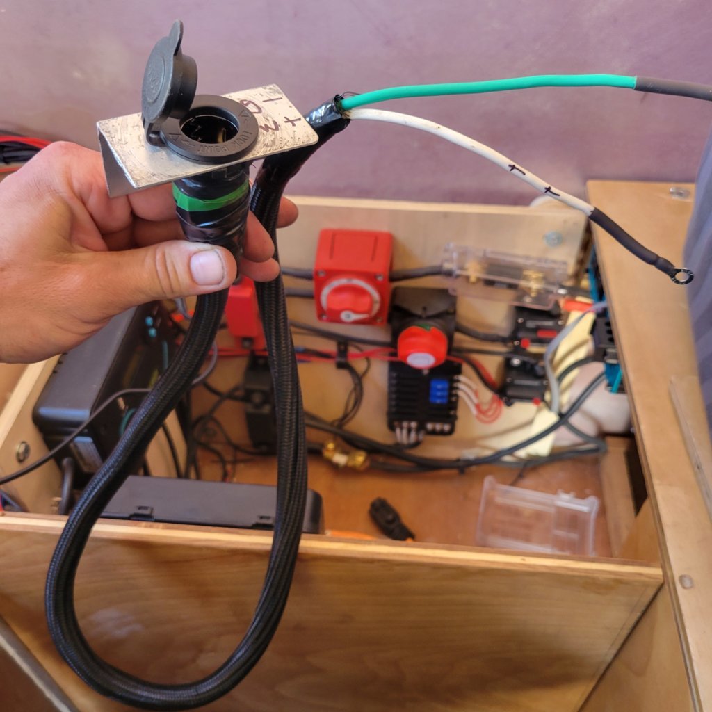

    Last minute MERUS prep
    Temp fridge tie down location and cut my yoga mat flooring to fit
    Temp 12v socket with the wrong color wire :rofl:
    I guess this drawer might be handy after all

    If the wire is wrong color put a piece of tape around it in the correct color(s).

    I used a tie rod puller. It pulled the tie rod well, but also bent it. More than likely was user error.
