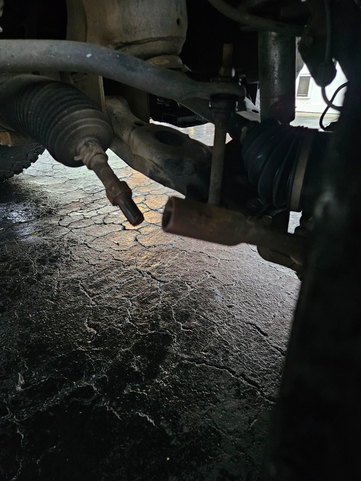

    Been away for a while for no reason in particular but I had a Tundra related incident so here I am, ready to share. It's a strange failure for sure. I was backing out of my driveway onto our neighborhood street when I heard a pop and lost most of my steering ability. My first thought was LBJ failure so I put it in park and jumped out to survey the damage.
    Well, it wasn't LBJ but the inner and outer tie rods separated.
    Has anyone ever seen this happen?
    I figured out what failed in my case. I've had play in the inner tie rod ball joint for a few years. It never seemed to get worse whenever I would check, just a slight wobble when I'd push on the wheel side to side. But it has prevented me from getting an alignment for years.
    Well I believe that small amount of play over the years fatigued the threads between the inner and outer rods to the point that today under stress of backing up with the wheel turned sharp hitting the bump where my drive transitions to the street was enough to cause complete separation.
    I was surprisingly able to force it back in my driveway with only 1 wheel steering on the slippery wet asphalt thanks to rain overnight.
    I already had the inner tie rod on standby in the garage but I had to borrow my wife's car and pickup a new outer tie rod, bellows and clamp. Got it reassembled and adjusted to the same alignment as the old pair and it drives just the same as it did prior to failure. But at least now I can go get an alignment.

    I went over the weekend to a junkyard and snagged 2 outer tie rods just to have in case i ever break one on the trail. Just thought id share since you brought up your tie rod breaking, haha

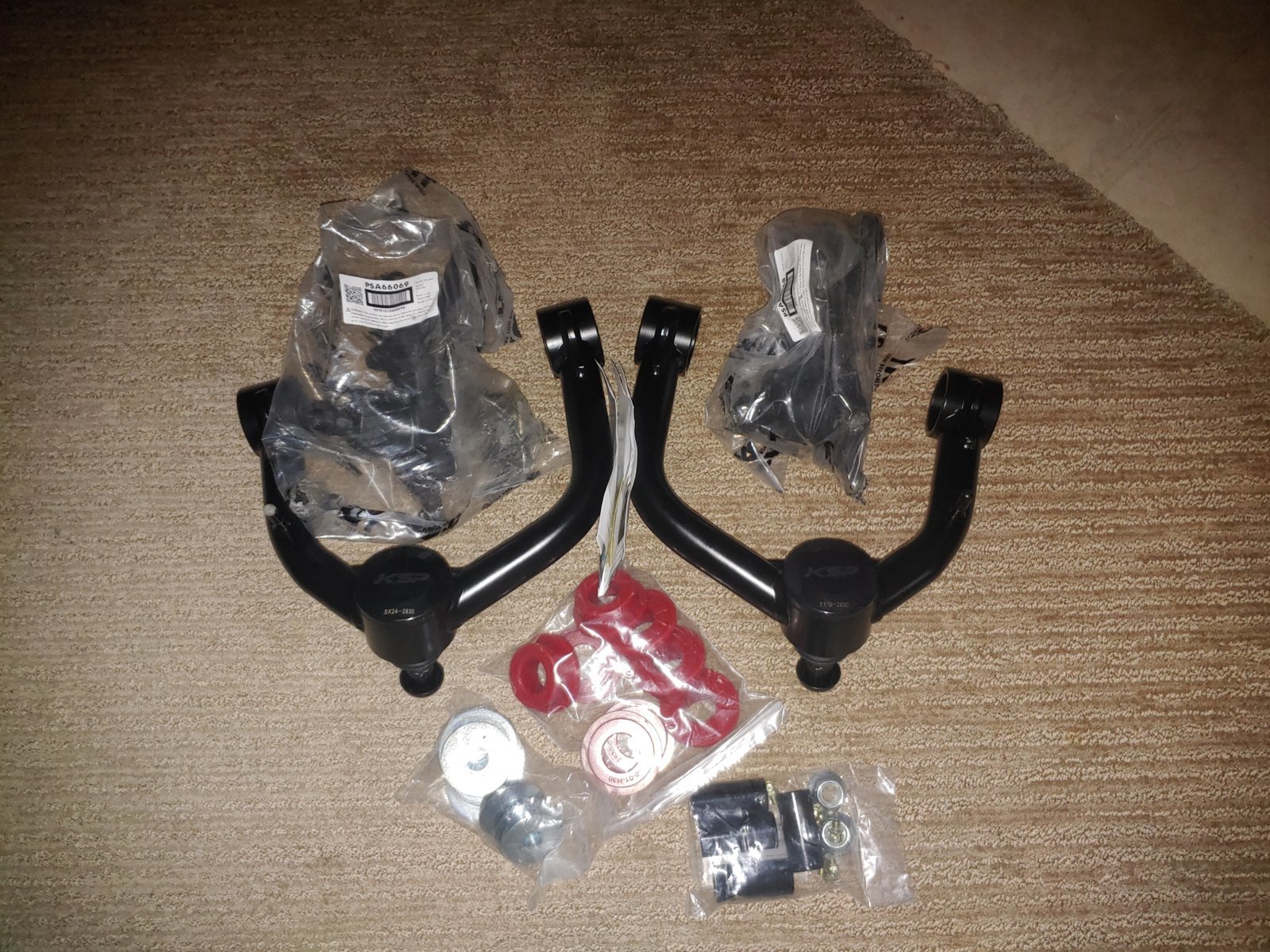

    THEY CAME!! My UPS guy caught me as I was walking out the door for work. Of course i opened them and did and "inspect"....... Ehich clearly wasnt for this thread.....
  26. Jan 24, 2024 at 12:50 PM
    VR6T
    VR6T In fealty to the God-Emperor I serve the Imperium
    Jan 29, 2022
    #73879
    1,962
    Texan.... Big suprise
    00 Tundra Limited 2WD AC
    OEM+, 6+1 bastard pack, 4.08 swapped rear end, custom spring shackles, 3 inch flat lift. This list will grow
    Damn thsts a good one
