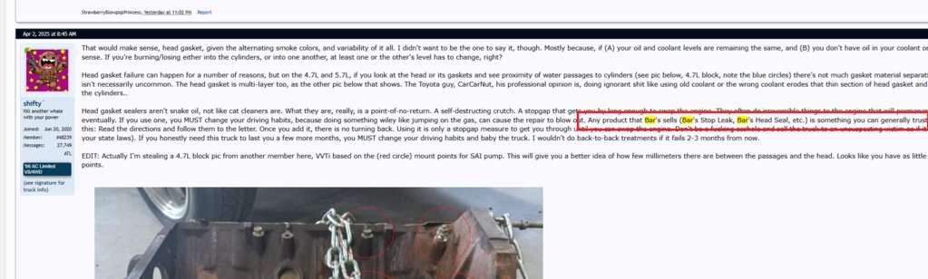

    It's not about MPG. The upstream sensors aren't some gov't conspiracy brought upon by treehuggers, they serve a legitimate function, they read the output of the fuel+air+spark explosions in your cylinders to inform the ECU to know whether the truck is running rich or lean. The ECU uses that info to auto-adjust for best operation. Thinking about that from the bigger perspective that means:
    • You eat less gas, better MPG
    • You don't run rich or dry lean, which extends the life and improves operation of your plugs
    • You don't idle out of whack
    • Optimal acceleration
    • No weird exhaust or fuel smells
    • Reduction of engine wear
    Granted, there's definitely an argument to be made for cats and downstream sensors being a bit tree-huggy, especially on the small-scale output our passenger cars and trucks put out (versus what the shipping/freight industry vehicles output annually).
    Yes. Replacing the O2 sensors with a genuine OEM/Denso "Exact fit" sensors (not "universal", you should NEVER cut an O2 sensor harnesses to install a new sensor), and leave the negative battery cable disconnected for at least 10 minutes either during or after install, before you start up, so the computer has to re-learn the new sensors.
    While you're in there, and since you need to do this anyway... I'd recommend you take time to do the following:
    • Go to the parts store, buy a can of Throttle Body Cleaner, and a can of MAF Sensor Cleaner; I prefer CRC brand, they make quality chemicals
    • Pop the lid off your air filter housing; lift the air filter fully out of the housing, inspect it top and bottom for cleanliness, debris, signs of rodents.
    • Pop the MAF out; spray the shit out of it with the MAF cleaner, inside, out, especially letting the jet blast across the thick wire and sensor up inside. DO NOT use anything except MAF cleaner. Spray at least half the can into it. It will be cold as shit; let it sit out for 10-20 mins before reinstall to avoid condensation buildup which can result in weird operation. NEVER use anything except 'MAF sensor cleaner' specifically for this task.
    • Pop the intake tube off the throttle body. Get a clean shop towel, spray the Throttle Body cleaner into it, then wipe any black sooty stuff you see out of the throttle body. Push in the throttle body plate to get the ridge of soot that sometimes builds up top and bottom but DO NOT let the plate slam shut. NEVER spray cleaner directly into the throttle body. NEVER use anything except 'throttle body cleaner' specifically for this task.
    • If you need videos of the above, I can dig up prior posts where I linked them. The above steps should be part of a larger maintenance on your truck. Maybe earmark it for every 25k miles?
    And, I think this is something you need to hear: Any time you touch anything related to air intake, air/fuel mixture, anything related to spark (plugs, coils), or change sensors related to fuel/air/spark, you should ALWAYS disconnect the negative battery cable for at least 10 minutes to force the ECU into re-learn mode. Super important.
    Furthermore, if you ever need to force your vehicle into re-learn mode, you really should check the throttle body cleanliness prior, or just proactively clean the MAF and throttle body while it's disconnected. If I had a dollar for every time I've seen someone come in here with their truck dying or idling like shit after changing a dead battery, only to find the throttle body was gunky as hell, lunch would be on the forum today.
