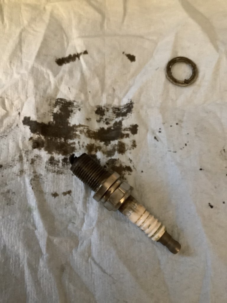

    Also, the spark plug from cylinder 3 was covered in oil, on the screw side. What does that indicate? Picture below

    That is oil on that plug yes. That plug also was so worn down the ring thing ….uhhh, WASHER (sorry I’m still learning) came off it

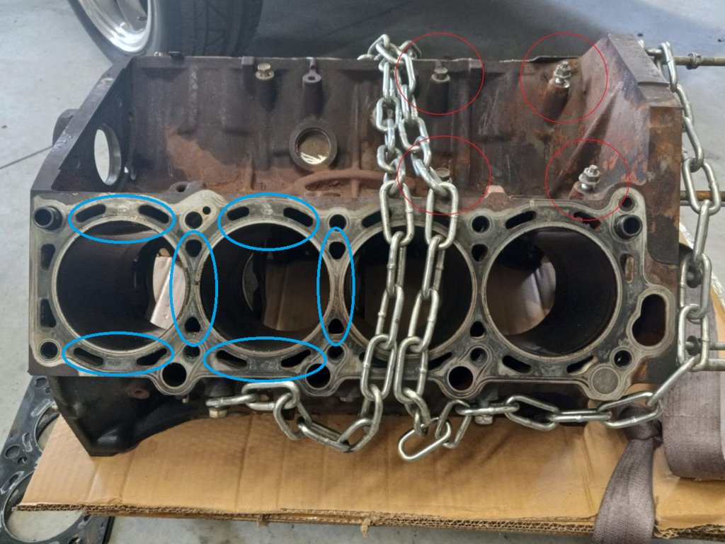

    That would make sense, head gasket, given the alternating smoke colors, and variability of it all. I didn't want to be the one to say it, though. Mostly because, if (A) your oil and coolant levels are remaining the same, and (B) you don't have oil in your coolant or milky oil, head gasket doesn't make a ton of sense. If you're burning/losing either into the cylinders, or into one another, at least one or the other's level has to change, right?
    Head gasket failure can happen for a number of reasons, but on the 4.7L and 5.7L, if you look at the head or its gaskets and see proximity of water passages to cylinders (see pic below, 4.7L block, note the blue circles) there's not much gasket material separating coolant/lubricant from the cylinder, which isn't necessarily uncommon. The head gasket is multi-layer too, as the other pic below that shows. The Toyota guy, CarCarNut, his professional opinion is, doing ignorant shit like using old coolant or the wrong coolant erodes that thin section of head gasket and the rest is history, you've got stuff leaking into the cylinders..
    Head gasket sealers aren't snake oil, not like cat cleaners are. What they are, really, is a point-of-no-return. A self-destructing crutch. A stopgap that gets you by long enough to swap the engine. They often do irreversible things to the engine that will permanently affect it (at best) and ultimately kill it eventually. If you use one, you MUST change your driving habits, because doing something wiley like jumping on the gas, can cause the repair to blow out. Any product that Bar's sells (Bar's Stop Leak, Bar's Head Seal, etc.) is something you can generally trust, but the main thing I'd impart upon you is this: Read the directions and follow them to the letter. Once you add it, there is no turning back. Using it is only a stopgap measure to get you through until you can swap the engine. Don't be a fucking asshole and sell the truck to an unsuspecting victim as if it's OK (you may be legally liable depending on your state laws). If you honestly need this truck to last you a few more months, you MUST change your driving habits and baby the truck. I wouldn't do back-to-back treatments if it fails 2-3 months from now.
    EDIT: Actually I'm stealing a 4.7L block pic from another member here, VVTi based on the (red circle) mount points for SAI pump. This will give you a better idea of how few millimeters there are between the passages and the head. Looks like you have as little as 3mm of gasket separating you at some points.
