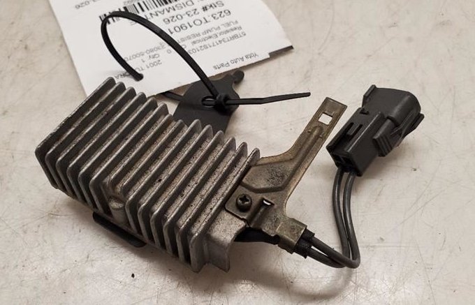

    Any chance it could be the fuel pump resistor?

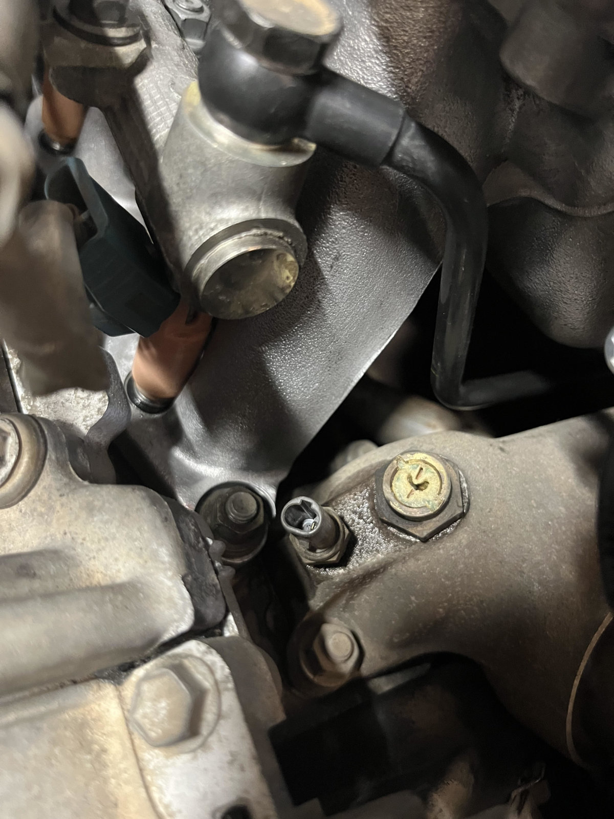

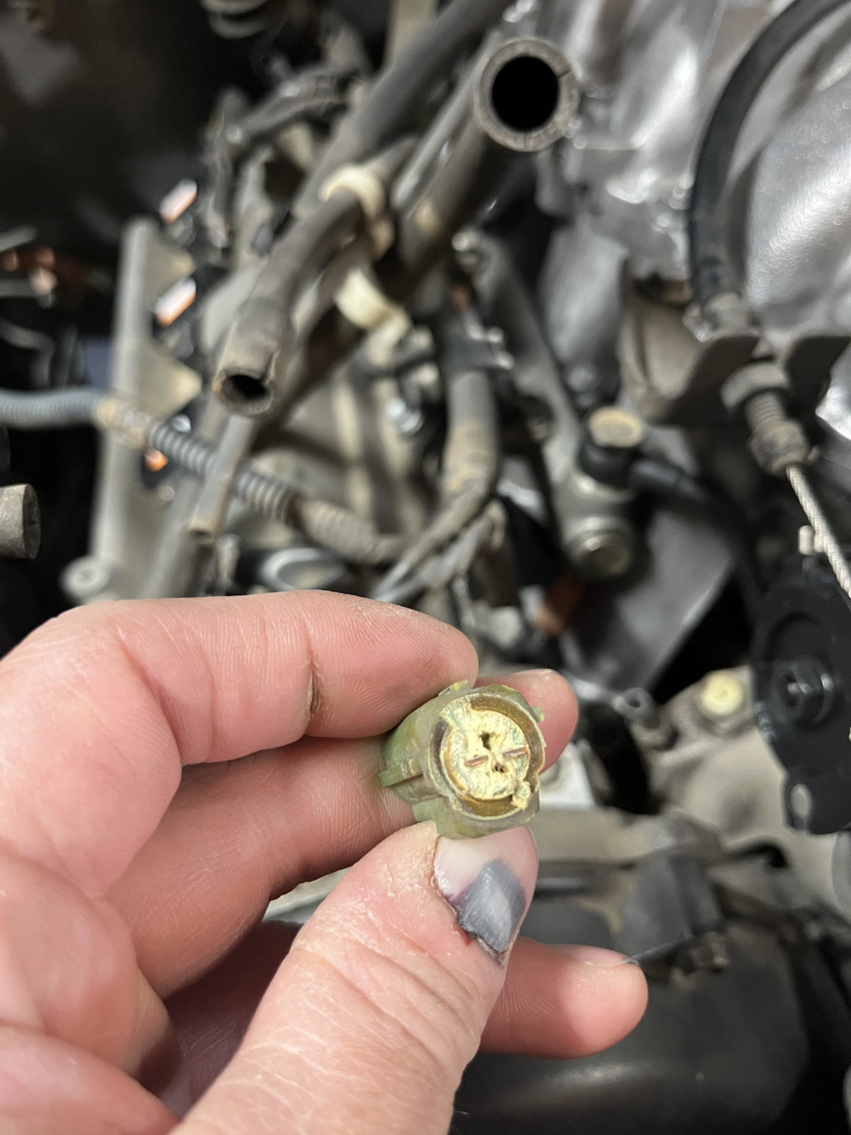

    So I went to get the battery tested. Test came back that battery is fully charged and cranking amps match what is listed on the battery. Was close to the dealership and they said they had a coolant temperature sensor in stock, so went by to get one since it's probably never been replaced anyway.
    When I tried taking off the sensor, coolant started leaking (which I expected but just wanted to test, and now I need to drain it a little) so I tightened it down again. When re-tightening it to stop the coolant from seeping out, the connector twisted off the sensor and this is what the internals look like. I'm assuming this is bad...

    I would definitely say it's not good. :rofl:
    That should be the green one, which is what feeds the ECM - the one to the left of it feeds the gauge cluster on the non-VVTi 4.7L like you've got.
    One guy on here a long time ago reported when he failed to hook his back up after timing belt swap, the truck wouldn't start. Wouldn't even turn over. So, since it's already fucked, may as well put in the new one and see if it turns over. If so ... lesson learned!
    If that does solve it, let us know. I know I've seen this info once on here, maybe twice. Would be nice to have another confirmation.

    Yeah, I can't tell if it's some sort of corrosion or if it's just the plastic from the mold when it was created that has slowly dried up. Good news is I have a new one to put in.
    Good lesson learned about using a socket on that sensor, too. Don't use a socket because the connector sticks past the actual flat parts of the nut. I used an open ended wrench to put the new one on.
    Started up fine when warm. Going to wait for the engine to cool down all the way and then start it up again and see if that fixed the issue. Fingers crossed.

    I took the resistor off to test the ohms with a Klein MM that I have. The 2M, 200k, 20k and 2k settings all seemed to big and yielded no results, so I set the MM at the 200 mark. The leads themselves have an ohms reading of 0.2-0.3 and the actual resistor has a ohms reading of 0.9 - 1.0. So Minus the 0.2 of the leads, the resistor should have an ohms reading of 0.7 - 0.8, which is in spec, based on the test procedure from the manual I found here:
    https://www.tundras.com/threads/2006-double-cab-fuel-pump-no-power.36822/
    Unless I'm a total idiot and didn't do the readings right, I think the resistor is fine.

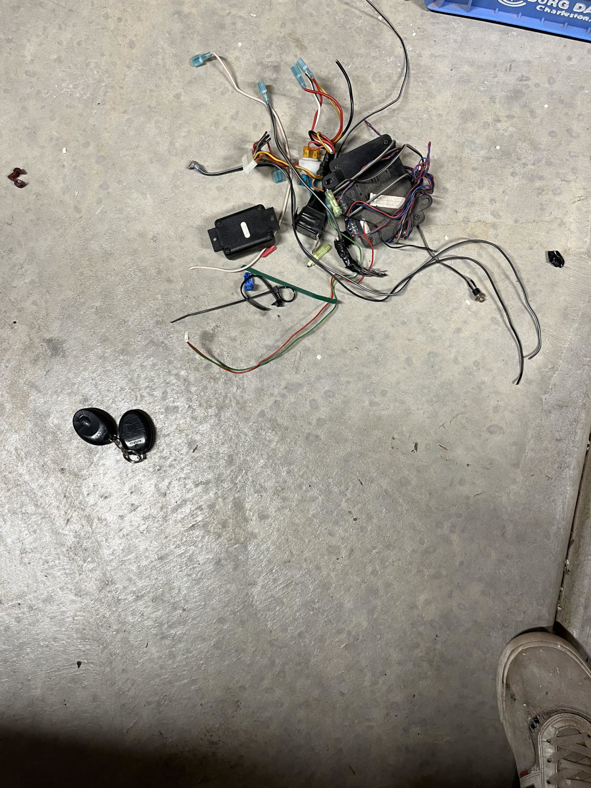

    I kind of doubt anyone is following this, but for future reference, I also took out the aftermarket alarm that has been in there for years. I don't know if this is gonna help or not, but we will see. This alarm was such a piece of junk and was installed so poorly. How and why they splice them like they do should be a crime.
    w666, JasonC. and KNABORES like this.

    So after removing the aftermarket alarm and double checking the grounds around the truck/engine bay/etc, I'm still getting the weird start problem, where it will, when "cold" crank 1 or 2 times, act like it's gonna stall, and then all the sudden start up. I don't know if this is something that anyone else has had issues with, but if so, I would be more than grateful if you chimed in.

    How did you re-attach the wiring after removing the alarm? If you did it properly and either butt-spliced or solder/wrapped, did you tug test each wire?
    Usually folks report odd running issues when neg batt cable is off for a period of time. Not latent starts. And you could potentially see everything all-over-the-place, because the ECM is relearning.

    I used butt splices since soldering and wrapping were out of the question since the wires weren't long enough to connect/solder/shrink wrap. Butt splices gave me a little extra length. I tugged on all the connections and made sure that they were shored up.

    Fuel pump resistor, if the truck starts with the fuel pump in low-flow mode, it's passing signal thru the fuel pump resistor; if hot/not working, resistor may over-restrict or stop flow of power entirely, i.e. pump no energized.
