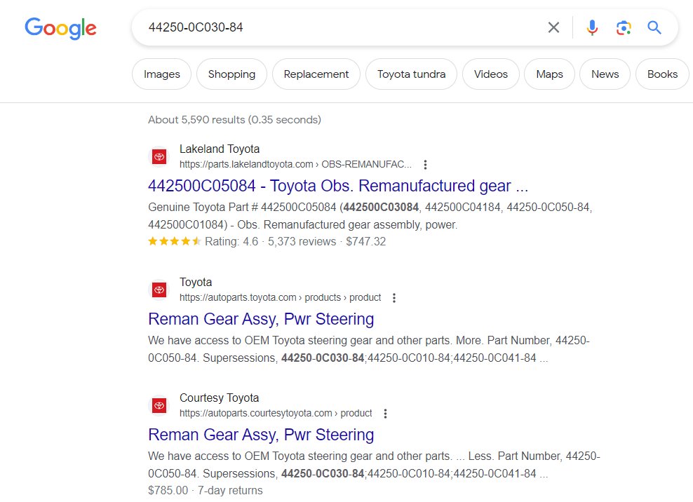

    If it's the case, that would be pretty typical for Toyota. I haven't found a good decoding method for their parts, but what I've noticed is the part numbers are usually 10 digits long, old style separated in the middle by a hyphen, and the last two digits in a 10-digit part number are usually attributes of the part.
    Like ... If I had to favor a guess, if a part number was ABCDE-FGHIJ, it seems like the letter in the "I" position pertains to color, and the letter in the "J" position is the version/iteration. I typically only see that "J" position as a 0, 1, 2, or 3. If you look at TSBs, the recall parts often have a "1" or a "2" at the end. I also notice the "ABCDE" portion is a catalog group, i.e. all parts related specifically to the front door may have the same ABCDE prefix.
    They also sometimes add on a "-84" at the end of a part number like ABCDE-FGHIJ-84 to indicate something is remanufactured from a core part. For example...
    I just searched for 44250-0C030-84 and sure enough, I found an entry for the 44250-0C030 rack (but it's just as expensive):
    Pnwtundy likes this.
