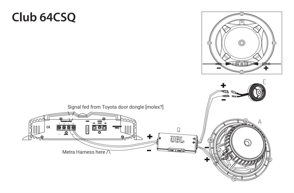

    If I understood you, yes, no harness to tweets needed b/cuz...
    Take a look at this JBL install sheet...its what Im using but havent yet completed install [waiting for re-paint completion].
    I believe you would use the Metra harness to plug directly to your door plug [molex?]. Toyota sends audio signal to its factory Mid, and then another separate line to its factory tweet [presuming why the name Y cable]; if replaced by a component sys [like this JBL], the audio signal [shown in JBL dwg as ExtAmp] comes thru the new 'Metra harness' that has direct connect [molex?] to the Toyota signal feed harness at door, THEN into the supplied X-over, THEN YOU will make the feed wires fr/X-over to Mid and Tweets separately as shown on the JBL dwg [w/my notes added].
    Like I said, I havent done the install, but have the parts waiting to complete.
    If Im wrong about any of this, I can make 'book' on @Shifty driving by in a while to yell at both of us and finish the picture of installing a component system w/out cutting your Toyota feed dongle [molex?]...
    Meanwhile, I'll point out that I went the JBL route since thats what Toyota voted for and @Shifty has already done the Beta test...good enuf for him, probly good enuf for most of us...

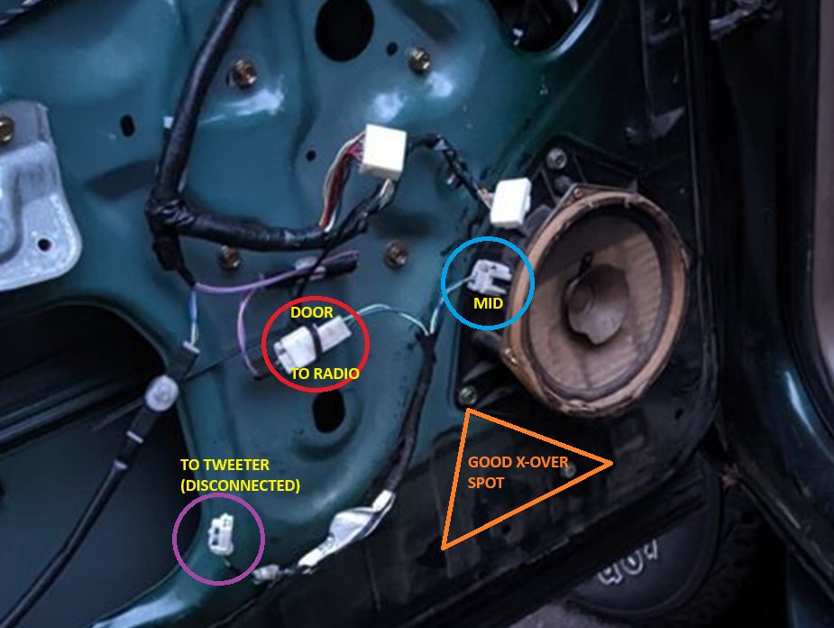

    Sorry about that, I swore I saw you had an AC. I'm juggling a lot today, and my head is likely halfway up my ass.
    Understand, we see too much of this, so I tend to be a cynical MFer sometimes and use flowery language. It's nothing targeted at you. In case you had that idea.
    After going online and trying to find pictures of any RC that didn't have tweeters in the door, I assumed it wasn't a thing - there's no rear doors for speakers, so they put the speakers in front.

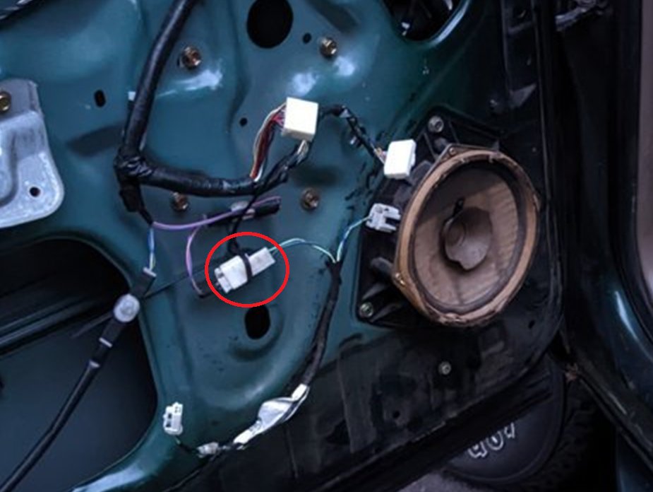

    What wasn't clear to me how they're wired or what impedance the speakers are. Sadly, the EWD doesn't make that clear at all, Toyota's EWD does a really piss-poor job of showing what happens - for example - at the Y-cable (take a peek, though I may be mis-reading it). I believe they're wiring that in parallel, but adding an electrical component to affect the impedance on the line.
    If you can show me the wiring inside the door, and look at the back of each speaker to see the impedance, and bonus if you show me a picture of each connector, I can tell you best approach. Really, I just need to know:
    • Is your truck using the standard Y-cable all AC trucks with tweeters use in the door ... or
    • Are both of your speakers directly wired separately, using two pairs of wires? (if so, I want to see the connectors at play!!)
    When I'm talking about this Y-cable ... at least on every AC I've dealt with on here (so take w/grain of salt) with trucks that have tweeters in the doors, there is one pair of wires coming into the door. On one side the wires are purple and pink. On the other side, they're blue and green. They terminate to a connector in the door. I'll toss two pictures in to try and make it clear. This is the Y-cable, they definitely added some electronics in-line, I'm assuming to manage impedance. Note the color of the circles, they will match up to the 2nd pic showing them in the door:
    Here's where those land inside the door - notice the purple/pink wires to the left of the "DOOR / TO RADIO" plug in this pic also. Again, look at the circle colors, and compare to the circle colors on the Y-cable above. Note the length of each one, and you'll figure out the orientation and wiring, I hope.
    If your door has tweeters, I'm assuming, just like you see in that pic, you've got the same damn thing. i.e. in the driver side door, you'll have a purple and a pink wire going to the red-circled connector (which you'd use Metra 72-8104 to adapt out, and leave your Y-cable intact).
    If you pop off your driver's door panel and DO NOT find any of what I'm showing you above, please, take more pics. I'm dying to know what other possible kind of fuckery Toyota could've imagined up for your truck.
    If you *DO* have the Y-cable pictured, I'd go with a nice pair of 3ohm JBL components that come with a crossover, remove the Y cable, install the the Metra 72-8104 onto that DOOR TO RADIO connector, install the crossover in the orange triangle (use industrial velcro or a tar-based adhesive), then wire your two speakers from the crossover.

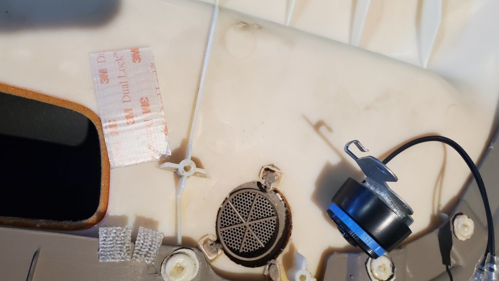

    OEM tweeter has the cap glued to the basket/magnet to handle HPF/bass blocking IIRC.
    Also IIRC, tweeter and mid in front door are both 4ohm. I can look back on my sale pics on here to check, and if you PM me your VIN I can also look up your part numbers and find pics of the magenta.
    I really need to untape my OEM Y-harness to see what’s inside. I remember feeling something hard in there, but I still haven’t cracked it open to see, are they running in parallel, in series, are they adding anything in line to bump up or drop down the resistance? I just know they’re going from a single pair to two. Maybe I can crack one open tomorrow.
    I’m sure I can find up what the other end of the tweeter connector is (part number) to find an adapter if you really want to know. But if you truly intend to simply swap the speakers, you’ll need to know what that Y-cable is doing [or] select the same impedance tweeter and move the OEM cap to the new tweeter on the same line to mimic it, knowing caps cut frequencies differently at different impedances [or] just replace the Y-harness with the Metra adapter and get a components set with crossover bundled and call it a day.

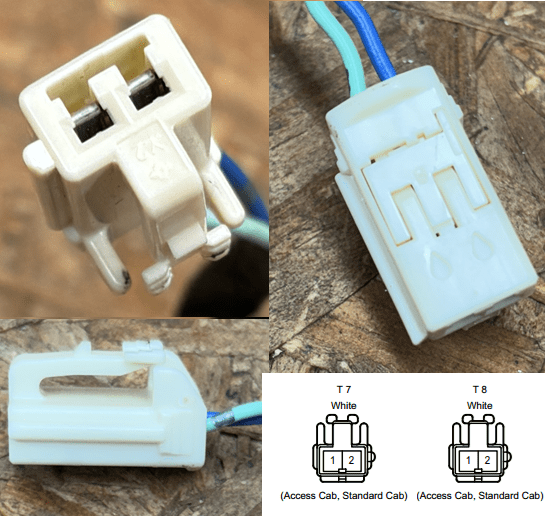

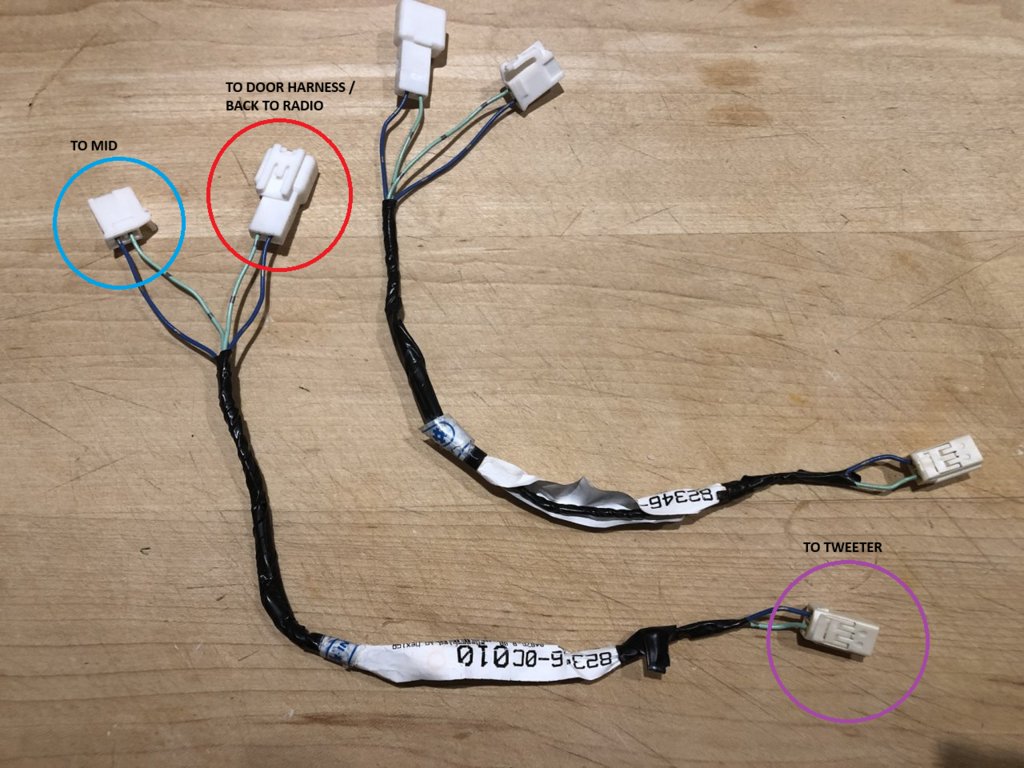

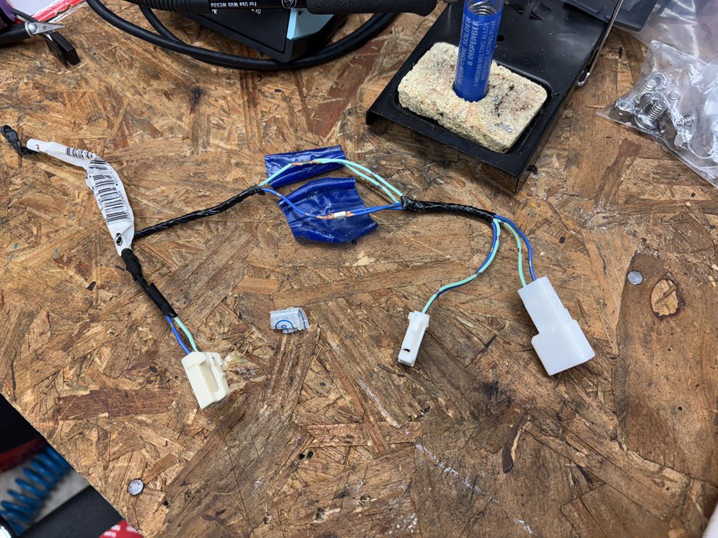

    So this is interesting. The Y-cable used on my OEM-amplified (but non-JBL) system, part number is a straight-up parallel circuit:
    That's interesting to me, for my AC with the OEM Fujitsu (non-JBL) amp, because here are my original OEM speakers. All speakers start with 86160- part numbers. My rear door speakers (OEM p/n ending -0C050) are 6ohm. The front midrange drivers (mine are p/n ending in -0C030, but toyota lists -0C040 as another variation) are 4ohm. The tweeters (mine are p/n ending in -0C010 but Toyota lists -0C020 as another variation) are also 4ohm. That would mean the Y-cable would potentially leave you with 2ohm load in front and 6ohm load in rear. Clearly there is front/rear channel separation so they're treating the channels independently (front to rear).
    Anyway, regardless what it is ... if your Y-harness has the same part number (82346-0C010) and you want to stick with that versus using components, I would simply un-solder the wires from the OEM tweeter and splice on your new connectors rather than cut the factory Y-harness and you have an instant adapter harness. At least this way, if you ever wanted to go back to stock, you could easily yoink some tweeters from a junkyard/parts truck and plop things back together, or just re-solder the wires back to the tweeter.
    If you really want to simply trust whatever Toyota is doing won't impact you, which may leave you with a 2ohm load on the front channel, Toyota lists the Tweeter connector as T7 or T8 if I'm not mistaken, and that's part number
    90980-10906 for AC/RC trucks (hey DC ppl, your 4-pin tweeter connector is 90980-11012). But that's for the female side attached to the wire harness, you need the male side (more text after this pic):
    For the life of me I can't find the part number for the female side. Most connectors start with the prefix "90980-" and sometimes the final 5 digits will be embossed on the connector somewhere, but you may need a magnifying glass to see it.
    Anyway, all that said ...
    That Sony head unit you have is one of the beefiest XAV-AX Sony sells from a power standpoint. If I were you, knowing I had that power at hand but also being thoughtful of heat, I'd honestly just go with JBL something with higher power handling, buy the Metra harness to replace the Y-harness, and wire them up without the Y-harness. Since you have no real front/rear channel and whatnot. I'd actually consider using the rear channel for a mid-range fill to pop into the b-pillar plastics.
    MobileTundra[OP] likes this.

    I'm only replying with this info for future onlookers, or maybe for my own reference.
    It appears the tweeter connector female, on the Y-harness, is Sumitomo 6520-0550. It would appear the male, on the tweeter side, is Sumitomo 0549. Alternately, it looks like Yazaki also has a part, 7282-1028 for the Y-connector side, and 7283-1028 for the tweeter side.
