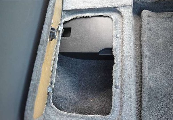

    Later-model access cabs, at least the '05-'06, you'll want to look under the rear passenger seat, inside the cubby, with this door:
    If you find a wide-open storage compartment like you see here, nothing but carpet, your access cab either doesn't have a factory amp OR it's a pre-2005 model and possibly in the dash.

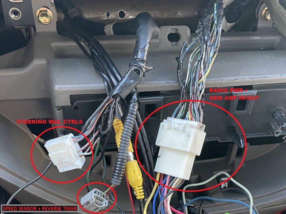

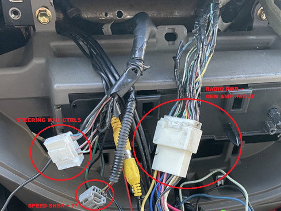

    PRO TIP: For folks with dash-mounted amps --- The wiring probably isn't what you'd expect. Your stereo wiring goes first into your amp via two connectors, then back out of the amp again, up to the stereo. Your aftermarket adapter harness should plug into the amp harnesses, NOT the stereo harness. This has confused a number of people, who popped out the stereo and found only one, single odd-shaped plug in the back of the factory radio. If you also found only one plug in the back of the OEM radio, you need to double-check for an amp in the dash.
