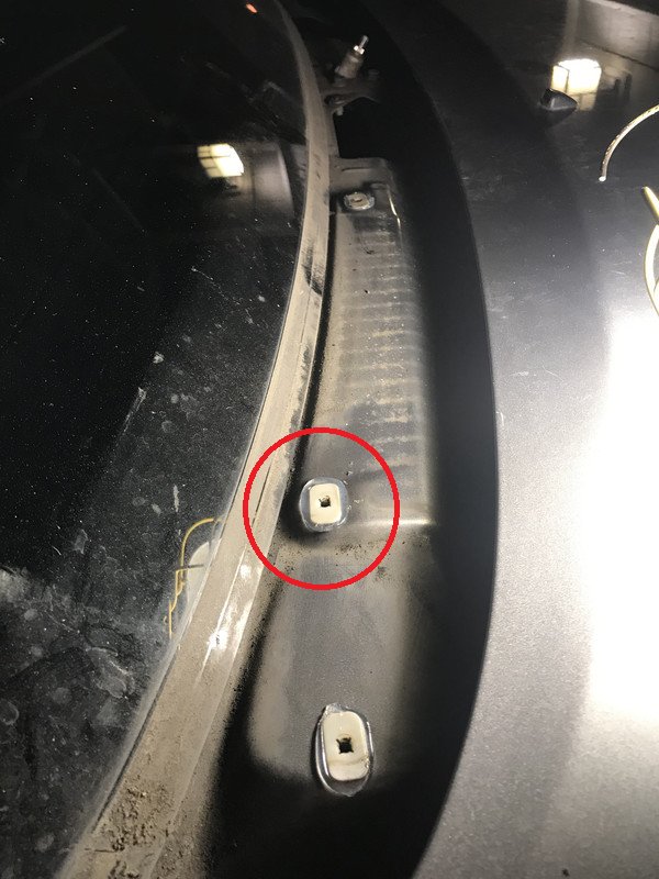

    4. I have the cowl leak issue. I'm planning to get all new screw grommets. Are there 10 in total? I understand there's been some recent suspicion of QC issues, but I'm currently still planning to get part number 90080-18055. Is there any particular marine sealant folks prefer to use with these?

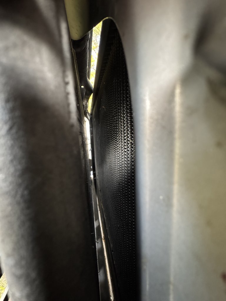

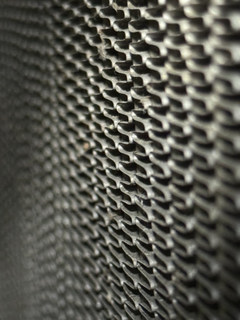

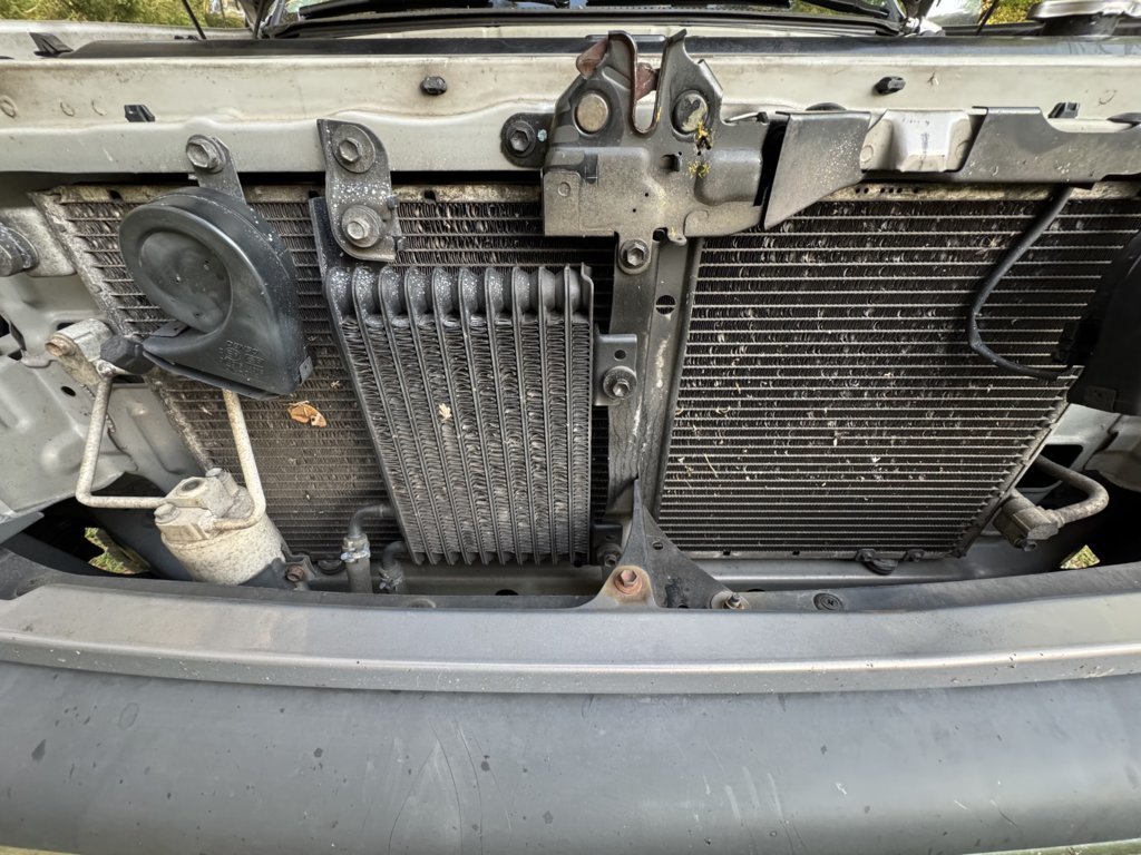

    5. I can't tell if the radiator has been replaced or not. Considering it's behind both the A/C condenser and an oil cooler, it has no damage and still looks shiny new on both sides. There's nothing in either the workbook or the Carfax that suggests it's ever been replaced. I understand the concern here is the antifreeze leaking into the bottom transmission cooler. The old coolant prior to replacing the timing belt / water pump looked fine, and so too did the old transmission fluid, although it was clearly recently changed for how red it was, lacking any burned smell, and how easy the drain plug was to loosen. Should I just go ahead and play it safe by replacing the radiator? If so, is a Denso unit safe to use?

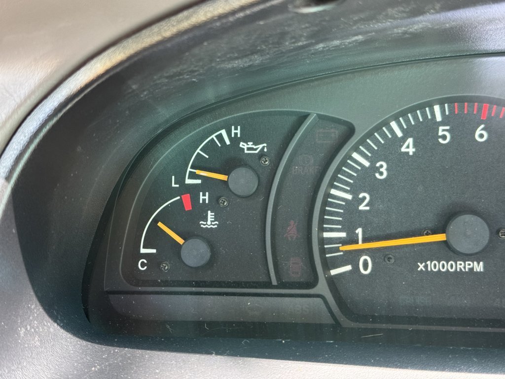

    6. The only OBDII code I have is P0141. I've already used a multimeter to check the heater circuit, and... I'm getting nothing. No ohms read between the two same-colored wires for the heater circuit, and I get no voltage on the others. The O2 sensor is original. Am I safe in assuming there's an issue on the ECU side vs the O2 sensor itself?

    You can post pics of it and maybe we can tell by the discoloration. If no record of replacement it may be best to go ahead and do it, as well as making sure it has the correct and fresh toyota coolant.

    There's really no reason not to replace the radiator. And yes, Denso is the go-to brand. It would have been convenient to do it during the timing belt/water pump job, but that's ok. A radiator isn't very expensive. Really cheap insurance. Get the right Toyota coolant in there if it's not already, new upper and lower hoses, and sleep better.

    10-4. The radiator isn’t the worst in the world to pull, so I’ll do that first thing before turning it over to get the LBJs etc replaced.

    Yep, pretty easy. Even though I had my timing belt/water pump job scheduled at a mechanic about a month down the road, I went ahead and replaced the radiator and hoses, because I knew they were original and didn't want to chance it.

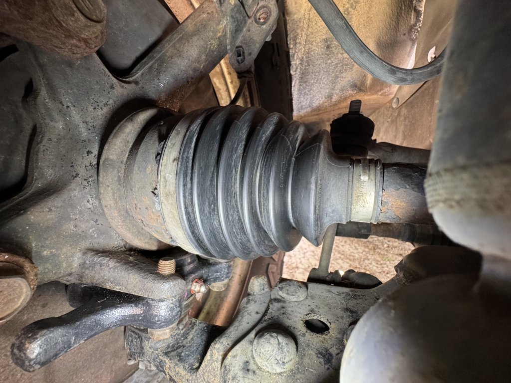

    Is anything actually wrong with your existing axles? If the boots are torn, I would recommend you reboot them(assuming they are original OEM axles). I'm not that familiar with Detroit axles but I do know a few members have purchased them.

    One of the bigger issues with aftermarket CV Axles seems to be their use of chubber (Chinese rubber), which starts to crack to hell within a year or three.

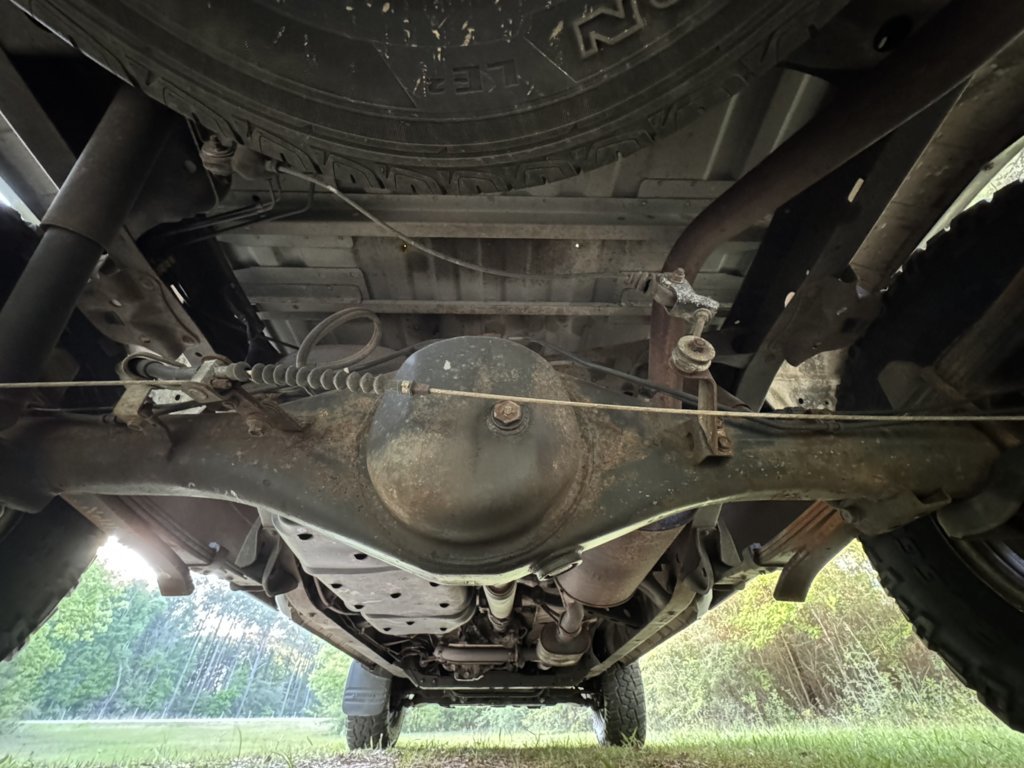

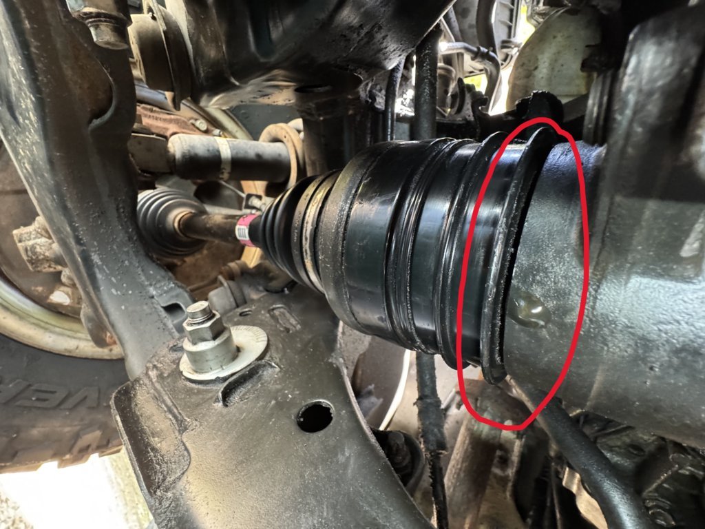

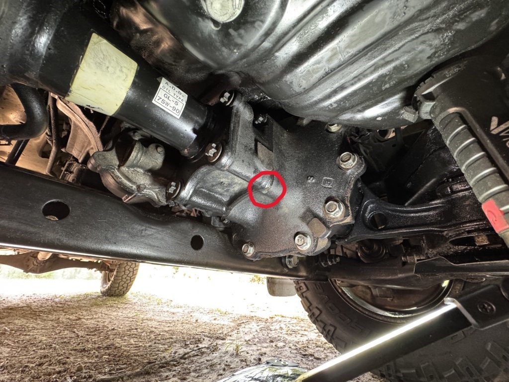

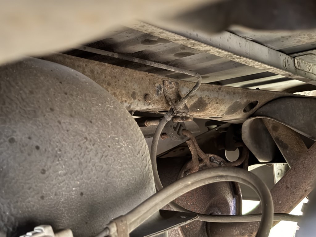

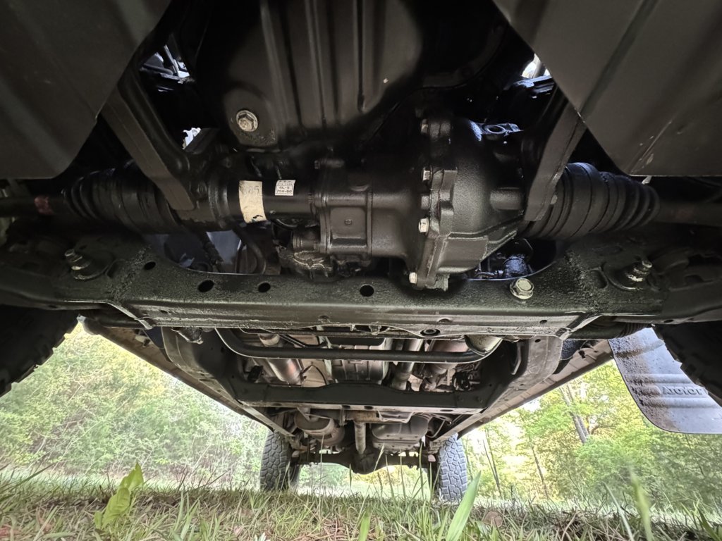

    Maybe not; haven't had any knocks or issues. And after cleaning the undercarriage some today and refilling the front diff, I wasn't able to find any leaks on the driver side. I did however find two separate leaks on the passenger side - see photos:
    The first leak is slow, but steady - drips maybe once every hour. The second leak drips once every couple mins when the truck is on level ground, and every 45~ seconds when the truck is banked to the passenger side.
    Looks like the first leak is a failed seal around the housing of the front diff? And the second, I can't tell if this is an issue with the CV axle, outer seal, etc?

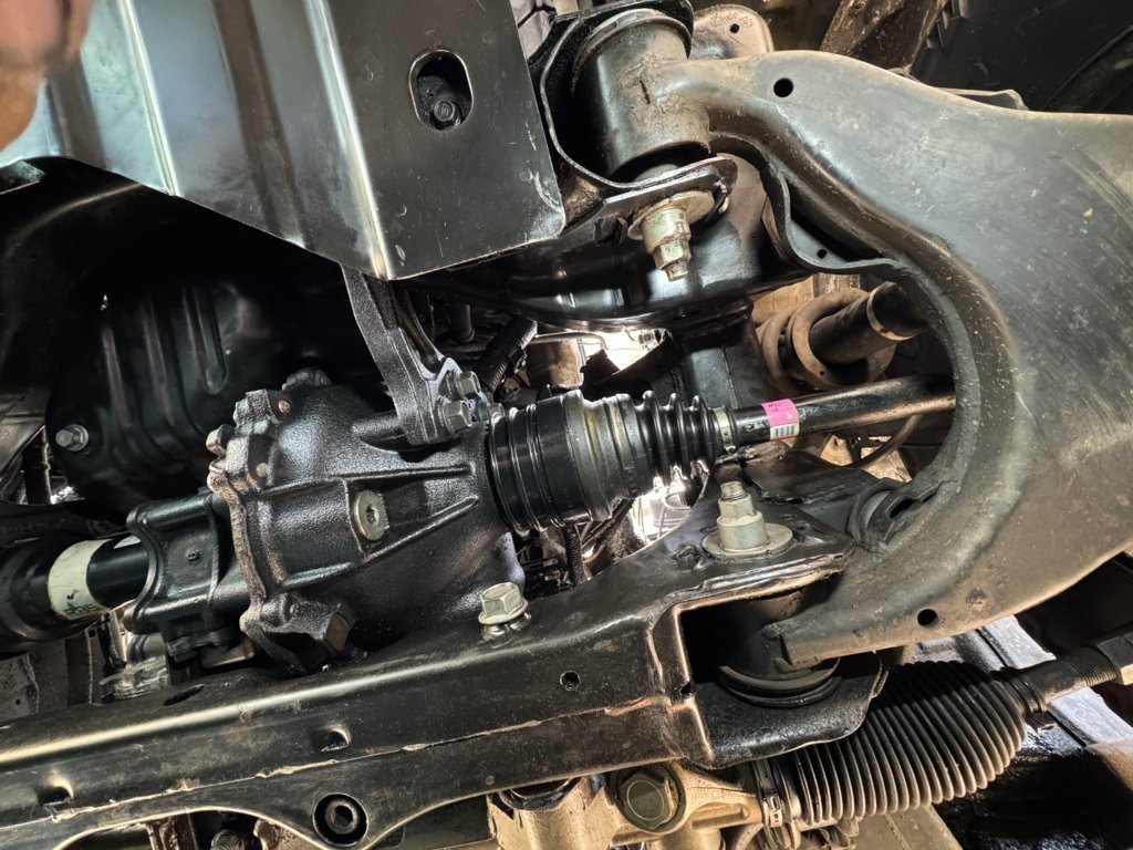

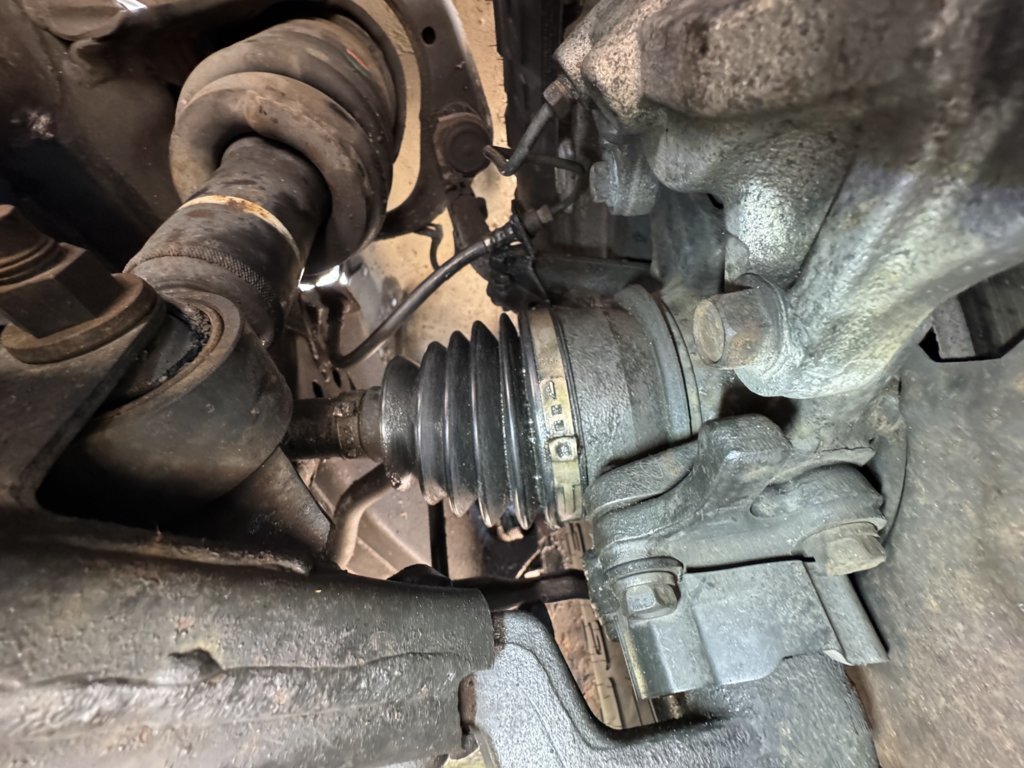

    Here's other photos of the CV axles - two shots of the drivers, and a shot of the end of the passenger since the rest of it can be seen in the last photo above:

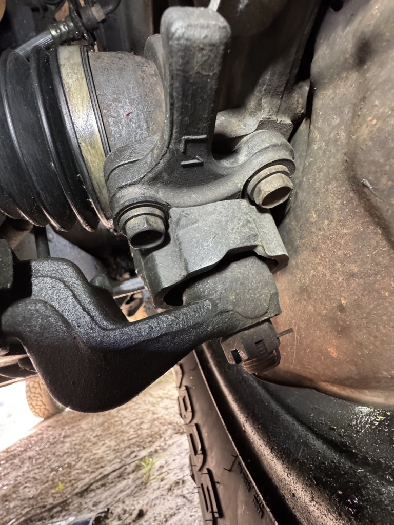

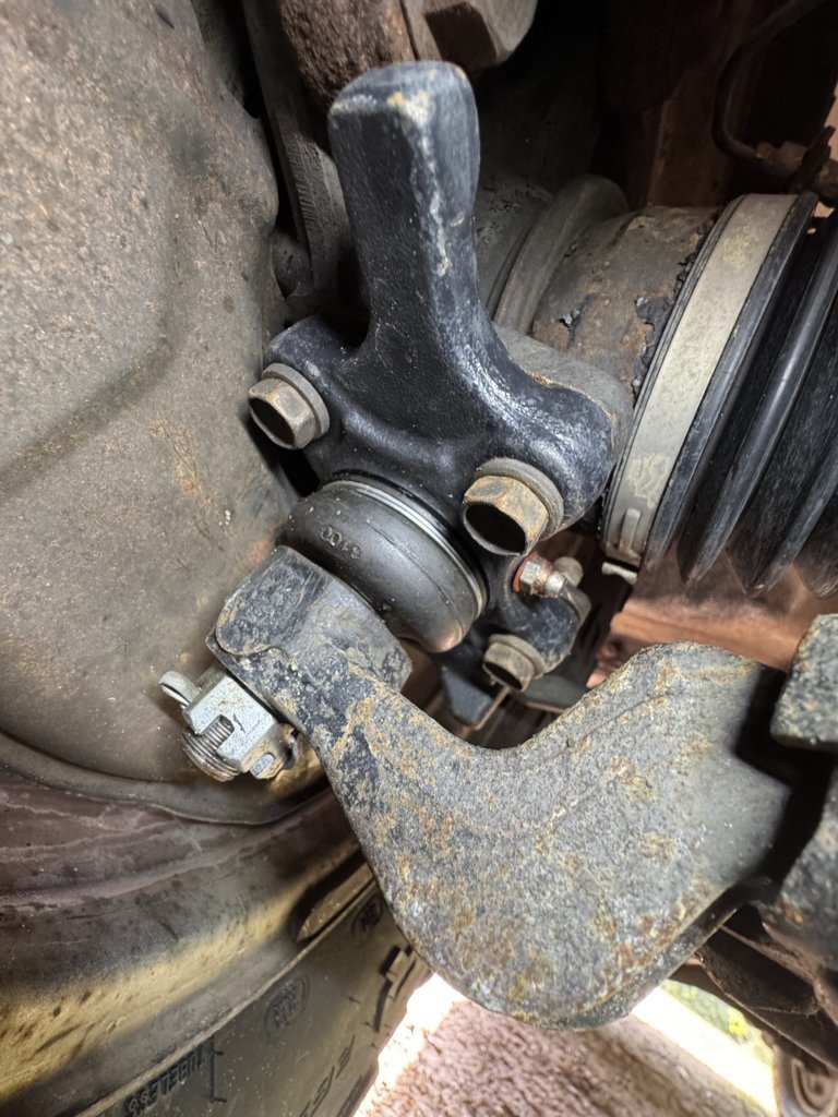

    Here's photos of the current LBJs. The driver side is original with a protector; the passenger side is aftermarket since it has a zerk, and has no protector anymore:

    Just giving this one bump since I’m about to order a round of parts. Currently planning to get these, but see the list for associated questions:
    • Denso radiator 2210517
    • Gates serpentine belt kit (belt, tensioner, idler - 90K38488A)
    • Post-TSB accurate Toyota oil pressure sensor 83520-60051
    • x2 Toyota cowl screw grommets 90080-18055
    • Toyota LBJs & protectors (43340-39356, 43330-39466, and 2x 43346-60011)
    • x10 ARP Chromoly bolts 663-1004 (?)
      • Are these long enough to work with the protectors? Or do I need to get the one-time use Toyota 90119-10933 bolts and torque to 37?
    • CV axle for passenger side(?)
      • Do I need this? Where does the axle-side leak seem to be sourcing from?
      • If needed, what brand ideally?
    • Passenger-side axle seal(?)
      • Does this appear to be the source of the diff-side leak? To me, it seems like the orange sealant around that section of housing has failed

    For the front differential leak I would hold off on purchasing an axle. You are definitely going to need the outer axle seal but to tackle the inner leak it is going to be more involved. I attached a parts diagram of the front diff. Everything with a diamond next to it is a non-reusable part

    So just for reference here, only 1 or 2 are the leaky ones, however I did find a few of mine to be somewhat damaged when putting screws back in. I'd get a few extras to be safe.
    I'm not sure on the length there. I'd really consider just going the Toyota bolt route for these or just don't run the protector, it isn't necessary. The pre 02 trucks didn't even have the protector.
    As for axle leaks, I'd say the one by the cv shaft is most likely from the axle seal, the other one in the middle of the diff is hard to say, can't say I've seen anyone post a leak from there.

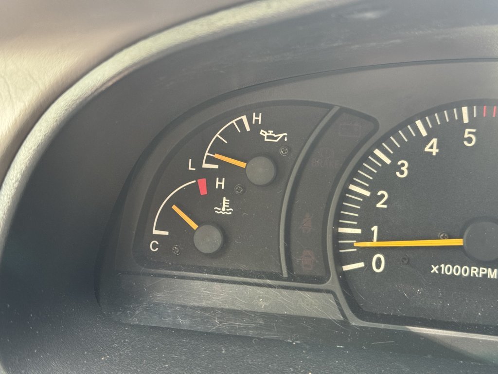

    I wouldn't get your hopes up that this will make your gauge read higher but if it does please tell.

    This is the specific cowl fastener that sits over the airbox (stealing from @Baller with this image). However, the one at bottom/center is probably good to seal.
    As for the cowl fastener part itself. The new OEM ones come with foams. They'll work fine as long as you push them fully in until they click to ensure they're properly seated. But honestly, as shown here in @Baller's photo, the definitive way to solve this problem is to remove the foams, and use a paint-safe sealant (normal silicone can induce rust!) similar to how is shown in this pic, and in PHM's build pic (he used Liquid Nails FuzeIt, IIRC).

    I wish the exploded diagram had a flipped view, but what I can tell you is it’s the separate section of the differential that mounts to the diff itself, which houses the A.D.D. So it looks like it doesn’t have a traditional gasket, which may make sense as to why mine seems to have once been sealed with orange silicone.
    Noted, thanks. I’ll just do without the protectors I suppose, since the ARP bolts are well-regarded. It’s not as if this truck will ever see any major off-roading; it’ll just see the occasional trip to town, the cold hole, and work around the property.

    I'm definitely interested if the new oil pressure sender makes a difference in what the gauge reads. I've noticed that my gauge hovers slightly above the L line for a long time after the engine is off. And it's in the same spot when idling and warm.

    I’ll report back about the oil sensor to everyone then! This isn’t the one that was listed in the TSB, but rather an even newer one that someone elsewhere on the forum highlighted (I think it was linked in the 1GT buyers sticky)

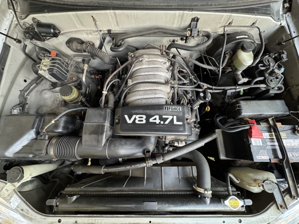

    Before I assume I’ve got all the parts I need for the radiator et al, I was just testing out the thermostatic fan clutch to see how it’s doing cold vs hot. I had already noticed the fan was engaging at either cold or hot, but when I spin it before a cold start or after shutting down at full operating temperature, it spins freely with just a little resistance. Is this normal? Was expecting it to be locked up once warm.

    Sounds like a bad fan clutch to me. Should develop more spin resistance with heat. But even fully cold, you shouldn't be able to get it to do more than a full spin (mine is about half spin).

    Got it, I’ll order the Aisin fan clutch off RockAuto then and install it at the same time as the other under-the-hood parts, thanks!

    Alright, all done with my end of the work; replaced the fan bearing bracket (which surprisingly came with its own studs!), fan clutch, serpentine belt tensioner, idler pulley, serpentine belt, radiator, oil pressure sending unit, and went ahead and did the oil as well, using a Toyota YZZD3 filter - the old one was a small Napa filter
    Everything’s working great, except the fan clutch operates the same when the engine is off as the old one; regardless of temp, it spins freely with only a little resistance. That said, you can see and hear a difference; it’s slow on startup and then engages more with the engine’s speed once the engine bay is up to temp. So it does seem to be working. I also found the old one is the exact same Aisin model as the new one.
    As for the oil pressure reading, there is a difference, and you can notice it, but it’s minimal.
    Before:
    After:
