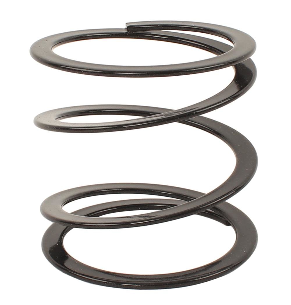

    Unless you have a progressive wound spring or a multi-rate spring system composed of multiple springs. The spring rate of the c/o assembly remains linear. Now when you start talking geometry, there can be some deviation but remains relatively linear for most well designed suspension systems.
