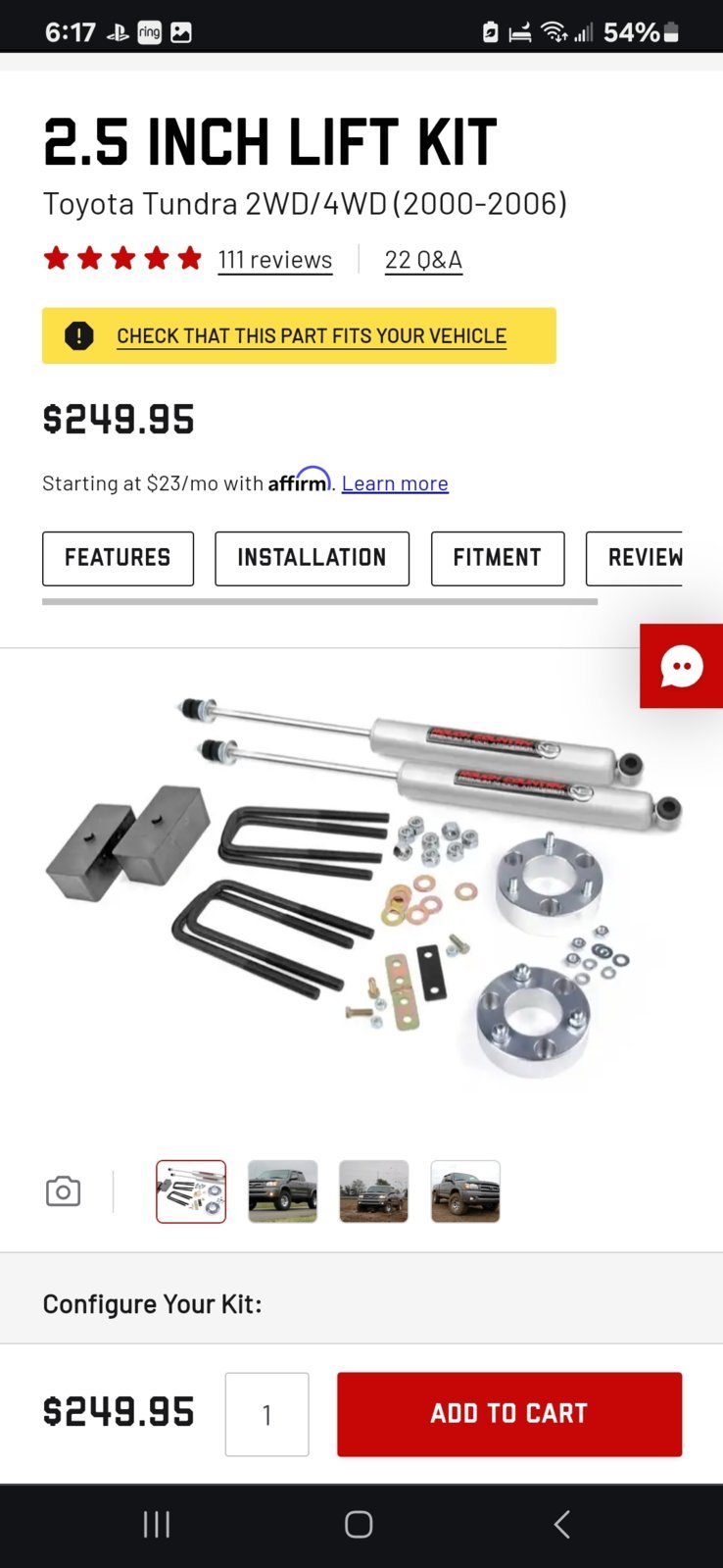

    Getting ready to install my rough country 2.5" leveling kit on my 2000 AC Tundra. Kit consists of pucks up front with blocks and shocks for the rear. I will be replacing lower ball joints with a new OEM set. Also replacing UCAs with either Freedom or JBA. What I'm trying to determine is what strut should I use with the factory springs,which UCA and what wheel spacer I need to avoid rubbing. My wheels are
    17x9
    Offset: -12
    BP: 6x5.5
    I was planning on running a 285-70-70 . Basically want a tire that has an aggressive look,fills up the wheel well,handles good on the road and doesn't rub. My truck is strictly a country road truck. Never goes off road.

    Rough Country is garbage, it's cheap for a reason, and you can get into something substantially better for not much more money. If you don't plan to offroad at all, blocks in rear is fine, if you plan to offroad, skip blocks and skip strut spacers. If you plan to lift with struts up front, skip strut spacers, you don't want to mix the two, last guy who did that (ironically on Rough Country hardware) bent knuckles and fucked his shit up.
    Before we get any farther, have you read the "Suspension, wheel and tires ..." section of this thread? https://www.tundras.com/threads/so-you-wanna-buy-just-bought-a-1st-gen-tundra-eh.115928/
    I think it answers most of your questions.
    I don't think you'll avoid rubbing with 33s (285/70r17 is 22.8") unless you install aftermarket upper control arms that'll give you the ability to realign favorably. Wheel spacers likely aren't going to help you with stock upper control arms, I suspect you'll be playing a game of whack-a-mole with where they're rubbing. You will need to remove the front mud flaps because they'll absolutely rub. The wheel specs you have (which gives you a favorable backspace @ 4.53) are the exact same I had at first after 2" lift all-around, but running slightly smaller 275/70r17 tires , but and I was eating mudflap and rubbing in the liners. When I scaled back to my current wheel setup at 17x8.5" and 0 offset (i.e. 4.75 backspace), half my rub went away, and I was able to cut up my flaps to stop 99% of my flap rubbing, but I still rub the liners at compression while turning.
    Seriously though, go read that Suspension info. Those aren't my words, those are actual real-world experiences assembled from years of modifications from members on this forum.

    Strut spacers. Unless you know what you're doing, mixing strut spacers and lift can be disastrous. If you want a good example, the link you just quoted will give you 4 pages worth of nightmare fuel.
    You may not even need a lift, just to level. Are my tires "large and aggressive enough" for your taste? https://www.tundras.com/posts/3358673
    That's a 275/70R17 on 17x8.5" wheels (4.75" backspace). @abcinv is running the same size in KO2s with stock tires (17x7.5 @ 5.0" backspace) with virtually no rubbing. I don't think he's using wheel spacers.

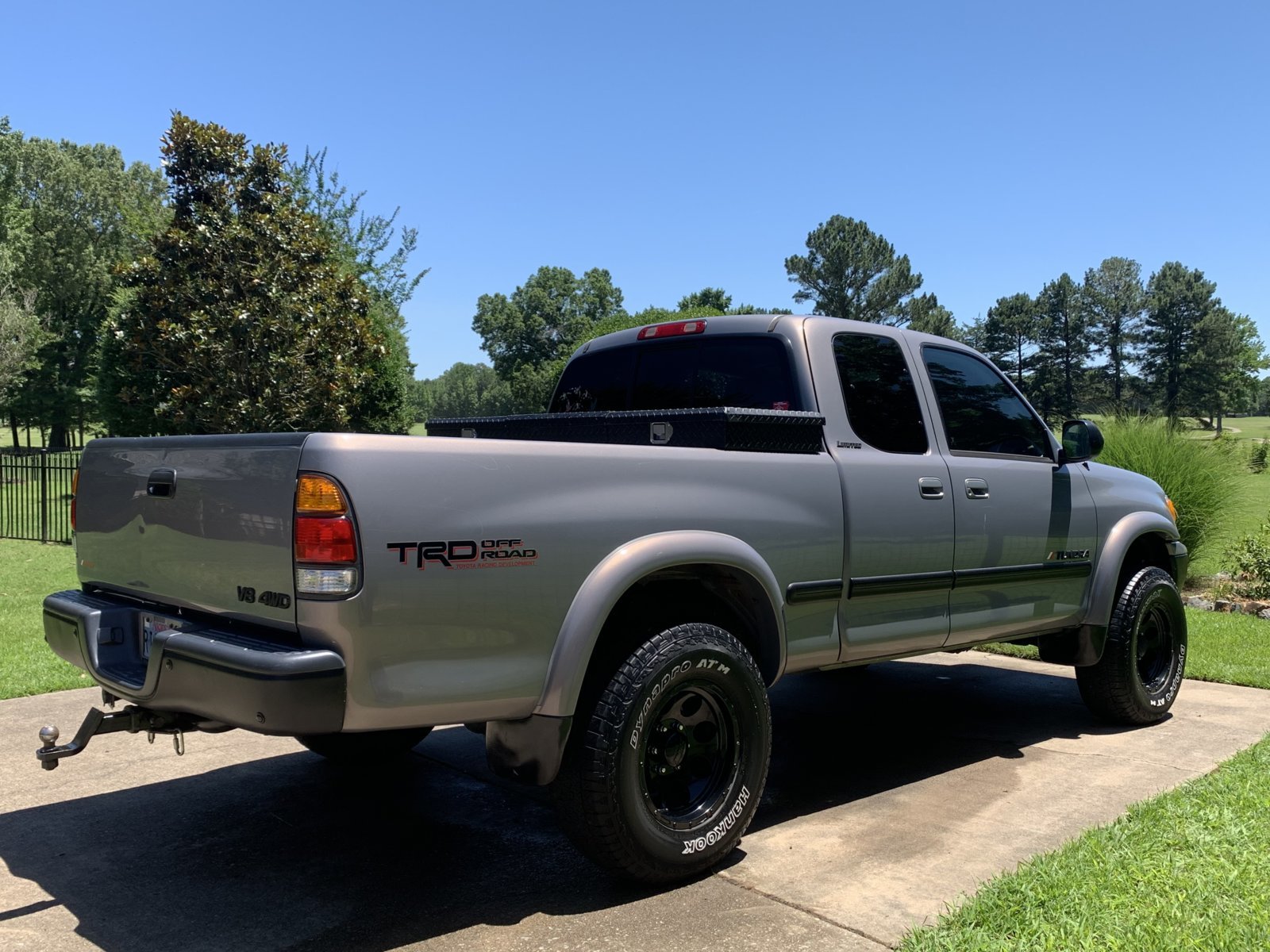

    This is what my truck looked like with 2" Toytec coilover lift, front and rear, with 17x9" wheels at -12 offset (exact same parameters you mentioned), and 275/70r17 aggressive AT tires, with SPC upper control arms, using stock alignment numbers (I really should've added +1 to +2 caster and probably would've rubbed less). This is with no strut or wheel spacers. Angles for pictures matter, they can really make a tire look beefy or skinny, as you'll see in this picture. The angle of the photo you shared is similar to the 2nd or 3rd pic here ... see how much meatier the tire looks?

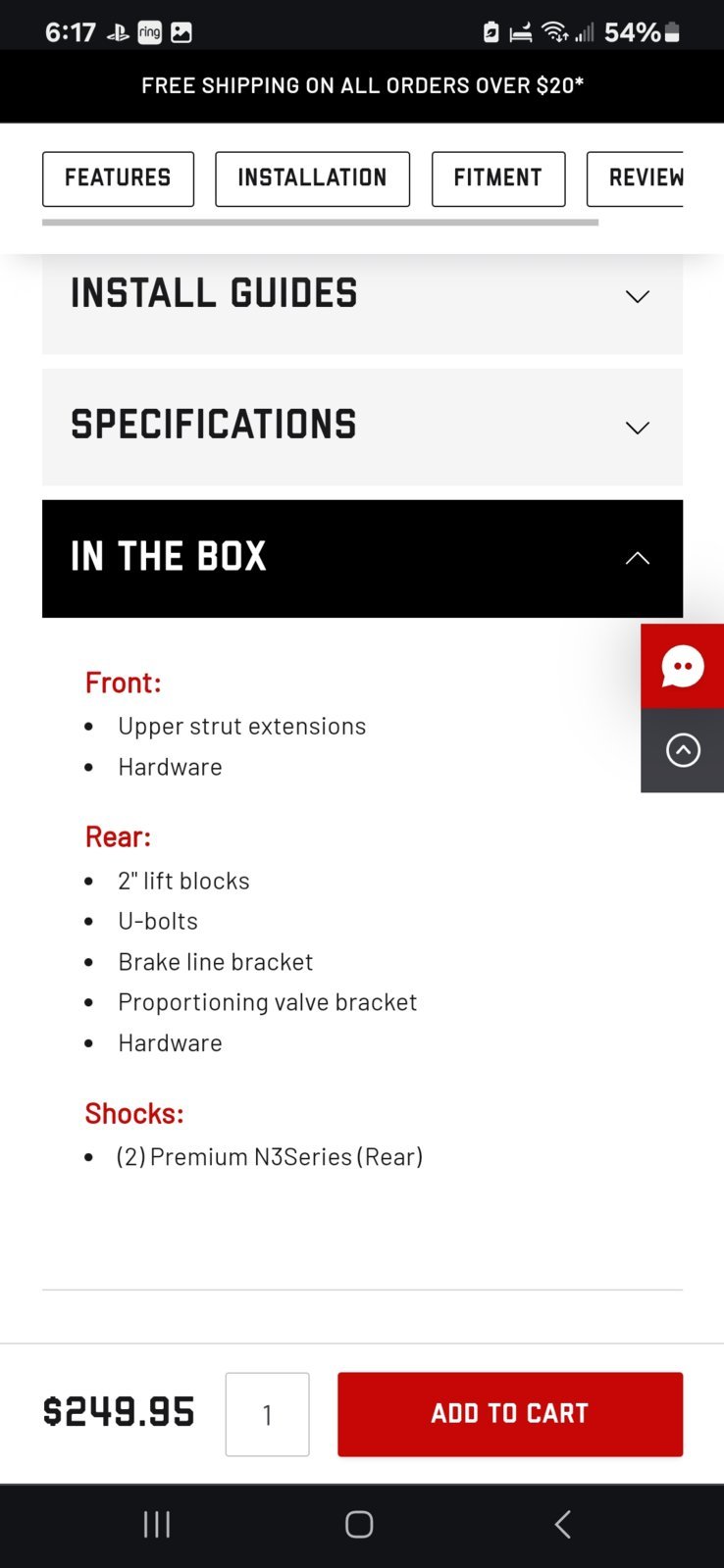

    I definitely see what you mean. The setup you have looks perfect to me. Here is the kit that I bought.

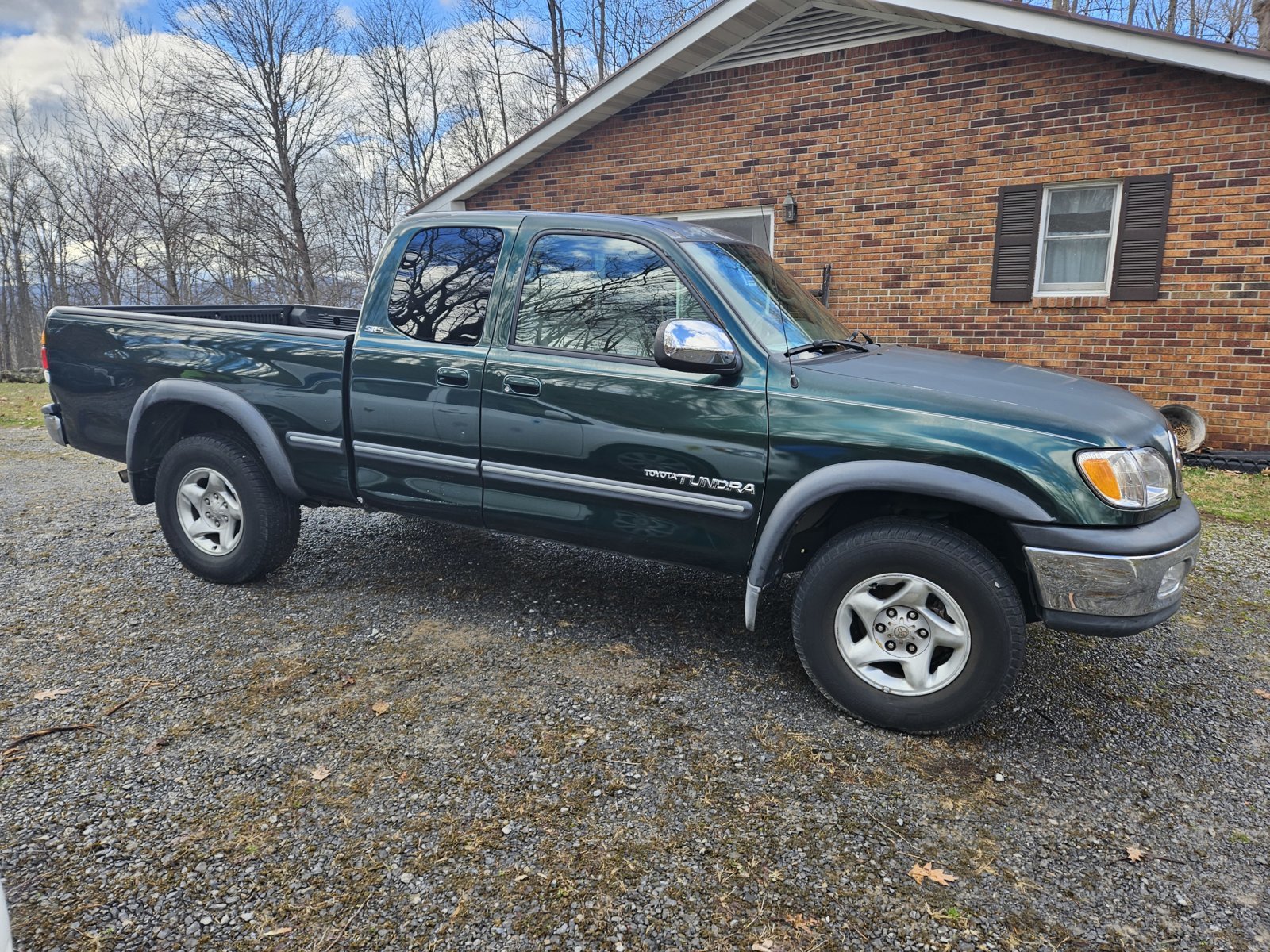

    This is how my truck currently looks.

    I misspoke, had to hit the 'measure up' thread. Stock rake is more like 1.5" give or take a quarter, depending how bad the fronts are and whether you're 4WD. I also got closer to 2.5" lift up front, and about 2" out back.
    Do you have the RC kit in front of you, and can you measure the thickness of the puck (strut spacer) accurately?

    Just to set expectations, lift doesn’t clear tires. The only thing it does it clears bigger tires at ride height. You will have minor rub with those tires most likely on the mud flap when reversing. I still rub at full compression.
    My advice would be to return that kit, as most have said it’s trash. Get 5100s and set it to either the second or third notch. Lift the front up to level it out with the rear. You won’t need to lift the rear to fit tires. You can lift the rear with blocks if you want to keep the factory rake look. Should run about $250 for the bilstein 5100 plus labor. Just my 2 cents
    also, UCA are highly recommended but you could get away with stock if you stay at 2”
