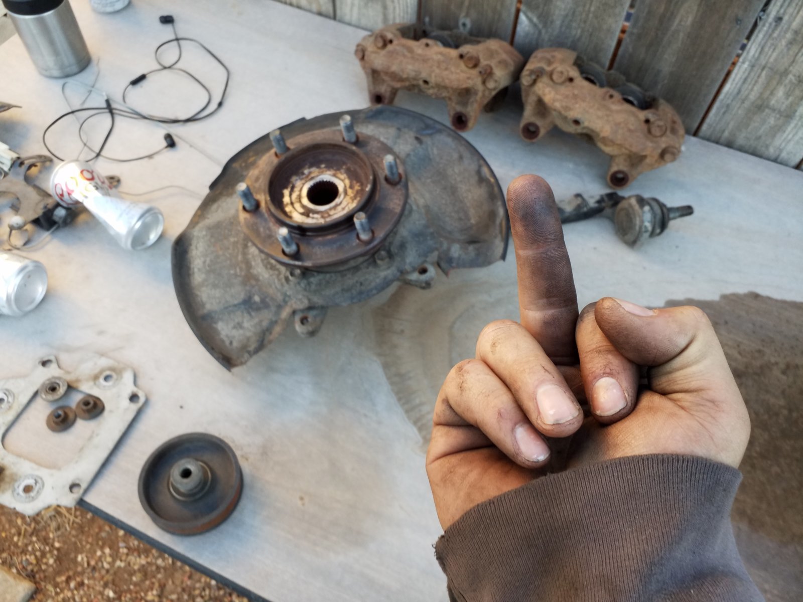

    If that bearing race splits and stays stuck on the hub, that’s when the fun starts. I ended up buying new Toyota hubs instead of trying to cut off the races. I used a 20 ton press to do the work. It’s also the time to replace or repair those dust shields as that’s the only access when the hub is pressed out. I got the bearings from yotashop, everything else from the local dealer. Honestly the rear bearings were worse with all the brake work that needed done.

    02 AC sr5 4wd v8
    Yeah. Even getting the knuckle off can be a pain.
