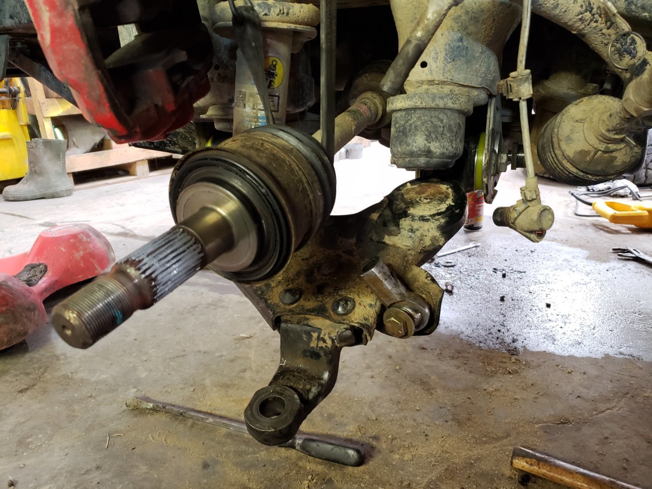

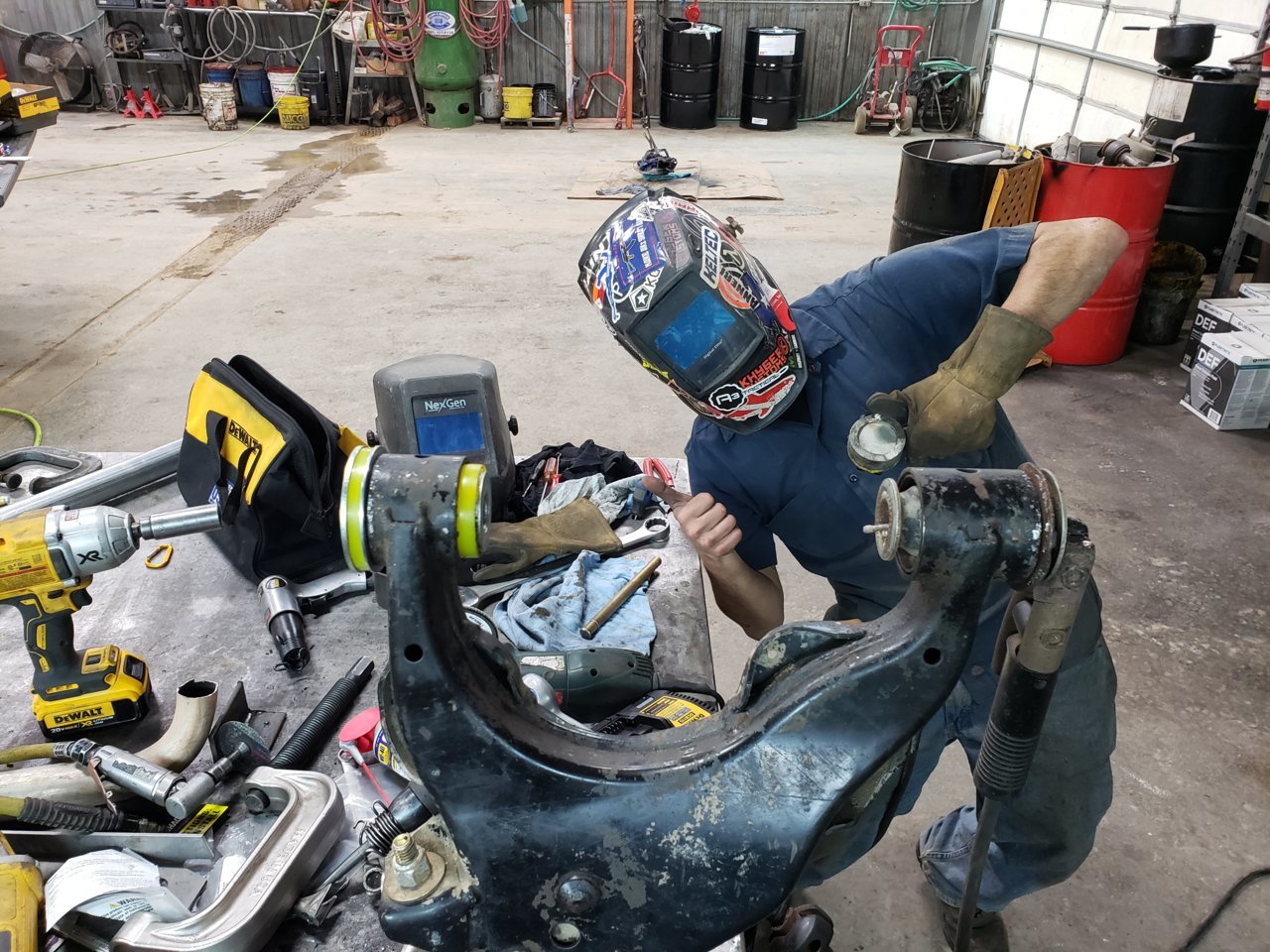

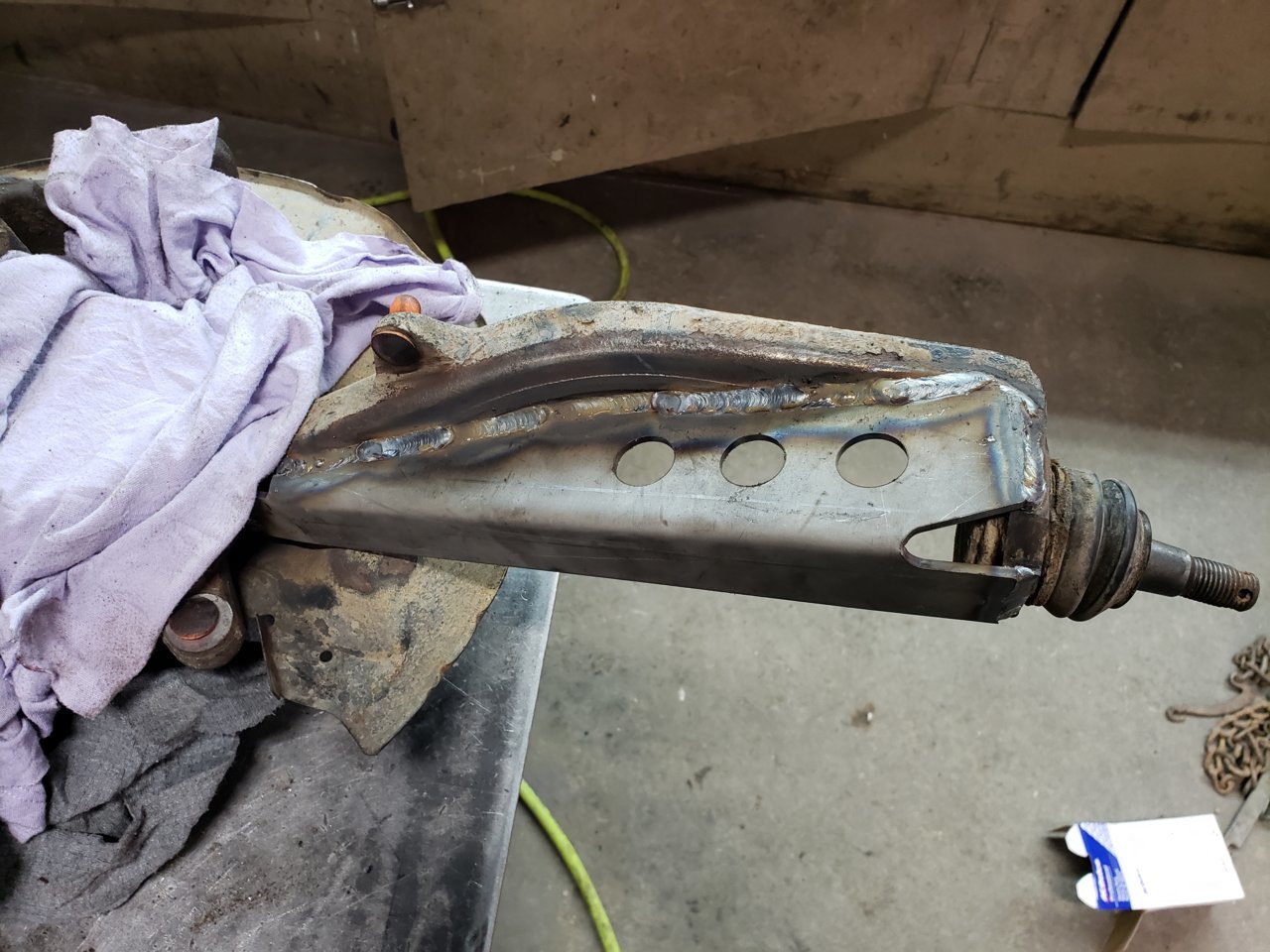

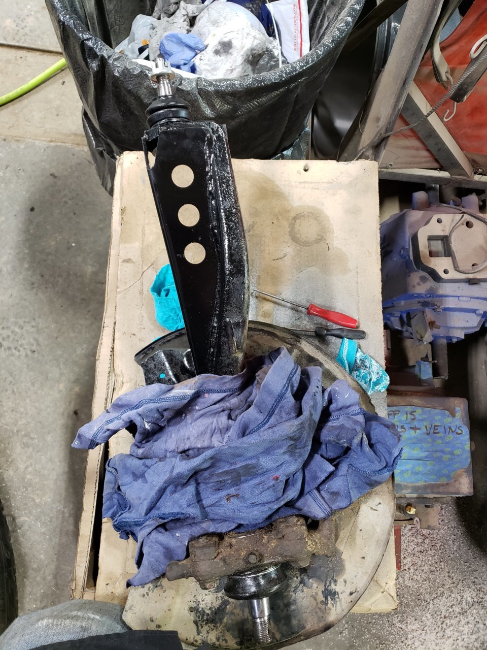

    I spent the last few days with my front end ripped apart. I ordered some Siberian polyurethane bushings and some new upper ball joints for the old lady.
    Words cannot express how uncool it was to get the bushings out without a press. I ended up using a torch and an air chisel to made things reasonable.
    The biggest problem I ran into was the rear cam adjuster on the passenger side. It was seized while the others came out smoov. I had to invest in a reciprocating saw specifically for that cam sleeve thing.
    I also replaced my upper ball joints and welded in total chaos spindle gussets.
    I was in a rush to get the truck out of the shop by last night, so I forgot to take more pics on the install.
    Here is one of the LCAs with the new bushings.
    I'm also going to have to pull apart the front again soon. The boots on my LBJs came apart and let sand and junk in. I cleaned and regreased them, but I don't want to push my luck. I will also need to get a couple of these new hub seals ordered. This one's cooked for sure. Are there any non OEM alternatives for this particular seal? I really don't want to spend $50+ per seal.
    [P/N: 90316-69001]

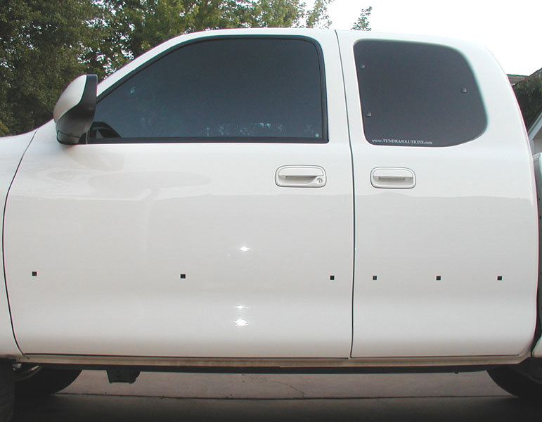

    2001 Thunder Grey Tundra AC Limited 4x4 V8
    (Camper conversion underway.) Rebuilt engine w/265K miles, A.R.E. camper shell (w/cab pass-through, rooftop fan, and side windows delete), bedlinered steel ladder rack (w/wooden rooftop deck and hammock mount), all LED lights (red dash, 4" side floods, 32" rear bar), Android head unit, 1.5" lift from Bilstein 5100 struts, 32" DuraTrac tires on factory rims, 1.5" wheel spacers, Moog suspension parts, SuperSprings leaf kit, diff drop, Reese trailer brake control, GoRhino Hitch Step, debadged, F-150 rear bumper, Sequoia center console unit upgrade, partial rear bench seat delete, dashcam, aftermarket speakers, 50% sound deadening coverage, custom tools unit.
    I'm thinking about doing a side molding delete on my Tundra after the engine rebuild situation is complete. I know I'd have to fill in the holes and that's fine because I'm planning on painting the truck soon too. Has anyone done this?
    @empty_lord I couldn't find your build page, looks like you don't have them though.
    •Would using auto body repair tape be easier than the exclusively Bondo route?
    •What do you guys think of the look? I'm going for a very basic white work truck aesthetic, I already have zero badges and love how clean that looks. I would keep fender flares, though.
    This is the only photo I could find (not mine):

    My driver side door hand them, they were filled with sheet metal welded to the door. Then ground flat and thin layer of filler to make it seem less

    I think it looks great. Have you seen the Drax build here? He didn't have those and it looked clean.
