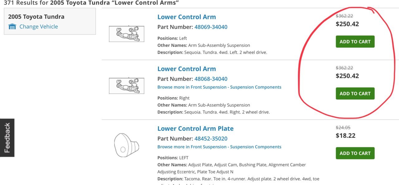

    I went new with the LCA's over bushings but mine (34020 PN) I found super cheap during the time (about $100each). The same seller is up to $278each now. Not sure how but I guess I got lucky?

    I believe @empty_lord has advised using Napa arms. They're around $200/arm.

    Per @empty_lord's reccomendation...
    I have Napa arms under my bed... they will go on when Summit sends me my UCAs eventually... I feel like @bmf4069 parts everywhere, and piling up... except I'm waiting on the rest of the parts to come in. :rofl:

    Yea I’ve had no issues with the Napa arms. And the price wasn’t to terrible. But if you wanted to do just the bushings it’s also not a huge deal and would save a bit of money. One of my arms was bent hence the need for new ones

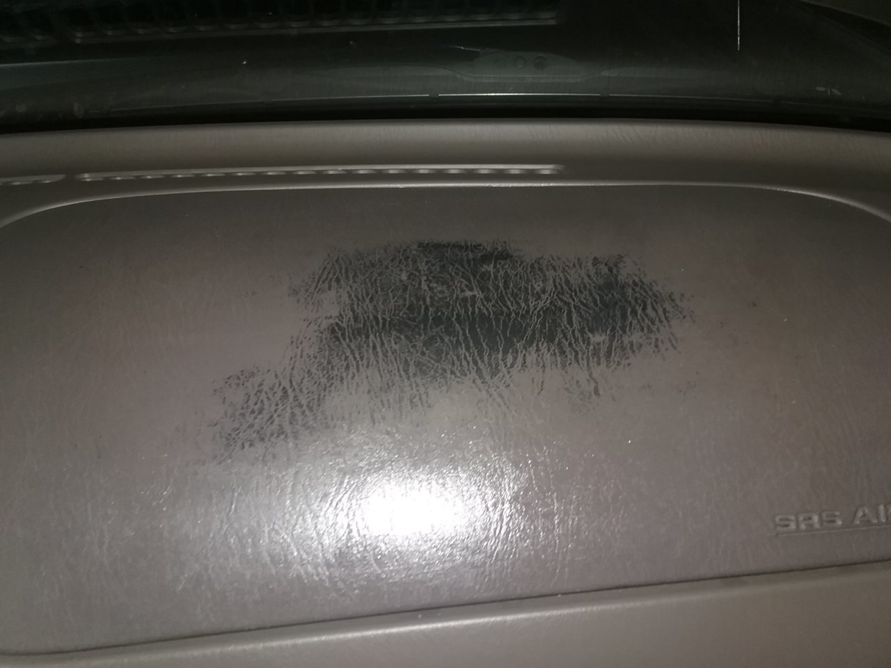

    A similar thing happened to my 02. I guarantee it was the solvent the tech used. I was cleaning my truck and my dad took a wet rag and started scrubbing on the airbag part of the dash and it started to remove the finish on the airbag
    YardBird[QUOTED] likes this.

    Sadly, you have explained exactly what happened to my airbag.
    When I picked it up from the first airbag recall there were sticky fingerprints all over its cover. Turns out it wasn't a dirty mess, it was the paint having been lifted and the black plastic showing through.
    The second go'round with the inflator recall sealed the deal and really screwed up the finish on that cover.

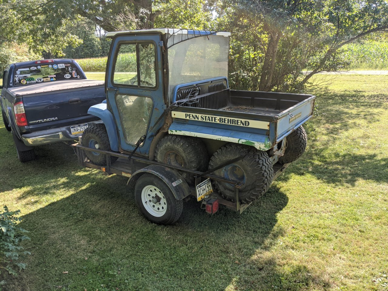

    Squeezed this fat bastard on the 5x8 trailer to transport back to work. Had to drop the tire pressure to 3psi to flex between the trailer rails.

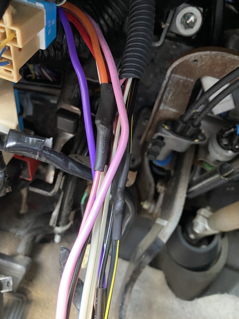

    Replaced a really poorly installed Clifford remote start / door lock with a new Viper 4105V system. Pretty much a one-for-one swap. Properly routed cabling, soldered and heat shrinked.
    Installed the safety mechanisms that were bypassed in previous system. Enabled safety cutoff when hood is open, using existing switch in the hood latch. Wired up the parking brake wire (remote start will not work unless parking brake is engaged).
    Then, implemented the TPMS warning light bypass: https://www.tundras.com/threads/tpms-bypass-shut-off-disable.52317/
    shifty`, bmf4069, NUDRAT and 3 others like this.

    I think a lot of people would be surprised at how many interior parts are painted for vehicles with non-grey/non-black interiors. Good part is, if you get stuck in a situation like this and the dealer or shop isn't willing to replace the part, or you do it to yourself, there are some great LVP paints on the market to refinish and make it look OEM, or as close as you'll get. I've tried a few on the market, ColorBond and SEM Products are the best I've found on the market if you ever need to go there. Had the closest match depending on manufacturer I was hunting for. ColorBond is probably best for the novice, using their base color and a topcoat with proper prep will get you looking like OEM again.
