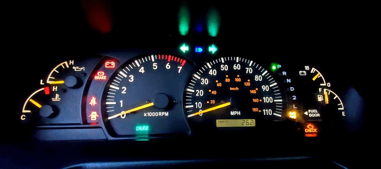

    Pulled the dash again to replace my mismatched color temperature bulbs.
    Had to stay up for dentist appointment for chipped toof...
    Sorry for shaky picture.

    Any chance you have a detailed list of the needed LED bulbs and where you got yours from?
    TIA!

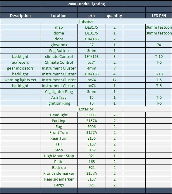

    Thanks @bmf4069! I did catch your list from the 1st gen info dump thread:
    https://www.tundras.com/threads/1st-gen-tundras-info-dump.52214/
    I was also able to find additional details from @Tundra2's earlier post:
    https://www.tundras.com/threads/tundra2s-lifetime-project.65626/page-3#post-1880278
    Shortening / mod for 74 bulb:
    https://www.tundras.com/threads/1st-gen-lunch-table-general-discussion.60450/page-231#post-1863953
    My main takeaways that he was putting in 4000k cool white LEDs, and some needed to be sourced from superbrightleds:
    https://www.superbrightleds.com/mor...d-led-miniature-wedge-retrofit-car/228/13213/

    I know @bmf4069 already covered it, and you did your own research...
    Here is a link to the thread that helped me, and the specific post.
    I ordered all my stuff from superbrightleds.com.
    Cool white bulbs get you a white look, natural white bulbs get you a warm white like an incandescent.
    Edit: I just saw where you saw my shortening experiment. That was a trial, and I determined there was no need in that. Measured OEM bulb in holder with LED in holder. Both were really close. I can't remember what the actual measurements were.

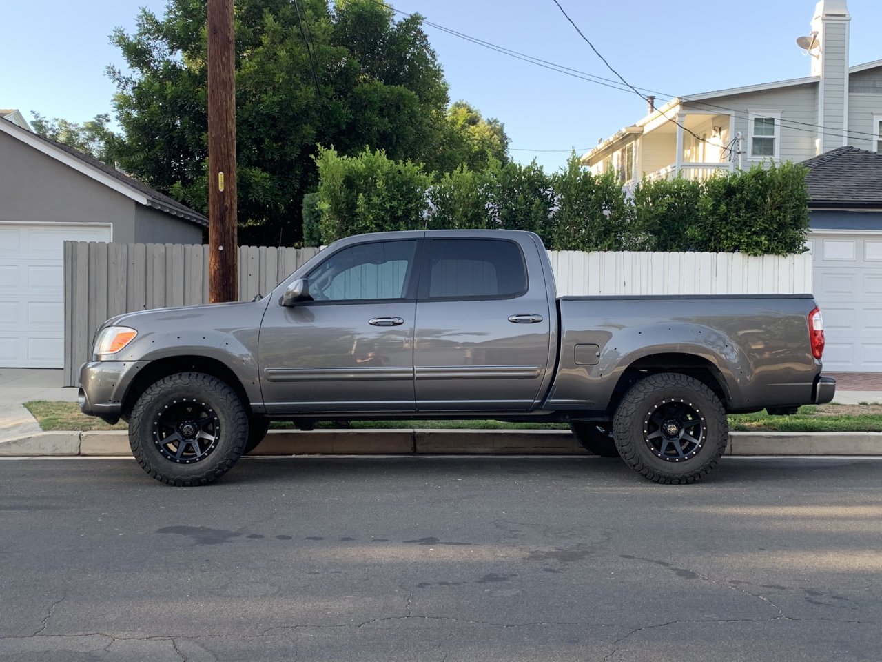

    New wheels and tires.
