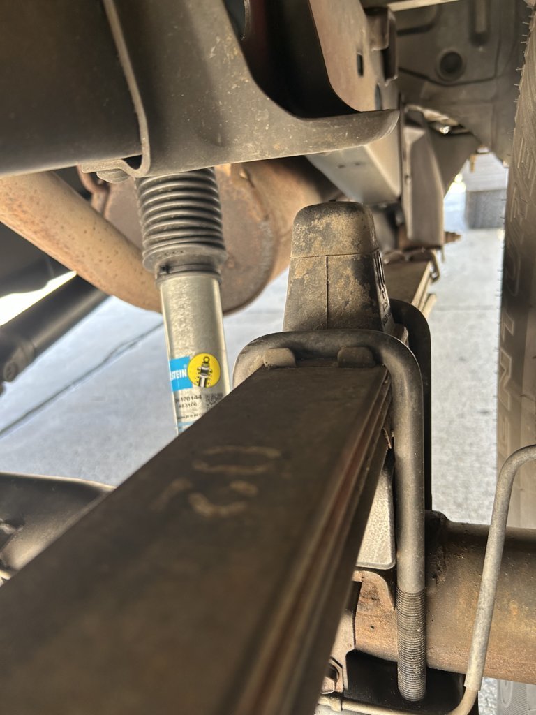

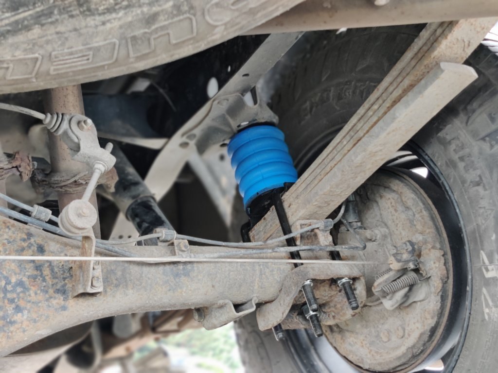

    Got the sumo springs installed! Rode good on the way home from the mechanic. I'll have my dirtbike on a hitch carrier and camping gear loaded up for the 4th of July so we'll see how it carries the weight and rides then but they definitely don't feel too stiff. My old bump stops rusted off long ago and the Ubolts were so rusted they had to be cut off.
    Also swapped the passenger and driver seat belts. They are identical. Slow retracting solved!

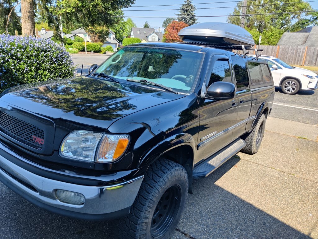

    Also picked up a rooftop cargo box. Pretty tall but the extra space will be nice on road trips

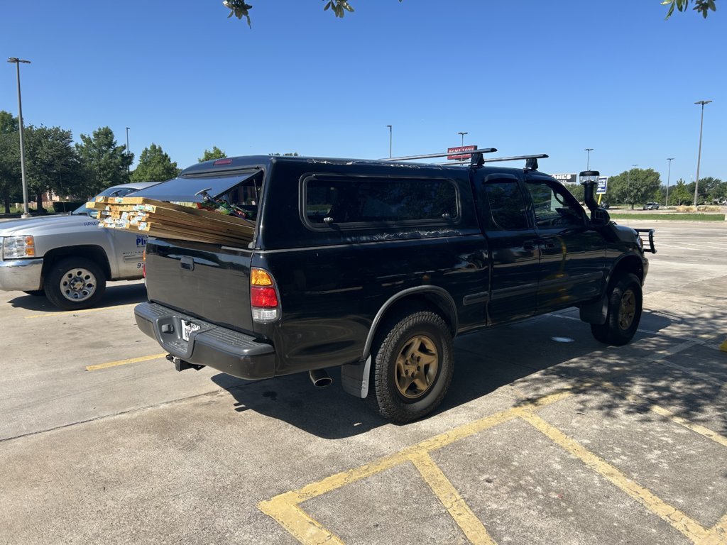

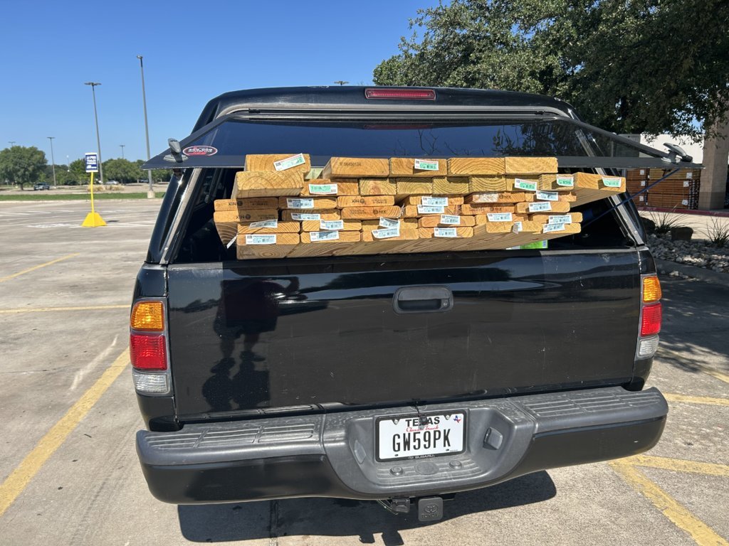

    Very nice. This was mine leaving the lumber yard. I really need to go ahead and do something with the rear

    Looks like it's handling things perfectly fine!

    I think those blue Sumo Springs are about right for what you're planning. How much does the bike weigh? They were perfect for me with a topper, gear, and my camper trailer with ~300lbs tongue weight. But they didn't hold up to the 860lb slide-in camper.

    Wow that’s great! My medium duty Deavers would be on the stops

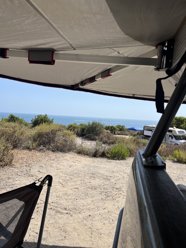

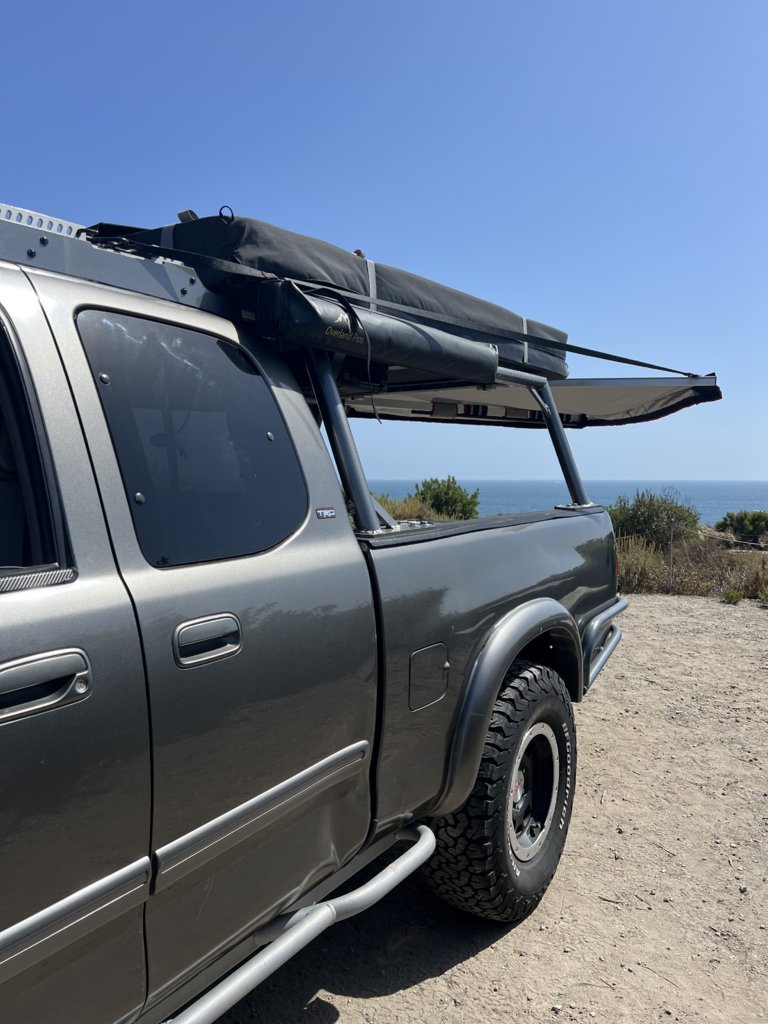

    Took her somewhere new this weekend. Used to primitive sites with no one around so it’s a little weird but different is good at timesIMG_1125.jpg IMG_1124.jpg IMG_1123.jpg
    I’ll be fishing for Halibut for breakfast. That’ll be a first off the coast too. Who said old dogs can’t learn new tricks lol

    That's a cool spot by the beach, is it crystal cove area?

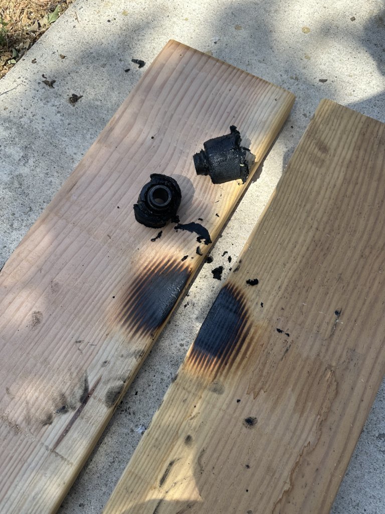

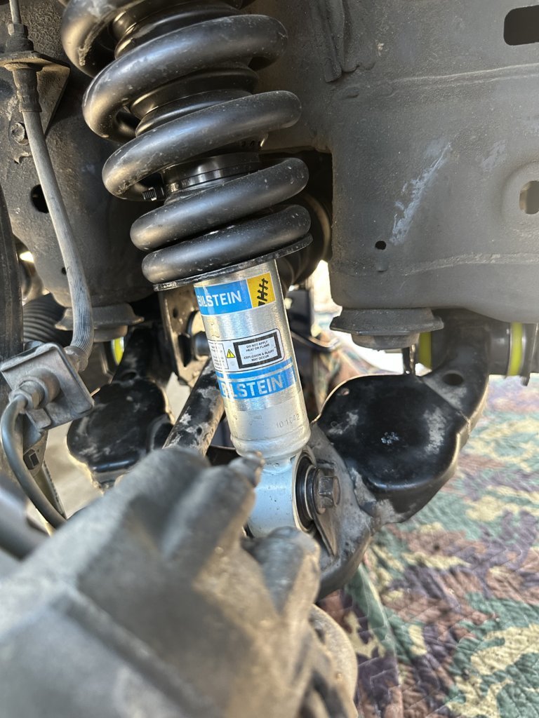

    Well that was my whole weekend, was only able to do passenger side as well as front differential bushings. Not fun having to cut and melt out old bushings. My alignment is so far off now as well and I can’t get one for another week because I have to do the drivers side. Hopefully it will be okay.

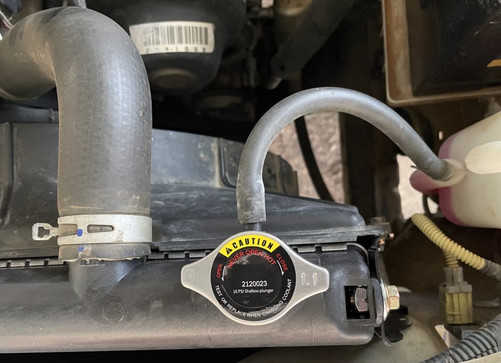

    New Denso Radiator (Jan 2025) cap leaking. So I noticed some antifreeze crusting on both sides of my cap and had a buddy of mine (who owns a radiator shop of all things) take a look at it. He took a look at the old cap and said it plunged ok but that it looks like there are a couple of small dings in it. For $10 he put on this 16PSI cap. I know the original is 88KPA (which I think = 12 PSI. I’m asking you guys if this is an issue? To me 4 PSI is no big deal but when dealing with/ such low pressure to begin with maybe it is. Anyone want to chime in?? I didn’t take a before but I did take an after.IMG_2234.jpg

    That would make me a little nervous. Sometimes on older radiators the plastic tanks crack, but sometimes its the glue that holds the aluminum in. I guess i’d block off the radiator, leave it in the driveway at 1500rpm, and let it get hot, like hot hot. If it can handle a bit more heat than normal, it oughtta be fine for a few years.

    I don’t trust AI but I think I answered my own question. This was AI response to my question “
    AI Overview
    A 16psi radiator cap is commonly used on Toyota 4.7L V8 engines, particularly in models like the Land Cruiser and Sequoia. For example, the 1998-2007 Toyota Land Cruiser 4.7L V8 and the 2008-2019 Toyota Sequoia 4.7L V8 both utilize a 16 psi radiator cap

    I wasnt worried about the engine, my concern was with the radiator, how many sq.in. Is the extra 4psi ‘pushing’ on?

    My plan is to drive like normal but keep a close eye on things for a while. Here are the radiator dimensions, etc…IMG_0859.jpg

    I'm pretty sure the optional "TRD" cap is 16 PSI. Not sure who all was buying that or what the purpose really was but it does exist.
