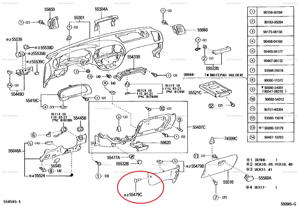

    Honestly I think I’d probably make some ABS slurry and weld it shut now I’ve thought through it.
    Good work! Remind me in an hour or two if I don’t post a part number. I’ll look it up.
    Classic! Disaster averted. Glad I brought it up! We see this misrouting a lot….

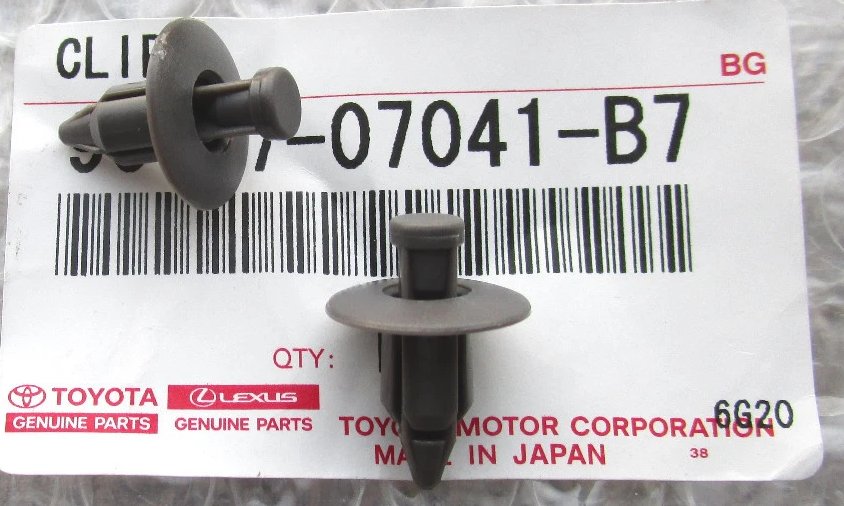

  5. May 26, 2025 at 1:35 PM
    shifty`
    shifty` NOT A NU JACK! NU JACK, NU JACK!
    Jun 20, 2020
    #48239
    31,286
    ATL
    '06 AC Limited V8/4WD
    I believe the base part number is 90467-07041-XX
    Where XX is your color code. Browns usually are E0/E1/E2/etc. and greys are usually B0/B1/B2/etc.
    I looked for another tan 2002 VIN to run, it happened to be roughly the same color as @NickB_01TRD and @KNABORES on the outside and tan-looking-to-me interior. It showed 90467-07041-B7. You be the judge. Circling the part in the exploded, in case that's not the part, that circle shows you what I just looked up, where this clip goes. If it doesn't appear to be the right color, try the same part but ending with E0, then E1, then E2 etc. Hunt for pics of the part on fleaBay, it's a great place to see the actual parts. If nothing shows up for the part number you input, try removing the hyphens.

    Thank you sir, that does look pretty similar! I'll look them up and order. And yeah looking up parts on ebay or even oem genuine parts is what I've learned to do to find actual pictures since toyota doesn't really have them on theirs, unless occasionally some independent dealership websites do. I recently used ebay to see a picture and to make sure I ordered the correct matching missing mudflap (as there are a couple different variations) from toyota.
    And the ABS slurry is a decent suggestion, I'll have to look into that further. But definitely happy with the results so far overall. Luckily the tape looks pretty inconspicuous and not that noticeable unless you look for it specifically.
  9. May 26, 2025 at 2:55 PM
    shifty`
    Jun 20, 2020
    #48239
    31,286
    ATL
    Some info - you'd want to do about half of the amount of acetone per ABS so the slurry is thicker. Recommend a Mason jar with metal lid. The metal screen or any perforated mesh to provide structure under would be worthwhile (EDIT: Make sure it's real acetone you're using):

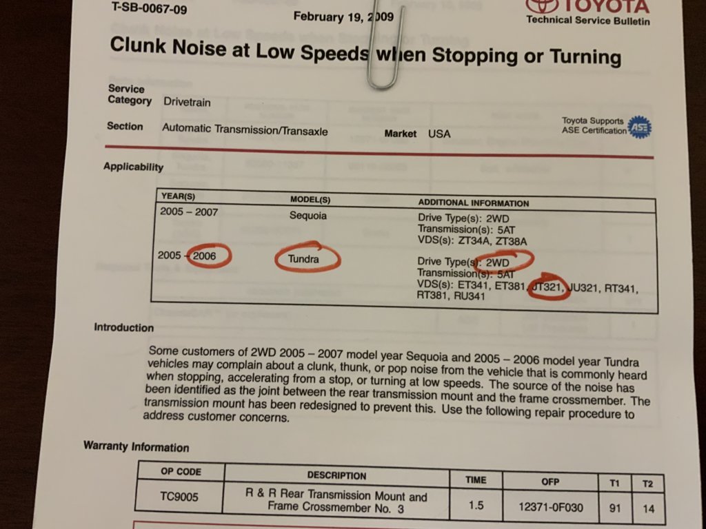

    Best Repair Ever…. So I was setting aside $930 for new Toyota Lower Control arms w/ bushings already pressed in as well as new eccentrics sleeves bushings etc… and no telling how much for labor to replace Lower Control Arms when I kept running across folks saying “check the transmission mount bolts”. And that the clunking noise is often misdiagnosed as needing new LCA bushings. Sure enough, I only have 3 out of 4 bolts in place and all 3 were loose. As far as I could tell the cross member didn’t have any cracks. “Holy crap!” That horrible sound that I heard when breaking or slowly pulling in or out of my driveway, is gone!!! Now I can really enjoy my truck.
    I do have a question, does this mean I need to order all 4 new bolts with washers or just the missing one? The TSB made it sound like the new bolts were different than the originals.IMG_0841.jpg

    I think the TSB only calls for replacing the crossmember itself, but if I were doing it I would just replace the bolts and washers as well since they are fairly inexpensive.
    MooreKen[QUOTED] likes this.

    I think you are right. I got confused after watching a YouTube video of a guy that had to replace the transmission mount bolts because the previous owner had put in some 3 inch bolts that didn’t fit properly.

    Yep. Tell us you didn't read THIS THREAD without actually telling us you haven't read THIS THREAD. :rofl:
    Dude. Go read that thread. Please. There's a reason so many other people know about this issue, and knew to repeatedly mention it in the threads you visited. You were literally prepared to spend $1,000 on stuff when the answer was right there in front of your face.
    We jam that "megathread" down everyone's throat for a reason. We're not trying to be annoying. We're trying to give you the "lessons learned" from dozens or hundreds of people befor you, so you don't need to suffer the same pitfalls.

    Don’t bust my balls too hard. I have read that thread soooooooo many times. Things don’t jump out at you some times. Hell, It was the suspension guys who thought it was passenger side LCA bushings making the noise. I’ve got so much info from you guys stored in my brain that I’m prepared for a million different scenarios if and when they occur. For some reason this one just wasn’t registering…. Lol

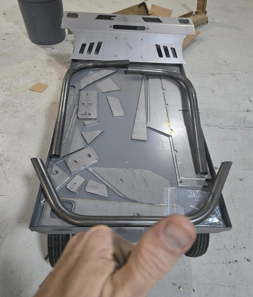

    It’s a late reply, but that (i’m guessing) 2x2 angle iron makes it difficult to bolt it down to the top of the bed rails. A stick of 2x3 would make is waaaay easier.
    EDIT: or maybe it’s 3x4 that’s easier? I’d have to go double check

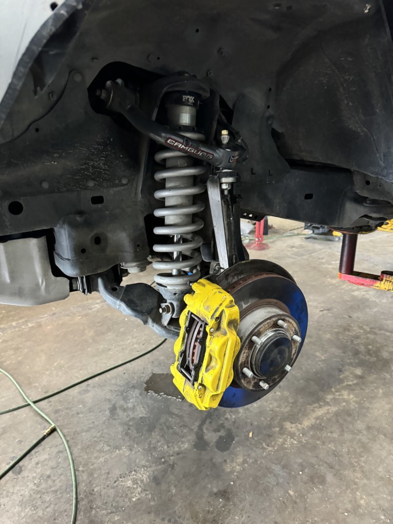

    New driver side hubs, wheel bearings, spindle, and spindle gusset.
    The Camburg slug that presses into the knuckle is a one piece that includes the lower misalignment spacer. Awful design. If the lip of the misalignment spacer starts chipping off you’re out for the whole entire kit. Slug, top misalignment spacer, bolt. $170….. spent a little more and got the solo Motorsports UCA to knuckle kit. 2 misalignment spacers and the slug for the knuckle. Swapped both sides and the truck drives smooth.

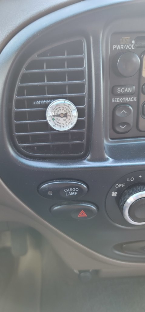

  27. May 27, 2025 at 4:40 PM
    Dblock500
    Dblock500 New Member
    Jan 23, 2025
    #129280
    366
    DMV
    2002 SR5 AC 4.7 V8 4WD

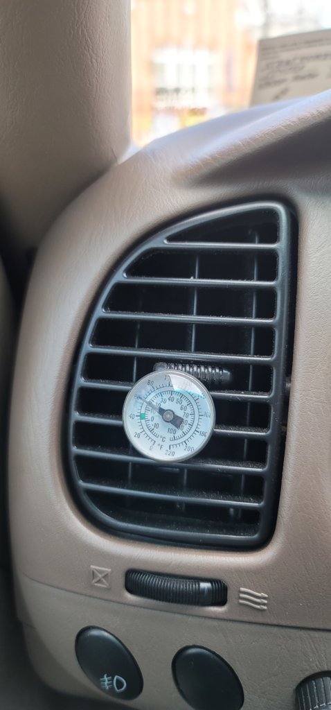

    While cleaning up my AC, I measured the temp coming out the vents at around 50 degrees at the lowest and even warmer from the driver's side vent. Is this comparable/on par to most of yall?
  28. May 27, 2025 at 5:17 PM
    Jack McCarthy
    Jack McCarthy My work anxiety is my morning alarm clock
    Nov 2, 2020
    #54409
    10,892
    Bill
    North of Boston
    02 Tundra AC SR5 V8 4x4
    What’s the ambient temp outside when you took the reading? That plays a big factor.
  29. May 27, 2025 at 5:31 PM
    des2mtn
    Jul 1, 2020
    #48721
    4,704
    On the Scenery, Looking at the Road
    2004 Black DC Limited 4x4
    Tonto cover
    I usually get 41-44 after a deep coil cleaning as well as a new condenser, expansion valve, schraders, and fresh recharge. I've recorded 43 degrees with up to 118 degrees ambient temperature while the vehicle was in motion.
  30. May 27, 2025 at 5:38 PM
    Dblock500
    Jan 23, 2025
    #129280
    366
    DMV
    Only around 70 degrees or cooler outside. It blows pretty cool, but not as cold as it probably should. Been meaning to take to an AC specialist and probably vacuum/recharge or track down any potential leaks
