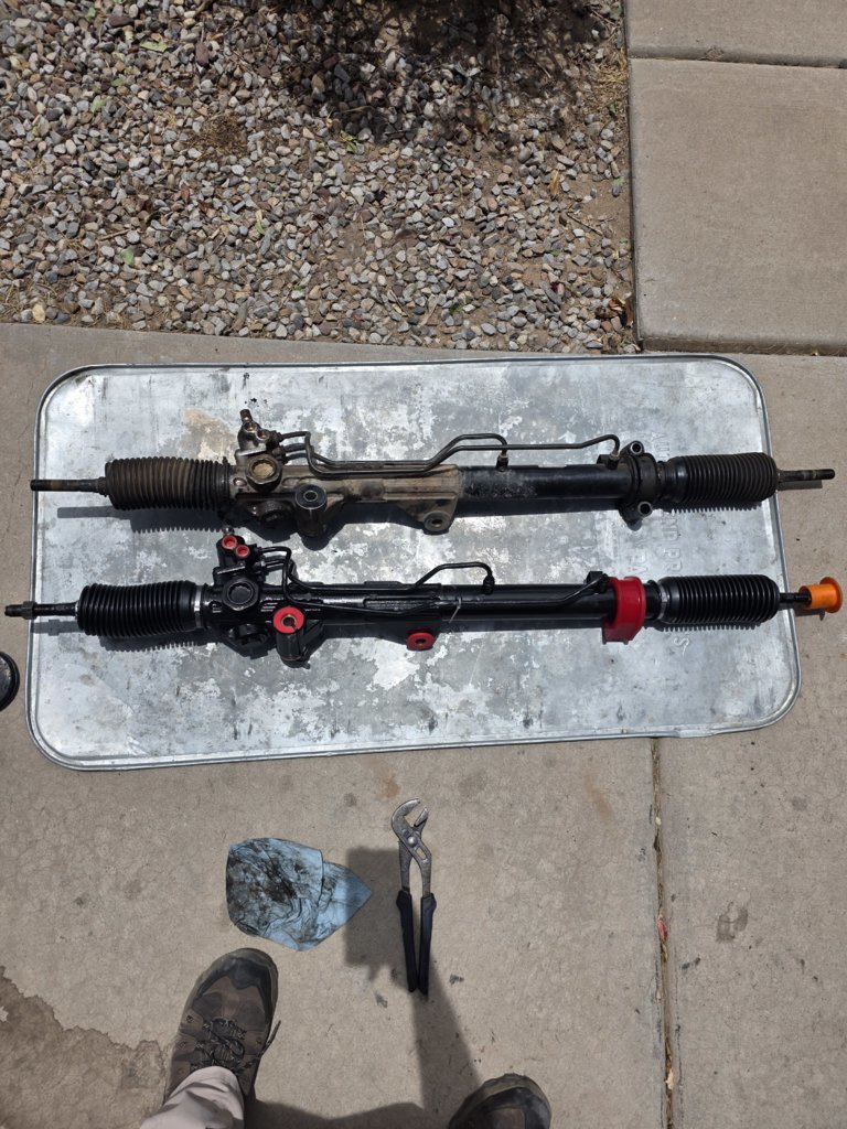

    7 hours later, new spindles, CV axles, and power steering rack. 20250524_130750.jpg 20250524_130741.jpg

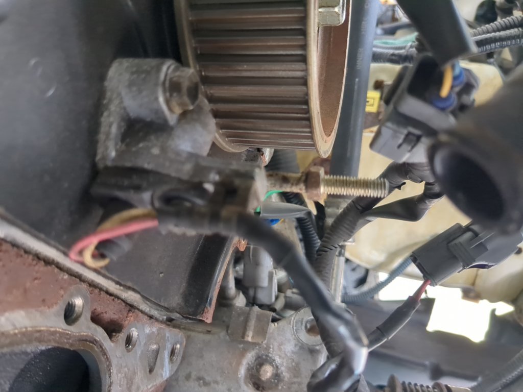

    Hopefully I don't regret it, but I'm chickening out on cam and crank seals as part of timing belt replacement. L cam rear cover has this stud that just wants to break when I try to turn it. Tried removing the can pulley to get access for vice grips but I can't seem to get it with a breaker bar and can holder tool.
    Crank has some rust on it that would have to be cleaned off. I think I trust the factory installed seals more than I trust my ability to install new ones.

    I get your reticence on the bolt. And impact may get you there with mitigated risk?
    Two things, common mistakes to avoid.
    1. Be careful not to pinch your cam position sensor wires with the water pump during install.
    2. Be sure to route the crank position sensor harness/loom BEHIND the pulley bracket during reassembly.

    Thanks, I'll have a think about it while cleaning the water pump surface. I went as far as putting the impact on the bolt before second guessing whether that was a good idea

    Well this is not ideal

    Ouch!

    Ooof. But hey! I see in the background you got the cam off!

    Yup. Just got back from buying some shiny new drill bits... Fortunately it seems like its just this side. Every other bolt came out nicely. I'm pretty sure this one is cross-threaded, possibly the seals were done in '06 and maybe it was cross-threaded then?

    Drilled it out and tapped new threads. Used the stud from the pass side to test. Not the best threads in the world but good enough for what they need to do. There's a chance I'll need to cut down the threads of the new stud a little as I was afraid of drilling too deep
