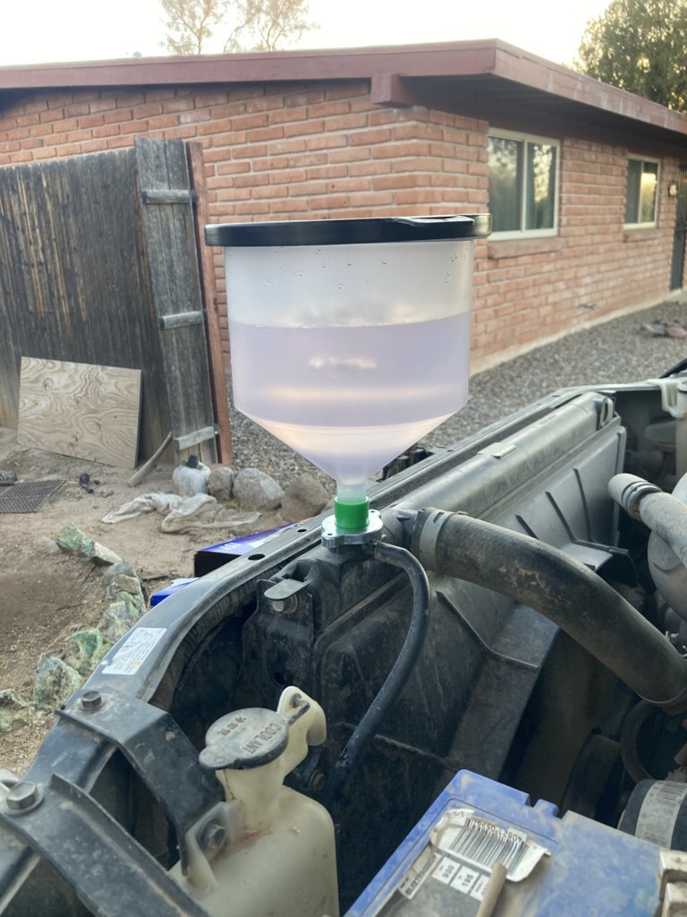

    Sep 15, 2019
    #36156

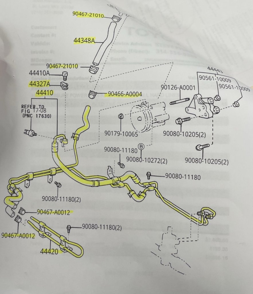

    This diagram should help, ignore the highlighted parts. They sell it on rockauto alone. dealer only sells it as a complete set. Hose connects to the the steering rack
    this thread has some info on the hoses and what ppl have done. I just fixed my leak from the reservoir
    https://www.tundras.com/threads/power-steering-leak.48461/
    Voss, Kimosabe[QUOTED] and shifty` like this.

    For the denso and koyo rad on RA. Part numbers are one off and pics look like the hoses are opposite.
    oscardog86[QUOTED] likes this.

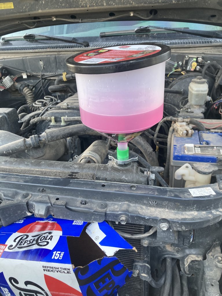

    I'm always afraid to put the cap on the funnel when I'm bleeding it in fear that it'll build pressure. I guess if you leave it open just a bit, it'll keep it from spraying fluid out as it splashes around. Good idea, I'll have to try it next time.
    What's your determining factor for knowing when yours need to be adjusted?

    Yeah the lid was loosely setting on the funnel
