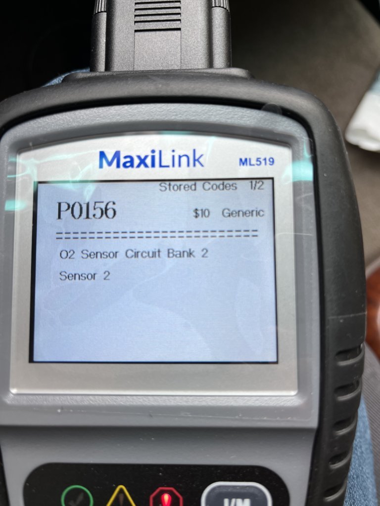

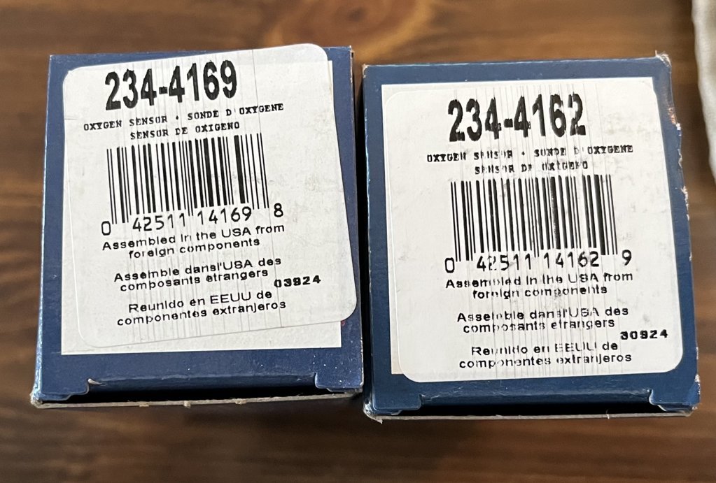

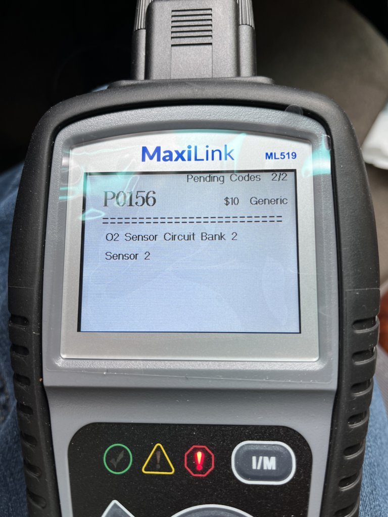

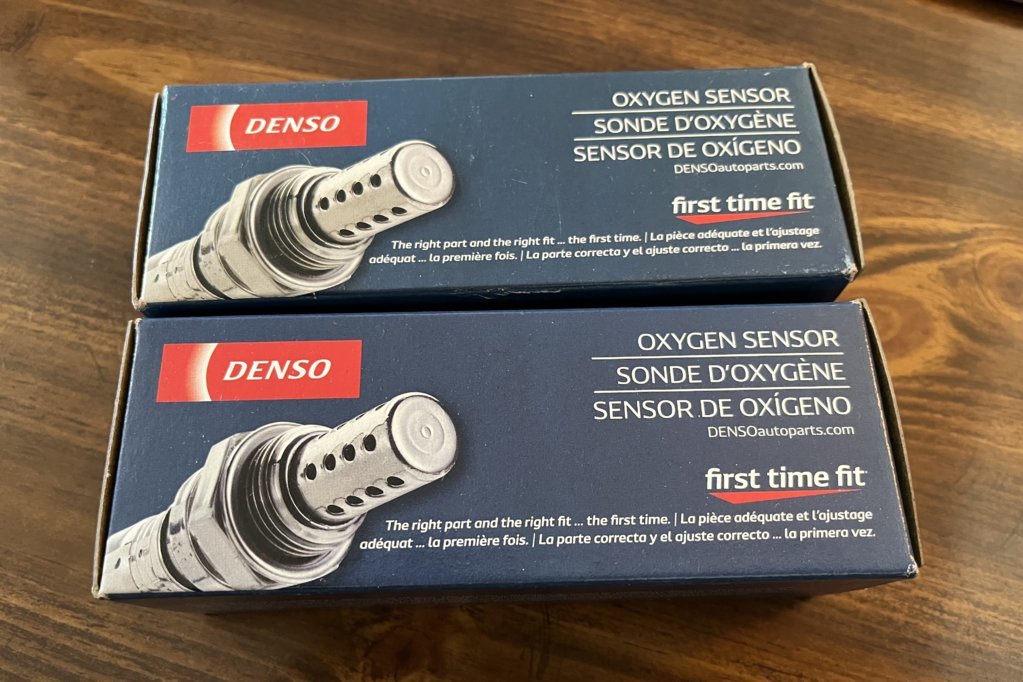

    Denso. Definitely the right ones. I thought when I was searching somewhere on this site people here were saying bad cat could cause an o2 sensor code, but maybe I read wrong. I'll keep looking into it. Possible I just need to tighten something down, but since there's snow on the ground I'm seeing what the possibilities are first.
    I guess first we'll see if the light comes back on. I cleaned the MAF when I first got the truck less than a year ago, so I kind of doubt that'd cause issues, but we'll see...

    Which code exactly? You can also check were the headers meet the cats for a leak or loose bolts because that can also throw codes.

    I'll check for leaks. Between getting a beater car and a new work truck, the Tundra hasn't been driving much lately. Which is the point.

    I'd also switch the sensor to the other bank and see if you get a code there instead.

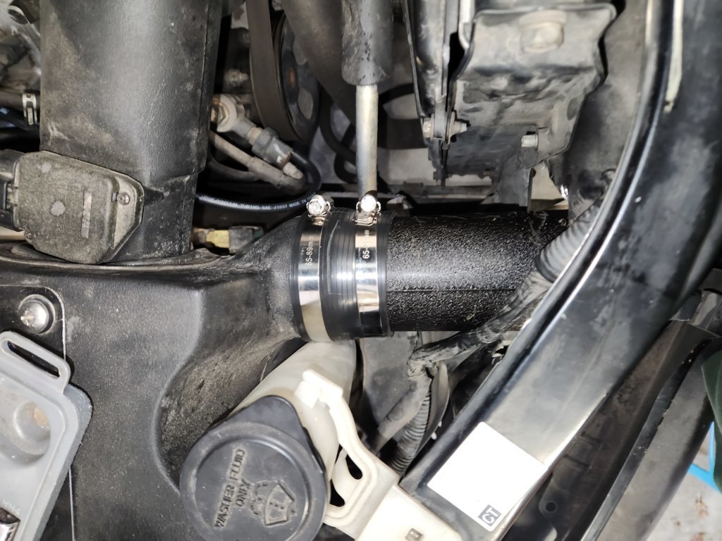

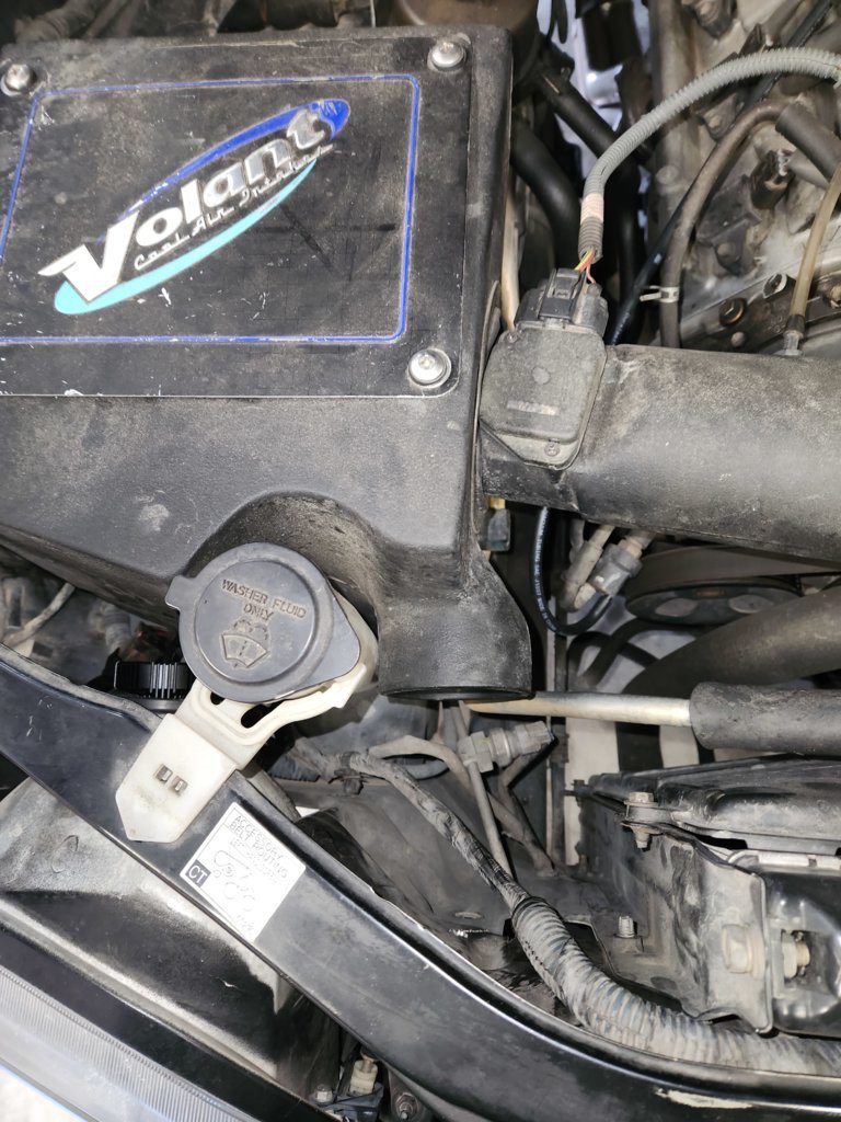

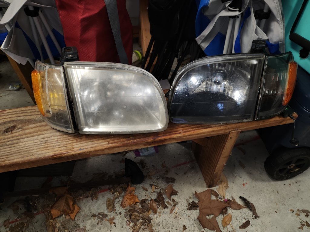

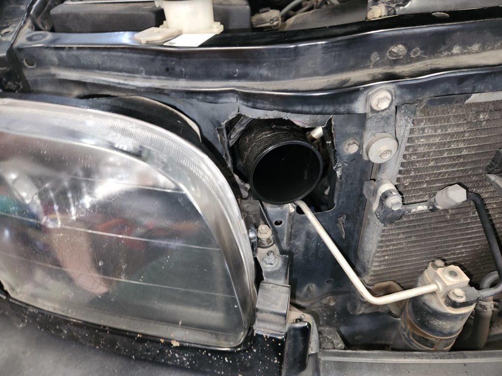

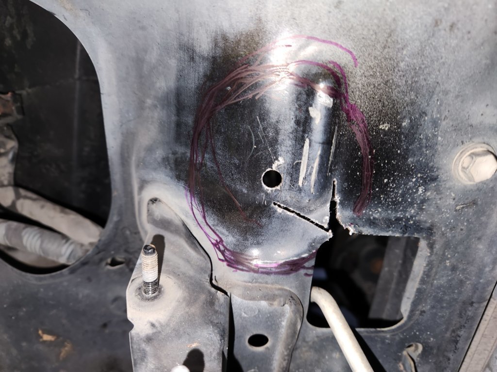

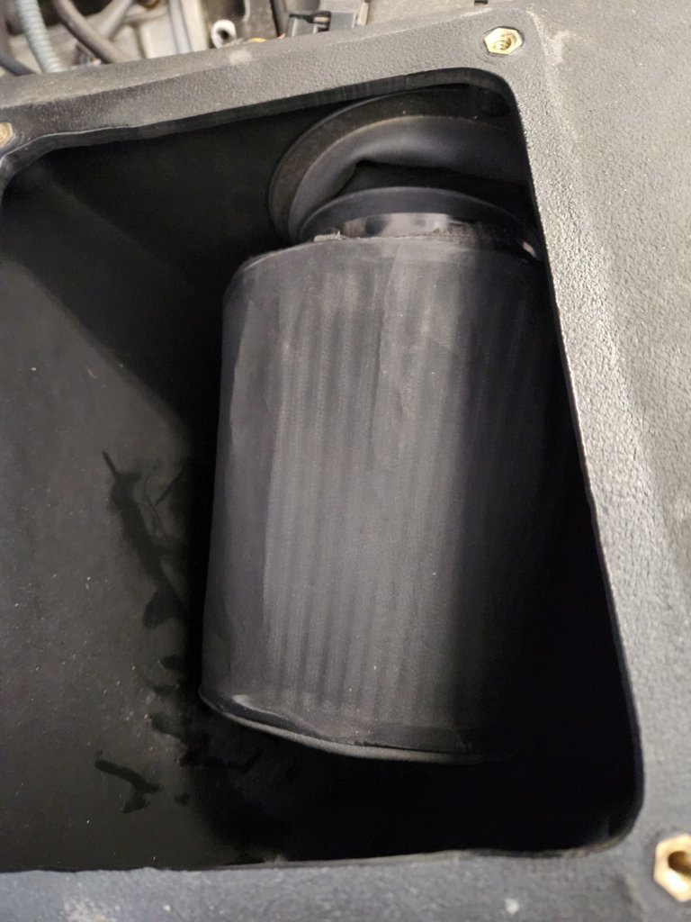

    Yesterday, while installing some new to me (used) black housing headlights and corners, plus CoLight LEDs, I got an idea. My tangent turned a 30 minute job into a 4 hour job lol.
    I walked a block to vautozone and got a 3"x6" plastic tube and a 3" coupler.
    I know my cuts are trash, but I'm a noob to metal (not the music :headbang: ) and I was working with what tools I had on hand: drill, hole saw, tin sheers, old angle grinder, hammer, sharpie, and channel locks.
    True cold air intake achieved. Volant makes some cool attachments for the front intlet to a wide flat scoop over the radiator on several vehicles. But of course not our trucks. I think it turned out pretty good. If I ever get a hood scoop, I think I'll plumb it to the top of the Volant box and seal the side inlet (OEM inlet location). Then it would have both front facing for a ram air effect. I thought about sealing the side as is, but I'm not sure the front inlet alone is wide enough. I also thought about using a velocity stack, but didn't see any at the store. I guess I should have walked across the street to check O'Reilly's. Oh well.
    Then I went to Discount Tire for some new rubber. I did a bunch of burnout on the old rubbers OMW there.
    Edit: I think next I may wrap the air box and intake tube in gold foil, then do the throttle body coolant bypass, and 05-06 intake manifold swap.

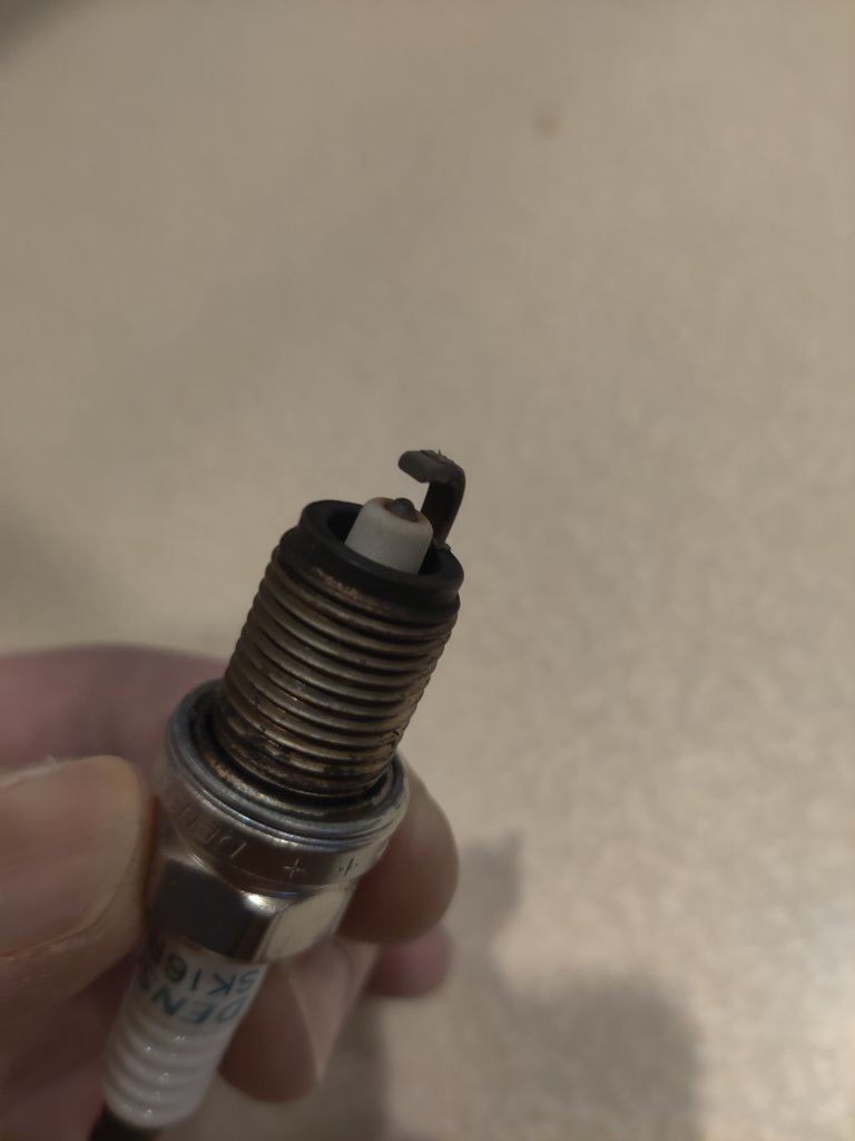

    IMG_20250130_165640.jpgheres a picture of the spark plug I pulled out SK16R11. Not looking too good haha. Running much better now that I got the right plugs in.

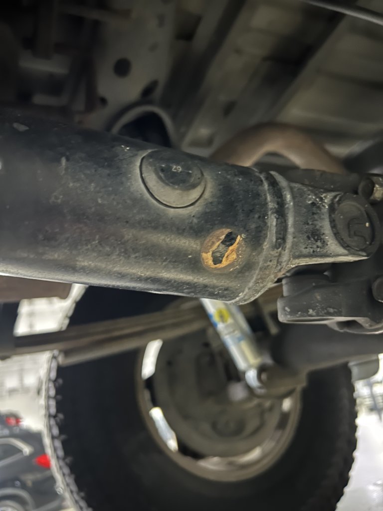

    I’ve noticed a slight vibration for the last few months. So slight, I really haven’t even been concerned about it. While underneath this morning to check my spare tire pressure, I found that my driveshaft was missing a weight. In the interim, I’ve stuck a quarter ounce wheel weight on there to see if that makes a difference.

    That’s a pretty cool fix. I need to chase my vibration down in the spring. Damn thing jumps around changing pavement type and sometimes temporarily goes away altogether. I think it might be my rear brake dragging after use but I haven’t noticed the drum getting hot. I hate these sort of problems.
