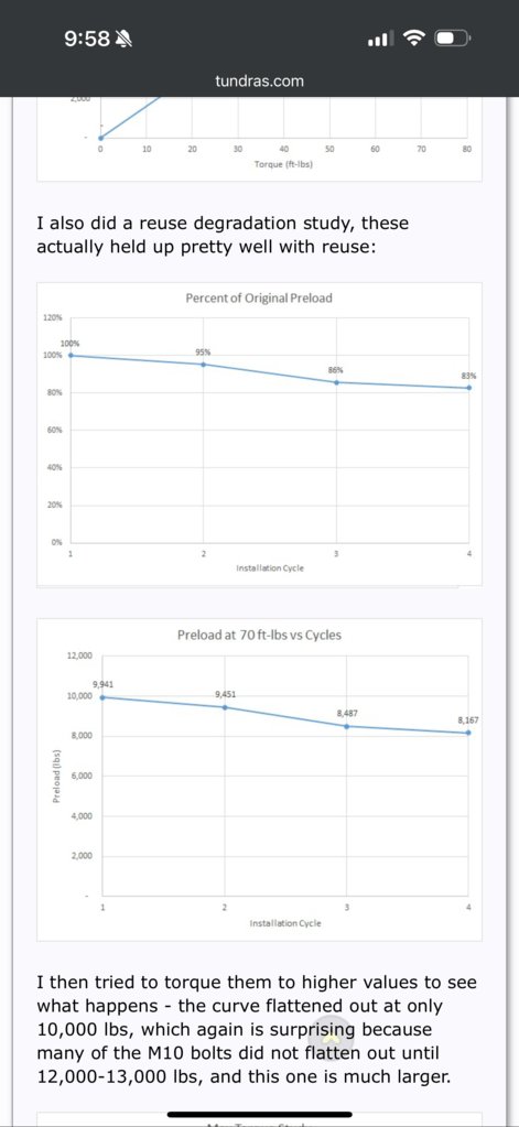

    Meh, like I said, I'm just being anal about it. Fresh gives me a better sense of security. Is it false? Maybe. And, like I said, if I absolutely had to for some reason, I would, but if I did, that thought would always be in the back of my mind :D

    I agree with replacing the bolts, however, technically, the Toyota service manual does not specify the need to replace them (i.e. one time use) like say head bolts.

    Man, I sure would feel stupid if I snapped a bolt that woulda only cost me $15-20 to replace all 8 of... and it did hundreds of dollars in damage...
    That said, I would probably re-install at least once if I torqued to spec initially.

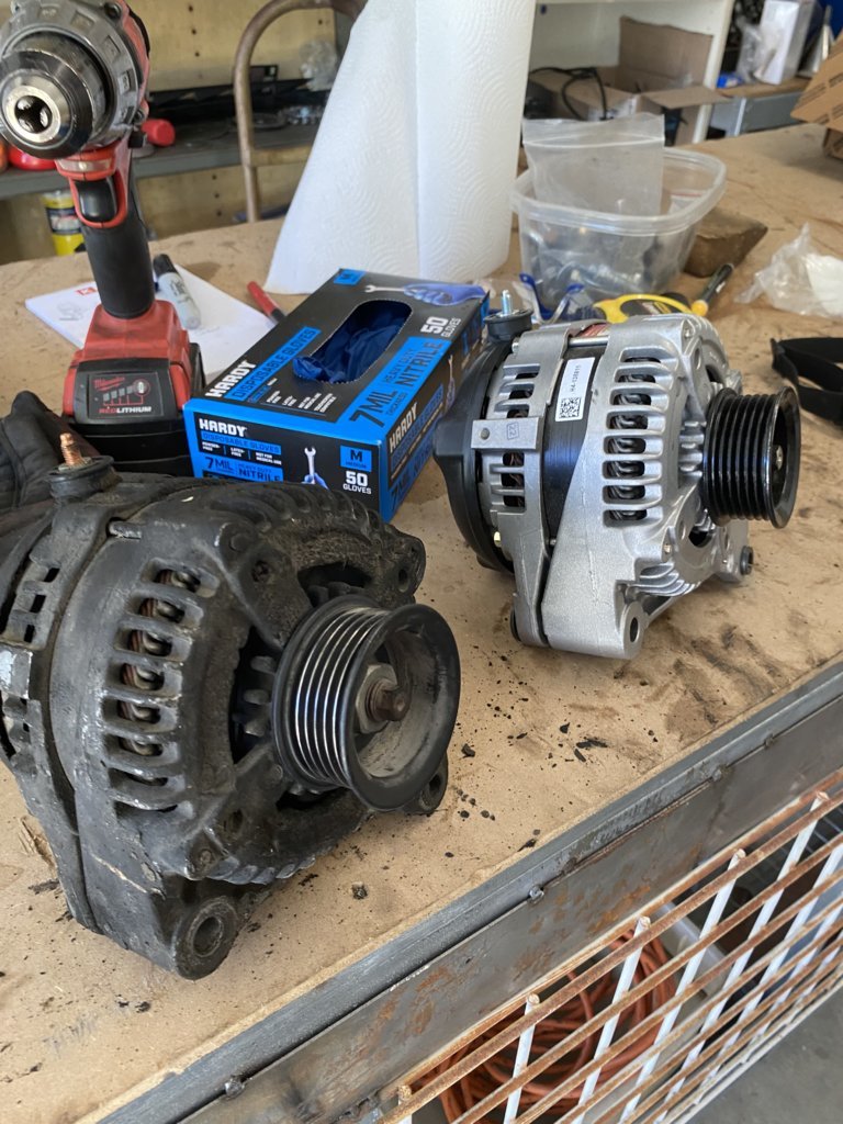

    Looks like mine. Gonna take it apart?

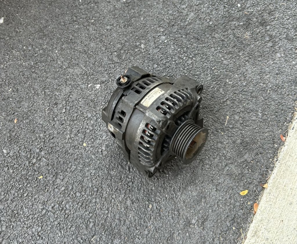

    Mine looked the same:

    Growing up I worked at my dad's shop. Directly across the street is one of the more reputable Alternator/Starter rebuilders in SA. So I'm gonna give it to them and let them work their magic.
    what did you do to clean it up? My is fucking CRUDDYYY lol

    I mean, Purple Power will absolutely get that thing gleaming. But you'd want to separate it b/c you don't want that shit getting down inside there given the electronics inside.
    But really, you should check and replace the brushes anyhow, so ...

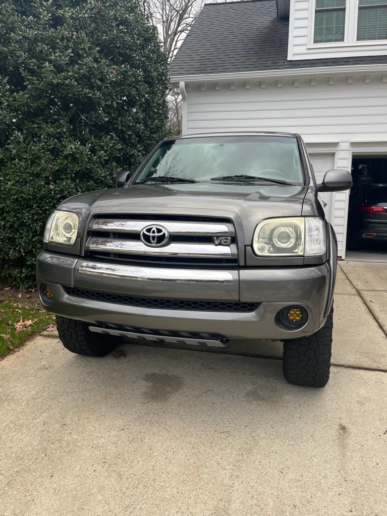

    Back and fixed. New bumper, new skit plate, new recovery hooks. Nice to replace the 19 year old plastic with new.

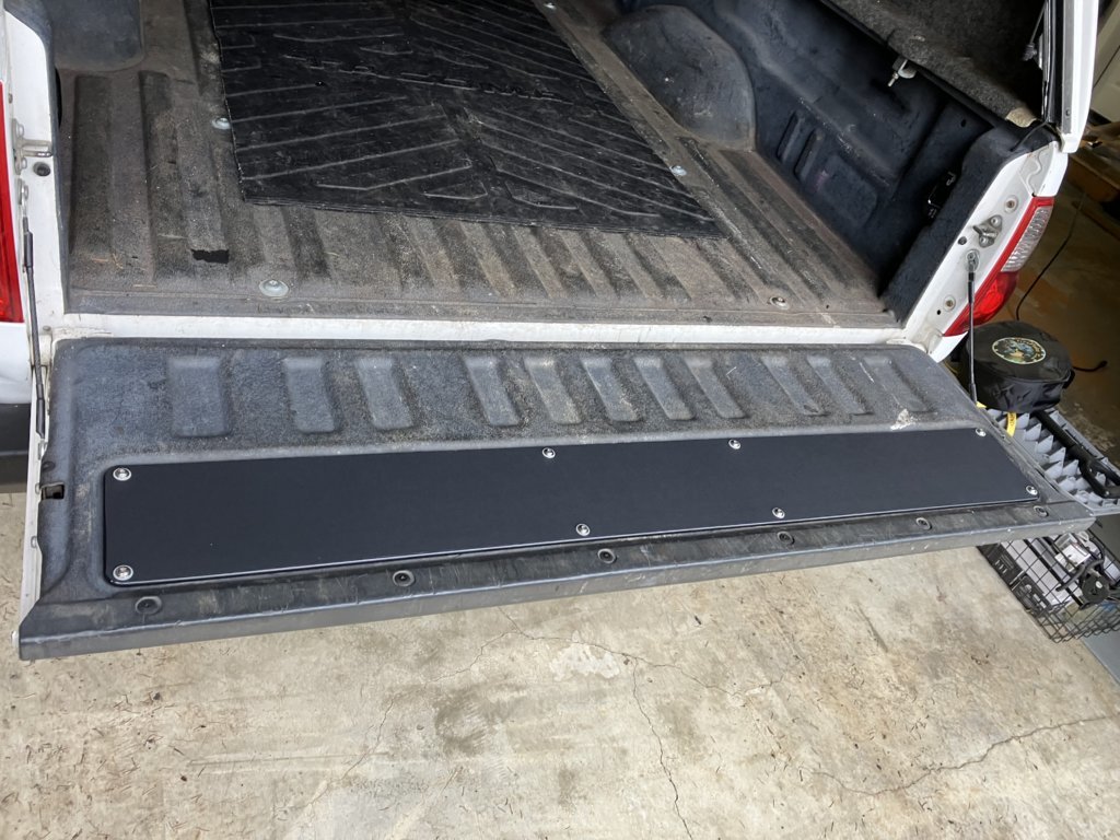

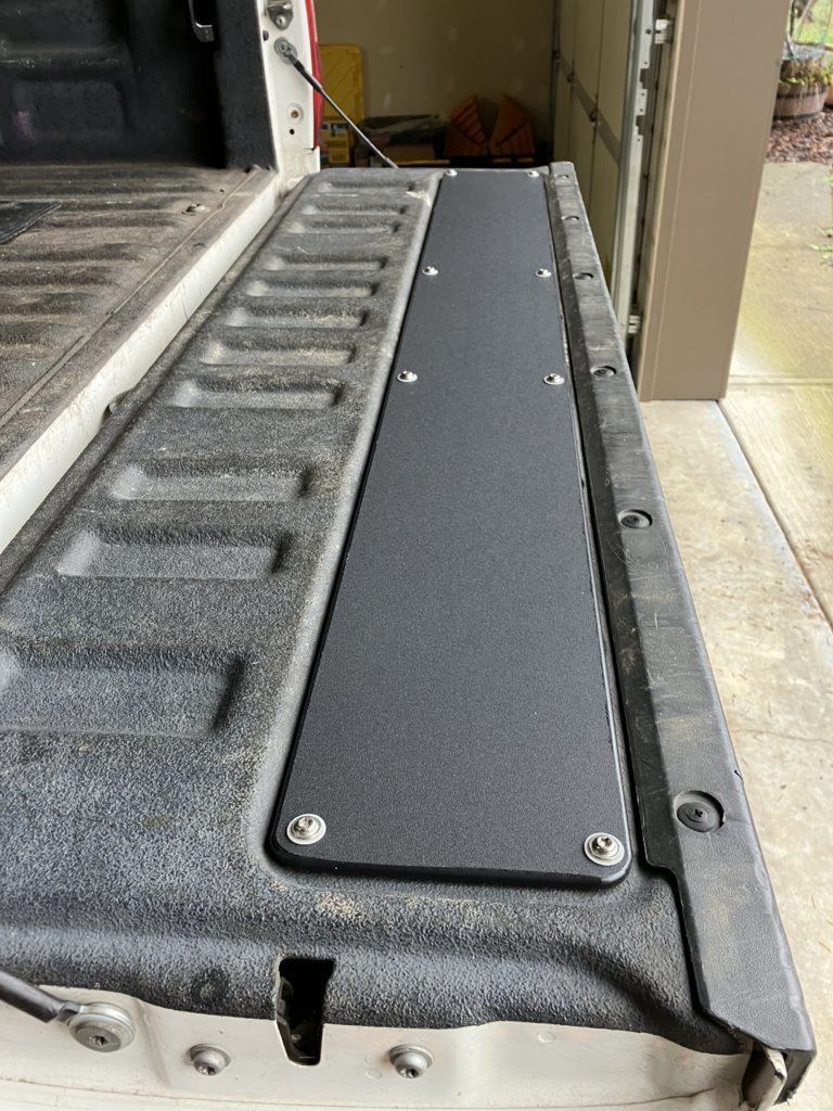

    It was a busy day when I posted this but wanted to also ask the crowd. Not pictured (hidden by the OEM fasteners) is the pre-drilled and countersunk holes. I was/am tempted to do torx security bolts flush to the surface of the board for a clean snag-free surface I can drag stuff across. Or hex or regular torx could work too. The problem I encounter is, stainless 1/4" are all machine screws from what I've seen. I could try #12 instead of 1/4 but not sure that's big enough to thread into the plastic retaining clips. @shifty` any advice on this one? I can get a photo of what lies underneath the OEM fasteners but it's just what you would expect, a countersunk divot which would take a flat head fastener nice and tight and be super clean.
    Ideally, 1/4 x 1" coarse thread flat head stainless torx sercurity sheet metal screws which is quite the odd fastener. Or maybe 3/4" long would do. I should measure the OEM ones.

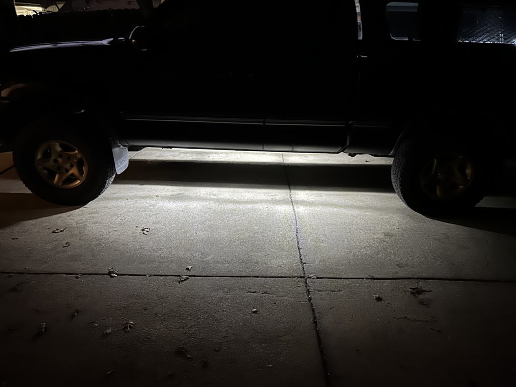

    Puddle lights wired to the cargo light switch

    How you do dat
    :eek:

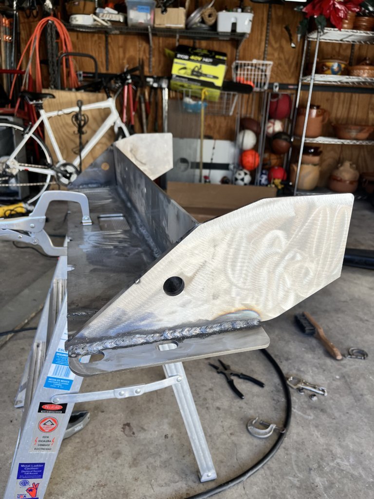

    Made a lot more progress today. These things take a lot of welding. I keep dealing with a misfeed/jam in the wire feed mechanism that I think may be when my contact tips get crudded up.
    Got it all tack welded together.
    The center bar has to be angled out slightly to fit on the bumper and clearance the hood.
    Angle-cutting freehand with a cutoff tool achievement unlocked. Don’t know how I’m going to do that in the side bars though that go over the lights. Probably a lot of error and error with a trial or two mixed in. Then I removed it from the truck and have been finishing all the exterior welds. There’s so much!
    Almost done. Should finish welding tomorrow.
    Really been a fun project.

    How heavy is that thang?

    Looking good. You going with the full brushgard over the headlights or keeping it like that? Mine looks like yours. Don't forget the little gussets for the grill hoop. :cheers:
