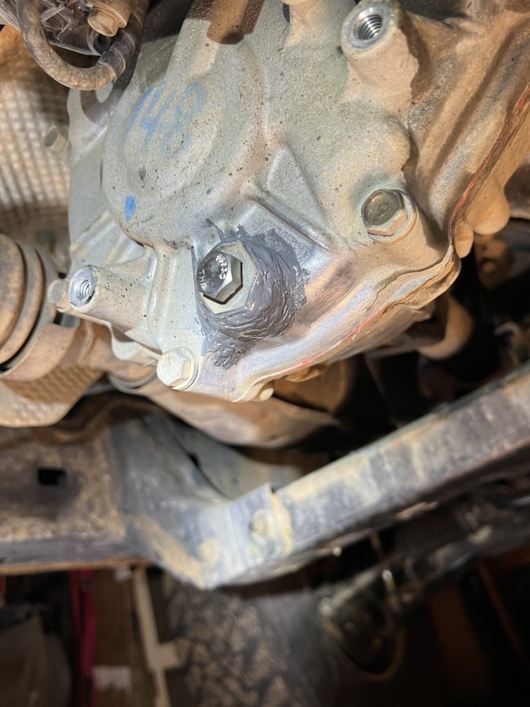

    I've never actually looked at our FSE, but mine is set to 31. Subaru calls for 31 on the non-turbos and 34 on the turbo pans.

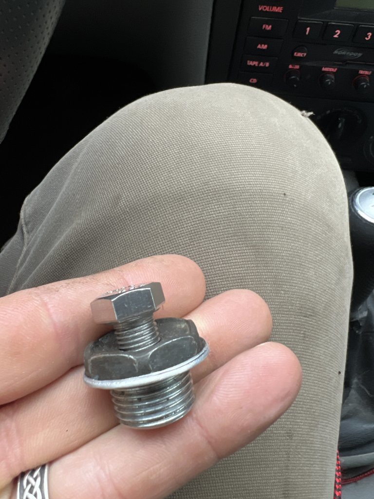

    29 us what it says, but that's one fastener where I go by feel.
    The Votex quick-drain plug I installed recently said "29 max!" on it. I set my torque wrench to 25 because I didn't trust it, and started to feel uncomfortable at what turned out to be closer to 23, so I left it and and it's sealing and holding up just fine.

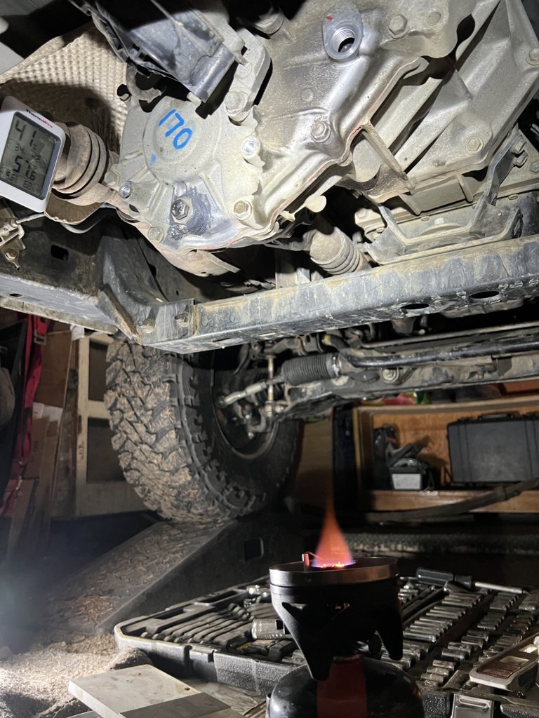

    Okay, I put 20 on this factory drain plug and I'm just going to keep an eye on it for the next week or so. If it leaks, I'll go up to 23.

    I have CDO tendencies and it drives me nuts when I either don't have a torque spec or when it's wrong. Obviously, what I don't want is a situation where it works its way loose like it did this time because whoever didn't torque it down at the last oil change.

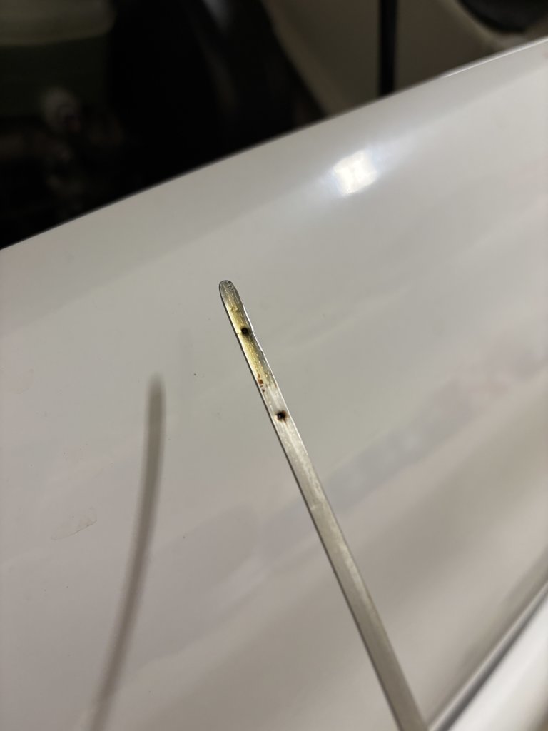

    Checked the oil today in prep for a 4hr round trip to N. GA tomorrow, scoping out a LV cabling and technology setup job for next year. Figured it was wise after swapping in the Pennzoil Ultra Premium a week or so ago. I’ve put maybe 100-150 miles on the truck since OC, still looks clean as can be. I expected to find a little more color in the oil, but not complaining or anything.
    I also noticed my fan shroud was missing the bolt closest to the battery. Weird. Popped the passenger-top bolt out to gauge it. If anyone is interested, it's an M5/0.8 looks to be roughly 25mm length with integrated washer in the shank and 10mm head, had one in my spares bin that will hold me over but it's +1 or +2mm longer. This style, with similar tip, but the tip is notched:

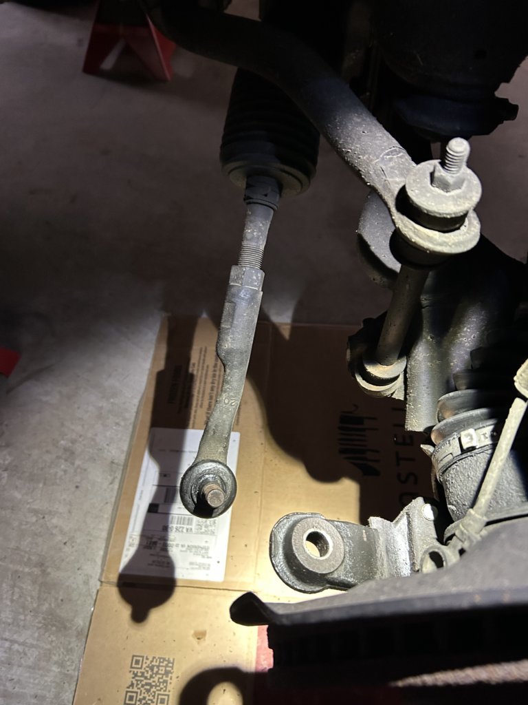

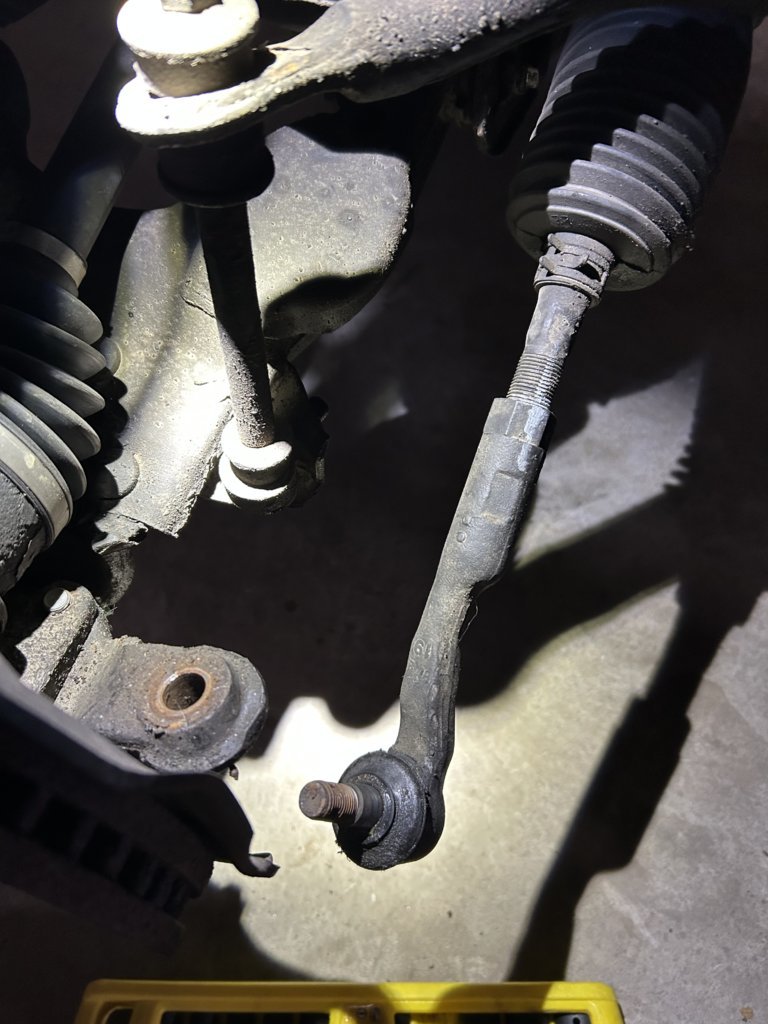

    My Koyo wheel bearing and OEM outer tie rods arrived last night (Yota Parts and Serra Toyota), just spent a solid afternoon under the truck.
    First, disconnected the tie rod ends on both side using the rental tool front end service kit from Advance. To my displeasure, the inners are drooping under the weight of the outers. I was hoping to just have to replace the outers but it looks like inners are needed. They have no in/out play though, what is the consensus on that? In/out or up/down as well? I have an appt. scheduled for the bearing and alignment at the local shop for the 23rd, but with the shipping time of Serra, they won't arrive in time so I'll have to push it back and the truck be down another week.
    Other than that, spent the rest of the time pulling the bushing out of the rack. The bolt near the shaft would not come out, almost like its bound up in the crossmember. I was able to hammer it in far enough to get the rack back and remove the bushing still. They weren't awful, definitely worn and cracked. Rack had plenty of lateral play when turning the wheels. Bought a tub of the energy suspension formula 5 and will slather the ES poly bushings and install them tomorrow.
    Oh, and while under there the valve covers were leaking...again. Went and tightened them back up ever so slightly (like super light), but reading the cracked t-case event above made me nervous...about to go check and make sure they're okay...
