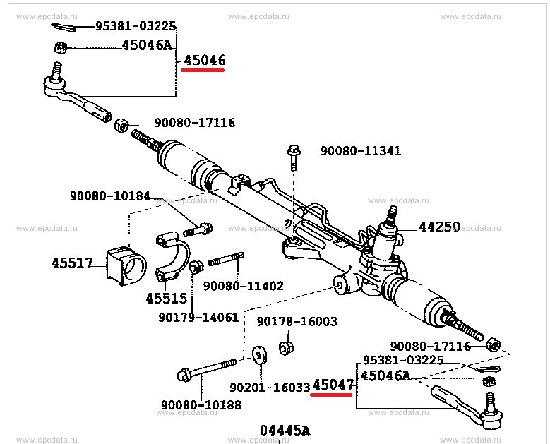

    Actually, just thought before I hit submit, does anyone know if the OEM outer tie rod ends come with the castle nut? If not, is this correct? Castle Nut #90171-14042 | Autoparts.toyota.com Assume so considering it shows the rack and TREs in the diagrams.

    Any time you're looking at EPC - and I'm not sure which you're using, I'm using the EPC-DATA one from the "how to find parts" sticky - you'll see one of two things. I'll post them both here.
    Multi-item display. See for 45046 and 45047 here, both for each tie rod, has a 3-prong fork coming off it, and there's one top-level number, with two lower-level numbers? If you click the 95381-03225 number, if ONLY gives you the cotter pin. If you click the 45046A number, it ONLY gives you the castle nut. If you click the top-level 45046 number, it gives you the part number for the package containing everything those three lines point at: Cotter, castle, outer tie rod.
    Boxed items. Sometimes in diagrams, you'll see Toyota box certain items in. Inside the box, you can click any number to only get that specific component. If you click the number outside the box, the number pointing to the box, it includes EVERYTHING inside the boxed area. For example, if you click on 44210 or 44240 in this EPC diagram, you'll get the part number for EVERYTHING shown inside that box, all the little parts. BUT if you only needed, say, the parts related to the worm-drive looking assembly with the 4 donut spacers inside, you could click "44201" and get just that. Or, if you only needed the spacer parts, you could click "44201B" to get that single part number. Hopefully this all makes sense. Parts lookup info for the tool I use is HERE.

    Makes total sense now, thanks Shifty! I was relying on what autoparts.toyota was showing, and probably spent way too much time on this than needed. I did order the whole kit it would seem now (45046 & 45047) and added the castle nuts in unnecessarily. So I emailed Serra to see if they could remove them from the order before shipping.
    Edit: Called them and they got me squared away, it is the kit and they're going to refund me the castle nuts.

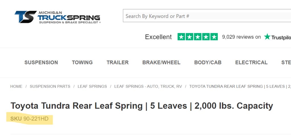

    Is there a reason you went with Michigan Truck Spring? Over General Spring, ATS etc.

    I did go with ATS 90-221HD, same as General spring I believe. Haven’t heard of Michigan Truck Springs

    Ah! Ok. Yeah I guess they all use the same part number. I googled 90-221HD, since that's all you had in one of your posts, and got truckspring.com
