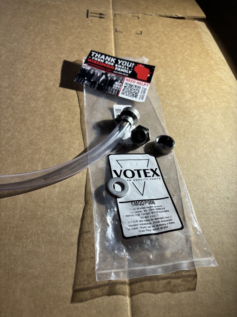

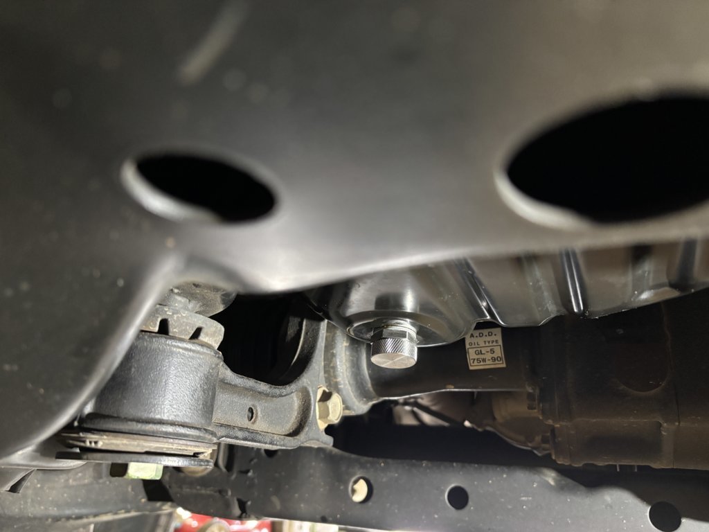

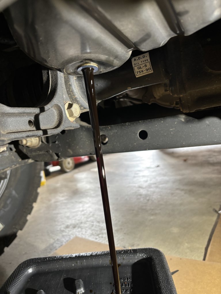

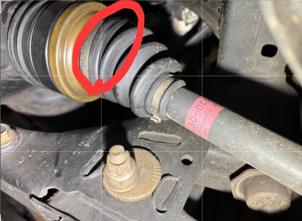

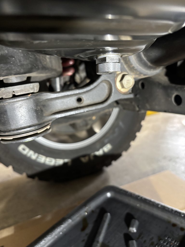

    Oil change. Installed Votex quick-drain plug. Clearance pics shown. I liked this concept more than Fumitomo, doesn’t sit quite as proud, and the easy-drain function is clever.

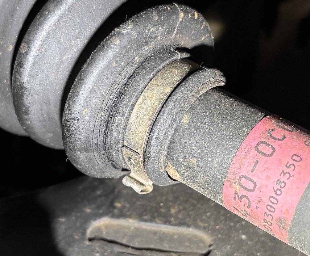

    Saw something unfortunate while under there, guess the added CV angle from lifting equals a reboot in my mid-future…

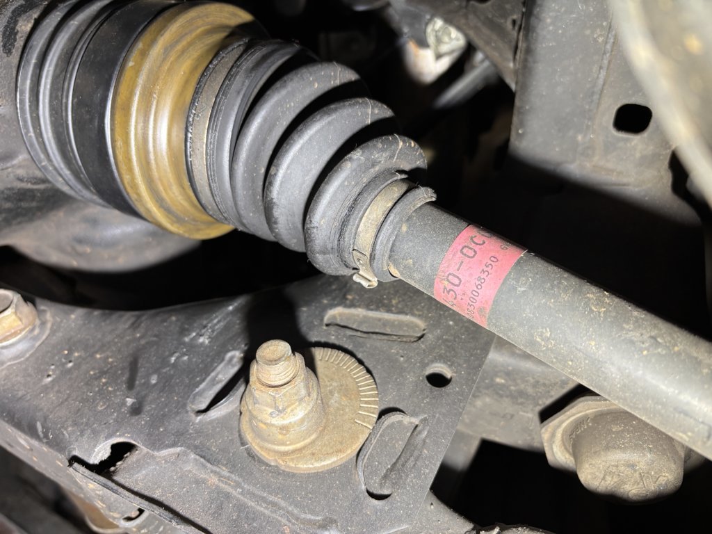

    Close-up on that thang. Starting to lose it, but it ain't tearing yet.

    Are those your original cv axles?
  12. Dec 8, 2024 at 2:38 PM
    shifty`
    shifty` Goons of Hazzard
    Jun 20, 2020
    #48239
    30,815
    ATL
    '06 AC Limited V8/4WD
    Yup
  13. Dec 8, 2024 at 2:52 PM
    FirstGenVol
    Dec 13, 2018
    #22934
    14,356
    East TN
    2002 AC TRD 4x4 V8
    The high angle boots have been working really well for me. No issues after 4 years.
    Someone probably sells them for less but this is what comes on the CVJ axles I bought.
    https://www.cvjreman.com/product/boot-rt50/

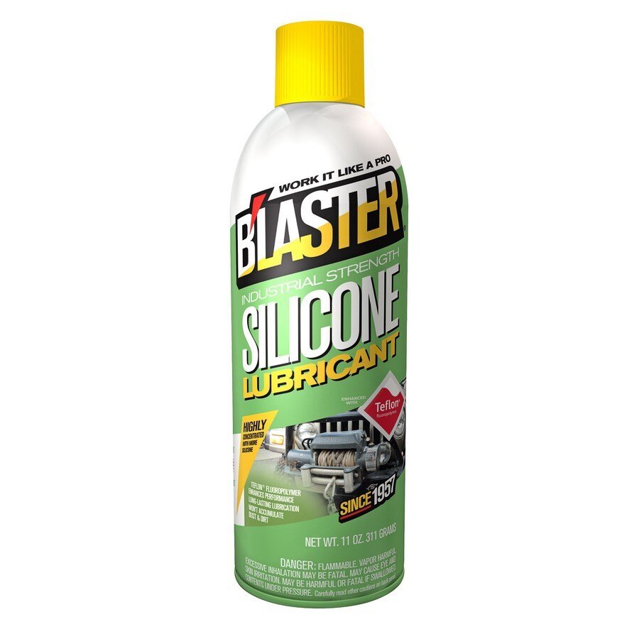

    What do you use for this and how do you apply. Spray silicone lube on the joint?

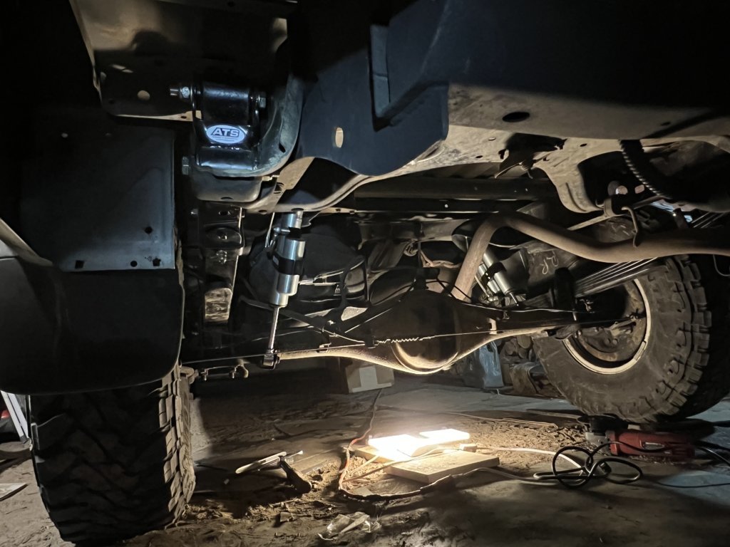

    I said I would post pictures but it got dark and I got distracted brushing off rust and hitting it with black paint haha.
    I took measurements with my topper and about 80 lbs of gear in the back from top of wheel well to center of hub. It turned out pretty dang level. I only added about a 1-1.25” lift in the front and I’m shocked I don’t have any rake. So I would assume your stock front end rake would only be 1-1.25” with a topper and level with the camper.
    Front Drivers 22, Front Passengers 22.25”
    Rear Drivers 22.25”, Rear Passengers 22”
    The really strange thing with the new rear shocks/springs is the difference in distance until the shocks bottoms out and the distance until the bump-stop engages. R-Drivers shock has 5” of available compression and 3.5” until bump stop engagement. R-Passengers has 5.5” of available compression but a bump-stop engagement barely under 3.25”. Somehow I have less distance until hitting the passenger bump but more available uptravel/compression on the shock.

    I use this, but I'm sure others are just as capable. And, yes, I spray it directly on the joints under the access panel in the cab. I've tried other types of lubes, but nothing seems to last more than 6 months or so.
