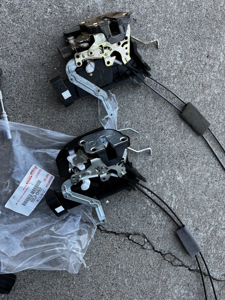

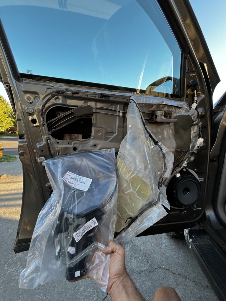

  5. Oct 6, 2024 at 6:47 AM
    noahrexion
    noahrexion New Member
    Feb 1, 2020
    #42020
    276
    Washington
    2005 4WD DC
    Lock actuator driver side - should’ve done it a while back.

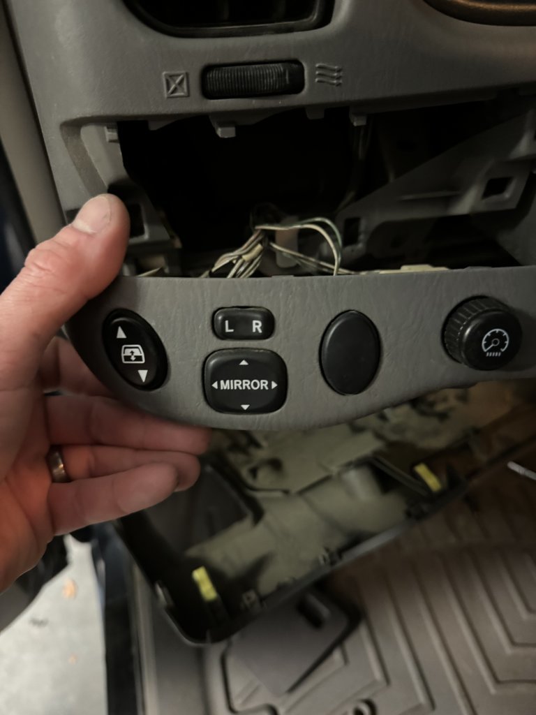

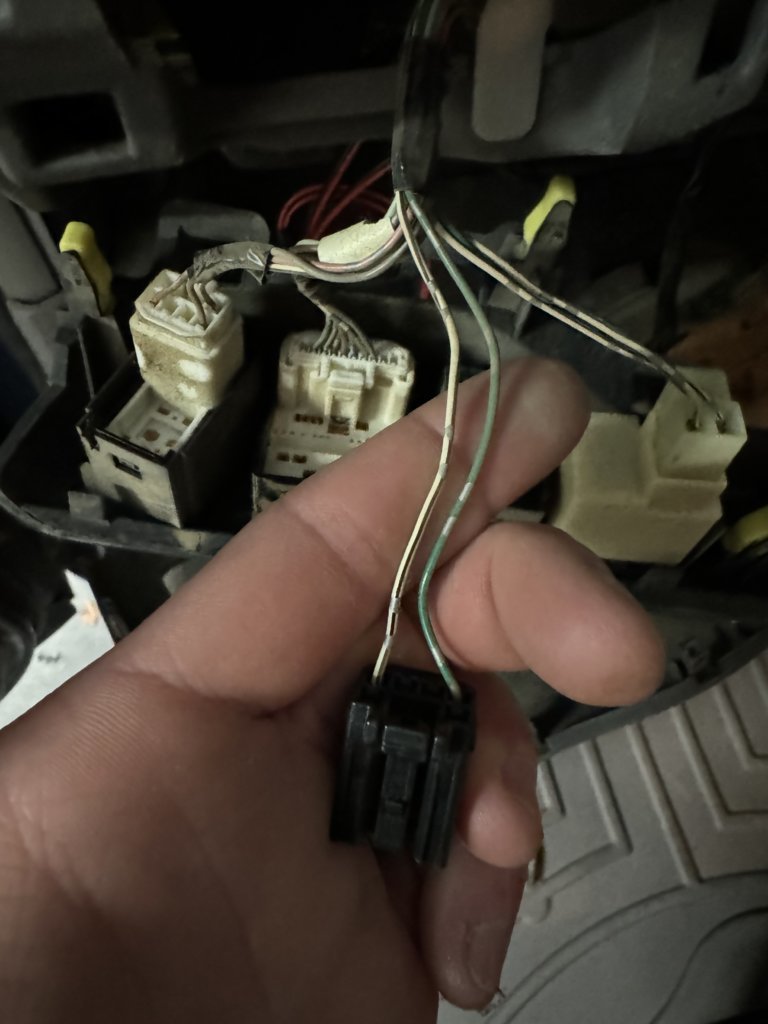

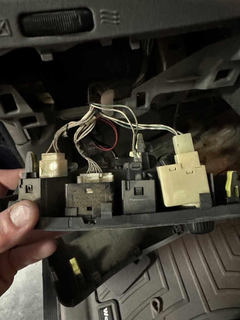

  7. Oct 6, 2024 at 12:01 PM
    Kimosabe
    Kimosabe Slacker
    Jul 28, 2020
    #50004
    1,223
    Sun Valley, Idaho
    06 Tundra DC TRD 4WD
    W.I.P - FOX 2.5 with DSC, SCS F5 wheels with MT Baja ATZ 285s
    I managed to get my ditch lights wired up. I had to get a new wire harness because I ripped mine during install. Harness was quite a bit thinner than the previous one. Both from Rigid.
    But, I went to install the button and there was a harness connected to the blank. Has anyone seen this, or know what it could be for?

  8. Oct 6, 2024 at 12:54 PM
    JasonC.
    JasonC. ¯\_(ツ)_/¯
    Jan 23, 2023
    #90779
    1,132
    TX
    2001 4x4 4.7L “Best Cab”/AC Limited 52k mi
    Might be the elusive dikfer I hear a lot of guys asking about on here.
  9. Oct 6, 2024 at 12:57 PM
    assassin10000
    assassin10000 New Member
    Oct 27, 2020
    #54157
    2,230
    Andrew
    Northern CA
    '05 SR5 AC
    Maybe heated mirrors?
  10. Oct 6, 2024 at 1:53 PM
    shifty`
    Jun 20, 2020
    #48239
    29,474
    ATL
    '06 AC Limited V8/4WD
    It’s for whatever function that button normally is used for. I have an AC or I would tell you. AC and DC are different on that panel. My AC order is different too.
  11. Oct 6, 2024 at 2:23 PM
    KNABORES
    KNABORES Sarcasm incoming
    Jan 1, 2020
    #40572
    14,277
    Arkansas
    What’s a dikf…… oh, gotcha
    BroHon, Kimosabe and FrenchToasty like this.
  12. Oct 6, 2024 at 3:34 PM
    Jack McCarthy
    Nov 2, 2020
    #54409
    10,472
    Bill
    North of Boston
    02 Tundra AC SR5 V8 4x4
    Is that a working switch in place of the blank or is the blank still fixed?
    If the blank is still fixed, what are you using for your ditch lights switch?
    FrenchToasty likes this.
  13. Oct 6, 2024 at 4:05 PM
    NUDRAT
    NUDRAT 6 lug life
    Dec 7, 2018
    #22736
    3,318
    SW CT
    Between 'Ridgelines'
    That spot is the on/off switch for the side airbags. Dunno what color wires they would be if that's to them.
  14. Oct 6, 2024 at 4:13 PM
    FrenchToasty
    Sep 15, 2019
    #36156
    18,504
    Mo
    The SoAz….. big surprise
    Bone stock
    Rear side curtain airbags. Our 4r has that switch, supposedly for high angle off-roading so the bags don’t deploy
    NUDRAT[QUOTED] and Jack McCarthy like this.
  15. Oct 6, 2024 at 4:14 PM
    Jack McCarthy
    Nov 2, 2020
    #54409
    10,472
    Bill
    North of Boston
    Toyota lets you turn on and off their side airbags as well? Way to make your passenger behave!
    That makes a lot of sense.

  30. Oct 7, 2024 at 8:30 AM
    Kimosabe
    Kimosabe Slacker
    Jul 28, 2020
    #50004
    1,223
    Sun Valley, Idaho
    I am using the blank to put the switch for my ditch lights. I installed the switch and left the wire harness to the side for now.
    That’s what I thought but was hoping maybe it’s for heated mirrors. I’ll check out a EWD and see if I can come up with some answers.
