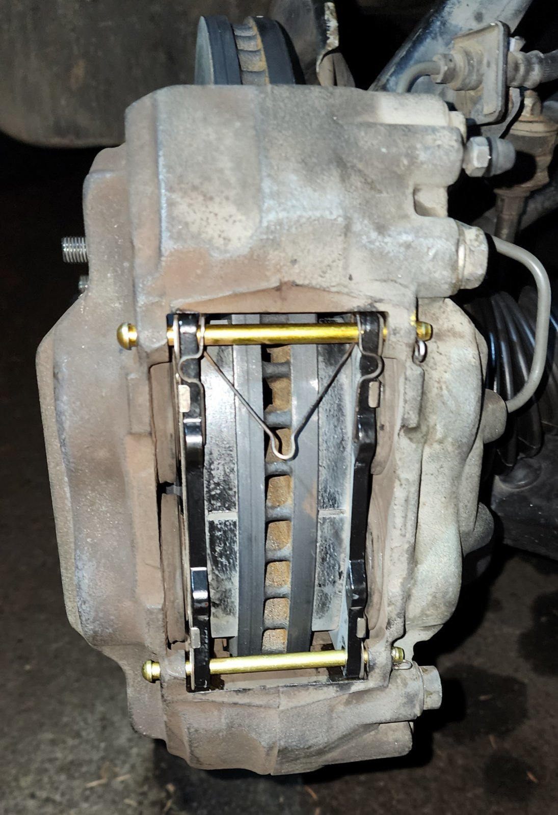

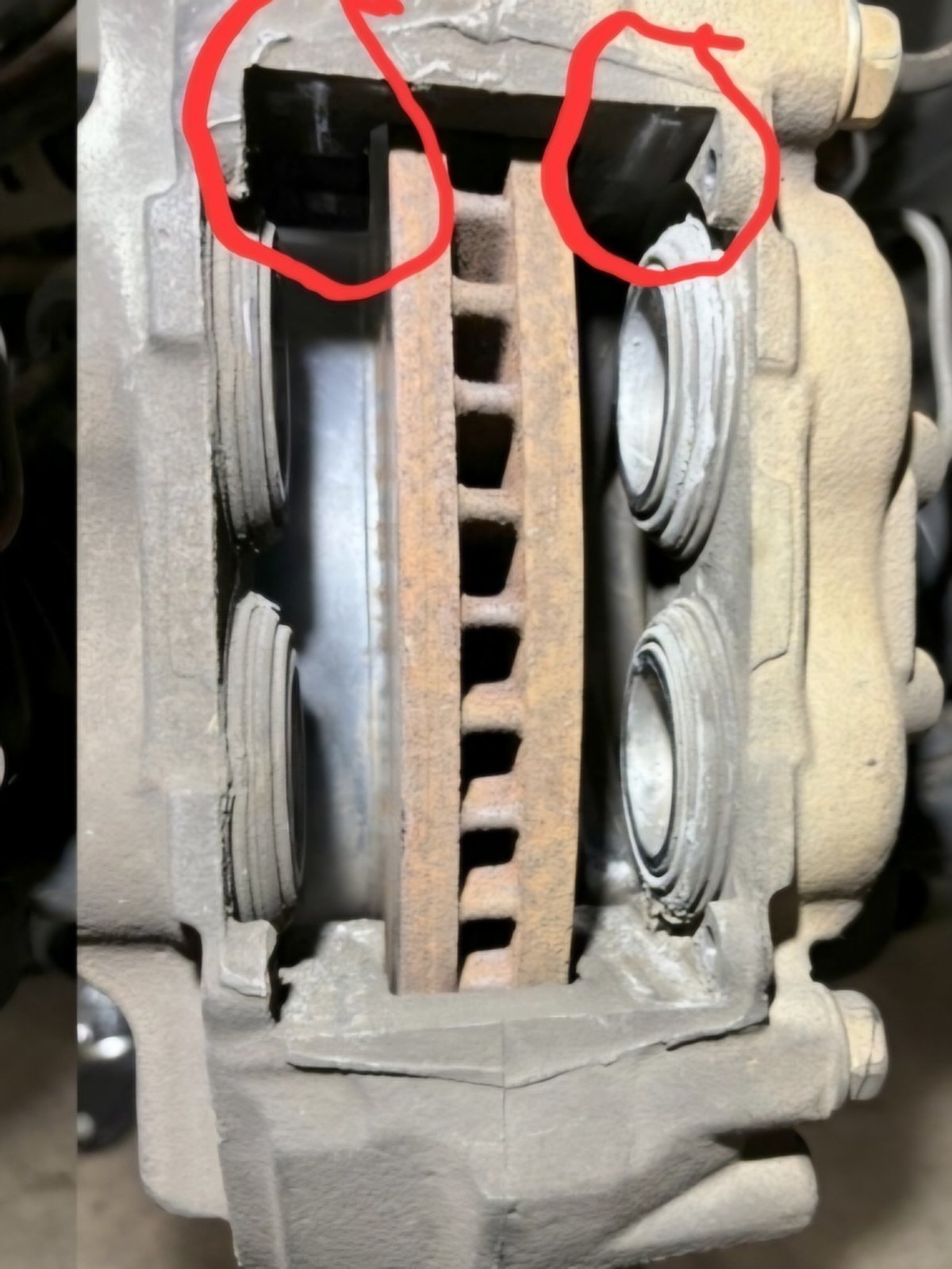

    Same single clips here too. Yes one spreader on top. But 2nd one just came in the mail to add 5hp.

    Yes suggest one until troubleshoot the sounds. IIRC OEM spreaders are like $2 pair OEM or Advance Auto pins aren't much either.

    Are the shims greased between the pads and shims? All rust removed and grease at the points on the calipers above and below the pads as shown if look closely in the FSM diagram? This TSB is for Tacoma but shows it in more detail.

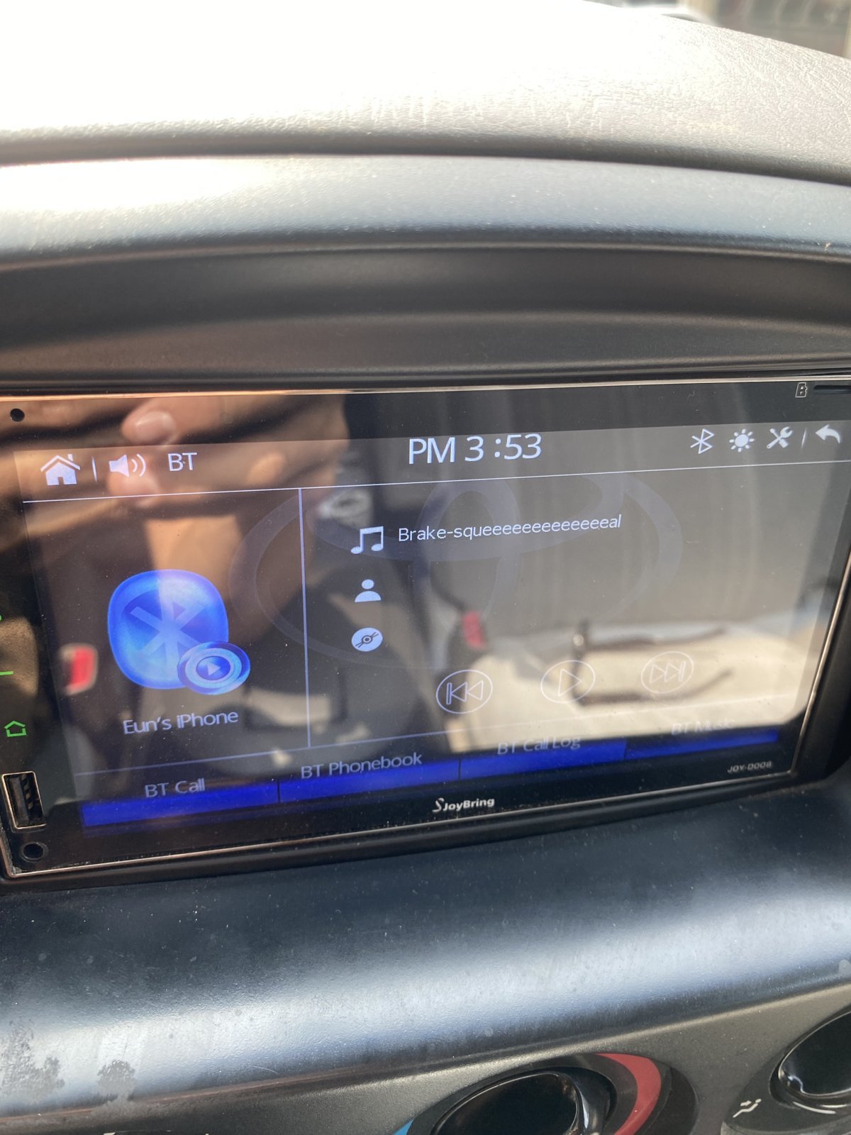

    That's the problem. Stereo is stuck on that track only in reverse.

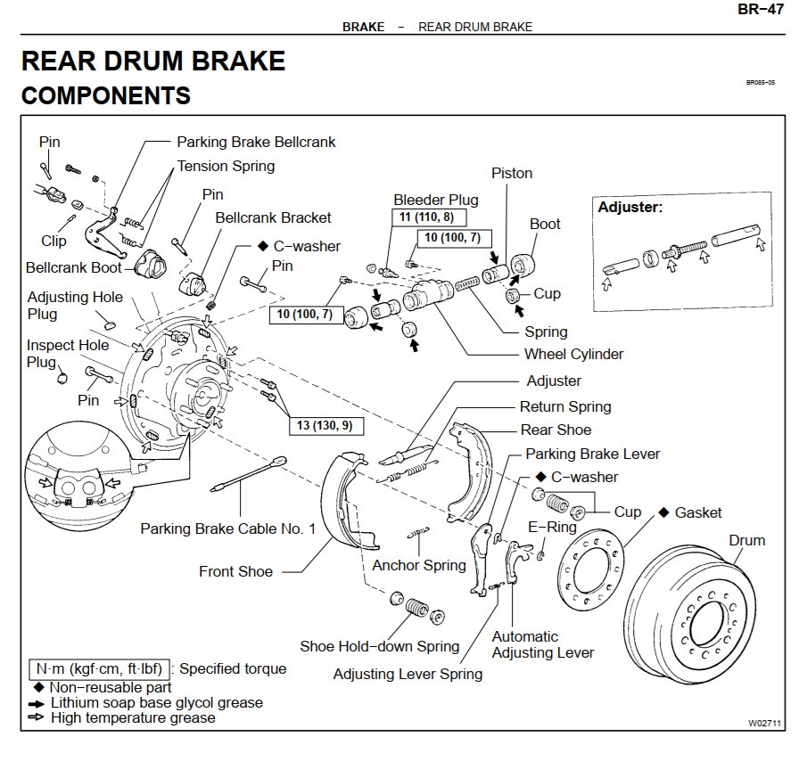

    One thing I just noticed in the FSM replying to another member, I didn't lube right here where the edges of the pad touch the caliper, and the FSM tells you to. I wonder if my squeal is actually coming from the pads rubbing against the caliper right here, on both sides. You can liderally see a black square where the pad plate rubs the dust away from the caliper. I'm gonna kick myself if that's my f'n issue right now. Fortunately I can hit that spot with lub wo/removing the wheel, I think.
    bmf4069 and oscardog86 like this.

    Advics kits come with the shims pre-glued to the pad with something like CRC BDQ, which is what I normally use. There was no vented shim I could see. There was virtually no rust I could see. I wiped all faces. And as a reminder, this sound was here both before, and after doing from pads. I'd argue maybe a bit more after the new pads, but ... not much more.
    And yes, greased between the shim and piston faces.
    Grease points are shown in the FSM here: https://www.tundras.com/threads/wha...-gen-tundra-today.2558/page-1979#post-3575486
    And pics of before/after, clearly showing no grease in those spots: https://tnstatic.net/attachments/upload_2024-4-26_12-23-20-png.987944/

    IiRC pulling the wheel is good and then the pads so can get a cotton swab down the caliper the full length of the pad to put a thin coat of grease (without putting it on the rotor). Might need to clean a little scale from the caliper (unless just need to spray off dust) and that can be easier with caliper off. But hopefully they're just ready for grease.
    Yeah those arrow in the FSM are not solid so easy to overlook. If it works wouldn't kick yourself but rejoice. Easy no money quick resolution. Good luck!
    Also, can't imagine it's the squeelers becuase they don't seem to drag otherwise and are new. But would check they aren't bent near touching for some weird reason.

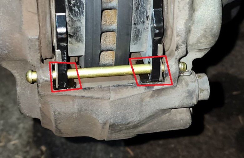

    @shifty` looks like there has been contact here and braking while backing up might shift pads to hit there more than going forward due to direction of wheel spin. Those calipers look clean so hope a little dab of grease fixes it!

    I always check squealers before install. Always inspect your parts :D
    I also need to doublecheck screamer. I remember I couldn't recall whether it should go inboard or outboard. I'm pretty sure I went inboard and upward with it, sometimes the dyslexia gets the better of me. If I got them backwards I'll be jacking up the entire front end to swap them anyway...
    Definitely, and I just wiped it entirely clean.
    When I pulled out a minute ago, I got 1/10th the squeal. Like waaaaaaay reduced. So maybe it was double-clipping that was doubling the sound.
    But I also shot that video after not backing out the truck for 3-4 days or more, so I recorded knowing it'd be far louder than normal. I did it on purpose, hoping that video would reveal whether it was rear or front. The more I think about it, though, the more it makes sense it's the front ones making all the racket, and that's why the sound never really got much louder because the camera was outside.
    So next on the agenda is confirming pad position, greasing the caliper/pad merge, and I'm also going to slap some grease on any part of the spring clip that is at risk of touching metal.
