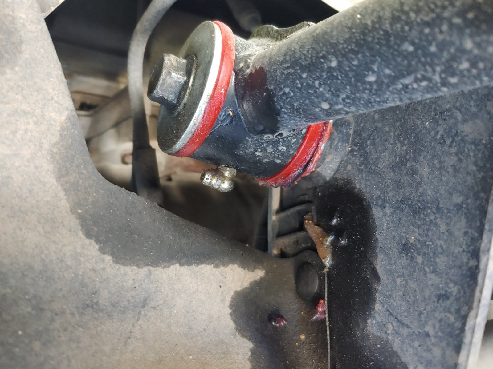

    I wad gonna do my front breaks today, as i thoight they were like really low, like nackered low on tbe pads. But I dont know, compairng to a new pad theyre just a bit less than half on both sides. What do y'all think. Lett em ride for a few more months or what?0212241135.jpg

    The pad on the right isn't properly seated on the rotor, note the two spots with overhang? Super weird. But yeah, those have plenty of life left.

    I seen that when i was doing the UCAs. Cant find a symptom or a cause other than improper install alignment. If anything its keeping that outter edger burr from forming lol

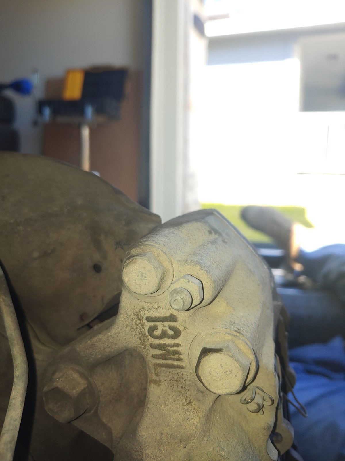

    WL calipers on WE rotors?
    rotors all seem to be the same. Dunno. Weird.

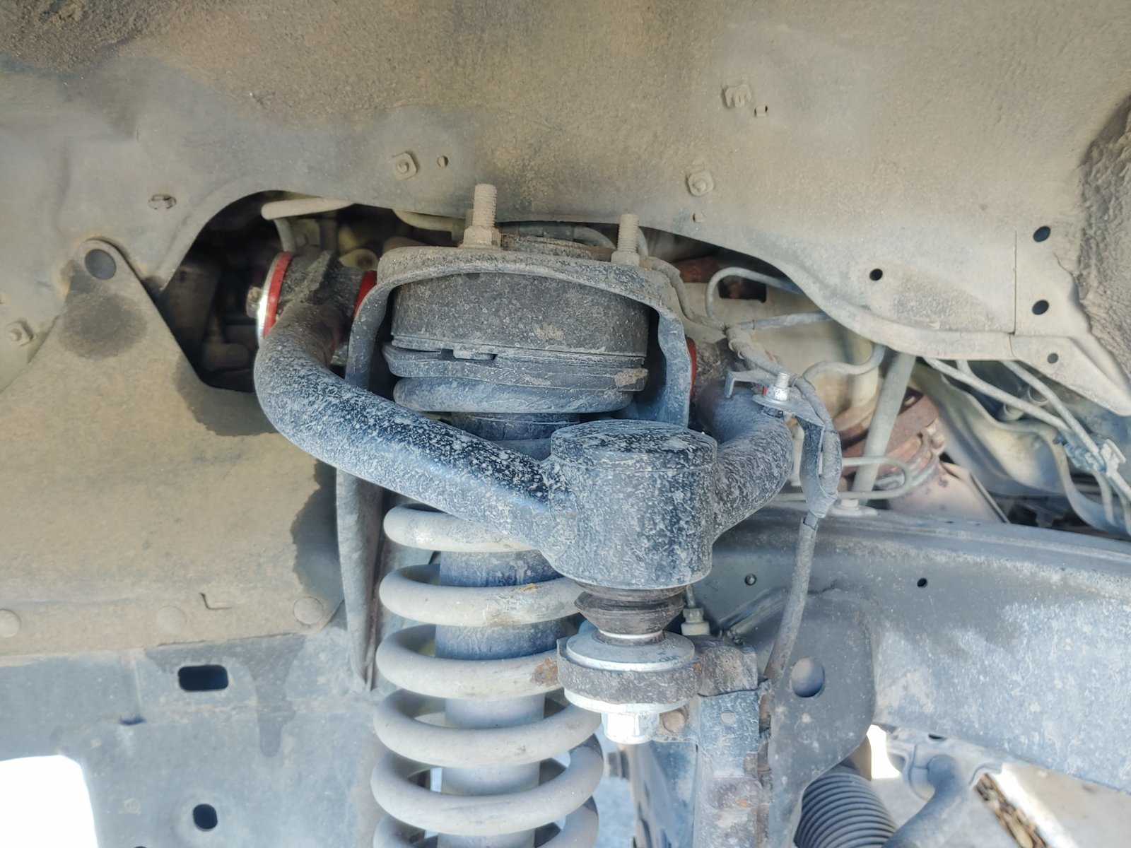

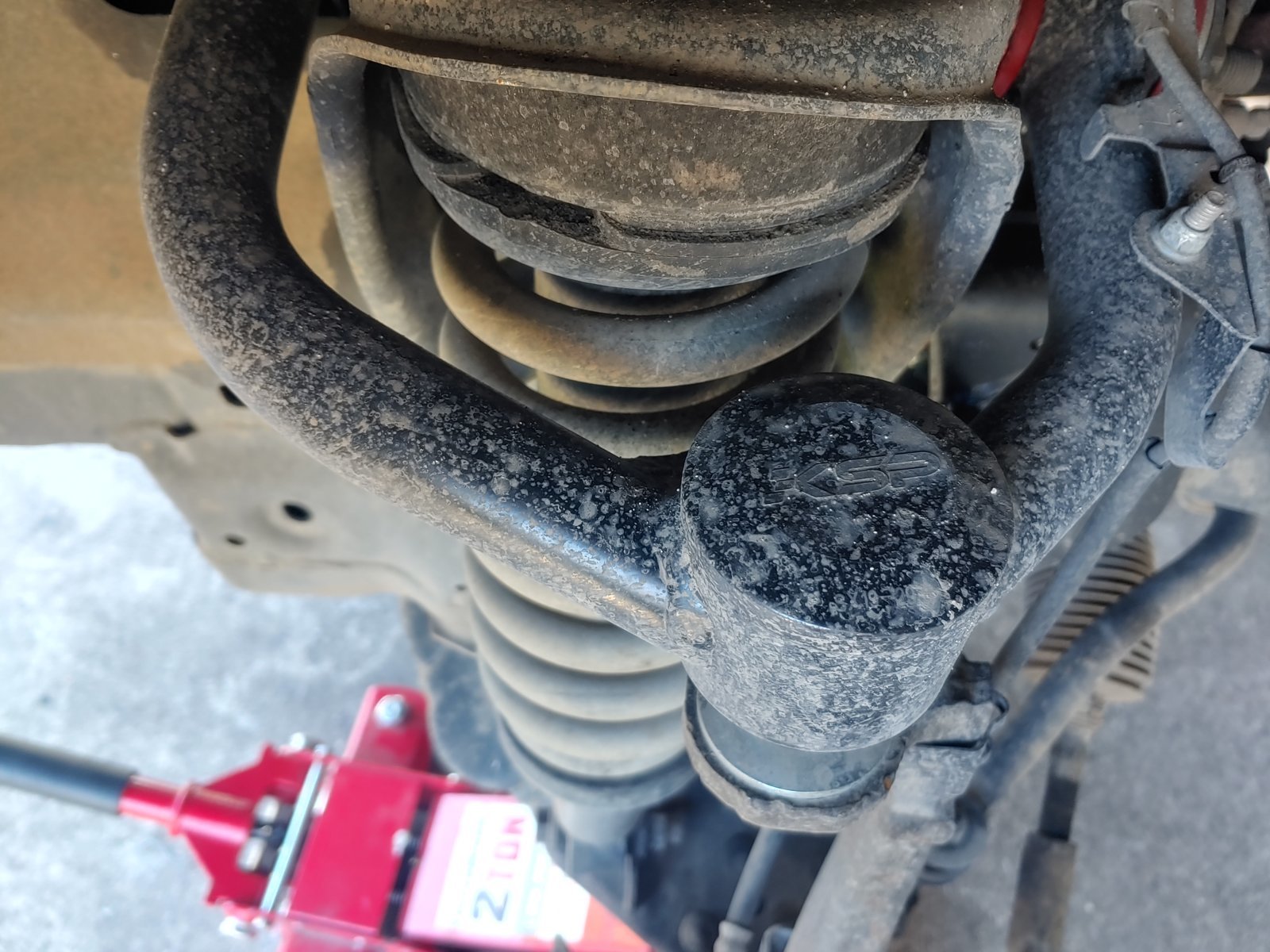

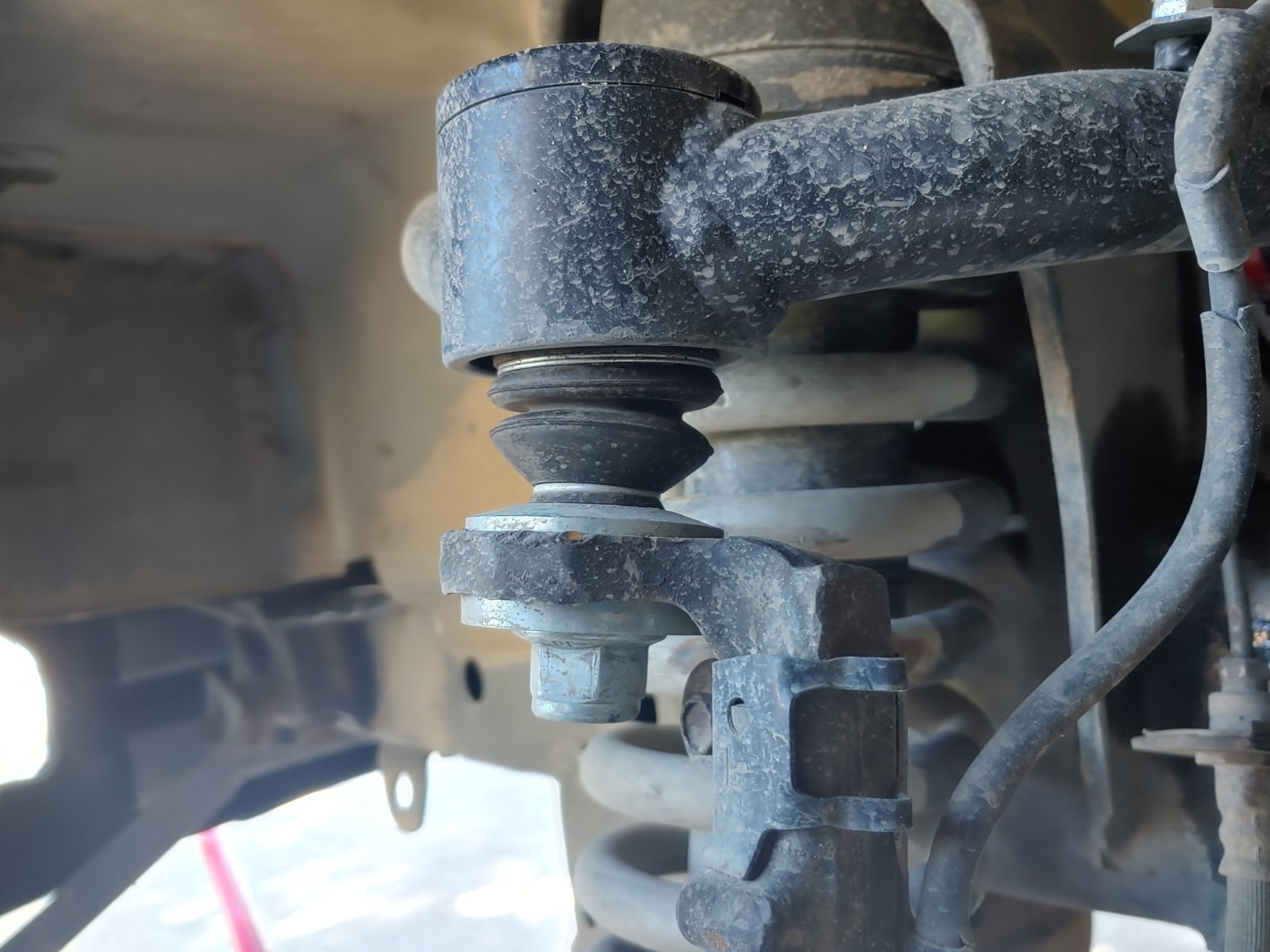

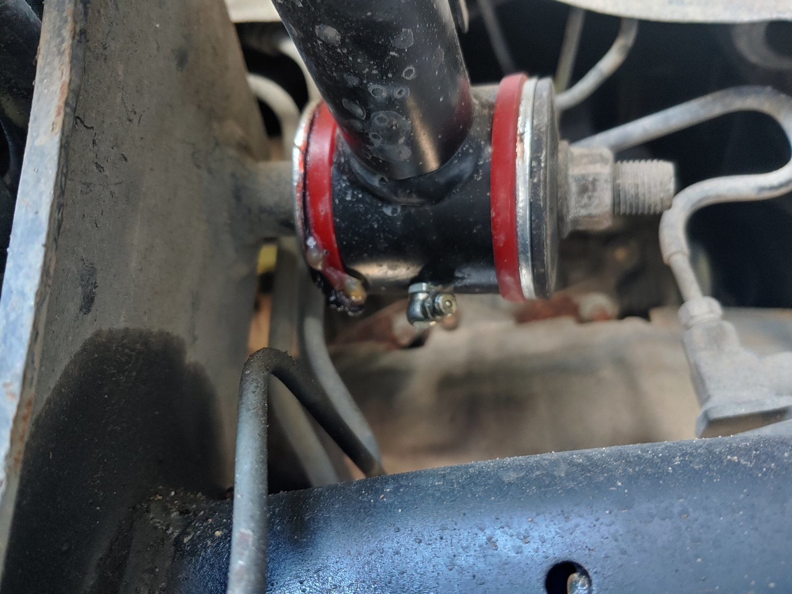

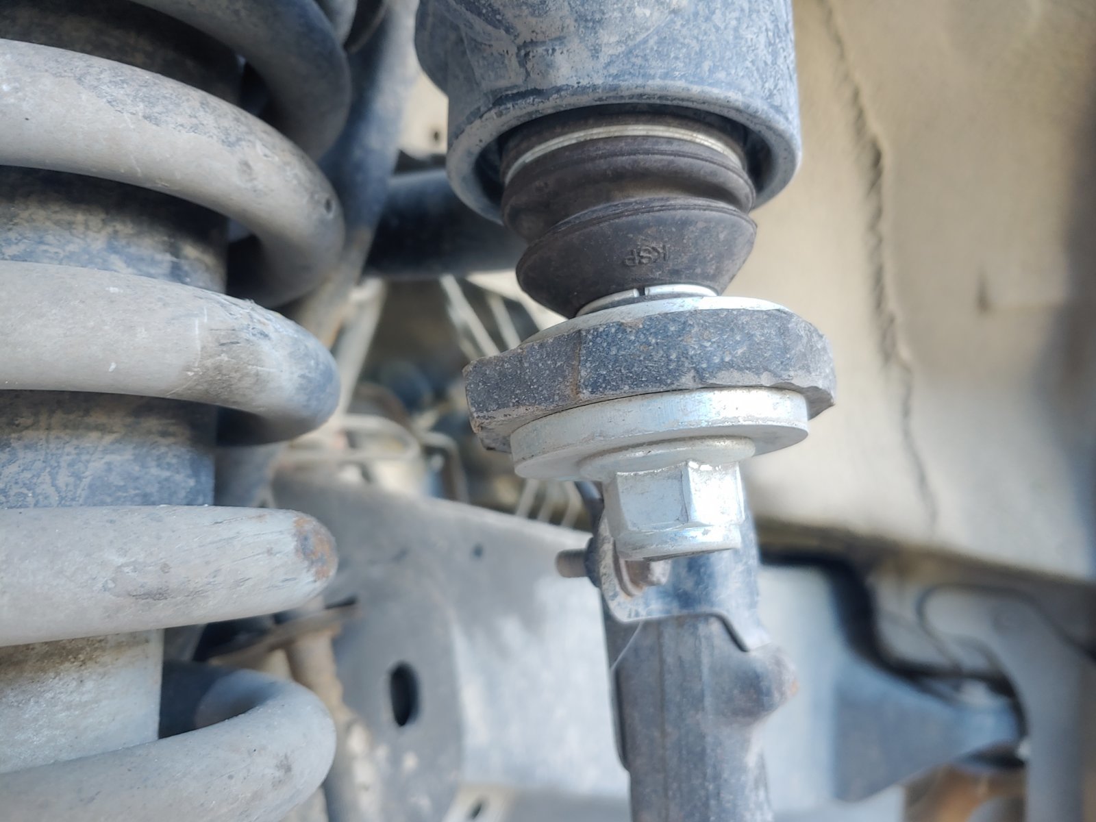

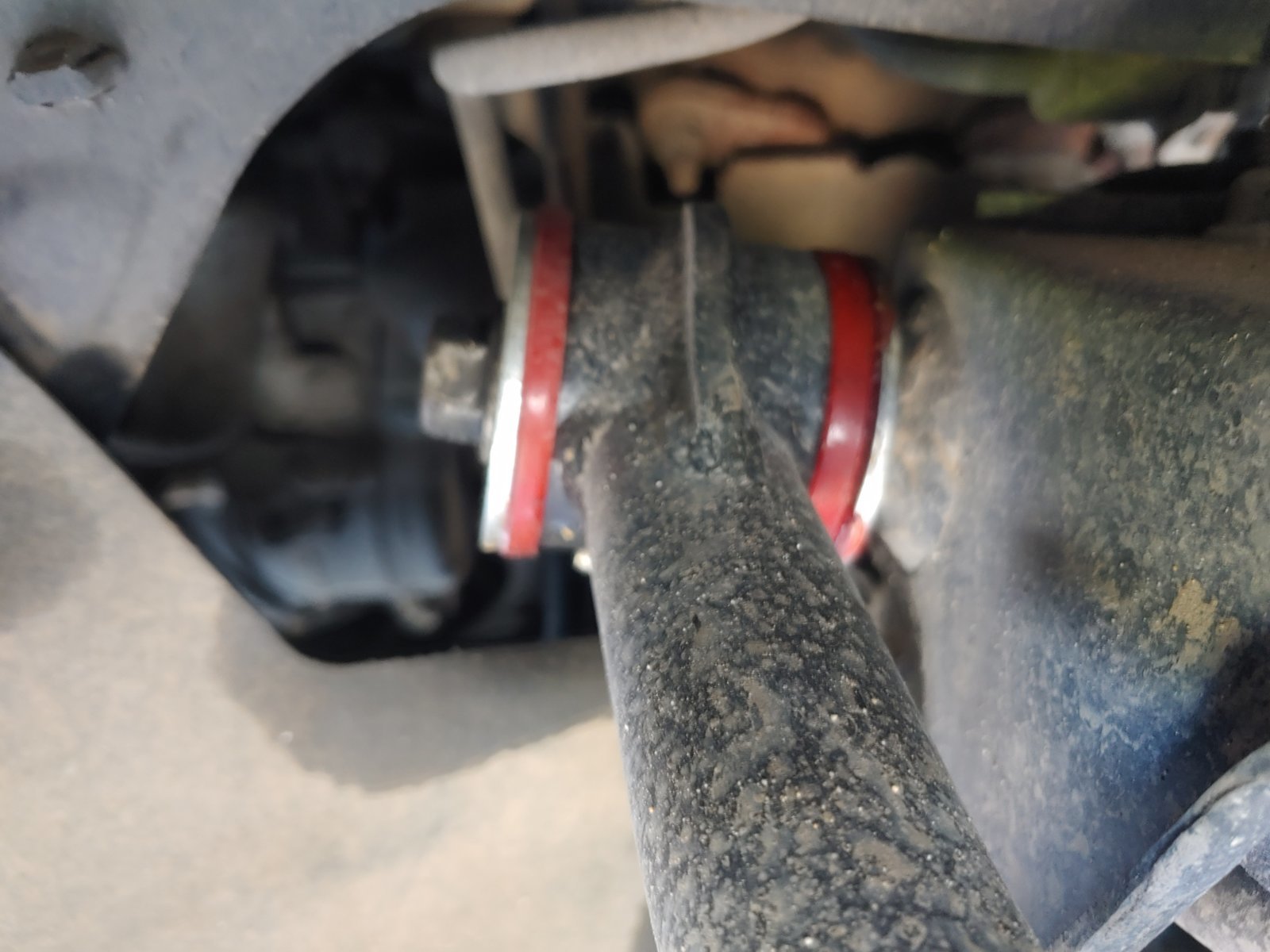

    Speaking of UCAs, these KSP UCAs are fucking great, got just under 500 miles in them now. Holding up well, no noises, smooth ride, no interference with anything, springs or mount housings. Their ball joints are holding up well.
    The factory Zerg fittings blow donkey balls, but for less than 300 shipped to your door, I mean I like them overall. And I'm pretty picky about what I like from building street legal track weapons.
    Will check in at 1000 miles. Oh driving types are 22 minutes of highway 5 days a week, light field driving most weekends, and the occasional around town shit 2 to 4 times a week.0212241135a.jpg 0212241150.jpg 0212241150a.jpg 0212241150b.jpg 0212241150_HDR.jpg 0212241150c.jpg 0212241150a_HDR.jpg 0212241150b_HDR.jpg

    But not in these rotors. And my calipers at 13WLs

    Your truck didn't come with the larger 13WLs. It came with the smaller 13WEs. I suspected @Mr.bee was right and liked his post when he said it. I think he nailed the issue. Some PO installed larger calipers whenever as an upgrade.
