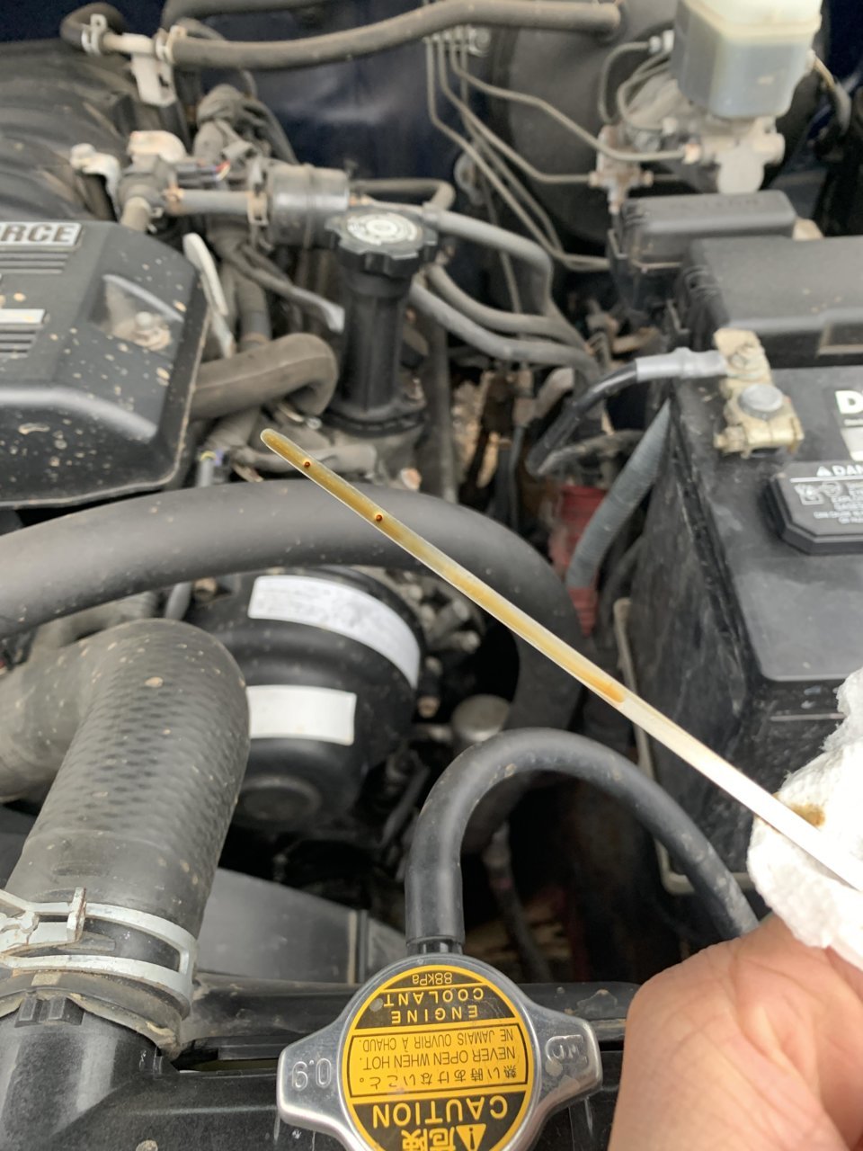

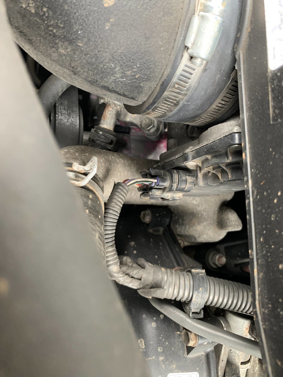

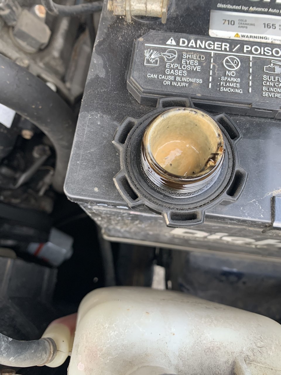

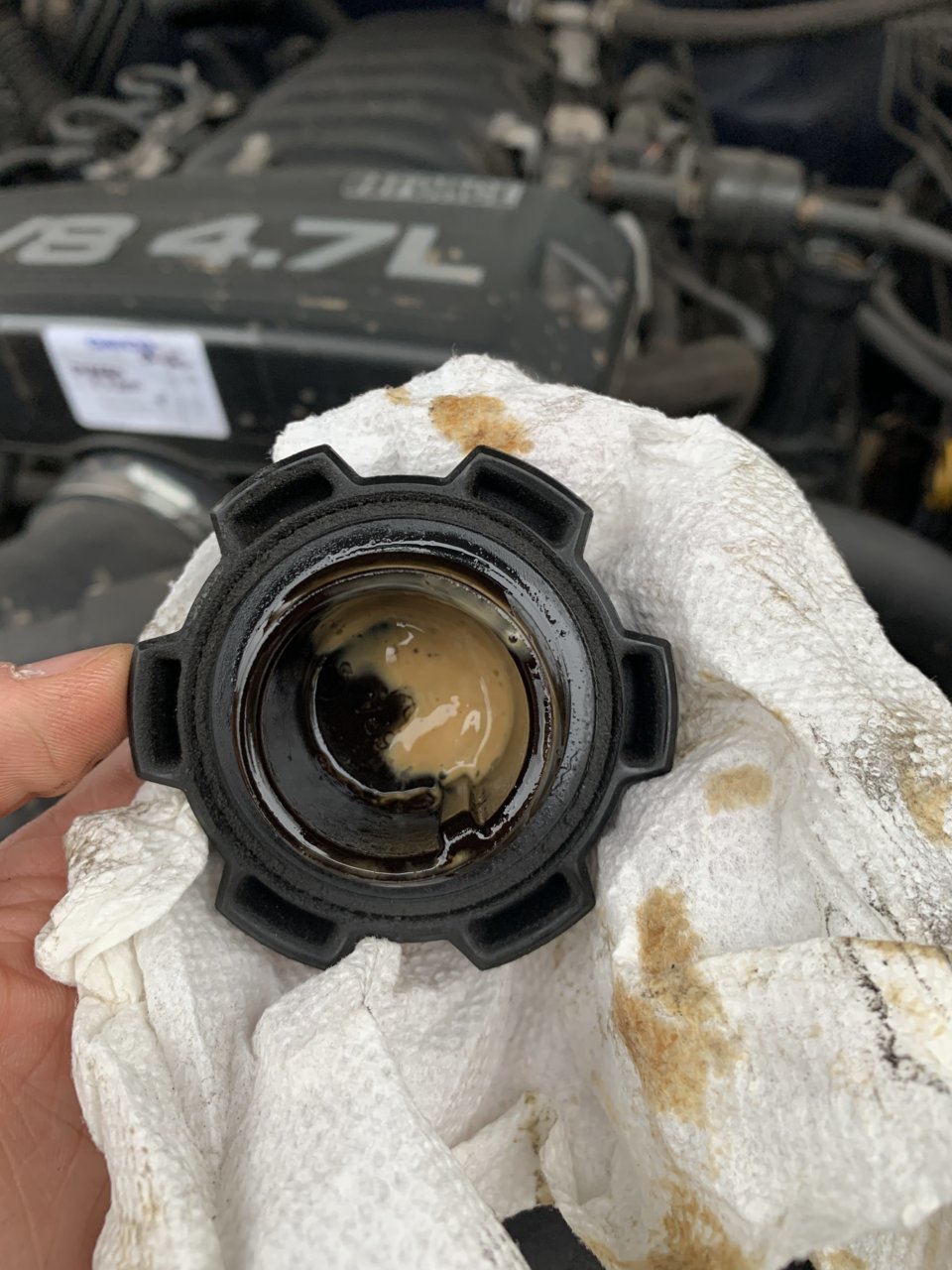

    As I am due for a routine oil change, I opened the cap to find the dreaded chocolate milk oil coating the underside of the cap. Although my truck (06 DC SR5 4.7L) is currently asymptomatic, I definitely need to address this issue and fix its source, which I am really hoping is not the head gasket. I have found some dried up pink spots on the water bypass joint under the connection to the thermostat and I'm wondering if this is the culprit. Does anyone know if this is an area that could cause leakage into the oil system or if this is a completely unconnected / independent coolant loop? Due to the clear leak of coolant being at the same time as my milky oil, they sure seem to be at the very least correlated.
    Additionally, I recently (about 3 months ago) had my radiator, water pump, and timing belt swapped out in a shop. I had these swapped out due to an overheating issue in the late summer which was diagnosed to be an old clogged up and leaky radiator. I would say that the overheating could have caused some issues to different gasketed connections in the cooling system, but I have not had any signs of the pink coolant on the water bypass joint until now.
    I do not think there is a way for the rad and pump swap to introduce coolant into the oil, can someone confirm?
    I plan to change the oil, fill the coolant reservoir, and clean off the leaked coolant, then closely monitor for a few days.

    Do you do a lot of short trips by chance? Condensation like that isn’t unreasonable if the truck takes many short trips
    The leak physically cannot leak into oil from there, that part is just purely cooling system. Get it addressed, but basically, when the t belt was done someone didn’t properly seal it.

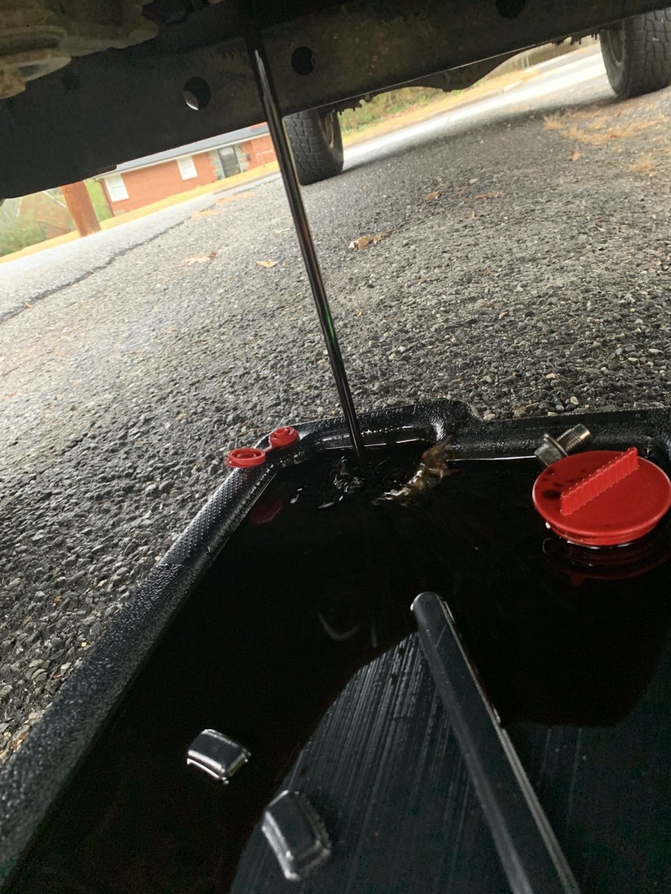

    Update and [hopefully] good news!
    I changed the oil last night and it looked fine. Dark, smooth, and clear just like used oil should look. Before the change, there was still some of the foamy chocolate milk under the cap, but the dipstick and oil were as they should be. Addressing the overheating issue, this was over the summer and I had a boil out on the radiator. What I'm hoping is that when the coolant splashed everywhere I had some collect on the thermostat/bypass joint and it went unnoticed until now. This boilover was at idle in the heat of summer, and I'm hoping the radiator's relief valve did its job and I don't have cracking of the block/head or a blown gasket. I cleaned up the dried coolant and wiped down the engine bay; I plan to keep an eye on this.
    Funny you mention this... I actually switched jobs so I have a very short 1.5 mile commute each day, so my truck has been running high quantities of short trips compared to normal. I'm hoping that this is a natural amount of condensation. Is this seen more frequently in vehicles with shorter drives?

    Water condensation is exactly what that is you see. I get it all the time. My commute is 5 miles via interstate so by the time I just get into work, the truck temp is where it needs to be but unfortunately, I need more mileage to burn off the condensation. I've had my oil cap filled with what I call the "mayonnaise" effect. :D
    Just change your oil regularly or drive further/longer to burn it off (if you're able).

    I get the brown froth in oil cap every winter, have for 8+ years. its just naturally occurring moisture that isn't getting fully burned out of the oil. Especially common if you only do short trips (which I often do) and/or live in an environment with cold and humid conditions. I like to think the long filler neck further from engine heat was done on purpose to collect the moisture for easy cleaning... You're not the first one to freak out when first seeing it, I almost shit a brick! fear not, its common.
