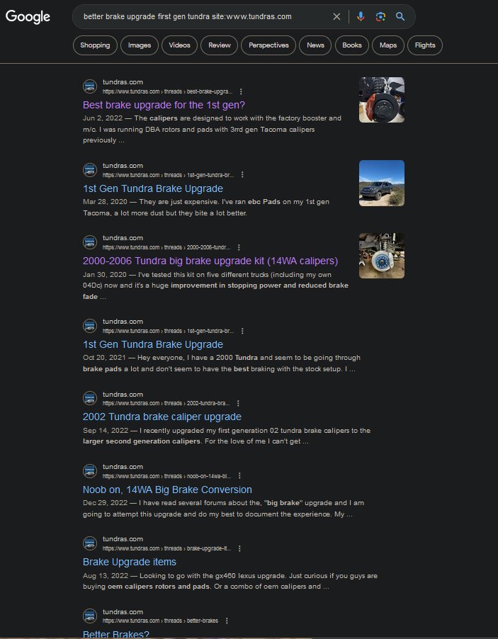

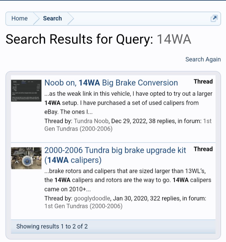

    It's actually the best search function of any forum I've ever visited. Try searching like this when you are looking for something.
    This narrowed it down to 2 results.

    If you can't figure out the search function on here, the fewer keywords, the better. Also select to only search this forum. If someone gives good advice you like, filter by their username.
    Google search helps, also adding site:tundras.com to your search will filter out other websites.

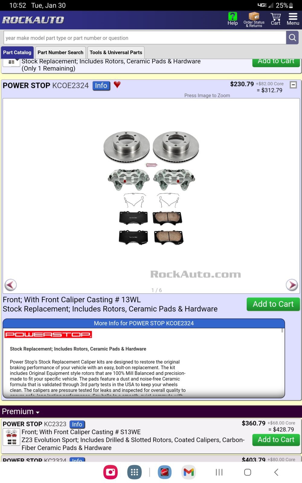

    If you look on the left side of the caliper it'll say 13WL or 13 WE on there. It'll be on the inside(towards the truck) of the caliper when installed.
    This is the kit I went with:
