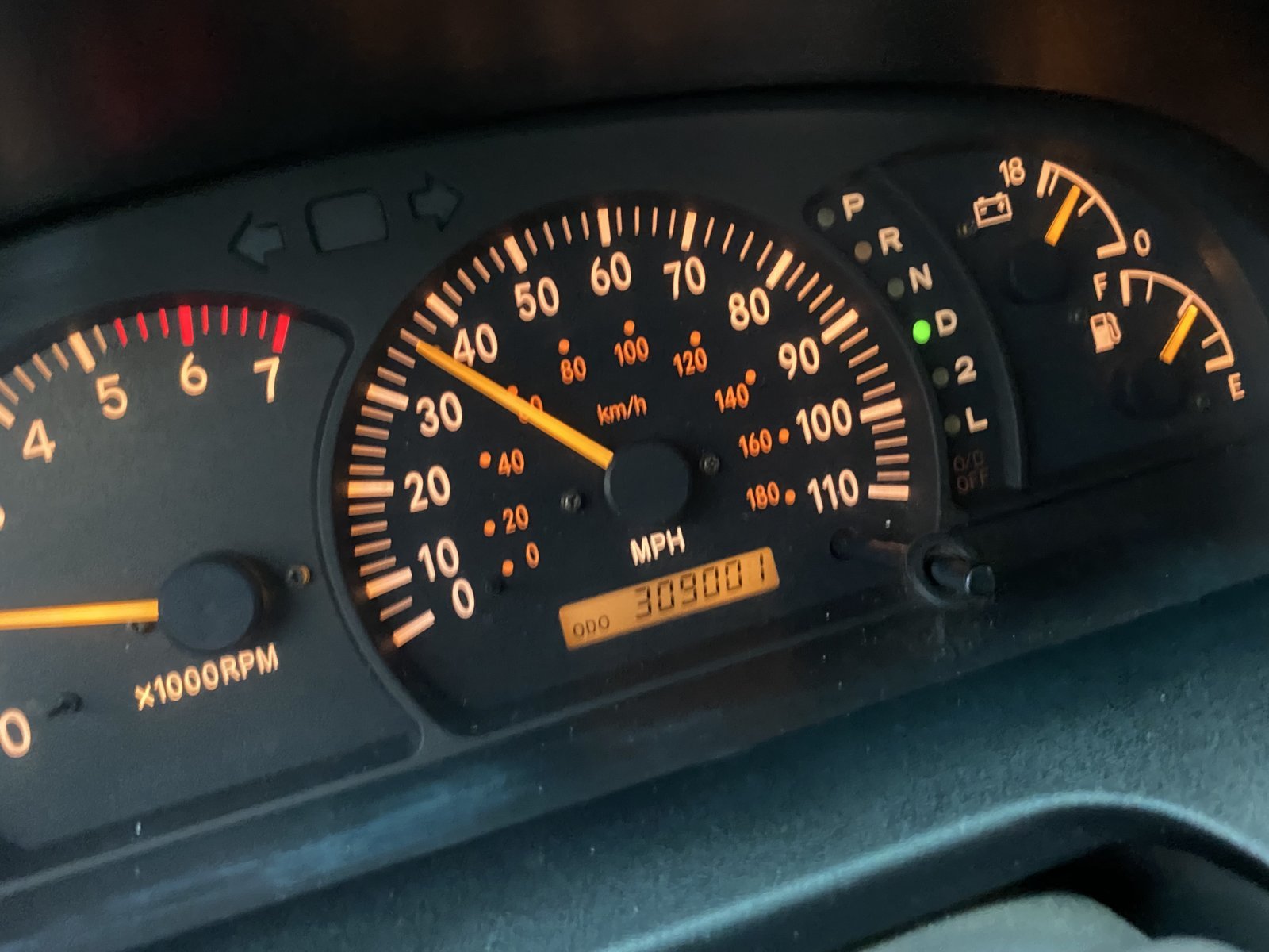

    I was driving and looked down at the odo and I saw 309000. I grabbed my phone and it was too late :(

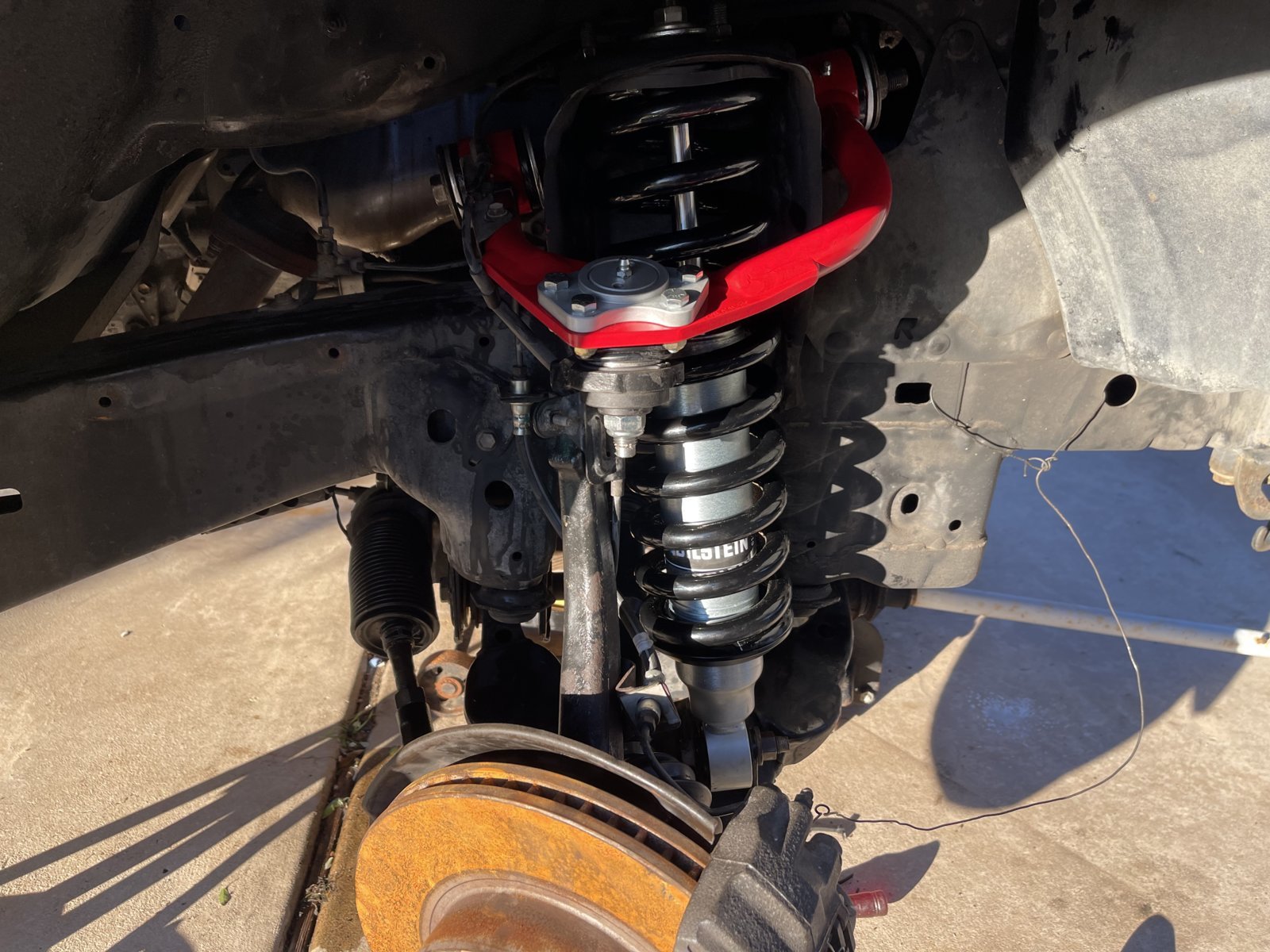

    Nice work. I should probably know but what CO and UCA is that?
