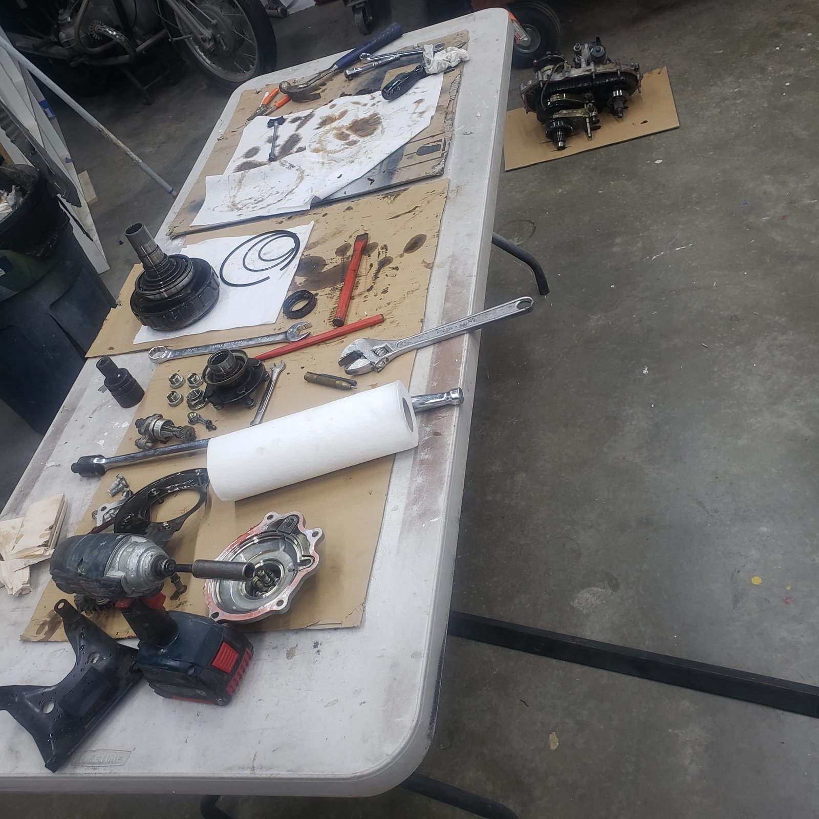

  28. Jan 4, 2024 at 2:07 PM
    JakeJake
    JakeJake Slippery Snake
    Jul 19, 2023
    #100515
    1,464
    2000 Tundra AC 4X4
    Now, where does all this stuff go?

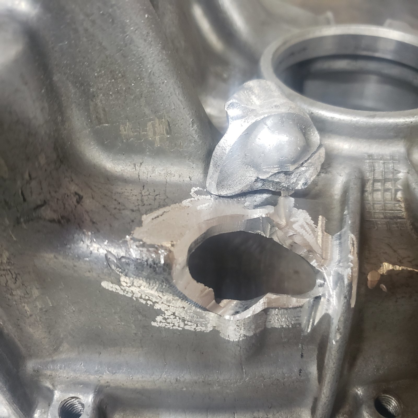

  29. Jan 4, 2024 at 2:44 PM
    NUDRAT
    NUDRAT 6 lug life
    Dec 7, 2018
    #22736
    3,318
    SW CT
    Between 'Ridgelines'
    Wait, what's that other damage to the case in the corner/to the left of the photo? There's holes there. Did you simply discover a casting defect?
  30. Jan 4, 2024 at 3:39 PM
    JakeJake
    Jul 19, 2023
    #100515
    1,464
    2000 Tundra AC 4X4
    Thats some less than stellar casting finish with some gear oil/grease highlights. Nothing to worry about. The case actually welded halfway decent for being cast, I was expecting much more of a fight.
