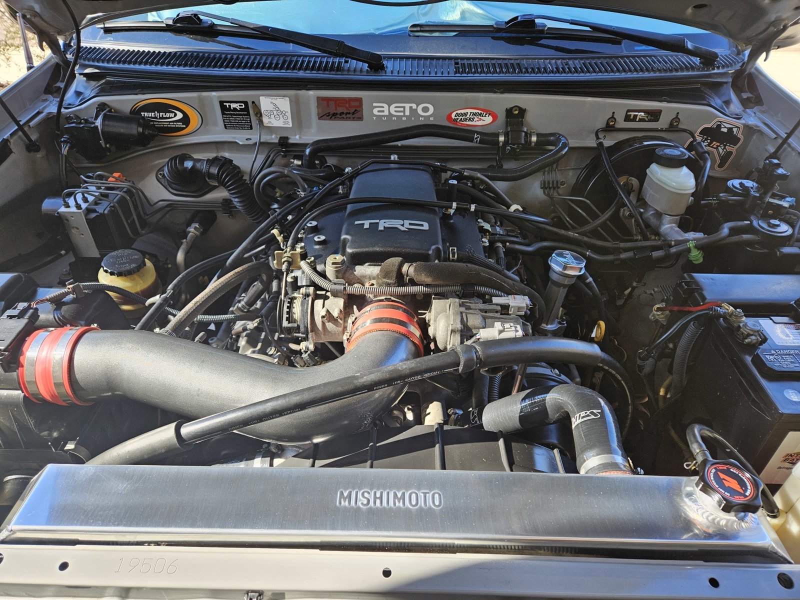

    Was looking for an intake tube like the one pictured. Thanks. I've used AEM DryFlow before. No issues. Since watching Project Farm's filters video, I stick with Wix filters.

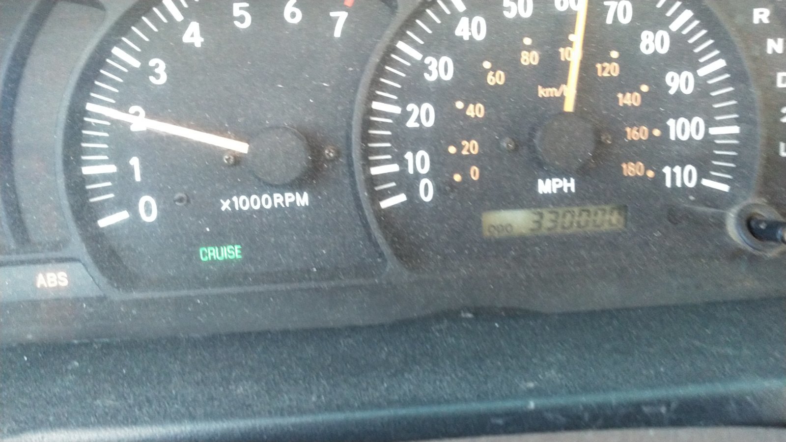

    10X New Member
    Nov 27, 2023

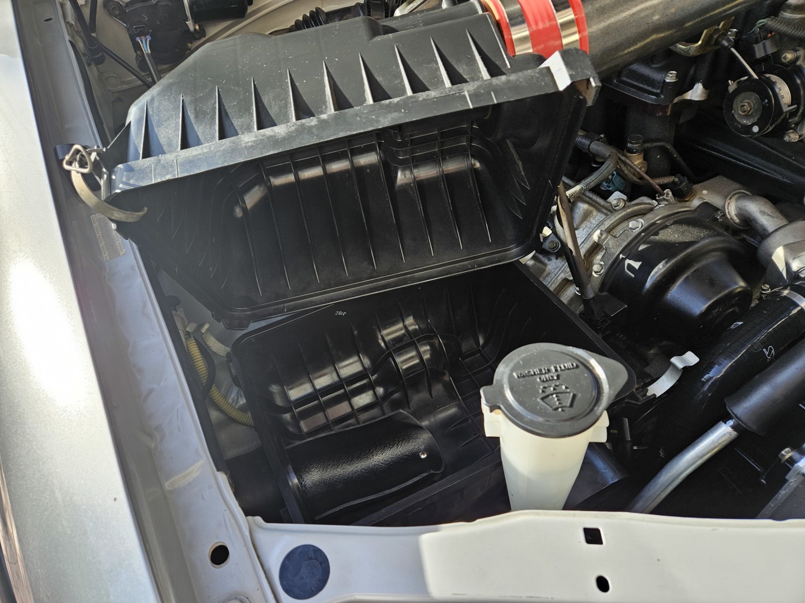

    The intake tube was part of the TRUFLOW intake system/filter, the only thing I kept was the tube and attached to the airbox....Well, that and the decal on the firewall. The company stopped making them almost twenty years ago.

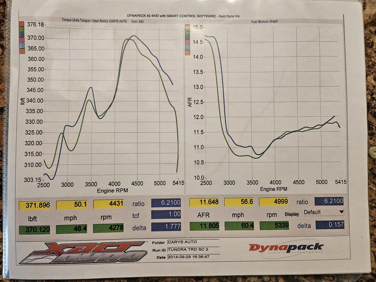

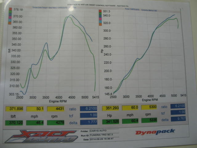

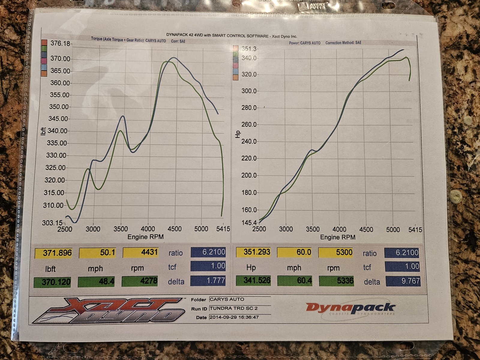

    350 horsepower, that's awesome! How much boost are you running?

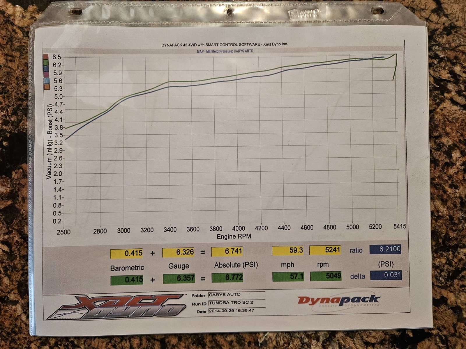

    Okay, found paperwork. Looks to top out a wee bit over six psi...It's been nine years ago with lots of smiles per mile.

    Just makes me want to test an SC 1st gen that much more! I'll never be able to buy it, but the idea is cool!
