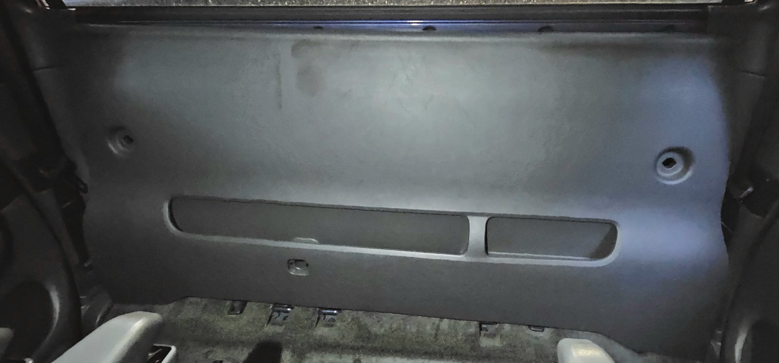

    Anyone remove the backwall plastic on their DC? How much room we got back there? Enough for a couple of powered slim underseat subs perhaps? One of these days, I'll get around to removing it and checking myself. Meh.

    Pretty much no room at all... I took mine off thinking I could mount my Weboost underneath one of the storage pockets, but the OEM JBL amp uses all of the available real estate.
    https://www.tundras.com/threads/remove-panel-behind-rear-seats-in-dc.88283/#post-2220719

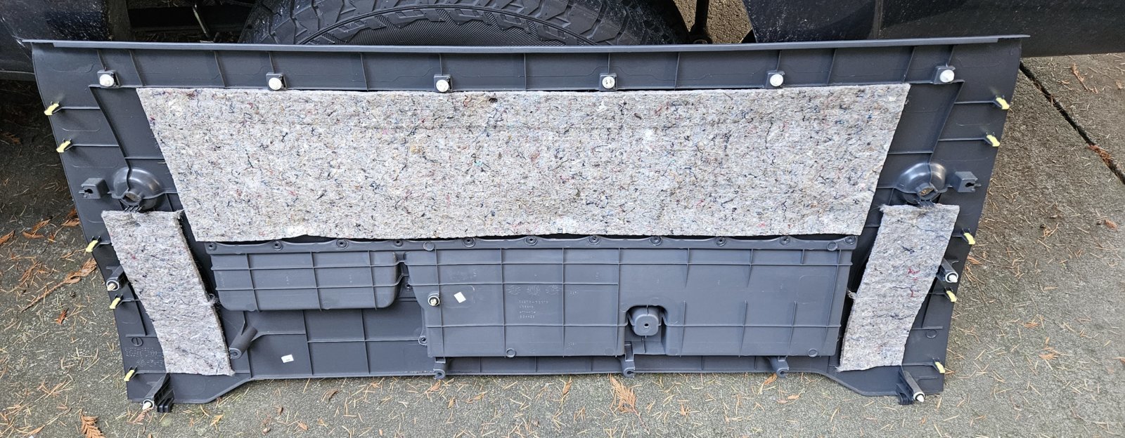

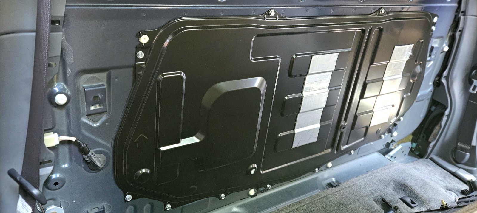

    I removed mine this week in search of room for an amp. I don't see there being room for subs. I'll post pictures tomorrow. I'm planting my sub under the back seat similar to what Shifty showed today.

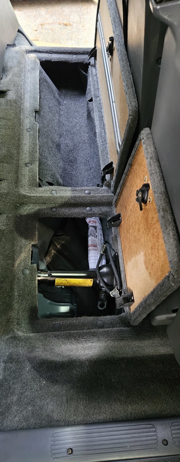

    @SateenC1 Thanks for those pics!
    I think I'll try throwing a single sub and sealing the other sub hole on my dual 8 sub box for the drivers side underseat storage cubby. The box has very little airspace. Not enough for two decent 8 inch subs that would fit with the restricted mounting depth. We'll see how it compares to my current single 10 in a truck wedge box.

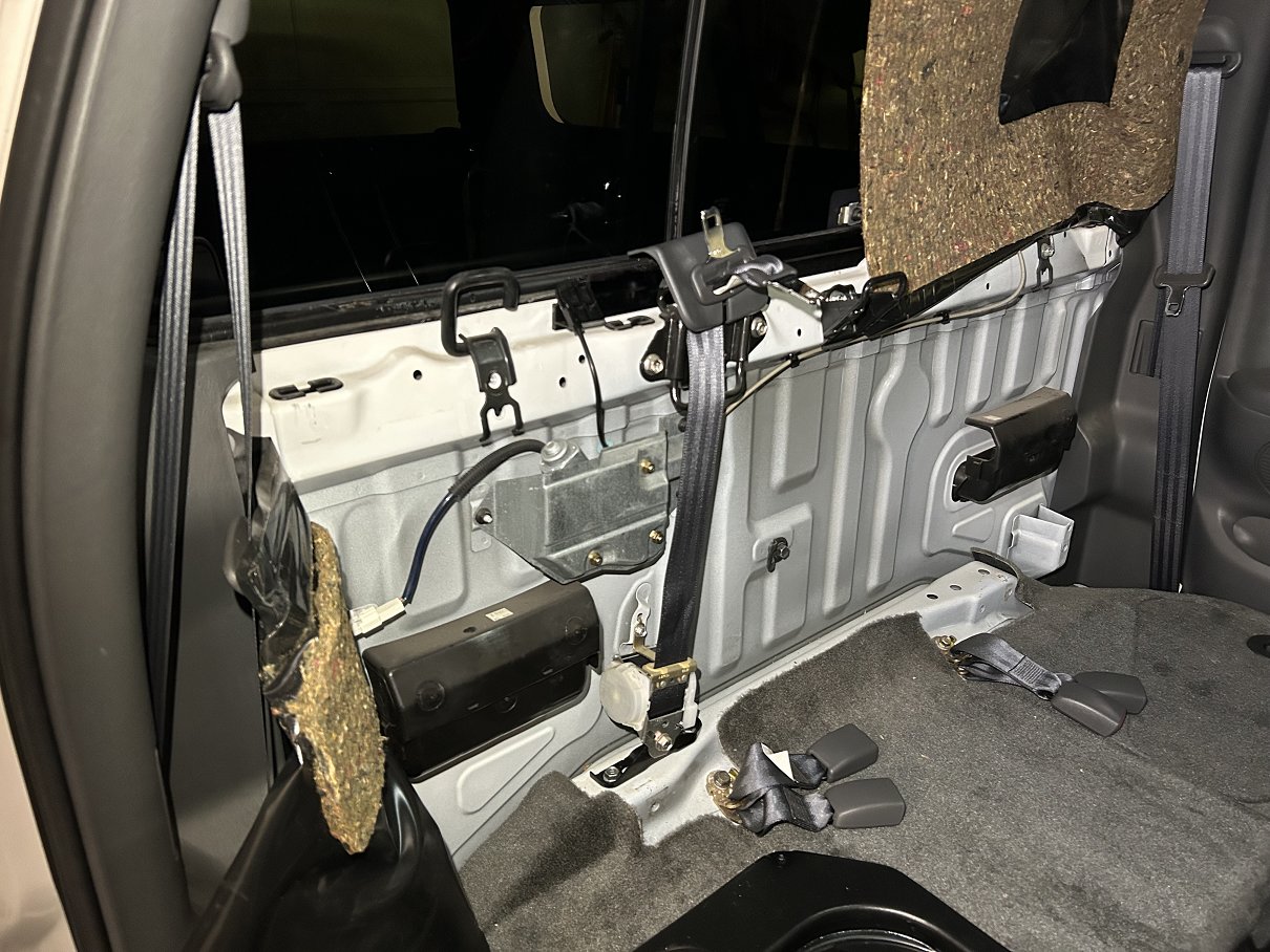

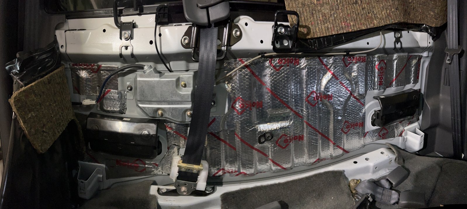

    5 bolts along the bottom for my '06, 12mm.
    I've been spiking from low grade up to fever all day, managed to sweat thru this over 3 attacks. Little over ~50% coverage, w/some overlaps in extra-tinny sounding places. Pics, and a bonus pic in case anyone needs to see what the rear slider motor etc. and wiring looks like later down the road.
    Lining up that seat to get all 4 hooks in the right place with that center belt is a freaking chore. Upper hooks I had to loosen to get the black plastic sheet off, 14mm. Center bolt I had to pull to install over the hole, 14mm.

    Do you have the rare power sliding window? It also looks like your center seatbelt is a real one? My center seatbelt in the back is only a lap belt.

    Real slider. Real center shoulder belt. I think it's just a year difference thing, 00-'02 vs. '03-'06 or '00-'04 vs. '05-'06

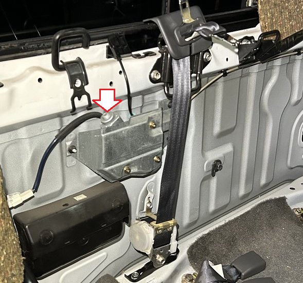

    What's the silver box in the middle, next to the seatbelt?

    Round part the arrow is pointing at is the motor for the rear window. Looks like it uses a cable system inside a coated steel sheath (going up from there). The silver box holds the motor in place. The line/loom off to the left is the power source for the window motor.
    I'm realizing in hindsight, I wasn't thinking clearly while down there. I should've taken time to clean out the sliding window track and all that jazz.

    Yeah that's what I figured. I thought you were saying it was a normal manual sliding window. The power slider is cool. I'm jelly.
