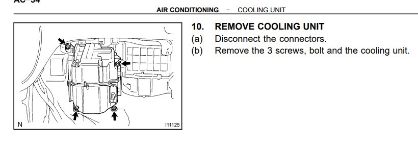

    I bought an expansion valve, schrader valves, and an o-ring kit to replace along side my condenser. I'm going to blow air and vacuum the evaporator while I'm in there and probably do the Toyota foam. Also need to re-read the cabin filter thread and order that stuff.

    Is the expansion valve at the evap? How hard will that be?
  10. Aug 28, 2023 at 12:50 PM
    des2mtn
    Jul 1, 2020
    #48721
    4,429
    SW
    2004 Black DC Limited 4x4
    Tonto cover
    Yup, it looks like the valve itself comes easy, but I'm not sure if I'll have to fully remove this or if I can just take off the lower half.
  11. Aug 28, 2023 at 12:52 PM
    FirstGenVol
    Dec 13, 2018
    #22934
    14,151
    East TN
    2002 AC TRD 4x4 V8

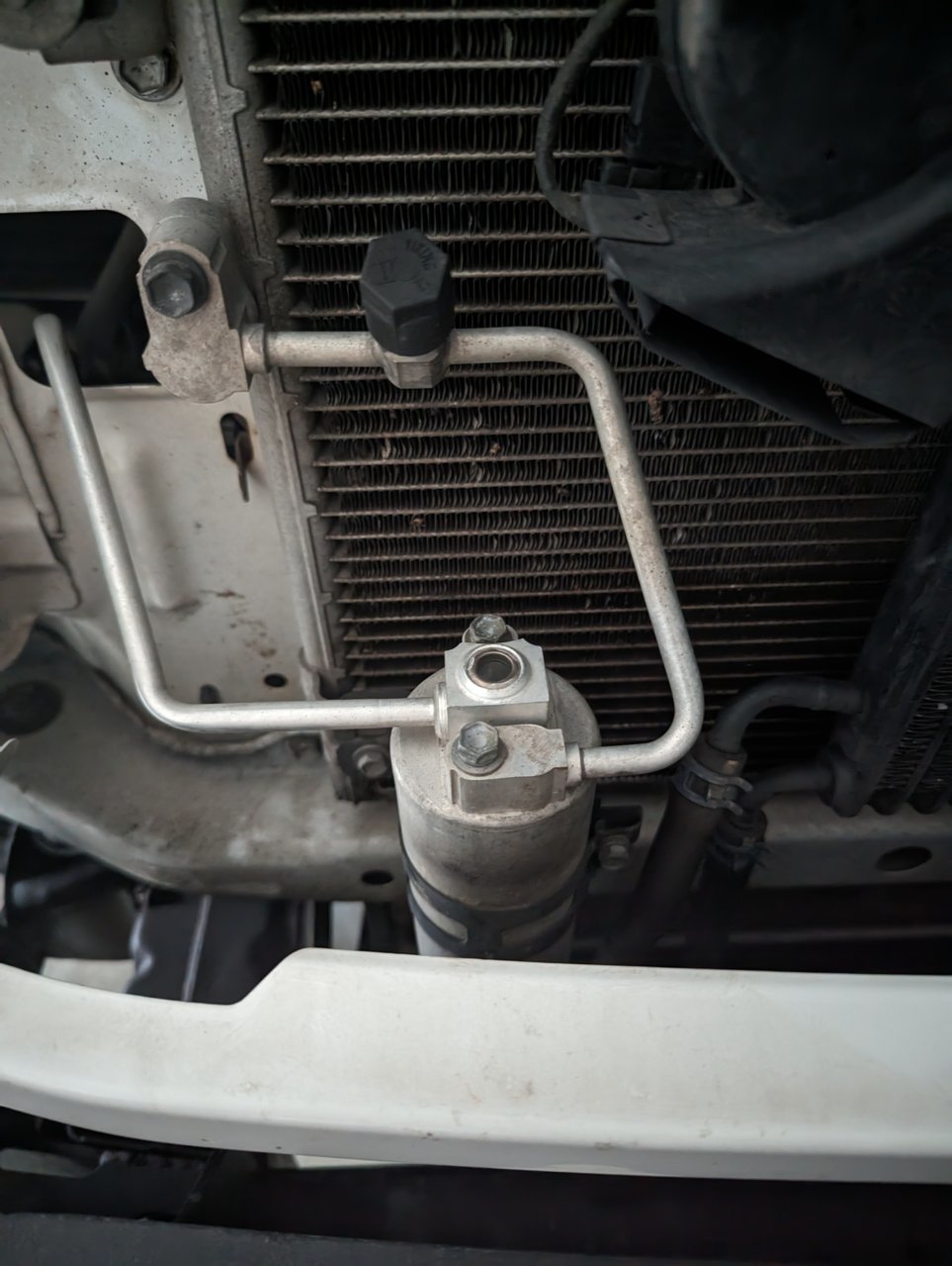

    I'm just praying mine never stops working because it seems like a lot to figure out and fix.

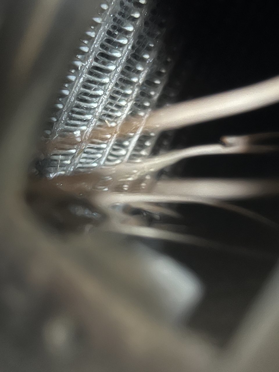

    What is this part?
  12. Aug 28, 2023 at 12:57 PM
    des2mtn
    Jul 1, 2020
    #48721
    4,429
    SW
    Tonto cover
    The tube canister thingy is your receiver/ dryer and that's a sight glass on top. Ridgelines have these built into the condenser. That black cap is where the schrader valve for checking your high pressure refigerant charge is.

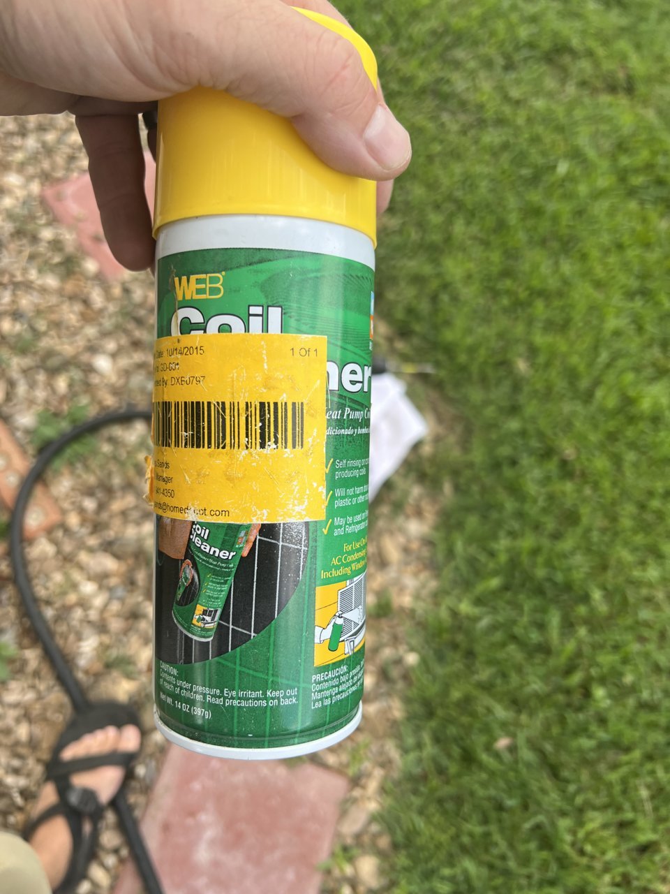

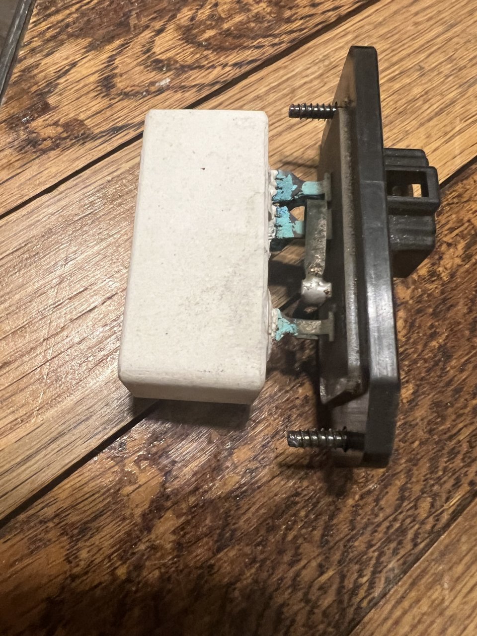

    Got inspired and did the FGT when my sone got home
    bunch of pine needles and trash in there
    used this foaming coil cleaner I had to fully foam it through the opening inside.
    Resistor was a little corroded, cleaned the contacts with some alcohol to remove the buildup.

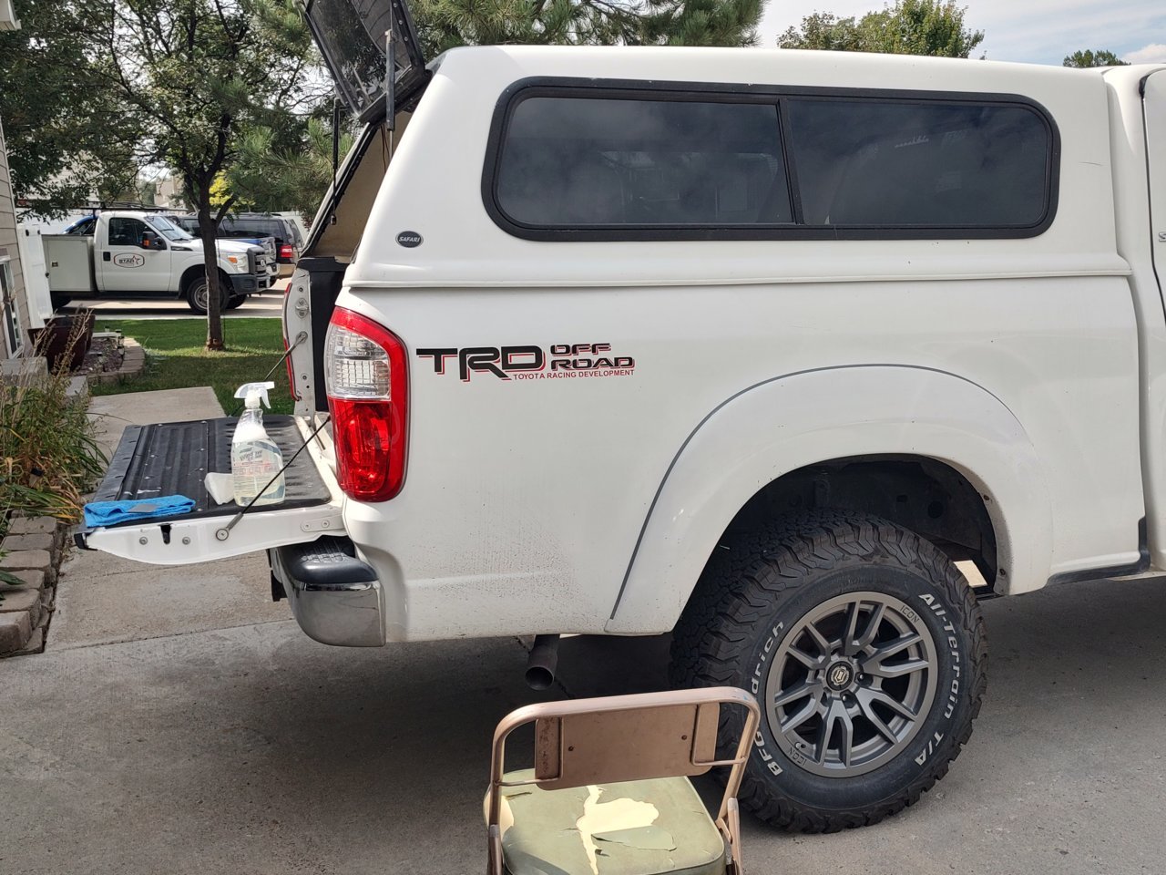

    I like it - it's your truck, you do your thing. Looks good
    But more importantly, those wheels... I'm not a big aftermarket wheel guy, but those look SHARP.

    Maybe not impossible but highly improbable.
    Back 2 screws and clip could be a bitch !

    Thank you. Those wheels are Icon's. I got them on 1stGenOffroad about a year ago. I like them, but I kinda wish I had gone with the bronze ones instead of the gunmetal

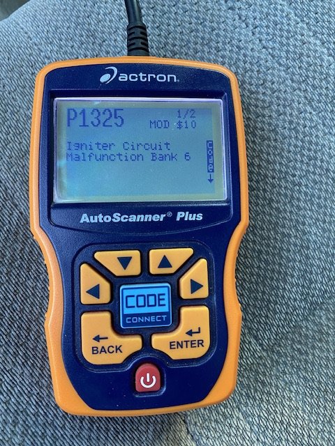

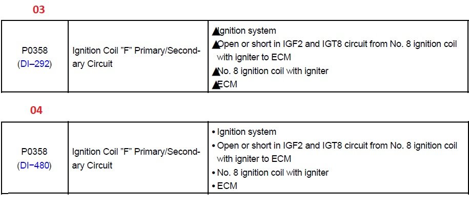

  24. Aug 30, 2023 at 2:27 PM
    Jack McCarthy
    Nov 2, 2020
    #54409
    10,258
    Bill
    North of Boston
    02 Tundra AC SR5 V8 4x4
    Now both codes after switching 6 and 8 ignition coils. :confused:
    Ill swap out both with extras i have to see what happens. Maybe the ECU will eat more coils.
