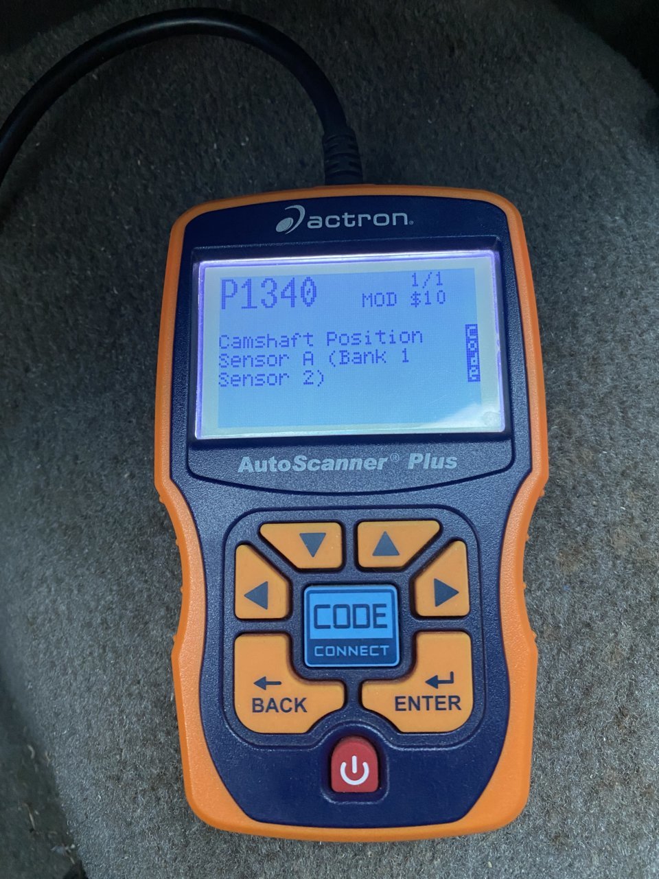

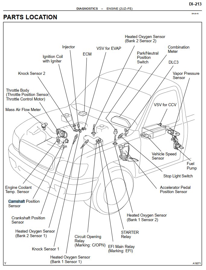

    Anyone know what needs to be replaced here? A cam sensor? Is there only one or two, one for each cam?
    The real question is how long can I drive it like that? It quickly went away but the truck was struggling to not die.

    check bubbaw's reply.
    https://www.tundras.com/threads/camshaft-position-sensor-a-bank-2.123418/
    & theres 4 cams.

    Believe for the 2UZ there is only the driver's side cam position sensor. I would check the harness wiring and make sure it hasn't gotten eaten into by the belt.

    It is, and there was an issue where the belt would eat through it in the earlier models. I want to say there was a TSB for it. Hold up, lemme check my thread and I may edit this.
    Here you go - as I understand, the newest part revision gives an added retention for the sensor or something. https://www.tundras.com/threads/p0340-code-camshaft-position-sensor.95343/

    Weird. The code that link references is a P0340 and I have a P1340.
    Is there really only one cam sensor for the 2uz-fe? Must be two codes for the same sensor I guess.

    No, it's possible there are two on the earlier models. I would need to dig to confirm. Hol' up, lemme check the FSM.

    Looks like only one.

    P1340 doesn't exist as a code in the FSM.
    Try a different code reader; something isn't jibing here. Or just clear the codes and wait if something pops again. Maybe your ECM is tweaking a bit.

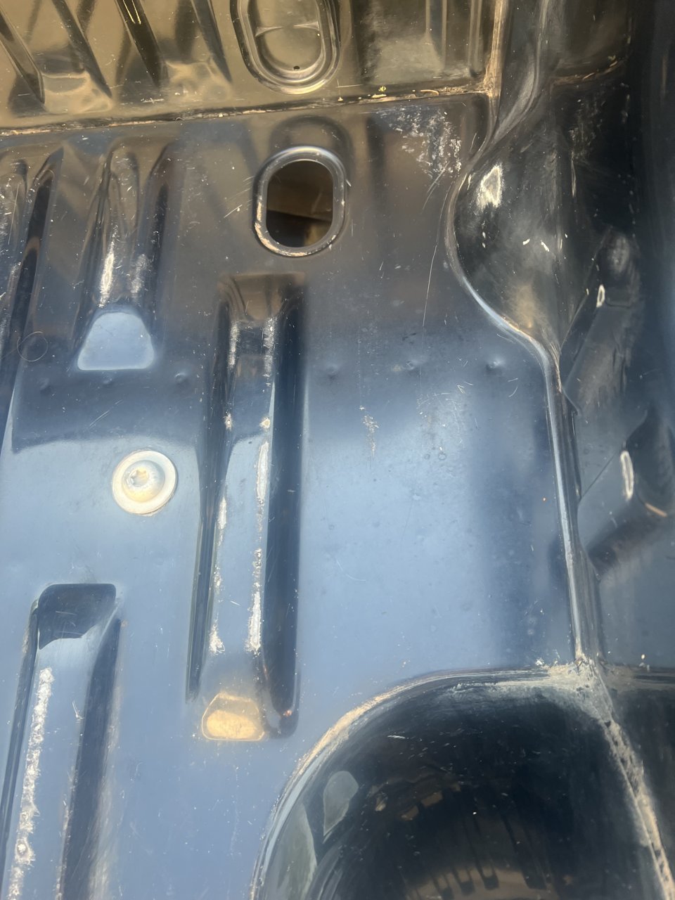

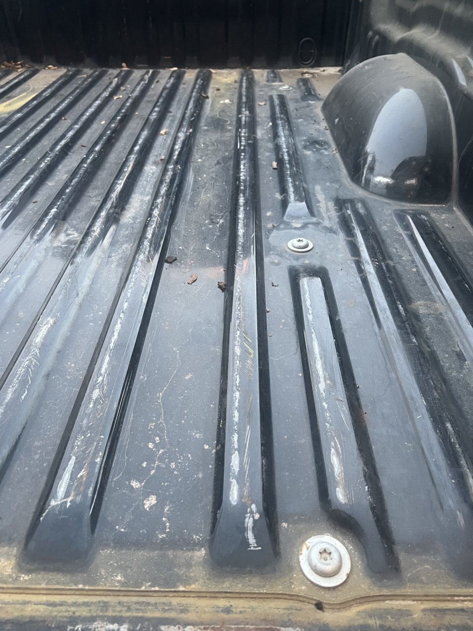

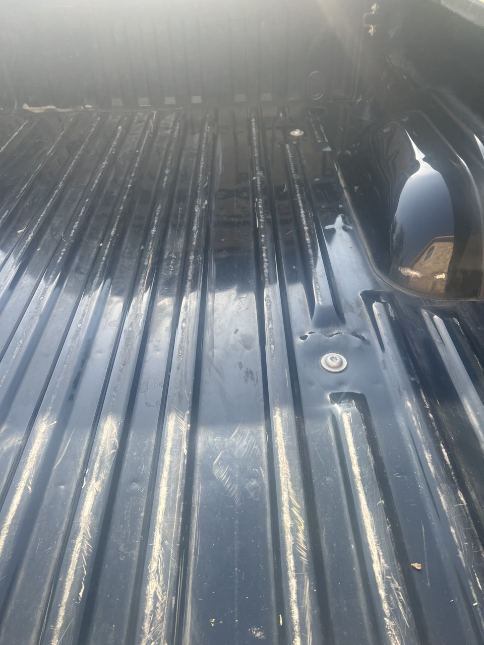

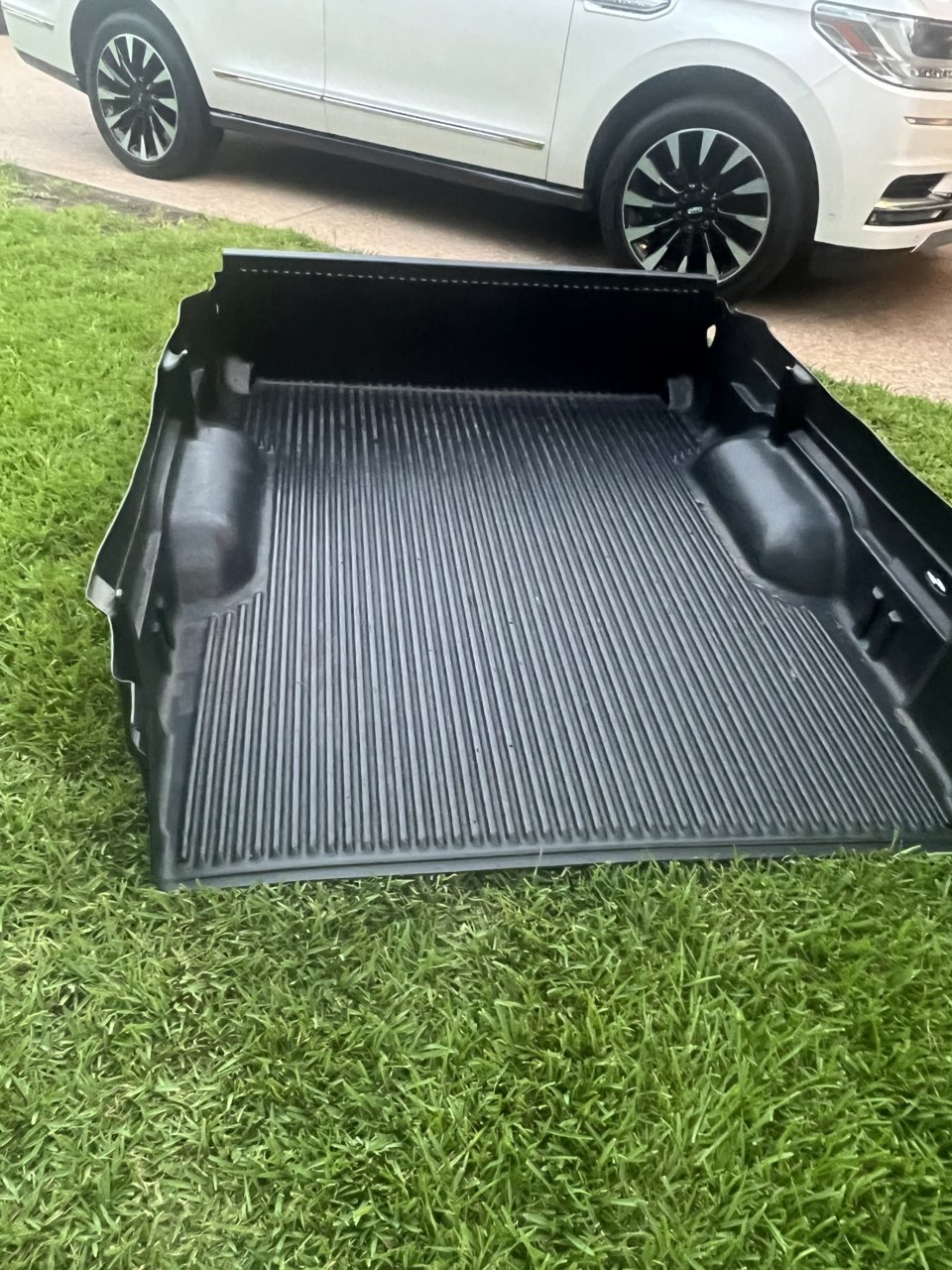

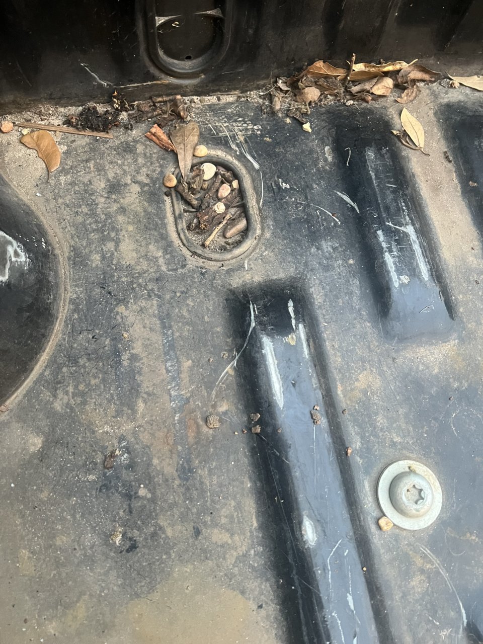

    Pulled the bed liner out of the old girl tonight. Truck lived in Virginia and Germany a few years, so was really worried about what I would find. Turned out to be in great shape!

    Watcha gonna do with that liner?

    Flip it upside down, stick it on the bed & have a cap?

    I'm throwing that hooker back in the bed, so will keep it. I wanted to see if I had any rust under there. Plan on pulling the bed and cleaning up the frame some when I swap the: Leafs, rear shocks, add airbags, and setup trailer wiring and brake setup.

    I really want to do that too and I'm tempted to replace the fuel pump when the bed is off. My truck has had a few instances when it didn't want to start and I've wondered if the fuel pump is the issue.

    Forgot about the pump, good call! I'll do that as well

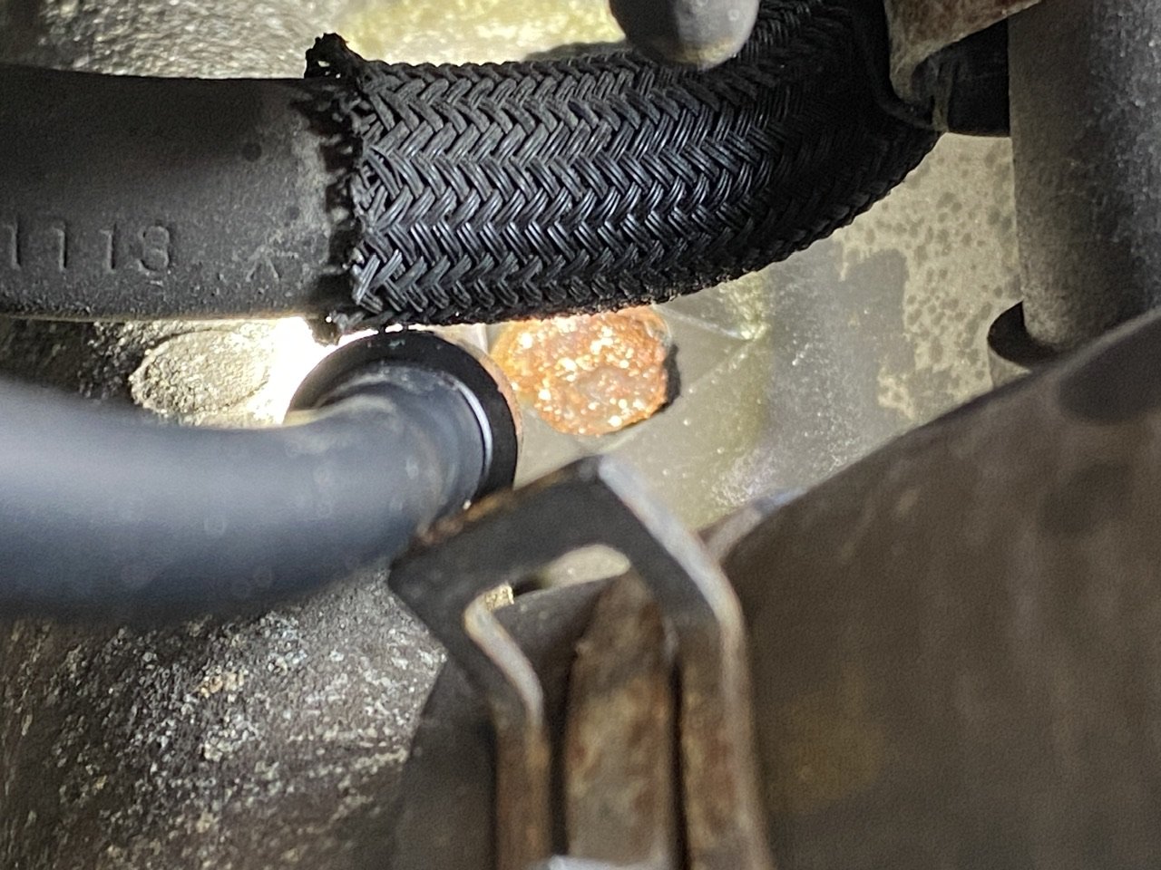

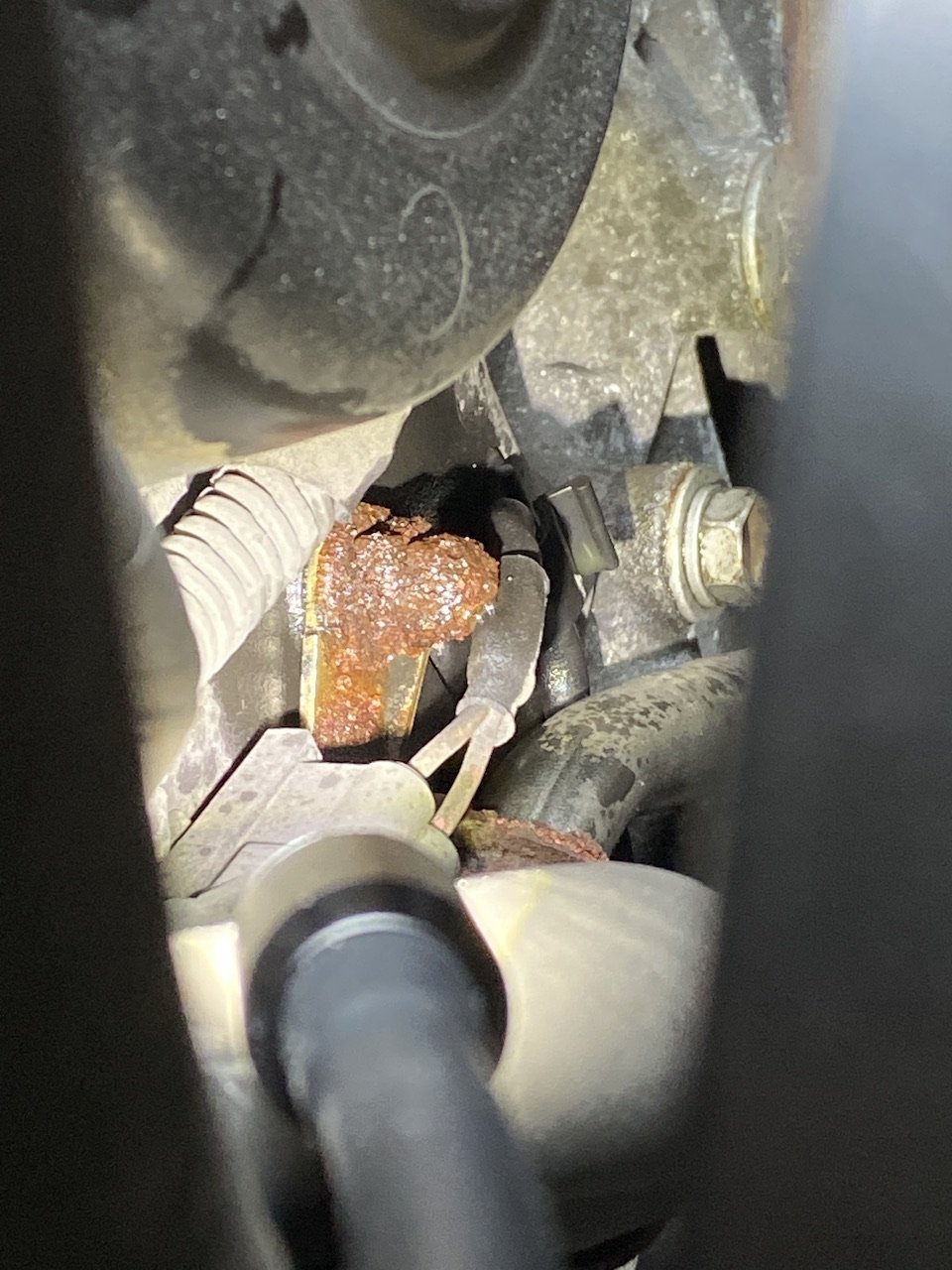

    Sometimes I hate my life….left side timing belt cover nut and bolt to remove :annoyed:
    Middle nut on timing cover
    Top left bolt to remove
    I’d hate to think the stud would snap in the process of removing the nut from the center of the timing cover. It’d probably do some damage if I didn’t get the cover off to find it before I drove the truck again.

    Washed it out with some hot water and dawn last night. Looks pretty good. @Jack McCarthy will be pissed IMG_1741.jpgIMG_1742.jpg
