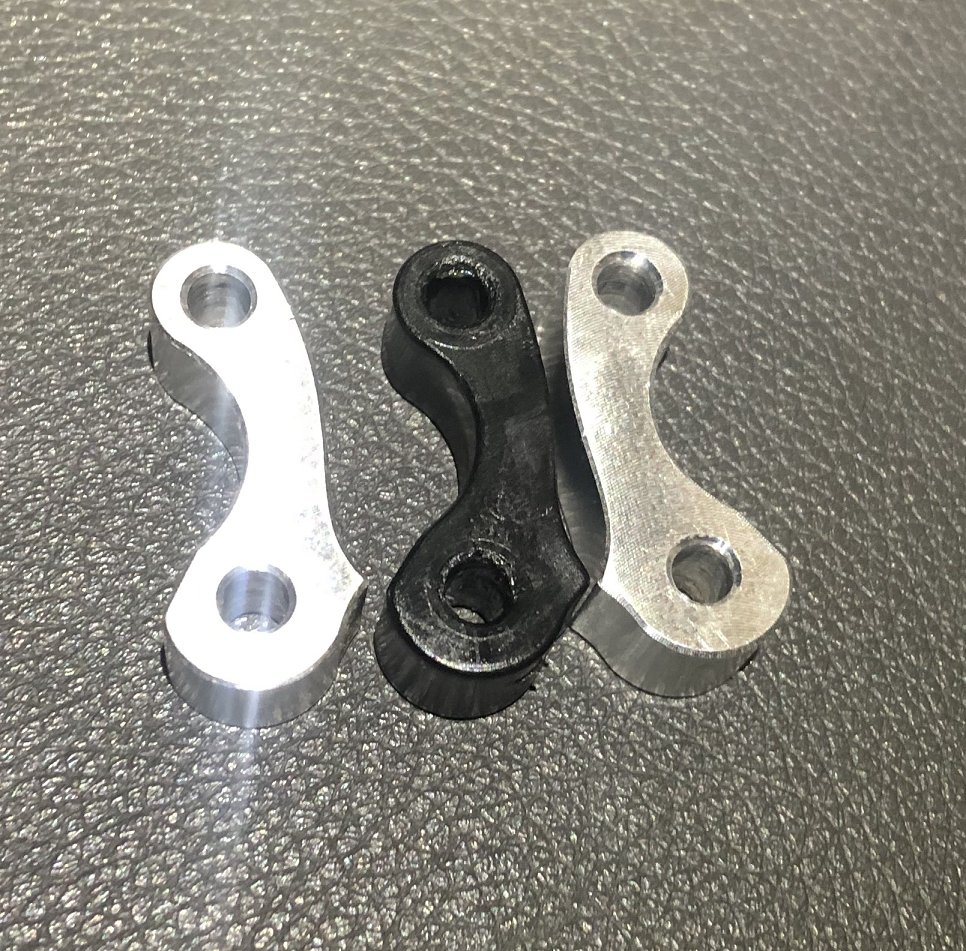

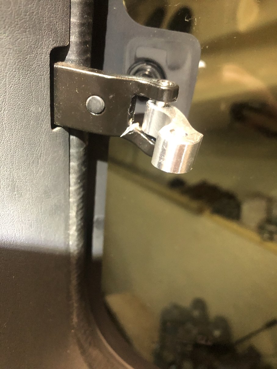

    The tension pins are an eff'n bitch even with proper tools.

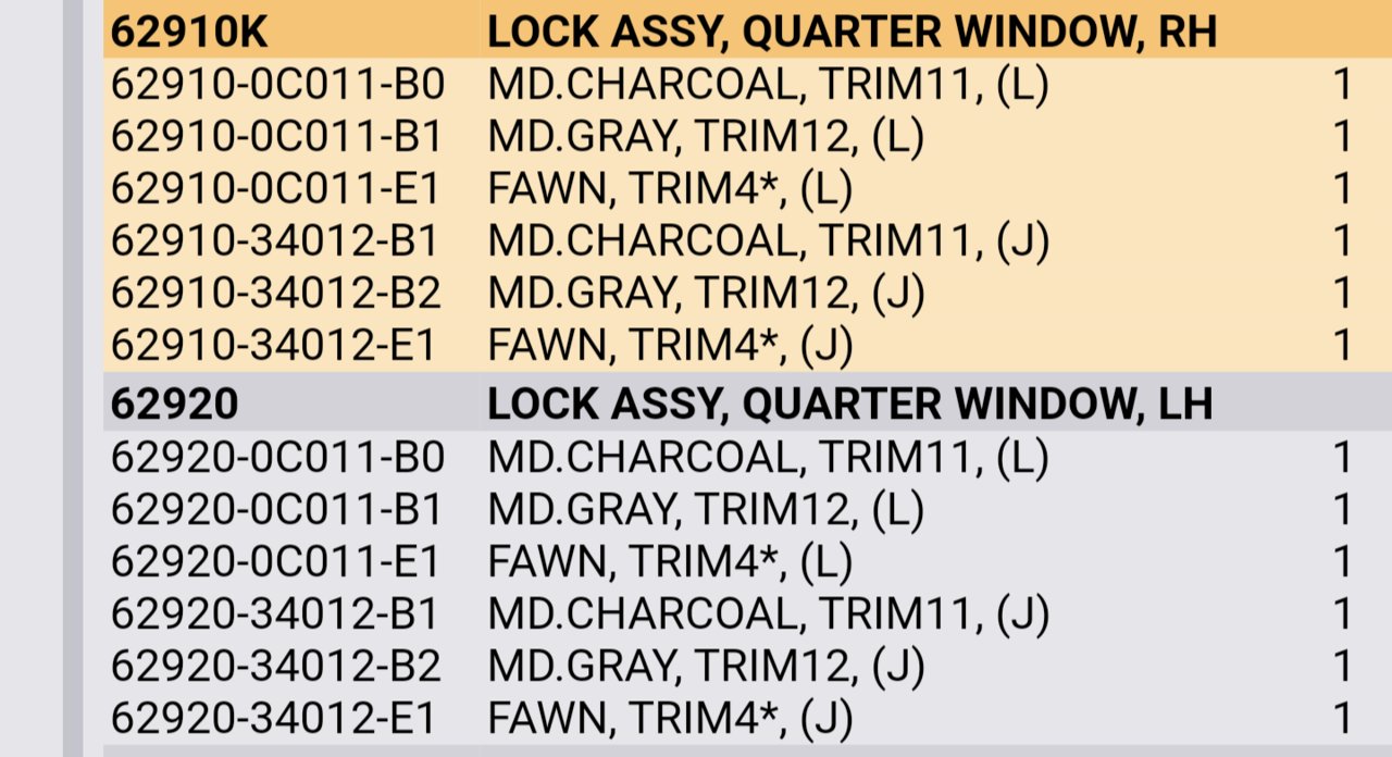

    I'll give part numbers, because it's not sold separately, for others in the future. If anyone else needs the rear access cab vent window or wing window latches, parts are as follows for 2000 - 2006 Tundras:
    Vent window latch left: 62920-34012-XX
    Vent window latch right: 62910-34012-XX
    Where "XX" is your truck's color code, i.e. B0, B1, E0, E1 or whatever. Like my Med Charcoal grey ends B1 for my later year. Moon mist ends B0 in some cases, or B1 in others. Grey ends B2. E0 is oak. E1 is fawn. You get the point.
    Anyway, here's why I think it's a bunch of bullshit. On previous trucks, I bought these as a 'wind noise fix', supposedly the geometry was different, they were elongated, and when you popped the OEM part off and compared side-by-side with OEM, there was clearly a difference. I bought these 'wind noise fix' latches off scAmazon based on a recommendation here with that in mind, because I am getting a little extra wind noise from my rear corners, although in hindsight it's probably the door seal.
    Here's the OEM part and the 'wind noise fix' part side by side. I also stacked on top of each other, THERE IS NO DIFFERENCE. And the tension pins are a bitch to get through the billet, to the point I cracked my shit, even using a 1/8 pinset, which is what I was using, alternating with a nail I modified for the tighter space. I almost stopped myself after the passenger side by my f'n OCD wouldn't let me do it. Don't be me. And the stupid part is I've done this half a dozen times on other trucks. UGH.

    At least if I buy both, and restore both to stock, I get FREESHIP from Serra or McGeorge since it still works, if I can actually order from there, and I can take the opportunity with my rear door card off to NOICO my doors.

    That long pin is used to push out the roll pins, you’ll need to reuse the pins you’ve got. I did this a while back, I used channel locks.

    Mine came with no pins. So I have to repurpose the OEM tension pins, which don't seem to like alloy very much.

    These are the old numbers probably.

    I used a punch tool to get the pins in mine but that's only after removing the part completely from the door first and doing it on my coffee table with a small 2x6 block of wood in between. Zero issues.
    https://www.tundras.com/threads/wha...-gen-tundra-today.2558/page-1037#post-2346263

    Had I been smart, I probably would've removed the entire part, but I was trying to save time not popping off my door card.
    Again, lesson learned. It could just be that the tolerances on the part I bought are shit. But either way, knowing the part is the same on both, and they're the same part on both sides, I may just swap out with originals to get back to stock, and save the carcasses. Chalk this up to a lesson learned, and have spare parts on hand in case I or anyone else needs.
