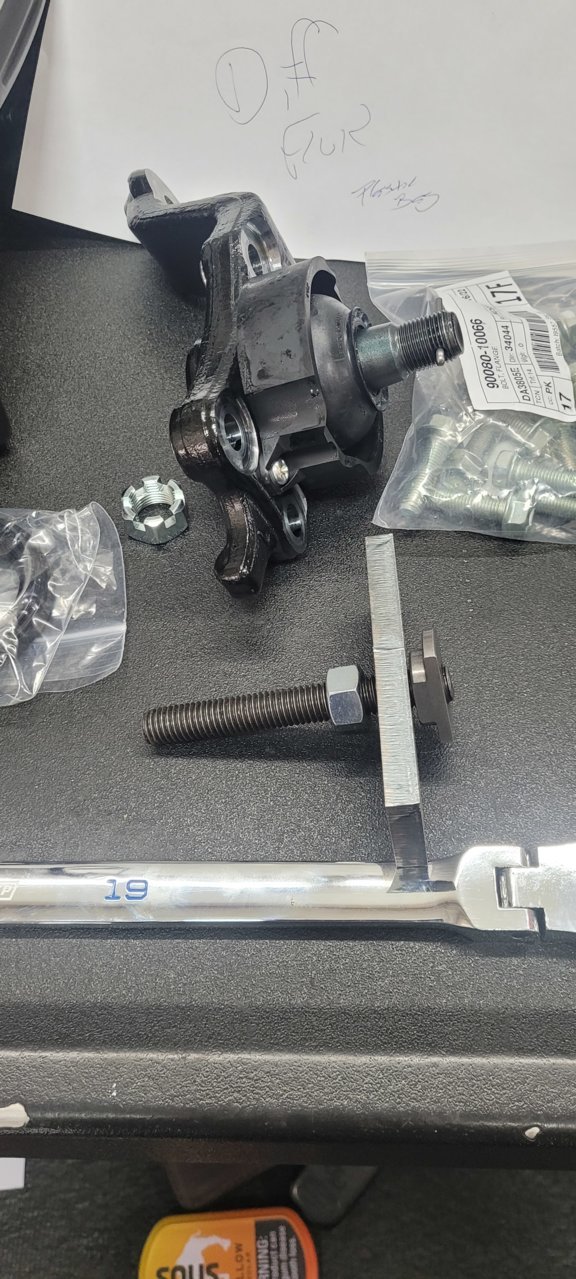

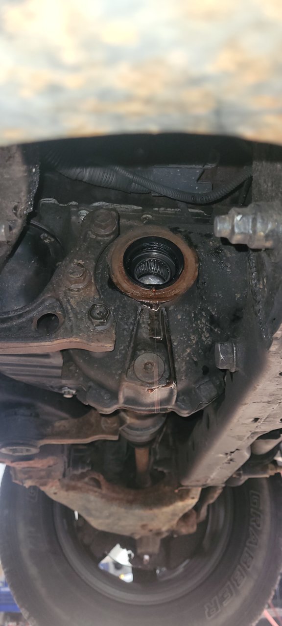

    Lower ball joint and needle bearing replacement day. Ecgs kit was awesome, tool slid right in and bearing came right out.
    Almost weird to not have my constant rhythmic vibration anymore.

    New axle seal too?

    For sure. Definitely wise to do while it's staring you in the face.

    Yep! Good call
    I’ve got that same tool somewhere

    Is it wise to use both the removal and install tools listed on the ECGS website?
    I see them listed for an 8” bushing, so I’m guessing that’s the same size used on our trucks.

    Hopefully they have a revised or better install tool, but any seal install kit will do

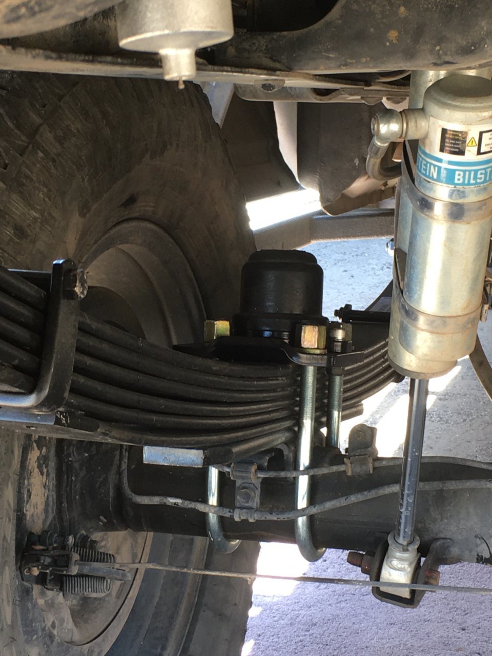

    Trimmed up the UBolts, only at 50miles since install but I’m doing a trail run next Saturday so might as well retorque everything. It was all good and tight excerpt the UBolts needed to be snuggled up some more. 3D0AB659-9948-4336-8FD5-029CDBC87033.jpg

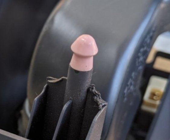

    I need to take my dash apart cuz the backer rod didn't completely fix my rattles.

    Need to grease those pink phallic looking things?

    I believe so. I can put upward/forward pressure on the dash halfway between the ipc and stereo and the rattle goes away. Does anyone have a pic of those pink phallic things in the dash? Are they accessible by removing the ipc?

    There was a guy on here a while back that took pics of those things with his dash apart. I can’t remember who it was though.

    Damn, if I have to take the dash apart to get to that, I'll just suffer with the rattle. LOL

    I only got the removal tool. I used a PVC pipe and a cap for the install but I don't recall the size off hand.

    2”
