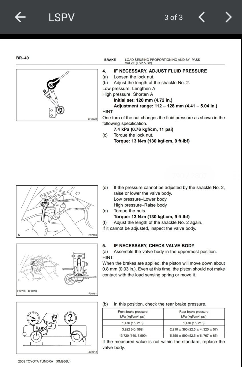

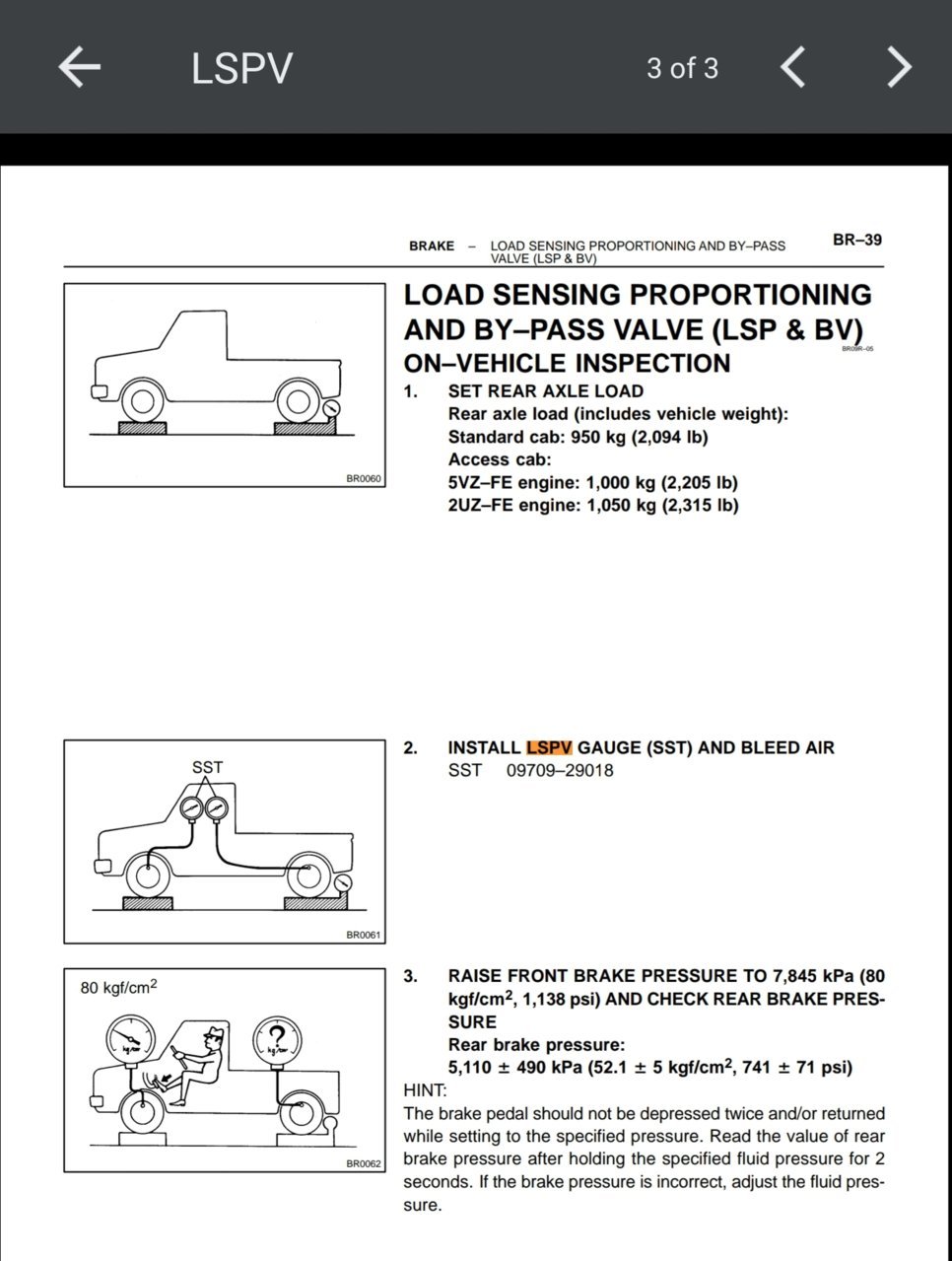

    Here's what the FSM says about the truck brake PSI under load.
    I've been thinking about buying that special service tool and then making it a rental for Herr since it pretty much only applies to our trucks, but I'd never get my money back on it.
    09709–29018
