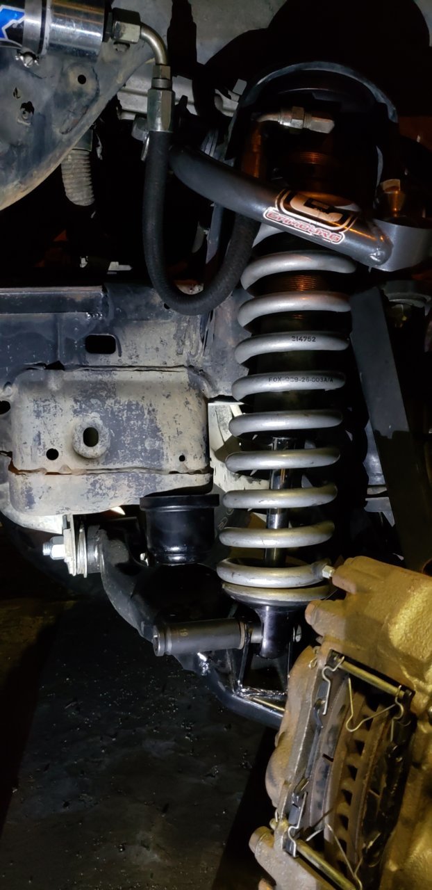

    To prep for tomorrow afternoon, I removed the oem skid plate and sway bar. They’re the start to my oem parts stockpile that will take over the corner of the garage.

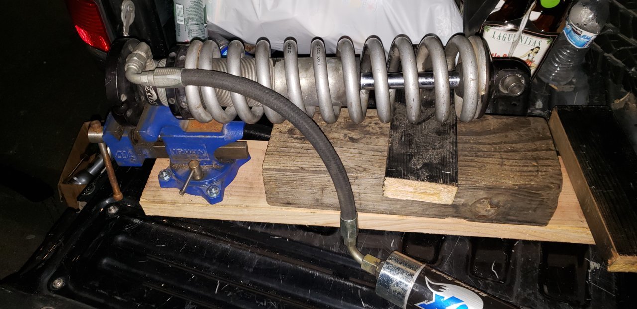

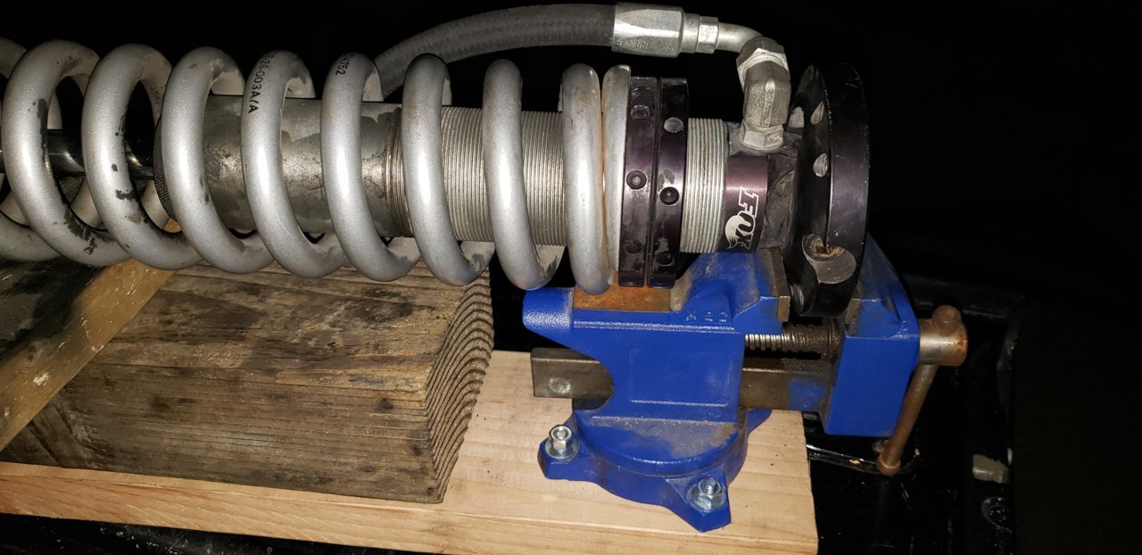

    Rigged up a "bench" for my vise and put around 120ftlbs of torque down to get that damn bolt out so I could correct the top plate. I don't think it needs more than 60ftlbs, can't imagine that being good for steel bolt and aluminum female threads.
    Progress...

    Starting to tear down the suspension.

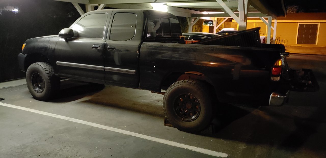

    Sat down and looked at it standing up by itself for the first time since October. Front end should settle once the weight shifts a bit. Looking like a barn find with all that dust.

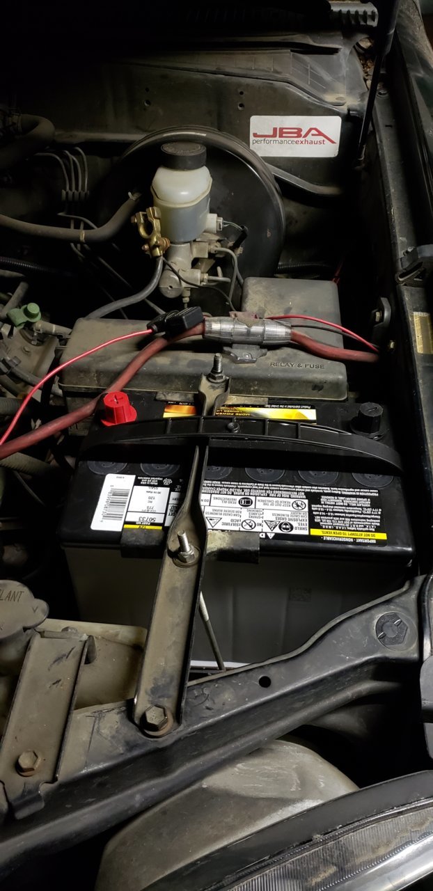

    Next episode I'll be putting the new battery in, then drive a few laps around the parking lot to settle the height so I can torque the upper arms pivot down. Then spend a few hours cleaning it out, bed is full of shit and cab is full of tools and parts now. Then I might wash it on my way to get alignment.

    Gonna connect the battery Sunday and fire this thing up. Can't wait to hear it again.

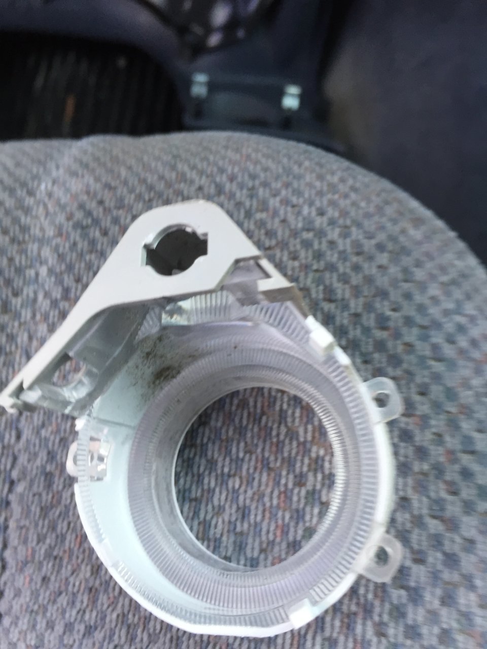

    Replaced bulbs at Key Ignition Ring and Ashtray with T-5 LED’s. Super bright white now. Green eliminated.
