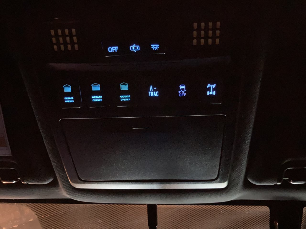

    I did custom buttons in the Tacoma overhead for my lift master remote. I’m rather fond of them. But space wise, nothing beats the mirror. And it’s something my wife won’t be annoyed with if she drives it.
    those square ones in our curvy trucks might look worse than the clip on visor remote im using.

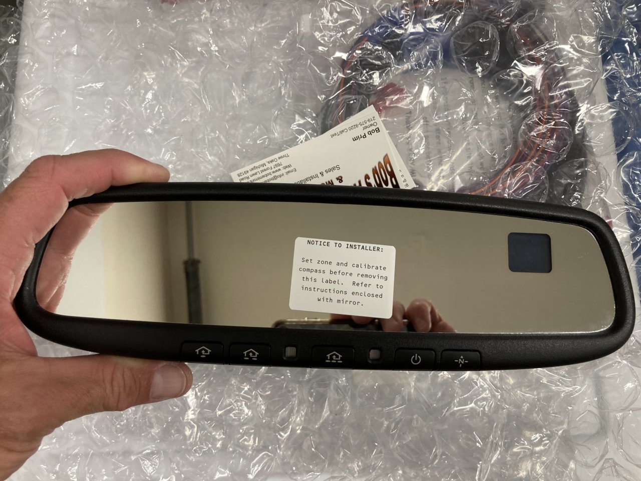

    Photos of my mirror:
    5E9866E8-F887-4C99-8C5B-BC255F703BDB.jpg DD461BCC-E92D-4F1C-A712-942C5EB02A12.jpg
    Tacoma setup for reference.

    The Tacoma part number w/compass, autodim, HL is 8781004110 or 87810-04110. Gentex part number is AECHL5. Was also used in Lex Rx350 apparently, 2018, 2019?

    Yup, definitely a Homelink v3 mirror from the pic, looks like the same p/n as my Gentex 453, except with mine the compass is hidden under the glass, and your readout window looks larger, like it may be compass + temp.
    I thought because my 453 mirror came out of a 2015 Honda, I'd be able to use it with my newer Chamberlain C203 opener - I've got two doors, one newer Security 2.0 compliant Chamberlain C203 opener, the other Chamberlain unit is 17yrs old and not Security 2.0 compliant - but I came to learn if I don't have at least a Homelink v4, there's no chance in hell I can open the newer Chamberlain C203 door, and even with HLv4, I may not be able to open.
    That sent me hunting for other options supporting a standard windshield keystone. I think if I went with an HL4 mirror from a newer vehicle - 2017+ maybe? - it will most likely support both the new and old door opener. But there's still a risk. Unfortunately, it seems like when Gentex moved to HL5, the field of options narrowed a bit, and as you and Bob are aware, the extra options you get with it changed. Seems a lot of OEMs are moving to put the temperature readout in a console, in the HUD or cluster, or at the head unit.
