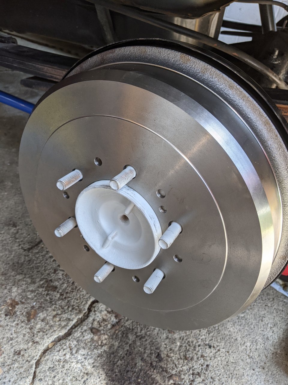

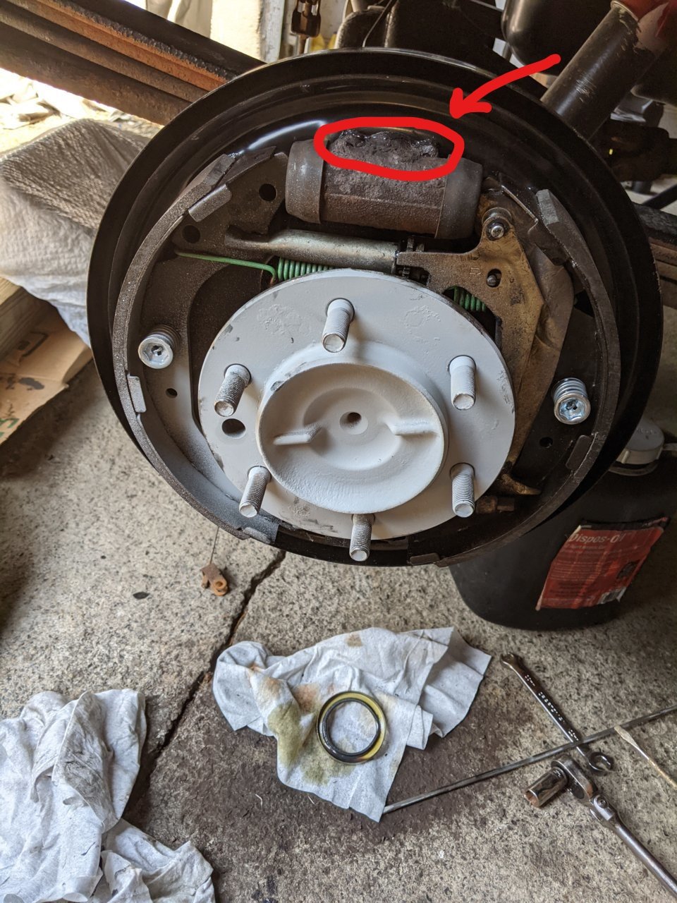

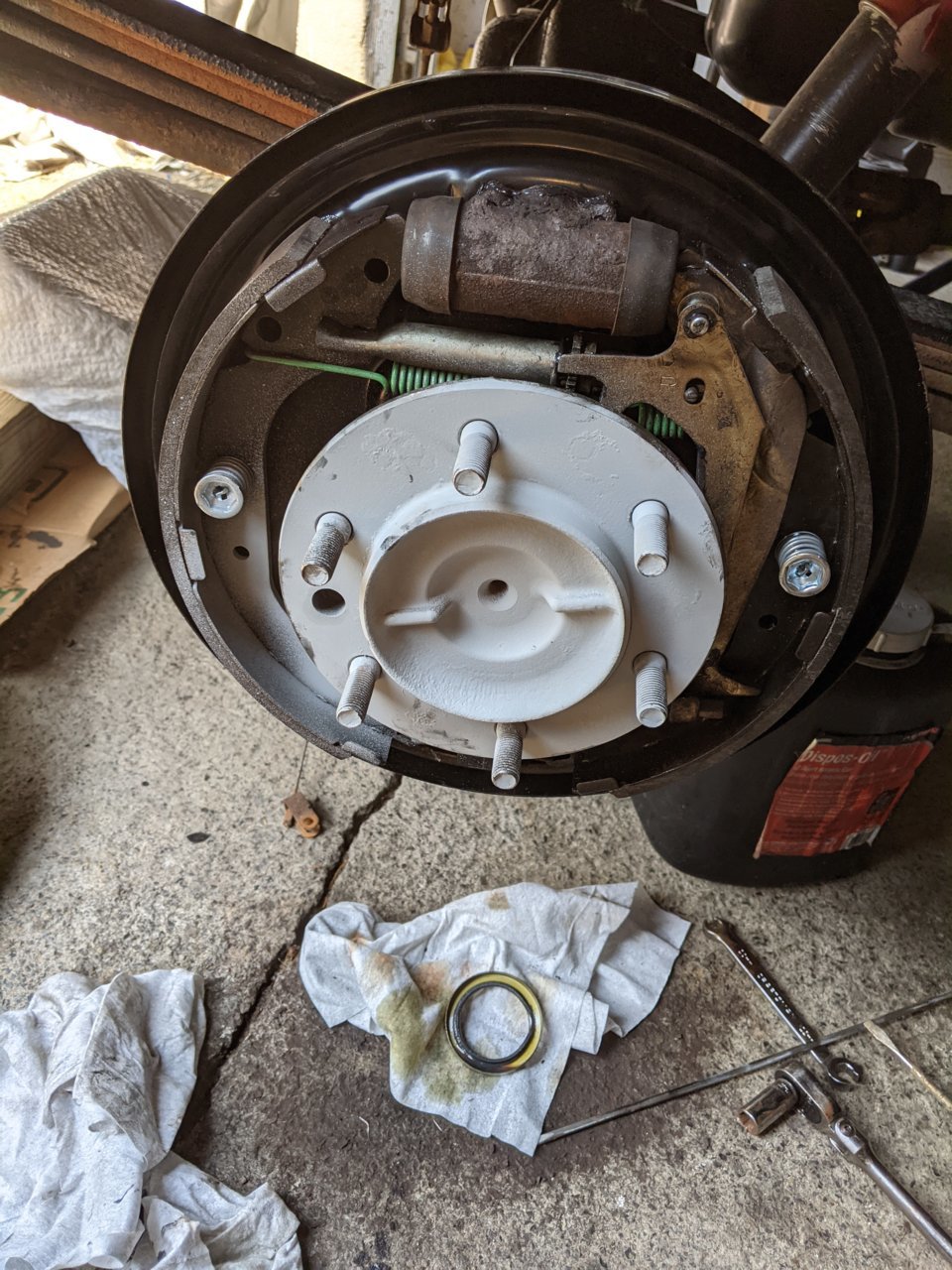

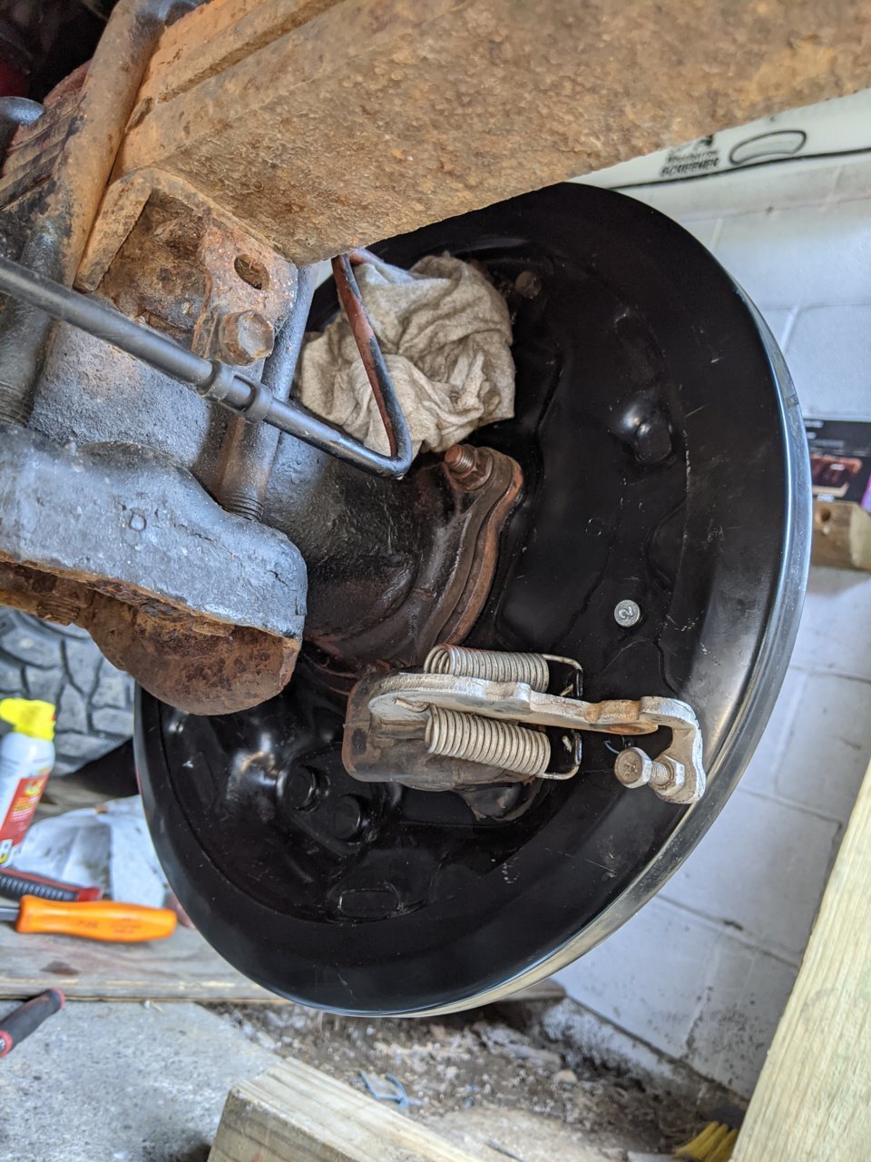

    Finished my backing plate, rear brakes, rear bearings and seals job. Now for the front end.PXL_20210727_163134194.jpg PXL_20210727_163112471.jpg PXL_20210727_163055198.jpg
    Hi06silver, bmf4069, NUDRAT and 5 others like this.

    This will never pass PHM muster. Whatever this schmutz is on top of the wheel cylinder. Disassemble and start over! Otherwise, great job sir.

    Damn you guys can pick up the smallest details....
    That's just brake assembly grease I put around the back of the brake cylinder before putting it in the backing plate.

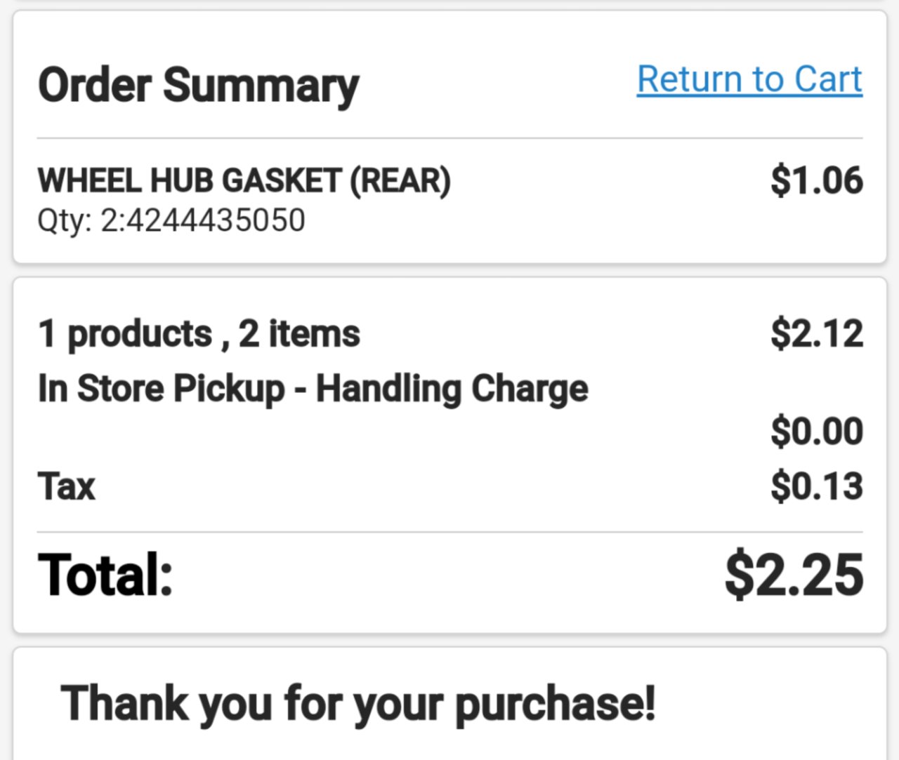

    Also missed the paper gasket.

    Gaskets are for sailors!

    OCD activated. Fine!

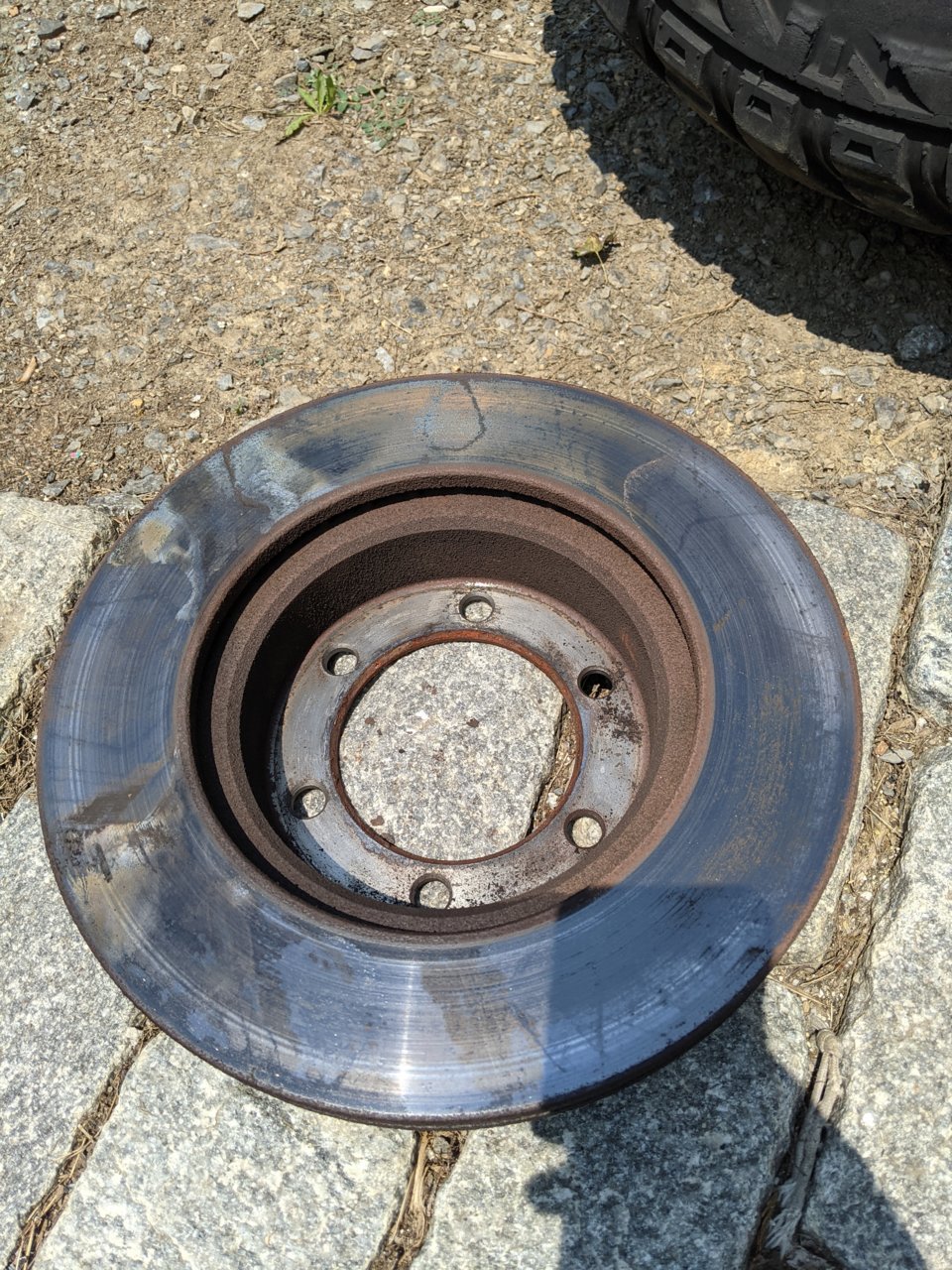

    On to the front. Just got back from the Zone with some new calipers. One piston was seized on the right side. I could barely spin my wheel when I got it off the ground. I'm surprised it wasn't more noticeable. You can see the hot spots in the old rotor too.
