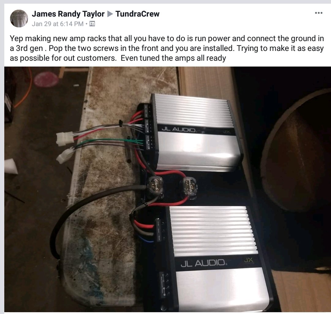

    @james@tech12volts has been working on making the install very simple, but you still will need to run a power cable thru the firewall boot, install a fuse and attach the cable to the battery. Also will need to attach a ground cable. Here is a post he made a week or so ago of a setup that he made very easy.
    A true plug and play setup that does not require a larger gauge power and ground cable is either a very low power amp (like the factory amp) or is risking an electrical fire by over heating the factory wire. Hopefully you would blow a fuse first, but I have seen people install higher rated fuses in the factory fuse box of cars.

    It says "run power" so I'm guessing that's exactly what he means and what you said, run a larger (properly sized) power wire and a ground wire of the same size as the power wire?

    Very curious as to what "this setup" that he's coming up with will cost.

    Yes, looking at the photo of the setup James built, the main ground wire looks to be 4 gauge, that is connected to the distribution block and then connected to the amps with 8 gauge wire. I would say the power wire needed would also be 4 gauge for that particular setup. Larger amps or more amps, you may have to run 2 gauge or 0 gauge wire
    Or the ground is 0 gauge and then 4 gauge to the amps

    Argh......taco tunes setup isn't more PNP than any other setup. You have to run a power wire. Taco tunes is lying to you if they say it's PNP.
    And you are much better off getting a good brand amp vs who knows what the hell supplier taco tunes is using.
