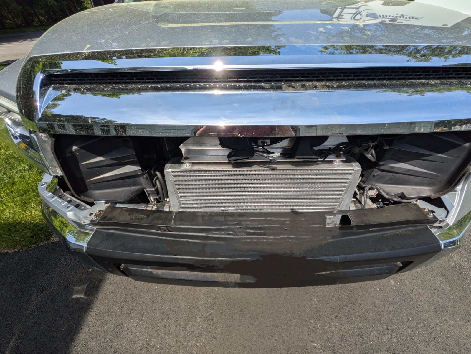

    Thanks again @TurboKits.com for overnighting the clamp!
    As an update, clamp is installed and more logging (into positive boost this round) happened this afternoon. The tune is def coming along and I'm looking forward to the next Dragy times, be cause the seat Dyno says they're improving.
    First tow with the intercooler is next Thursday. For anyone familiar, this is into the White Mountains of New Hampshire (right up to the base of Mount Washington) and then 45 minutes due West into VT (about 30 minutes east of Montpelier).
    A few brighter install photos of the intercooler and piping.

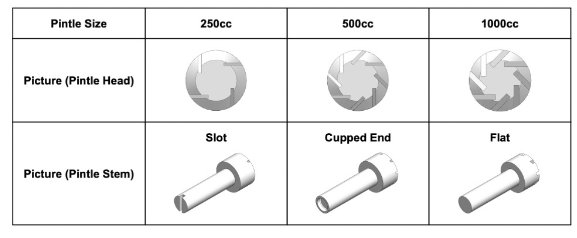

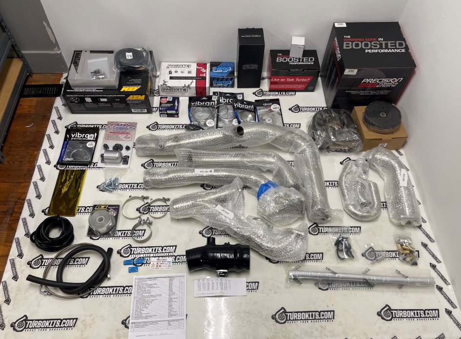

    Hey Jego, per your packing list and layout pic, you have the AEM Water Meth from us and it uses the V3 nozzle. We sell quite a few of those, so I can't even think there would be a chance of an older V2 in the inventory.
    Kit Layout:
    Check for these Pintles. You'll want to use the 500cc and have it start at about 2 PSI and max at 5 PSI:
    Can you confirm?
    Nice, I can't see that hurting being in PR, you don't have the colder weather where the TB coolant is used to bring the temps up on cold days.
    Wynnded and Mdl like this.

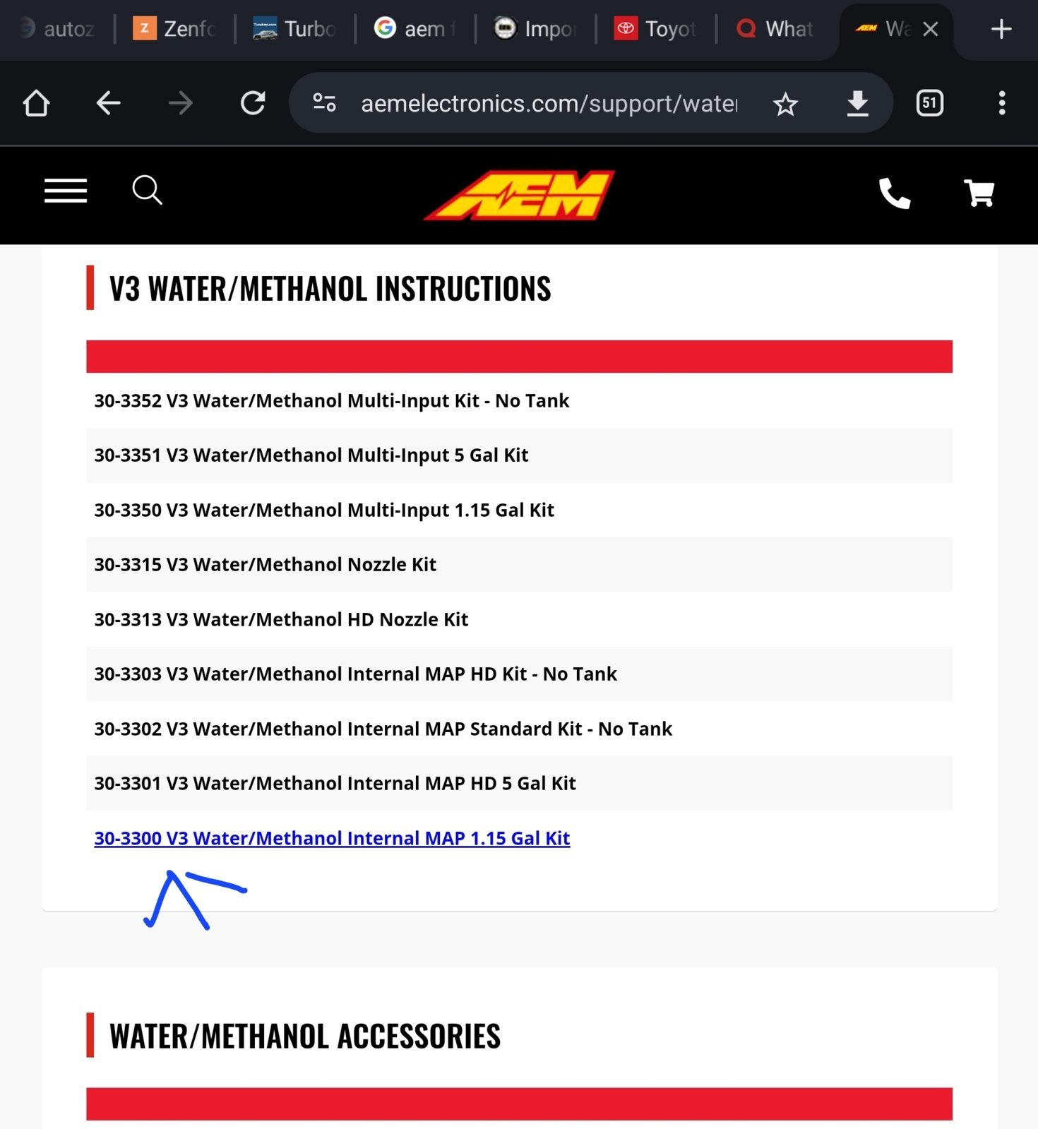

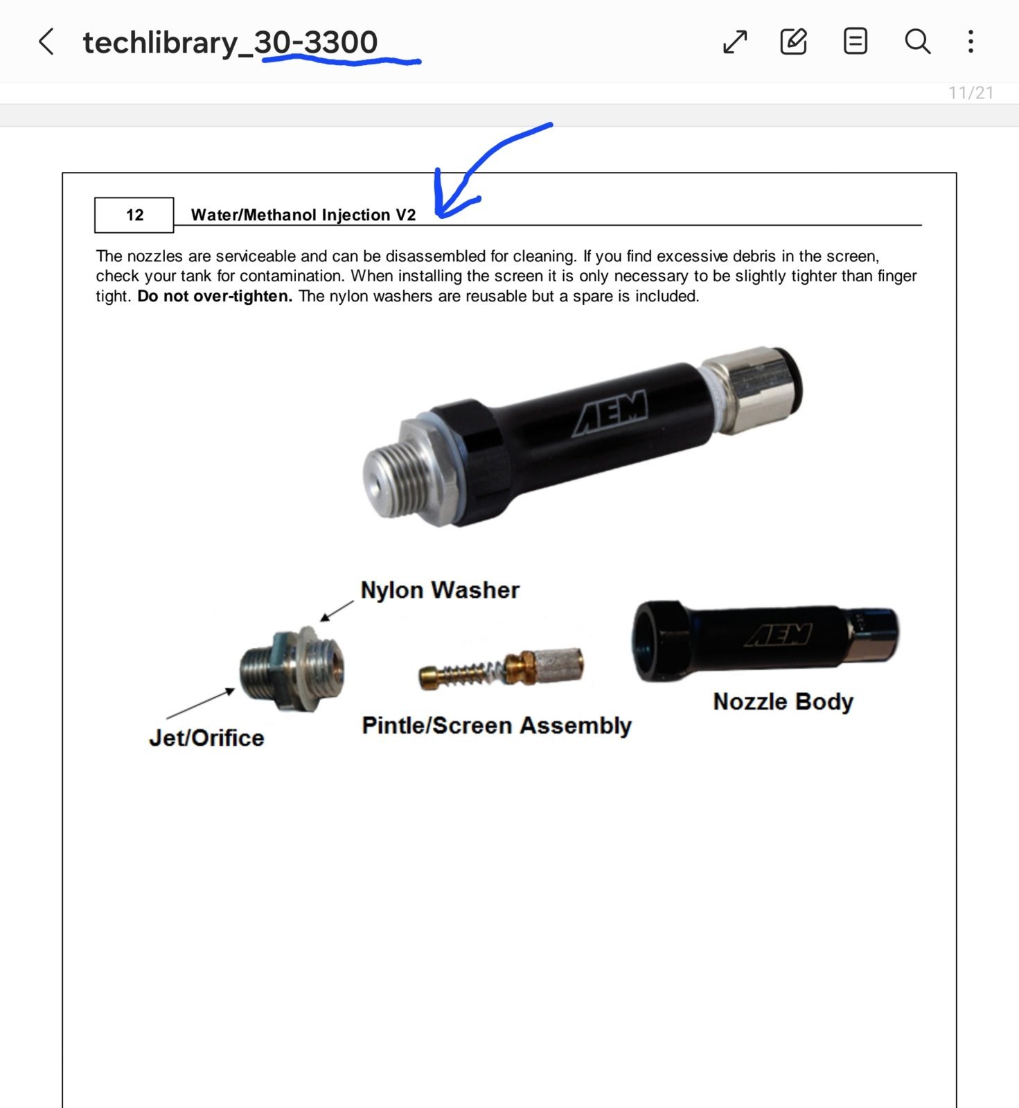

    Nice, I will do the coolant bypass! It is strange the model num. for the AEM kit is 30-3300. The install guide link has the V3 but the guide refers to v2.
    https://www.aemelectronics.com/support/water_methanol/

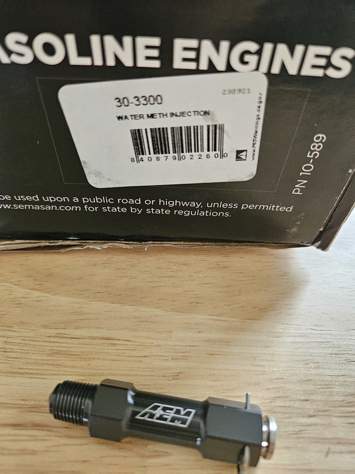

    Nop because the molle I ordered to install the tank is delayed. Per Amazon status should be delivered today. I am ok with it, it can be upgraded :)

    Oh, I thought you had it all open and had the older nozzle. The 30-3300 is the correct part# and the pic shows the correct V3 nozzle as we would have expected. So you are all set!
