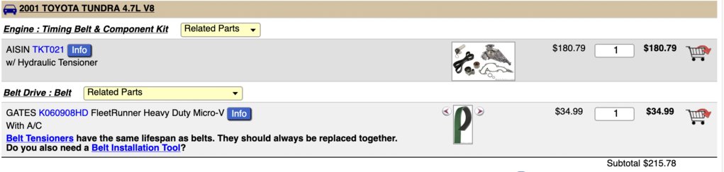

    If I am correct, replacing the coolant pipe o-ring is part of a timing belt job anyway, and included in the Aisin timing belt kit? So I made an appointment with my most trusted local shop for next week - they say all their mechanics have min 20 years experience, and they don't have any "junior mechanics" right now. They say they've done plenty of timing belts on Tundras, but didn't specify 2uz-fe or first gen tundras. They seemed confident and patient with me, so I'm leaning towards going for it with them. $1000 in labor and supplies, and they'll let me provide my own parts. I could always change my mind and do it myself, but I'm going to order the parts tonight either way.
    If I'm taking it to the shop, they'll have their own coolant, FIPG, tools, etc. ANYTHING TO ADD TO THIS SHOPPING LIST OF PARTS I'LL PROVIDE THE SHOP?
    Obviously, if I do it myself, I'll need to get some coolant and fipg. And will borrow an impact from my friend. But for tonight, I just want to get all the key parts on order in case I opt to take to the shop next week.
    Thanks in advance!

    I wouldn’t have ordered DAYCO, but …
    Aisin makes the part IIRC. You can look up the correct part using their part finder: https://aisinaftermarket.com/online

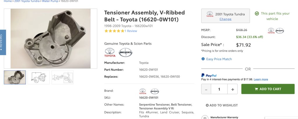

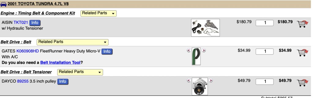

    DayCo not so good for the accessory belt tensioner eh? I had a feeling y'all would have suggestions on that. I did order it all last night from Rock Auto since I'm on a bit of a timeline. As best I can tell it seems AISIN makes a tensioner for the timing belt itself, but not for the accessory belt. Good resource for other parts on that link though.
    If you guys think it's worth it, I could order a Toyota OEM one today for $72 + shipping from Ourisman, then return the Dayco one to Rock Auto. Good idea?

    I don’t think I’ve ever replaced my accessory tensioner.

    Hm, interesting @KNABORES - would you recommend leaving the original?

    Mine continues to operate normally, as does my clutch fan and bearing. I will not be replacing them at my upcoming timing belt change. If I detect any symptoms of failure between now and then, I will plan to replace.

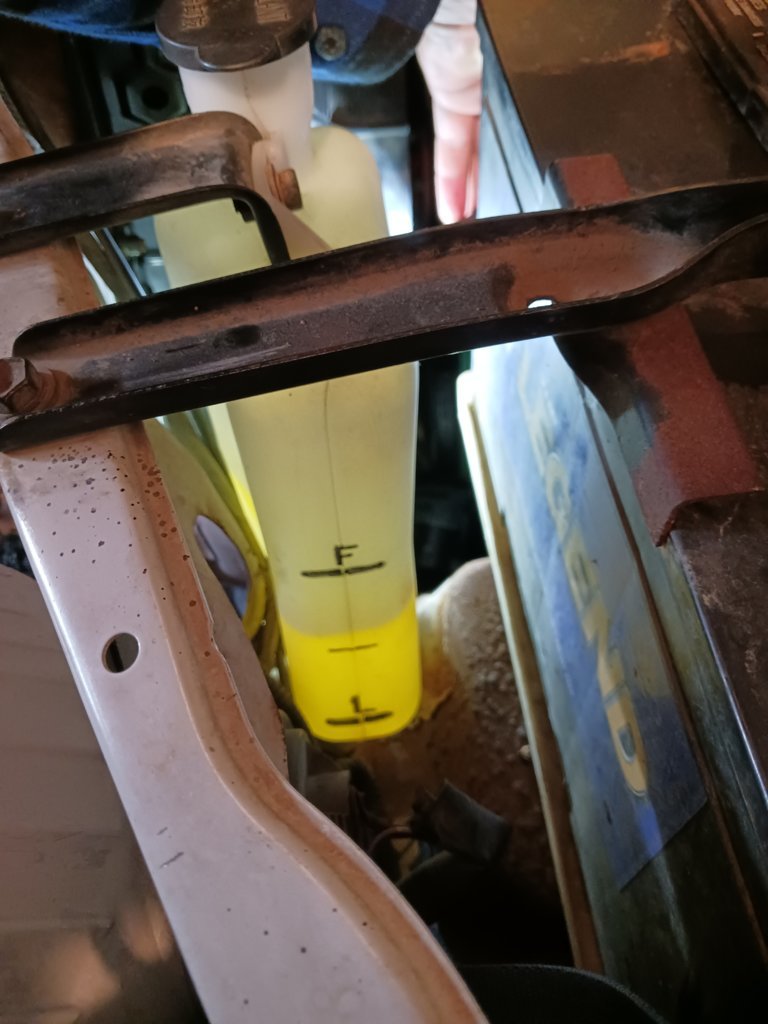

    Update: got the truck back from my (somehwat lol) trusted local shop today.
    Since the coolant pipe o-ring failed completely last week, it was a good time to do the timing belt job since replacing that o-ring is part of the job. Everything fired up just fine, and at first glance it appears they did a good job with it. Whew!
    But two questions:
    1. They filled it with a yellowish coolant. I inquired about coolant ahead of time, and they told me on the phone that I could provide coolant if I wish, but they have "Toyota coolant" they would use, so I let them do that. I've been running the Zerex Asian Coolant that's pink for a while now, but turns out the "Toyota coolant" they used is yellowish and is actually a coolant they buy in bulk from "Como Lubricants". They assured me that the yellow meets all Toyota's specs, and that I can top up with pink Zerex with no issues. YEESH. Wish I would have just provided my own pink. You guys think it's OK to top up their yellow with Zerex Pink? Maybe I need to call them up and request the spec sheet - how would you proceed?
    2. After my 30 mile test drive, coolant reservoir is down about half an inch and I smell burning coolant. Might be OK though. Possibly it is still burping air from the system which would explain the dropped level. And there was lots of coolant around in the V after my coolant pipe o-ring failed, so perhaps that is still just burning off and explains the smell. So hopefully he successfully seated the new coolant pipe o-ring and didn't put everything back together with a coolant leak somewhere...
    Temp gauge looks good. I will drive about 100 miles for work tomorrow and keep an eye on everything. I'll snap a photo of the yellow coolant and get that posted just for kicks..

    NEVER mix coolant colors. Don't make me pull up @Tundra2's debacle again.
    If you had pink in it before, and they added yellow, I guarantee you they didn't flush out the pink fully, probably didn't open the block drains, so you probably have 60/40 mix of pink/yellow. If it were me, I'd dump it all being sure to open both block drains, do a couple of hose-water flushes, completely emptying it, then refill with Toyota pink. What a bunch of numbnuts.

    Arg! That's aggravating.
    They said they performed a full coolant flush, and charged for the coolant and "coolant flush kit" whatever that means. All as part of timing belt service.
    In your opinion, is it OK to drive this week? And in your opinion, would it be a legit option to figure out exactly what they used and commit to that, seeing as how they supposedly flushed the whole system?
    I'm going to go out and get a pic of the color right now in case that's any use.
    Thank you for response as usual :)

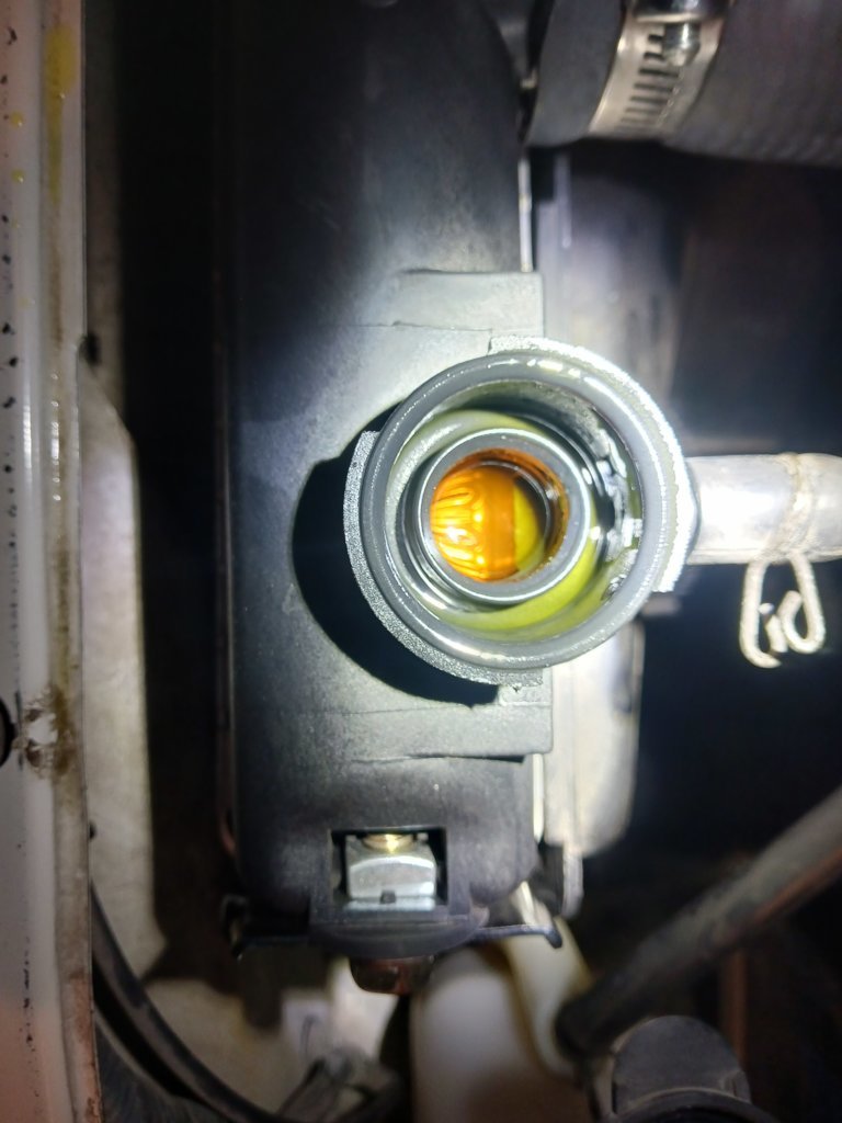

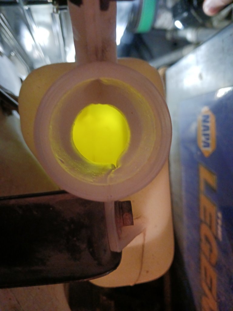

    Thanks for the quick responses everyone! I will read the debacle tonight as soon as I have a second. But can anyone provide the TLDR? Does the problem lie in using Yellow Mystery Coolant? Or is the problem in the mixing of the two colors?
    I took photos, and judging by the color it seems they may have done a pretty good job getting my nice trusty Zerex Pink all flushed out and replacing it with all Yellow dog urine looking coolant.

    The issue is mixing two different types of coolant.
    Unless I am mistaken, all types of antifreeze cool the same, but they have different formulations to work better with different engine materials. That’s what I’ve been told.
    I agree with you though- it does look like there isn’t any pink in that.

    It won't show. You could probably mix the two 50/50 and it would still look irridescent yellow.
    It's entirely possible they flushed with water in between instead of opening the block drains. The only way @TenderTundie is going to know that, and know the type of coolant the truck has in it, will be going back to the shot to ask:

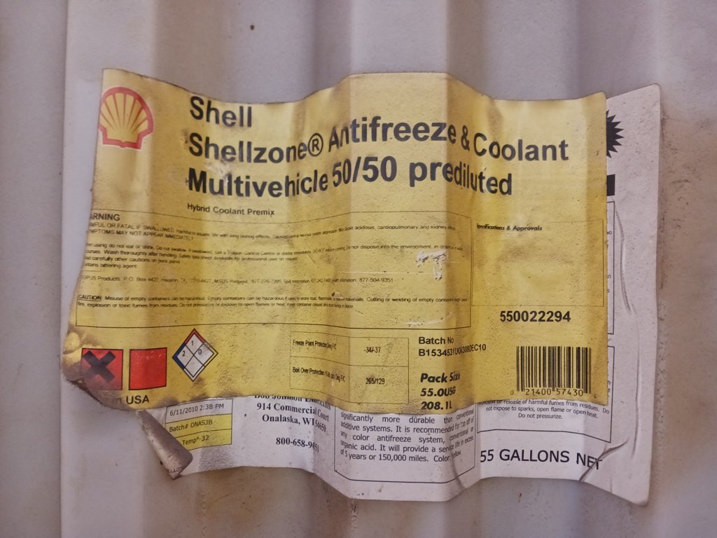

    I went out there today and followed @shifty` advice to play naive, and express interest in learning. Front desk guys were going to "attempt to bullshit user @TenderTundie", but then I got with a mechanic who was super helpful. He listened to all my questions, and here's what I learned:
    • A machine was used to do the flush with no water in between. The machine "gets up to temp" then it hits a button and flushes out ballpark 4 qts of my good old pink, and replaces with yellow. Mechanic said they used about 6 qts of their new yellow "universal" to hopefully get as much of the old out as possible and avoid mixing too much. He acknowledged that there is probably some degree of mixing from heater core or other nooks and crannies.
    • However, he SWEARS that it is OK to mix. This guy seemed really smart and was really listening to me, so I told him I'd read online about certain debacles related to mixing colors. He said "yes, but that's really an issue with old green coolant (IAT I think) mixing with newer technologies". He said they pay quite a bit to get a yellow universal coolant that will not cause gelling if mixed with modern coolants. Specifically said it's going to be OK if it mixes with my Toyota Zerex Pink, and that I should go ahead and use my pink for top ups. I have not done that.
    • He let me in back to look at the label, and here's what I got (below).
    What do you guys think of that Shell Multivehicle Antifreeze and Coolant? I see it meets ASTM D3306, which Zerex Asian Pink also does.
    I would value your opinions:
    Is it OK to run this coolant, possibly with some leftover Zerex Pink from the "coolant flush" for a few thousand miles without risking total disaster/debacle?
    Building from there, is it actually OK to run this coolant for a couple years, and just flush thoroughly back to pink at my next coolant change?
    Or can someone turn up a spec sheet that shows this is NOT OK for our engines and/or may be a disaster mixing with Pink? If so, it's urgent, and I will shorten up our weekend camping trip by one day in order to flush with distilled water then Zerex Pink immediately.
    From the bulk container at the shop:
    I believe I found the same product at wallyworld, and here is the front and back of the container:

    For me personally….not labeled but A choice. I’m not being hard headed in my choices but I chose since purchase in 2019 to only use OEM until they quit making it.
    TenderTundie[OP] likes this.
  26. May 1, 2025 at 3:55 PM
    #56
    bfunke
    bfunke Tundra Curmudgeon
    Oct 13, 2019
    #37321
    2,701
    South Carolina
    2018 SR-5 CM 5.7, 2000 SR-5 AC 4.7L
    Get Zerex Asian Pink

    A bit more info on the product: https://expertsincarcare.com/wp-con...ds/TDS-Shell-Multi-Vehicle-50-Pre-Diluted.pdf
    It technically [appears to me it] meets most of Toyota's requirements as posted by @BubbaW above.
    In order to avoid technical problems, only use “Toyota Super Long Life Coolant”
    or similar high quality ethylene glycol based non−silicate, non−amine, non−
    nitrite, and non−borate coolant with long−life hybrid organic acid (HOAT) technology.​
    Per the technical data sheet (TDS) I just linked, it is ...
    • Ethylene-glycol based
    • HOAT technology
    • Amine-free
    • Nitrite-free
    • Borate-free
    • NOT silicate-free (TDS for the Shell product says "low-silicate")
    IIRC - and I'm going from memory here, and my memory seems to be spottier on some things than others these days - silicates are an ultrafine abrasive and thus can cause precipitate, but are great at keeping things clean. It's not until the fluid gets old and accumulation has occured that you'll hit problems. That's not going to happen overnight. I'm not sure seals etc. will handle silicates. Not my area of expertise.
    Would I be overly worried about it, and rushing to flush my system this weekend, this month, this year?
    Probably not.
    Would I make a point of, within the next year or two, buying the correct coolant, and flushing the system to put the correct coolant in?
    Yes.
    Look, I know you have other things you need to put money into on the truck, things directly tied to safety. I'm trying to give you my honest opinion, despite my personal biases, whether I like or prefer what I'm saying. I never want to come off as a hardcore purist and we all know life is full of grey areas and "make-do", I feel like this is one of those cases.
