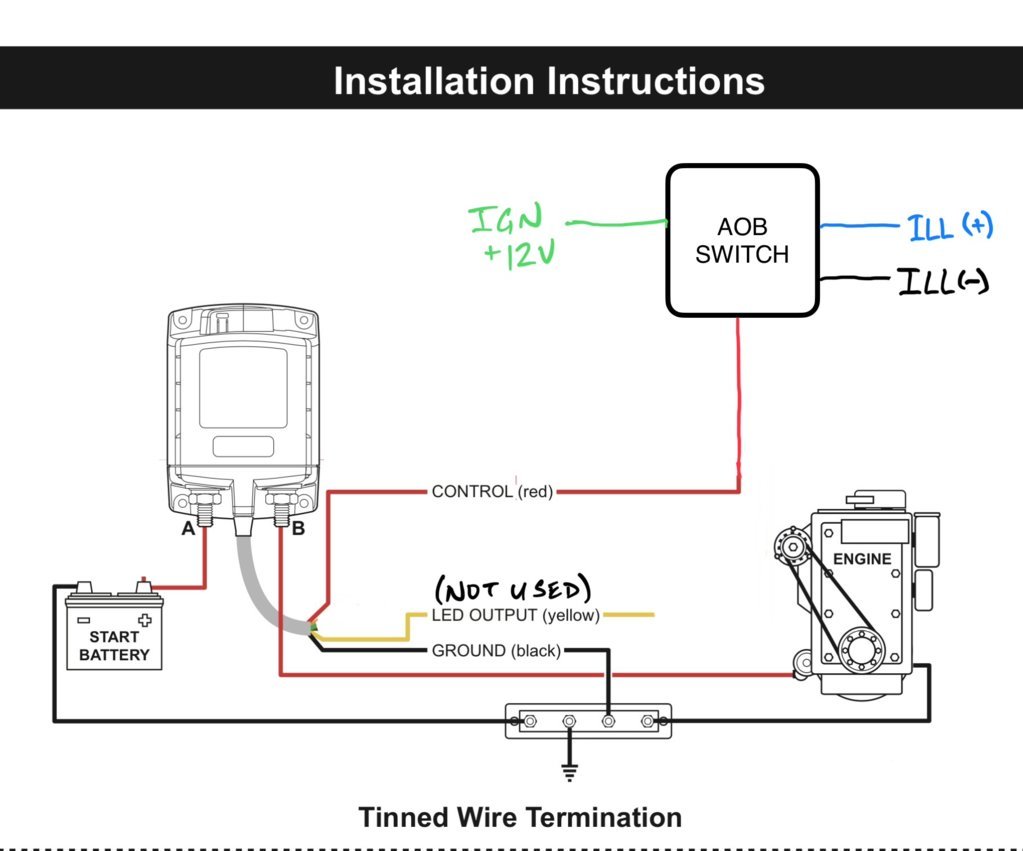

    More specific details on the winch power cut-off.
    I originally planned on using a Blue Sea ML-RBS 7700 that used a momentary switch to either engage or disengage the switch, but I found that it 1. Required more complicated wiring and 2. Didn’t provide good visual feedback if the switch was engaged (without running a separate LED or using the oversized switch that came with it).
    So, I opted instead to use the ML-RBS (Remote Battery Switch) model 7713, which uses constant power (only a few mA) to hold the switch closed - thereby using a regular latching switch to power it. And it only requires one wire through the firewall (I already have the other wires through there, so this leaves me with a few future spares now). This switch simply has a power lead coming from the switch and a ground lead going direct to the ground bus, where the other has five wires total.
    The front lug is connected to a 4/0 short (1 ft) cable direct to the battery, and the rear lug is connected to the switch controller with a 2ft 2AWG cable as mentioned in the post above. Inside the cab, I’ve got an AirOnBoard light blue “Winch Power” switch installed, which lights up the winch portion if the switch is powered on. I put this switch next to my start button when I relocated the Tow/Haul switch, so it is out of the way (not likely to accidentally hit) and helps me remember the truck has to be running to use the winch.
    Switch (at night) with winch power switch off:
    And with the winch power activated
